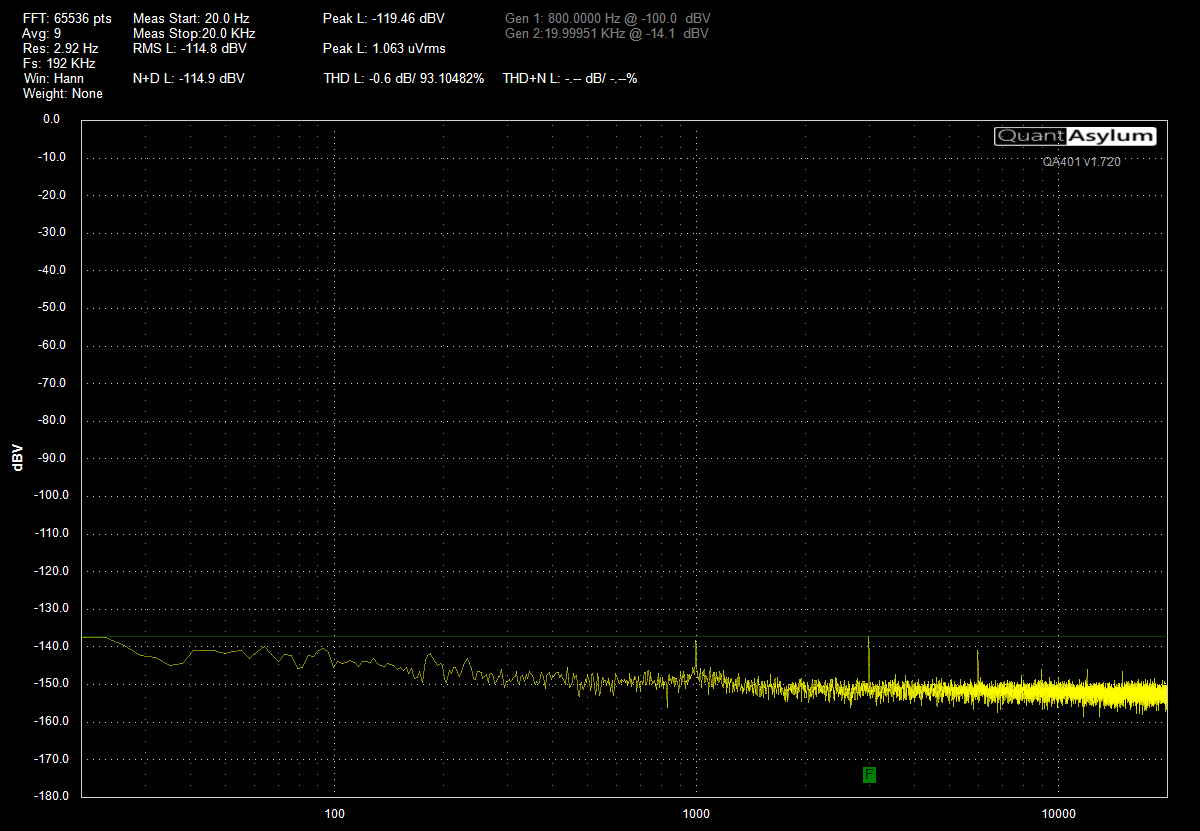

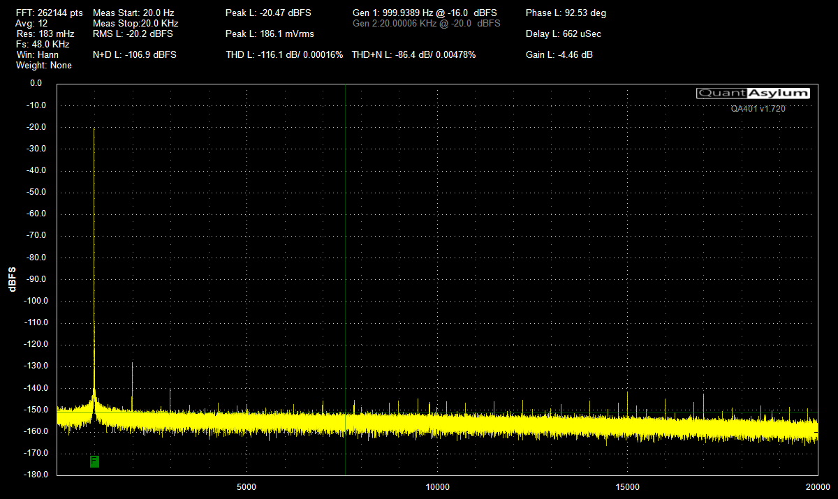

Here is Victor's 1KHz oscillator into a QA401 at the appropriate level. My Victor oscillator set is battry powered and you can see a lack of hum etc.

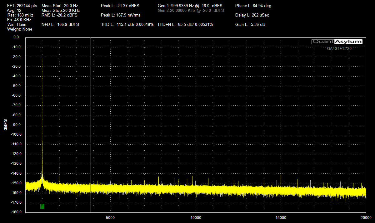

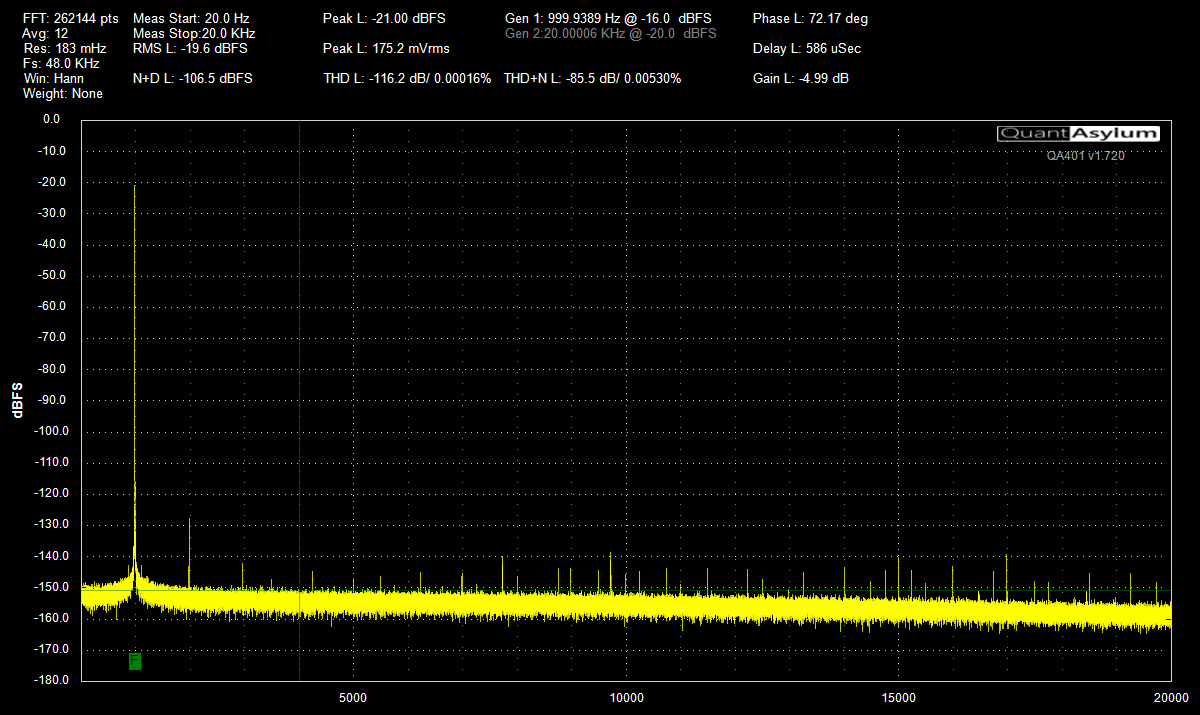

More testing.

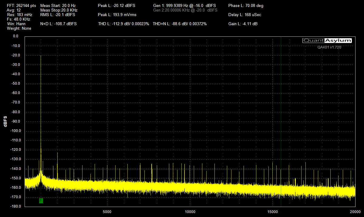

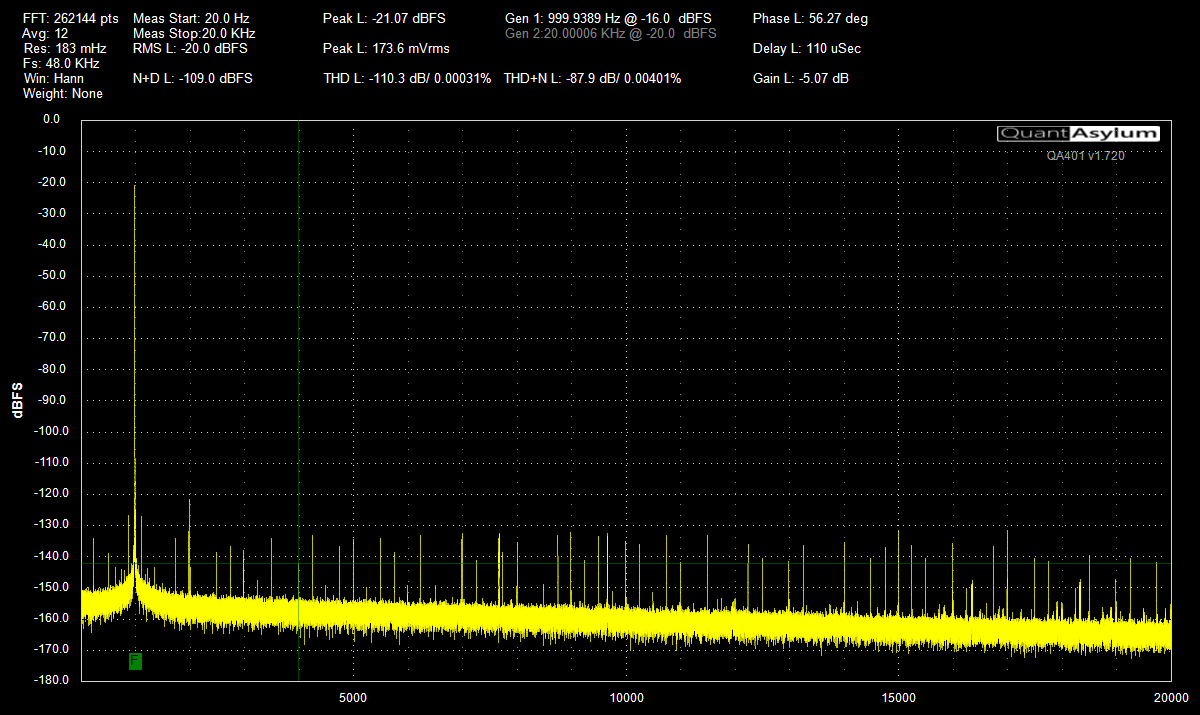

Some cable are UL listed and show the strading on the printwheel. It would show 2 conductors for power and 2 conductors for signal. It turns out i have a number with 28 AWG power conductors. Those all seem to fail and ones with 26 AWG seem to be OK. 24 AWG for power would be better but rare.
The Monster premium is what i used for the first picture. You know its premium, it has a blinking LED. . . Clearly the gauge of the power conductors matters.
However several generic cables are quite adequate as well. And more than a few are not.
Otherwise the Qa401 shows pretty exemplar performance. And the premium Monster is a 12' cable so I can keep the test system well away from the big PC.

Thanks, Demian. Great set of data. Quite a wake-up call. I'm guessing if they are skimping on the copper in the cable for power, they are probably skimping on the shielding of the cable. I wonder what the shielding looks like on that cable that uses 28 AWG.
Bob
Have you tried the RTX with that bad cable?
Its the cable I normally use for the RTX. I now have separated 5 "bad" cables/ The RTX will be different since its supplies are local and none of this stuff is running near the bandwidth limits of USB 2.

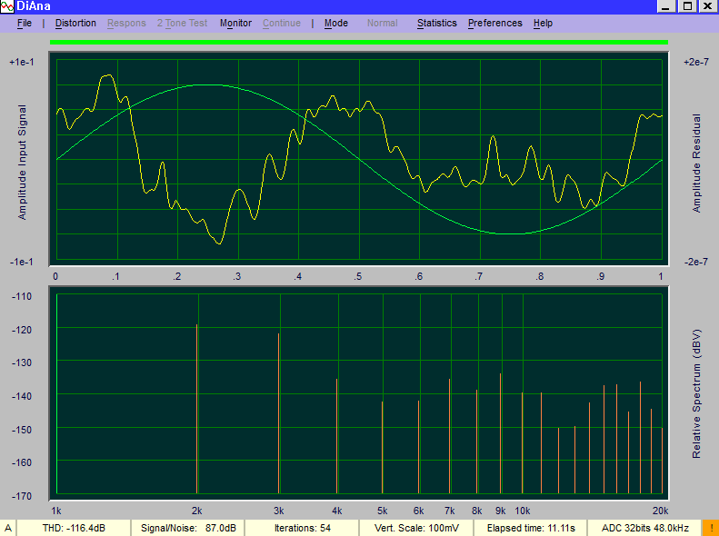

I got the ASIO working with Etienne's help and prodding. Below is DiAna + QA401 + Victor's oscillator. DiAna does a great job of showing just the harmonics and their relationships.The waveform shows where to look to improve things.

I am trying to understand why a bad USB cable would let through hash at c. +20 dB more than a ‘better’ USB cable?
The USB part of the 401 is galvanically isolated from the analog part as well.
What is the noise mechanism here?
For th3 record, I don’t get the very good noise floor Damian gets on my setup. Secondly, if I use my old Dell laptop, I get better results. If I use a newer Dell laptop, the noise floor seems higher. I am using 50 averages.

That would be my beginning issue. I believe the regulator is just dropping out with the smaller wires. The source voltage is 5.04V on all the tests. (Thg cheap USB power meters are a great investment 8 in 1 LCD USB Current Voltage Detector Charger Capacity Tester Meter Power Bank | eBay or with USB-C USB C Power Testers Type C USB Tester Digital Voltage Current Meter Multfunction 6468851942971 | eBay
I'll need to make a USB-B male to female breakout adapter. Could not find one on eBay. Its not useful to measure at the PC end of the cable.
