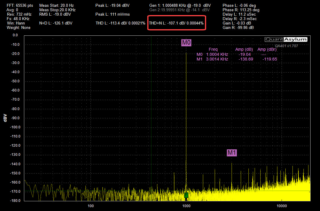

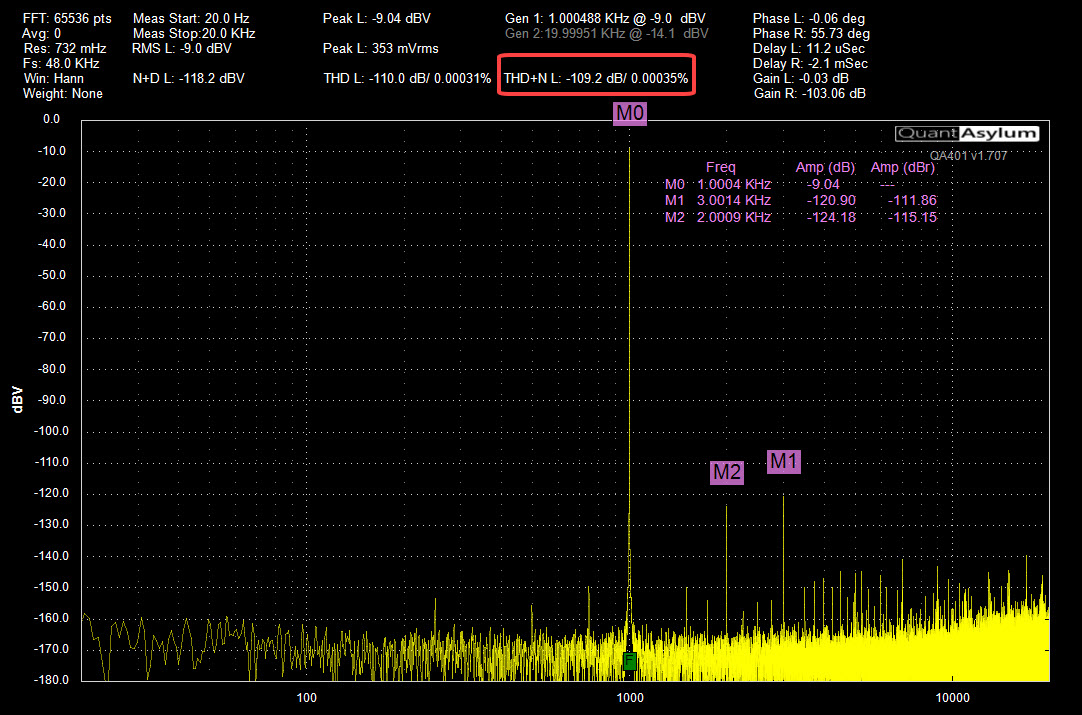

Interesting you found/solved Jen's jitter discovery in the FPGA.
Yes, that bug report led to another side benefit too. There's an experimental mode on the QA400/QA401 that was released in 2013 or 2014 called "melt noise" based on an AKM paper Demian had sent long ago regarding using N converters to acquire a signal. Every time you double the number of converters used, your noise drops by 3 dB. In the paper they paralleled 8 converters.
The melt noise feature acquires the signal N times. And since the box has precise control of the samples going out and coming in, they are precisely lined up. And if you do 8 acquisitions, that's the same as having 8 converters. The N acquisitions are precise in time alignment, and then they are averaged in the time domain (squashing the noise) and then the FFT of that average is displayed.
And eventually, THD should equal THD+N because you've melted all the noise away. But it never quite got as close as expected and I couldn't understand why. But this was due to the jitter. And once the +1/-0 sample jitter issue got fixed, then it started to better match the simulations.
Below you see loopback in the experimental mode with "melt noise" turned on. MeltNoise2 needs several more minutes to run to match the THD (and it's already been running for several minutes). MeltNoise1 has already converged and you see the THD and THD+N are very close.
PS. To turn on the experimental menu, just place a file in the QA400 or QA401 data directory called "experimental" (no extension) and the menu will appear on next re-launch of the app. Melt only works on the left channel.
PPS. AKM published the technique to explain how to extend the dynamic range of a converter. It's primarily useful if you are looking to find harmonics in what you are measuring that might be below the noise floor of the converter. But as you can see, a lot of tones get uncovered that are likely sigma delta idle tones from either the DAC or ADC. Thus, the ultimate utility of the mode is limited IMO. Though still interesting. That's why it's buried in the experimental menu.
