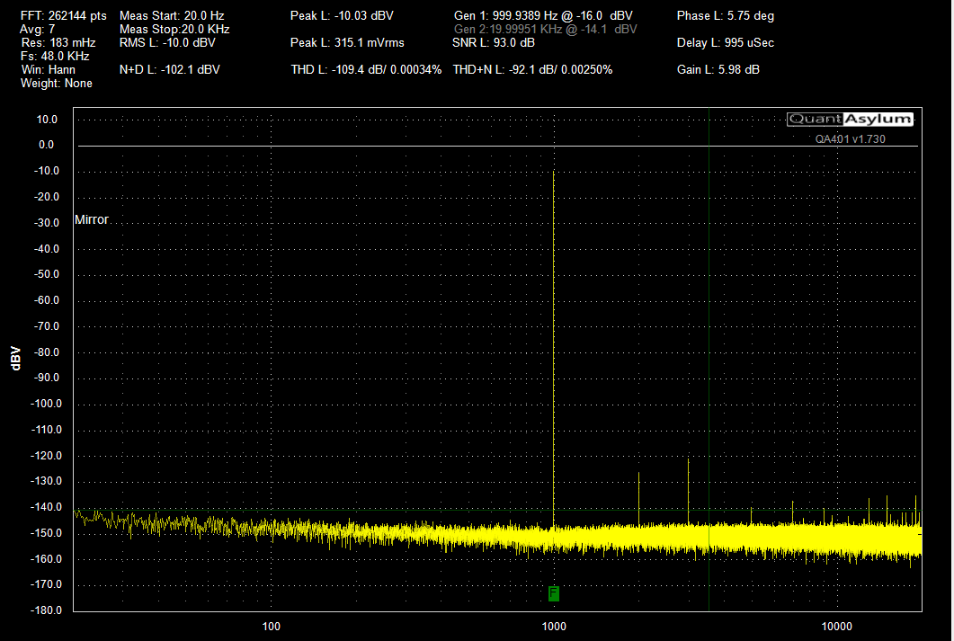

Attached are selftest plots of my QA401. First with a generic USB cable and then with a slightly better USB cable. Normally I would expect dropped frames or other ugly with a bad cable but NOT a major difference in the distortion pattern.
If you get bad results it may be the cable. ijn this case since nothing else was attached I could see no other possible issues and I was first worried that my QA401 had failed somehow. . . but just a funky cable. FWIW the cable shield measures about 500 milliOhms, a decent cable should be closer to 100 milliOhms.
I need to check the voltage at the QA401 end of the cable.
Back to this testing. I ordered a USB make and Female connector over ebay from China. They arrive a week or so ago. This stuff takes time. I assembled a little breakout to see the voltage at the USB B connector.
Good cable 4.99.
Bad cable 4.75V
Really bad cable 4.5V
At 4.5V the device doesn't run. For the long test I could not get any of the 28AWG cable to work. The device dropped link the moment the stream started and the voltage dropped to 4.5V
The bad and really bad cables had USB if approval etc. If you can see a printwheel on the cable it will usually call out the gauge of the wire inside. 28 AWG + 28 AWG will not cut it but is very common. Look for 28 AWG (the data pair) and 24 AWG or larger for the power conductors.
Separate issue- When making these hirez FFT's (262K) I ran into the inablity to get the software to respond once the plot was started. The only way to stop it was to kill the program. This may be a side effect of a Windows update but be forewarned. 131K works fine.
The capture below is what you can get when everything is working with at least 4.7V at the QA401. Its a fully balanced loopback.

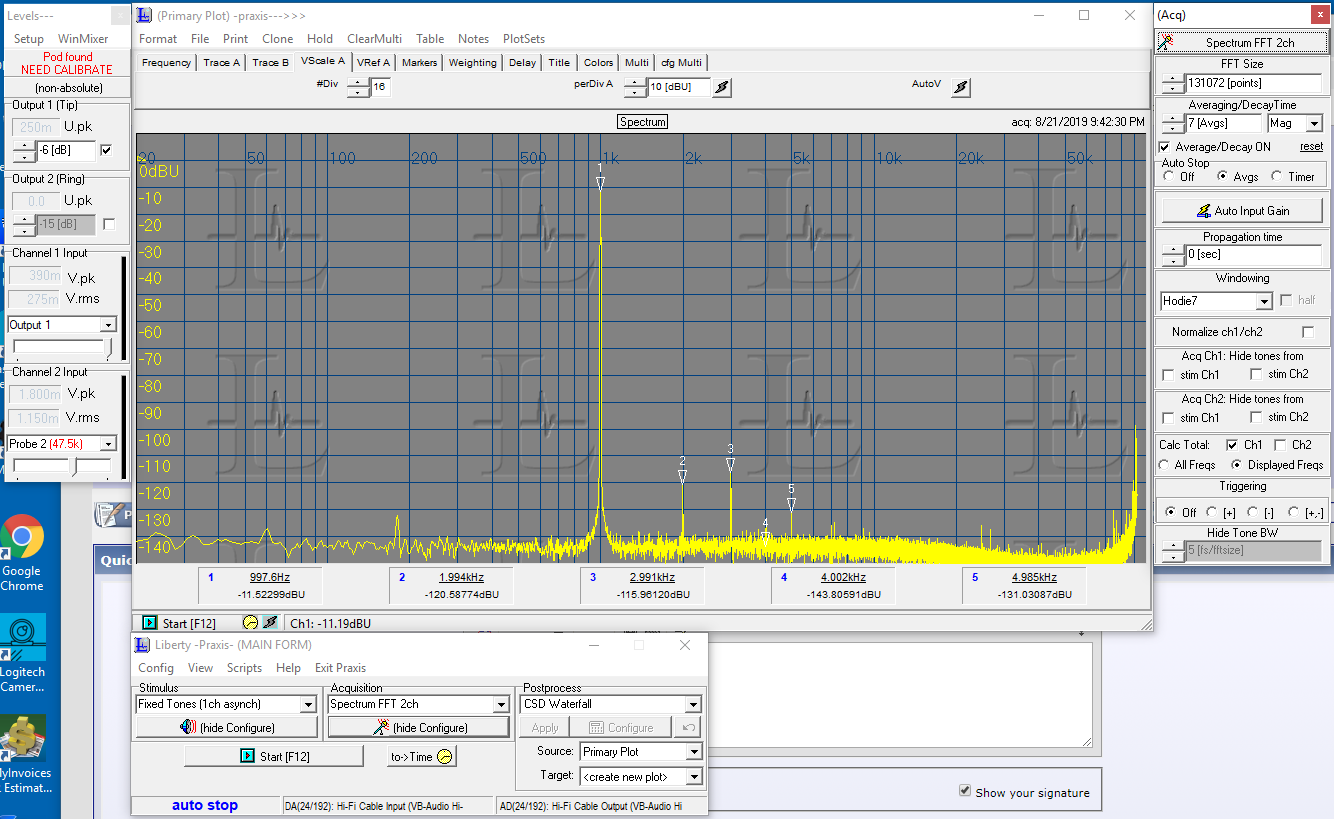

With patience you can often get things to work that shouldn't. Attached is a loopback using Praxis software + VB HIFI cable + QA401 ASIO + QA401.
Praxis is really a windows XP program that happens to work on current Win 10, however it has no ASIO interface. The QA401 has the thrird party ASIO interface that works quite well. The VB cable thing VB-Audio Virtual Apps hooks them together and seems to work OK with all of this. End result is pretty great performance at 192/24.

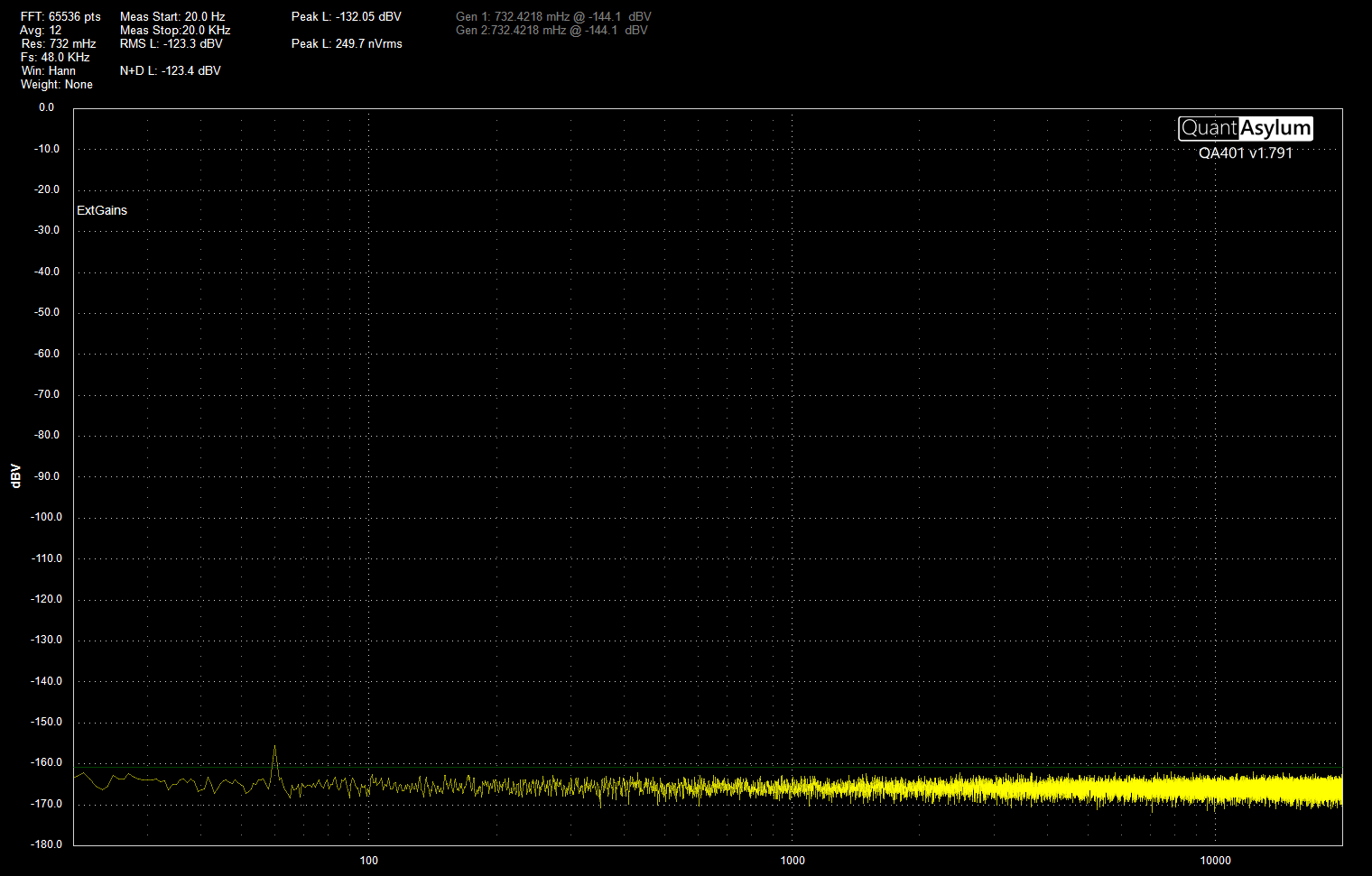

Hello All, Just found you guys here in this thread. Thinking and playing with noise measurement. I did the RMS noise measurement setup as 1Audio articulately spells out in post number 2624. With the QA401 inputs shorted with a 50Ohm BNC cap, RMS noise reads -114.7dBv, no weighting filter applied. With a 30dB gain amplifier attached (think QA470 when it is released) with the input shorted with bare wire RMS noise reads -126.2dBV, a -11~ dBv improvement over the QA401 by its self. With 680Ohms across the input of the 30dB gain amplifier the RMS dBV is reduced to -123.3dBV, 2.9dBv more than with the input shorted with bare wire. As close as I could get to 3dB with the resistors in my bin. The EIN of the QA401 plus 30dB gain amplifier is right in there at 0.469uV on my bench. Thermal Noise Calculator

Excellent work. There is still more to be had given no 1/f corner in your plot.
I'm still waiting for Matt to add root/Hertz noise measurement which makes comparisons much easier. With that I may finally be able to retire my vintage Wavetek FFT plugin.
Hello 1Audio,
Looks like Matt has been busy. Open your QA401 application and click on Ctrl + .dBV. The dBV Options box will open. There is now a rtHz check box. This may be the root/Hertz measurement you were looking for. Matt is now shipping his new QA470 with a 30dB gain low noise amplifier. This is the low noise amplifier that I used for the plot in my post above. In my hand I have a pmillett Opamp experimeters PCB. Ready to solder on the little PCB is a low noise OPA1612 Opamp. This little low noise amp will be a gain of 100 or 40dB's. This project will look a lot like a TI post amp. http://www.ti.com/lit/ug/tidu016/tidu016.pdf
