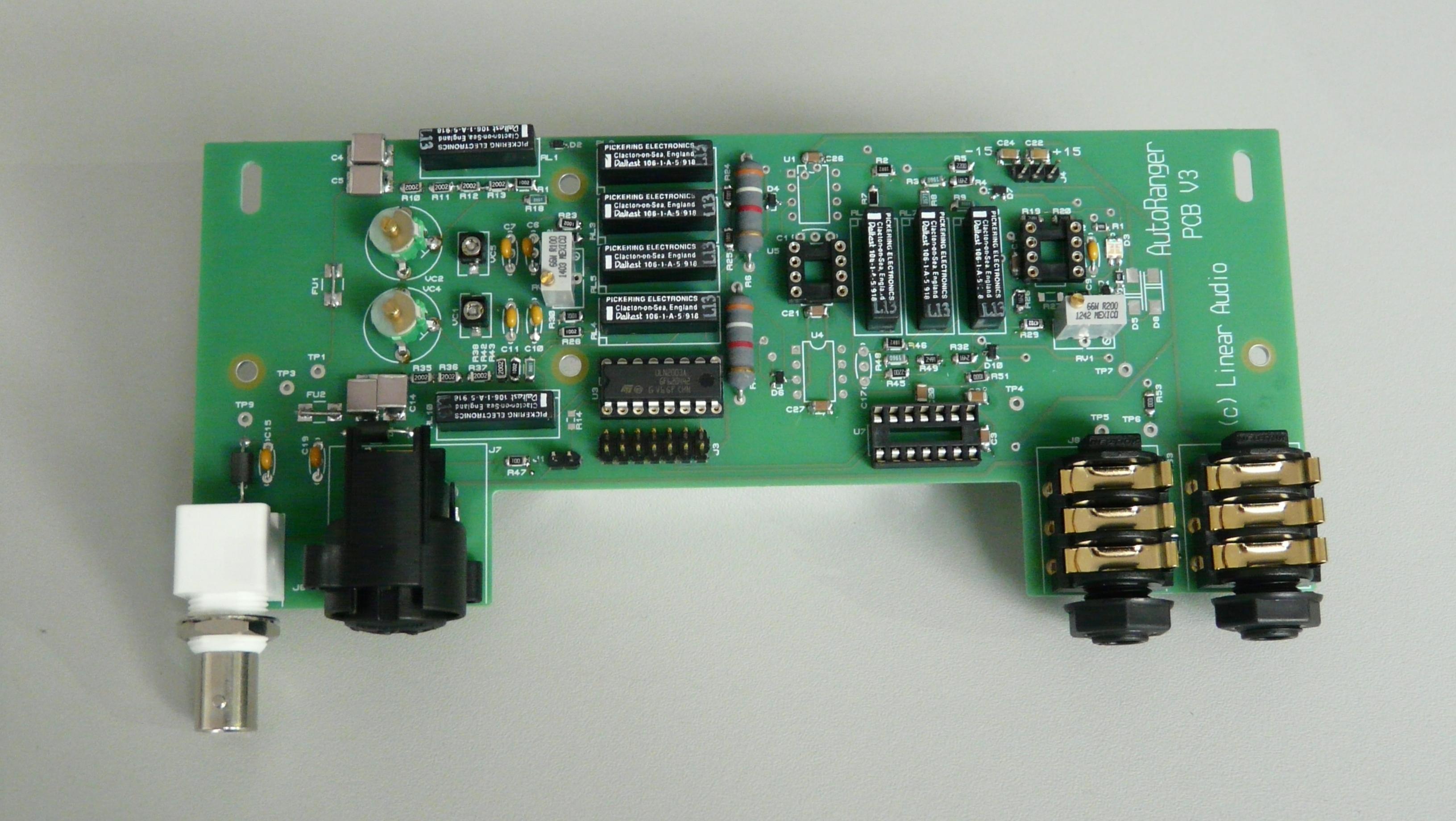

We should move the autoranger into its own thread.
Meanwhile I think the max matches the QA100 pretty well.
I have not checked a couple of AK5394A implementations and the optimim seems to be between -15 dBFS and -20 dBFS. So scaling the autoranger to match seems like a good idea.
I'll be reworking an EMU 1010 analog card this weekend to see if i can maximize its performance. Right now I get -120 dB 2nd and -120 dB 3rd at -18 dBFS. On a selected Emu 1616m I'm get -128 dB 2nd and 3rd so I know more is possible.

How about using the pin to select between two different values of hysteresis? Zero hysteresis and 15% hysteresis, for example.
Then if the input amplitude wanders a few percent AND if, at the same time, it's right at a range switching boundary, the autorange won't oscillate.
Actually, the hysteresis should be more than the minimum gain step which is 4dB, otherwise it will continue to switch up and down.

When I read the question about “threshold” I went off track in the direction of, how low of an input voltage will output “about” 1 Volt. I recall reading on you page somewhere around 0.1 V to 0.15 V. (16 dB gain)
Is there any ability to use that extra pin to increase the AR gain to 40 dB to resolve low level distortion and noise. MerlinB used a 100X preamplifier to study tube noise vs frequency.
DT
It is an interesting idea. There are some implications that have to be considered though. Increasing the gain necessarily also increases distortion and you don't want the AR to become the limiting factor. I will think about it but right off the cuff I'd think an external preamp can be optimised for the task and is probably a better solution.

because this is about the QA400/401 the AR for them gets all the attention. However, it is also most useful with the still popular sound card - like products. Should sell it to those users, also.

Indeed Richard, I'll ask the powers that be to separate out a thread.
Jan
The posts and discussion Jan is referring to are now here:
http://www.diyaudio.com/forums/equipment-tools/299635-autoranger-soundcards.html
