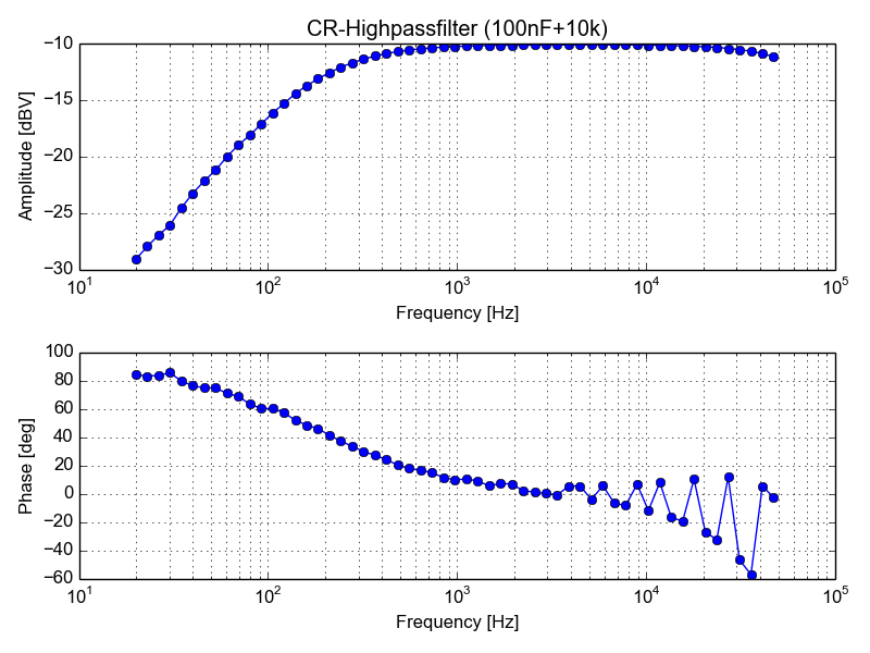

Hello again, the attenuator-project is still ongoing but currently I am quite busy exploring all the features of the QA401. Just now I did a test of the stepped-frequency response plugin. Somehow the phase-information seems to be lost.
Actually, looking at the phase-display in the upper right corner of the qa401-application-window during the sweep, the displayed figures seem to be correct BUT the exported .csv is definitely wrong. See plot below. Has anyone ever tried and got the same results?
The Visual-Studio stuff is still installing (since 3hrs now 😡)... anyways, I attempt to write my own script to overcome this issue.

The magnitude response seems spot on.
Maybe the phase is in radians rather than degrees? Then it would also seem to be OK.

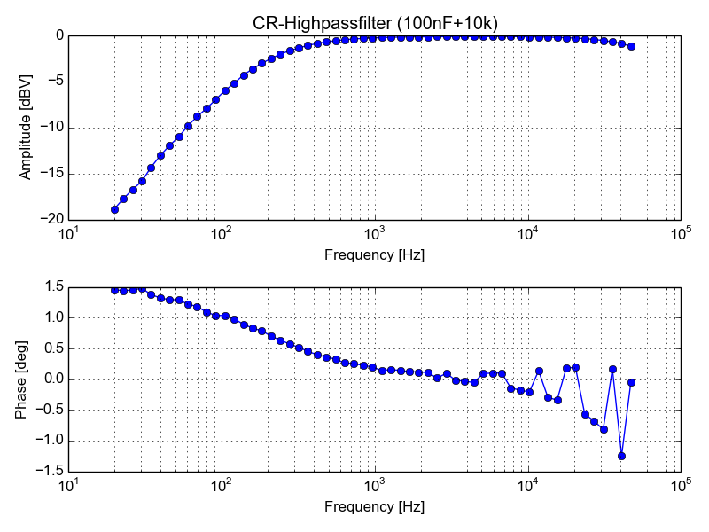

Hello Jan, thanks for the input. I did a second measurement to confirm this behaviour and plotted results with rad->deg transformation. Looks like expected and the 45deg crossing point is around 184Hz, these results look promising but I am still a little bit suspicious.
I guess the huge spread above 10kHz is due to general inaccuracy around 0deg?

Jan you were absolutely right - spot on 😉

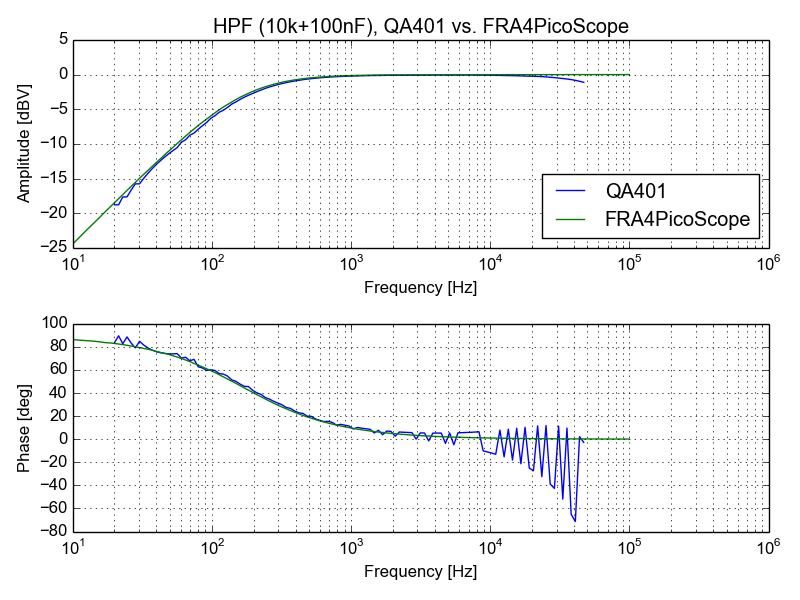

Here is an overlay of two measurements. One is done via QA401 with 0dBV an 10points per octave between 20Hz and 48kHz. The second was captured with the very same circuit, wiring etc. Despite the fact that a PicoScope (15bit resolution) was used with 25points per decade between 10Hz and 100kHz, level was 1V.
