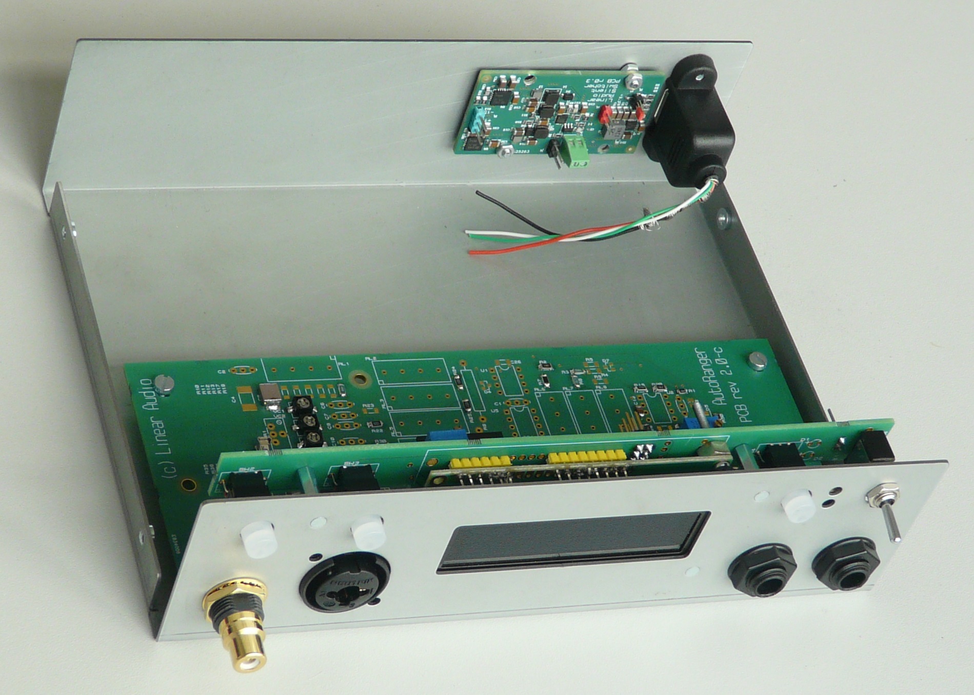

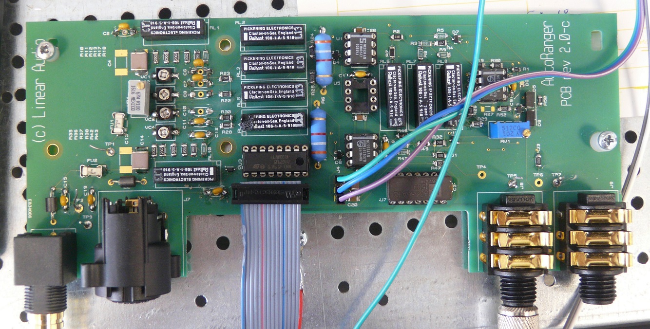

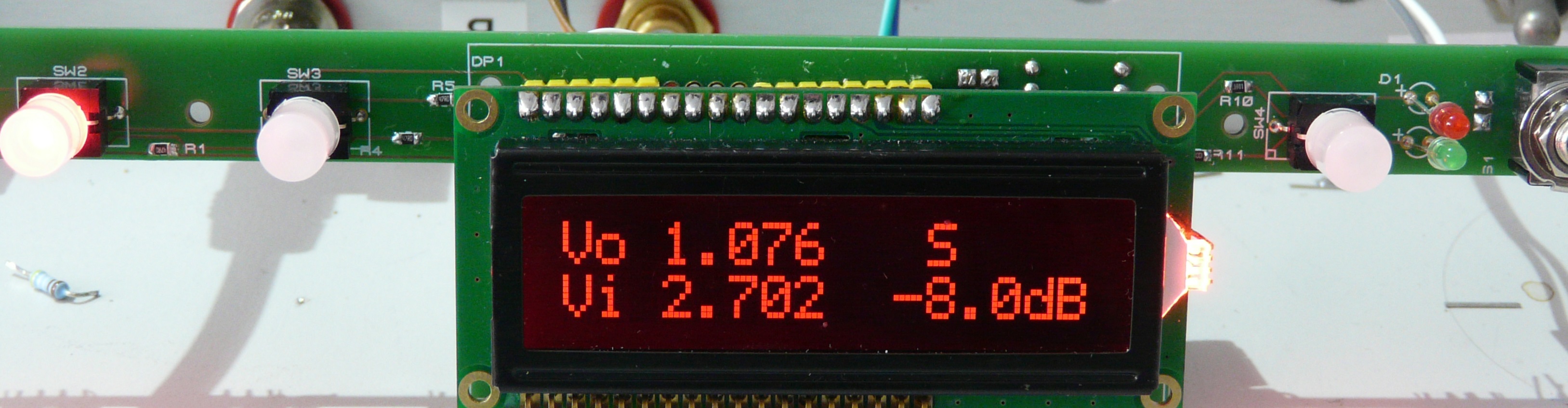

As promised some shots of the autoranger main PCB.
All SMDs are 0805 or 1206. I soldered this with no special tools, just thin solder and a fine iron point.
There's one exception: a few dual protection diodes in 3-pin SOT, see for instance D7 top right. These are a bit smaller but still easy enough for my almost 7 decades old eyes!
This is my testing prototype and the final will be slightly different but not much.
The small control PCB has also some SMDs, plus of course the buttons, on/off switch and display on the front. DIL/header connectors, the DIL28 controller and some TH resistors on the back.
And please, no comments on my soldering proficiency or lack thereof 🙁

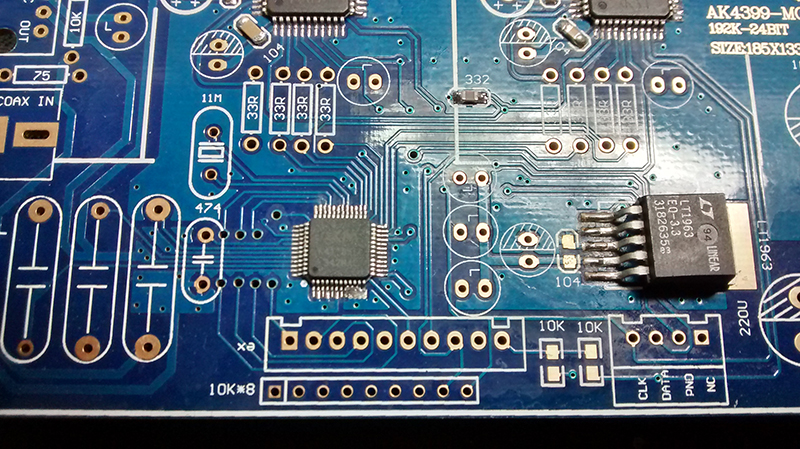

Thanks for the photographs Jan.
I don't see any issues soldering those smd parts, there's not that many and they're not crowded together...
Fwiw, this was my first effort at smd on a parallel dac board from Ebay specifically purchased to ascertain the difficulty of manual smd soldering.
Soldering was done using a Weller WSP-80 pencil with a 1.2mm bent chisel tip, a RS mini fluxer pen and x10 magnification optics. I did initially try a Weller needle tip but found it couldn't deliver enough heat reliably at the point of contact so I went back to the 1.2mm, which I use for most pcb soldering.
Hth and encourages those who haven't been down the manual smd path 😀

Sorry Jan I can't resist.
I thought the soldering was excellent on the sample I got from you.
