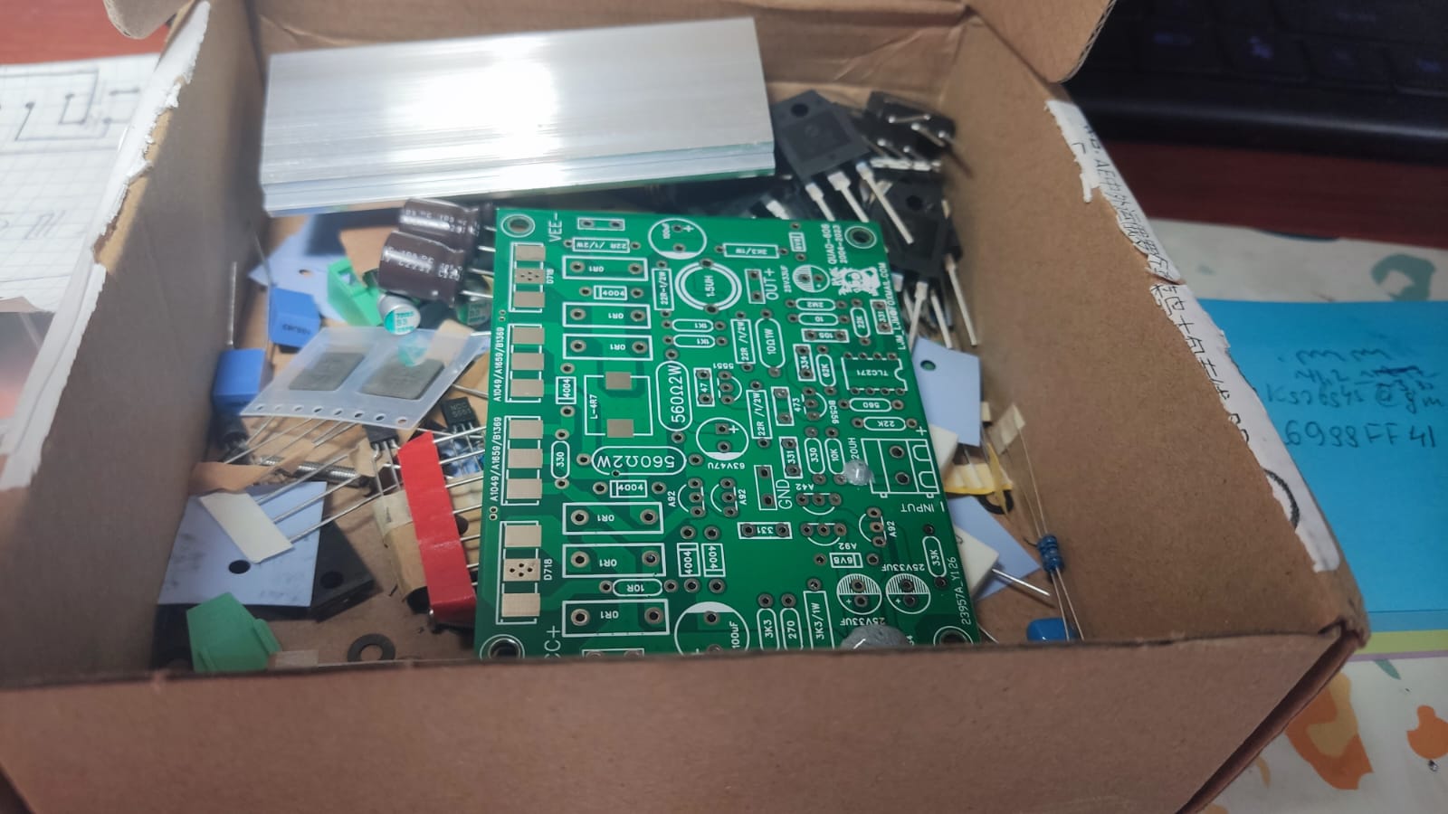

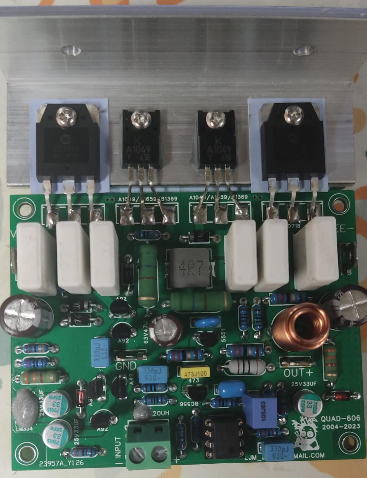

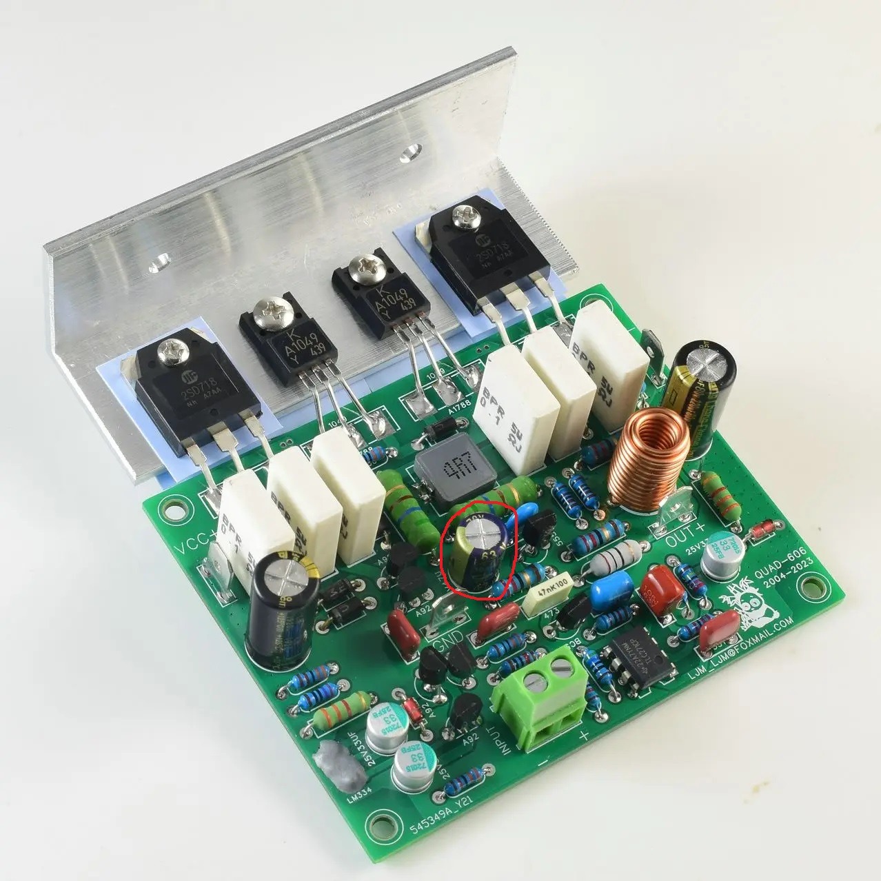

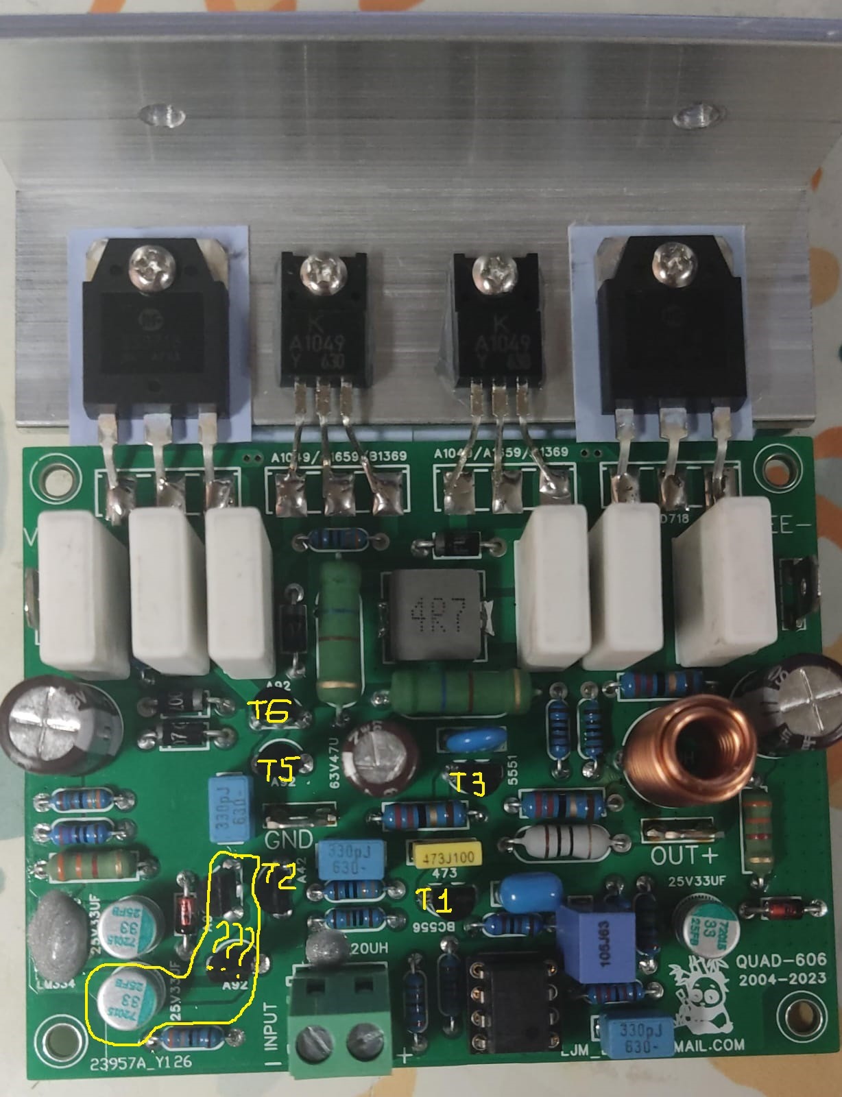

Hello, I decided to buy a set of 606. I had collected a couple of 707 before, everything was fine. But 606 doesn't work as it should. The constant output voltage in one channel is 31 mV, in the other 190 mV. The frequency response is overwhelmed from 8 kHz. Huge noise and distortion.

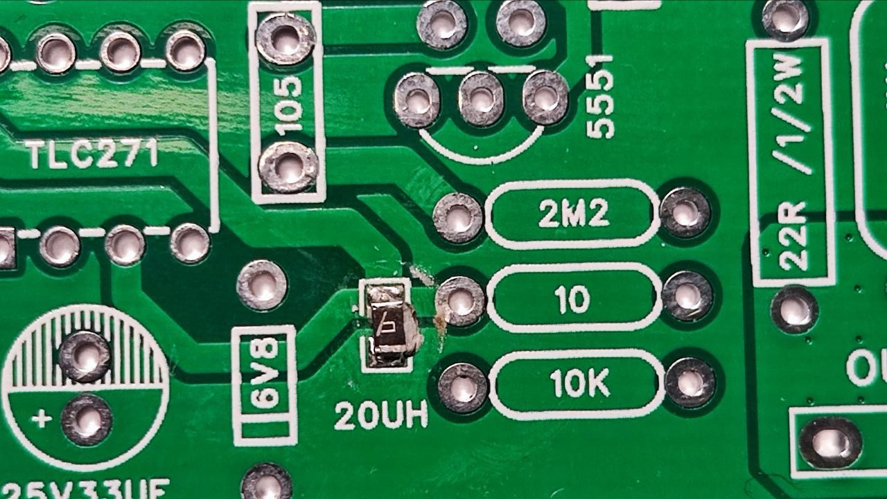

I always check all the details before installation. But I decided to double-check with a multimeter that all resistors were installed correctly. And the 2M2 resistor showed a resistance of about 500K. The resistance leakage turned out to be due to the 1.0 uF capacitor. Perhaps I haven't found everything yet. I don't think all kits are like this. I bought two sets of QUAD 707 from different sellers and everything was fine. And the operational amplifier looked different from the ones I bought earlier and there was corrosion on the legs. I just replaced it with the Lm301 that I had.

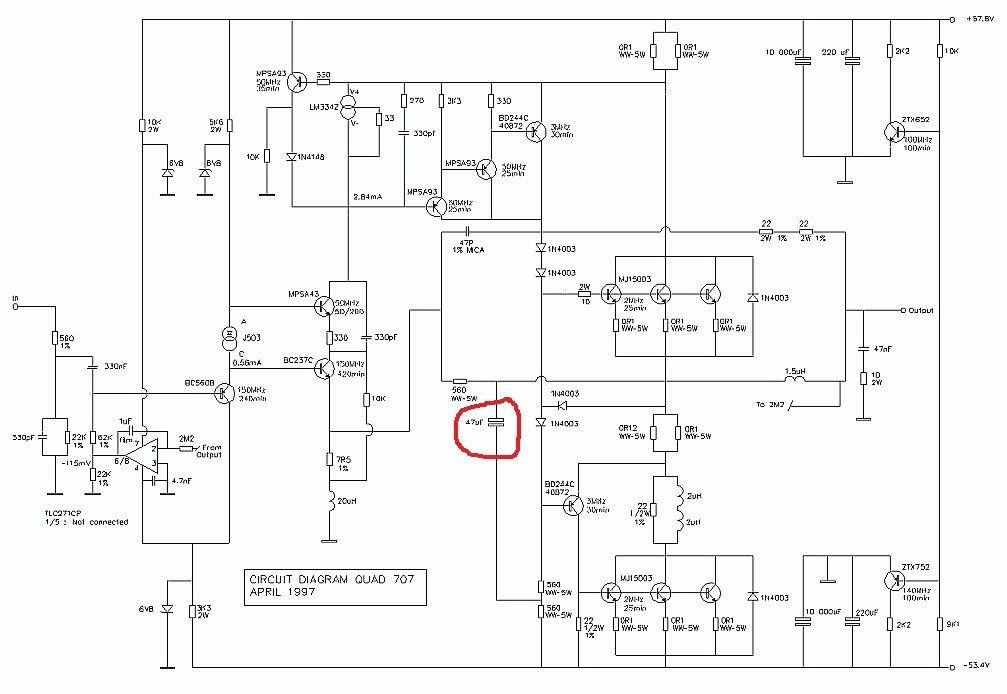

This is wrong. Where can I find the actual schematic for which this board is made? The board doesn't work and without a real circuit it's hard to fix it!
I don't think the 1UF capacitor is damaged. Because it is a CBB capacitor.
I think it's possible that the 25V33UF capacitor is damaged. It is an OSCON capacitor produced by Samwha capacitors in South Korea
But I once discovered a 25V33UF samwha OSCON capacitor with a short circuit. Replacing it with a 25V22 or 35V47UF ordinary electrolytic capacitor can solve the problem.
A diode is a constant current diode. Also known as a steady current diode. Place the circuit in a fixed current state of 1.5MA.
Can replace 2SJ503 and LM334. Diodes can also be omitted. The use of IC has the same effect as JFET.
So it cannot be replaced. Be careful to protect. So I applied glue to avoid collision damage.
Fourthly, I believe that the operational amplifier TL271 cannot be damaged. It is a genuine product produced by Texas Instruments.
It is recommended not to replace with LM301 or other operational amplifiers. Although operational amplifiers are universal. But the effect will vary.

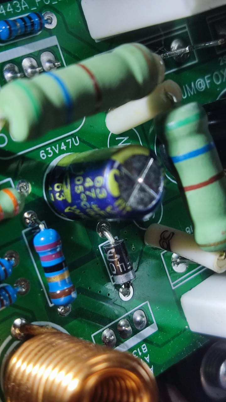

Hi! I soldered 2 pairs of QUAD 707 and a pair of QUAD 606 and on all copies the voltage boost capacitor gets very hot. The temperature on the fingers feels about 50-60 degrees Celsius. I insulated this capacitor with a thick piece of mica to eliminate their heating from the 560 ohm resistors, but this did not help. This is not useful for electrolytic capacitors. It is unknown how long they will work with such heating.

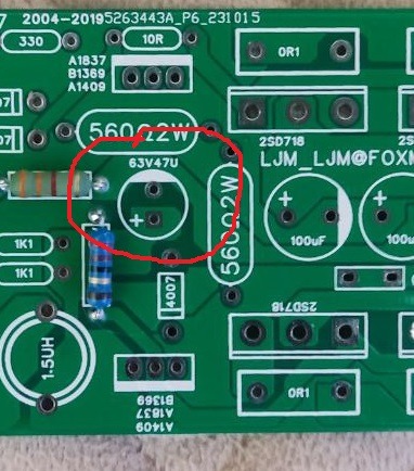

Please check the voltage rating of the capacitor and the correct orientation.
Naturally, everything is correct there with the location and parameters of all 6 capacitors on all six boards. I used supply voltage from different DC sources, transformer and pulse from +- 2x36V to 2x45V. Not difference. Perhaps no one paid attention to this heat on their boards.
There is no reason for the bootstrap capacitor to run hot unless it is under-rated or reverse-polarized. It should be 47uF 63V with the polarity as shown in the 707 schematic.
I’m answering for the second time, maybe my English is so bad. The capacitors are strictly in accordance with the QUAD707 circuit and has the nominal value is 47.0 μF 63V. I put a thick piece of mica for thermal insulation from the 560 ohm resistor

When does the capacitor gets hot? With or without signal?
Whith signal, the bootstrap capacitor is subject to ripple current and has to be choosen according to this ripple current. So no fancy boutique part here but sturdy smoothing cap type (choose a low ESR type whit a ripple current twice the DC current trough the 560 ohm resistors over the entire audio frequency range).
If it gets hot whitout signal, then it is either heated by the resistors, reverse biased or underrated voltage-vise. Or the amp is oscillating, which puts you in the first case.
