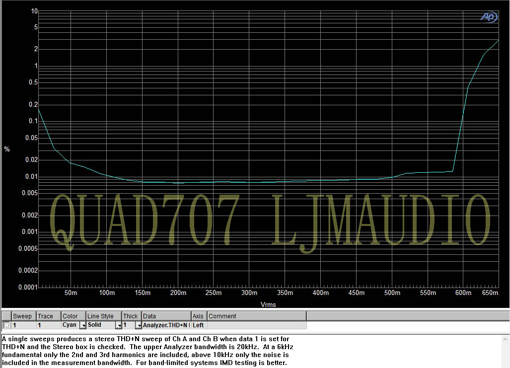

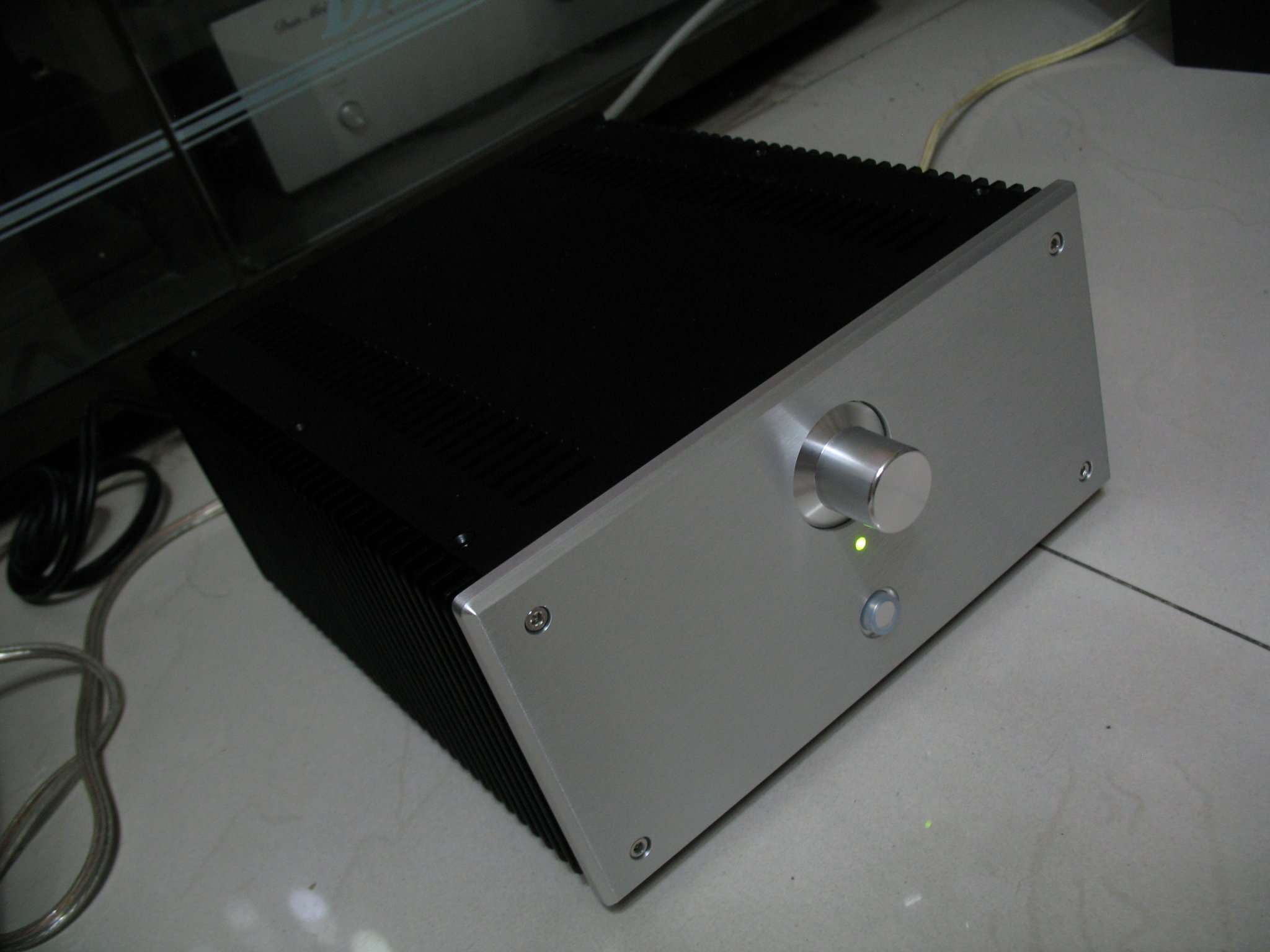

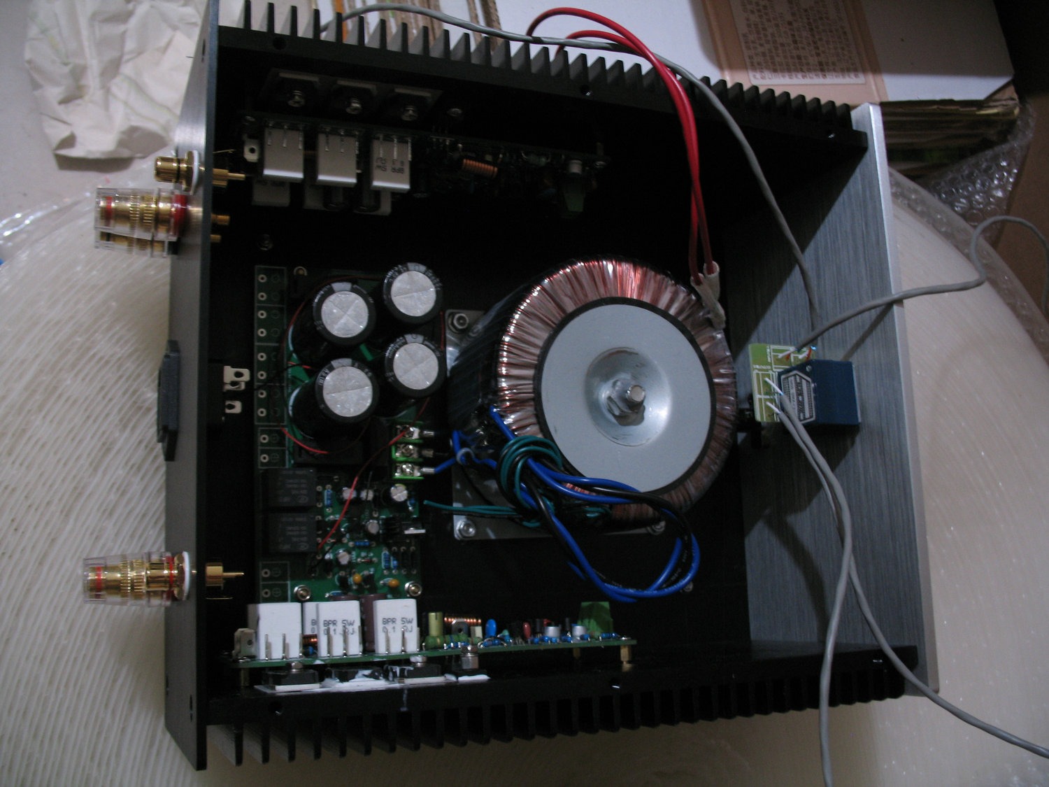

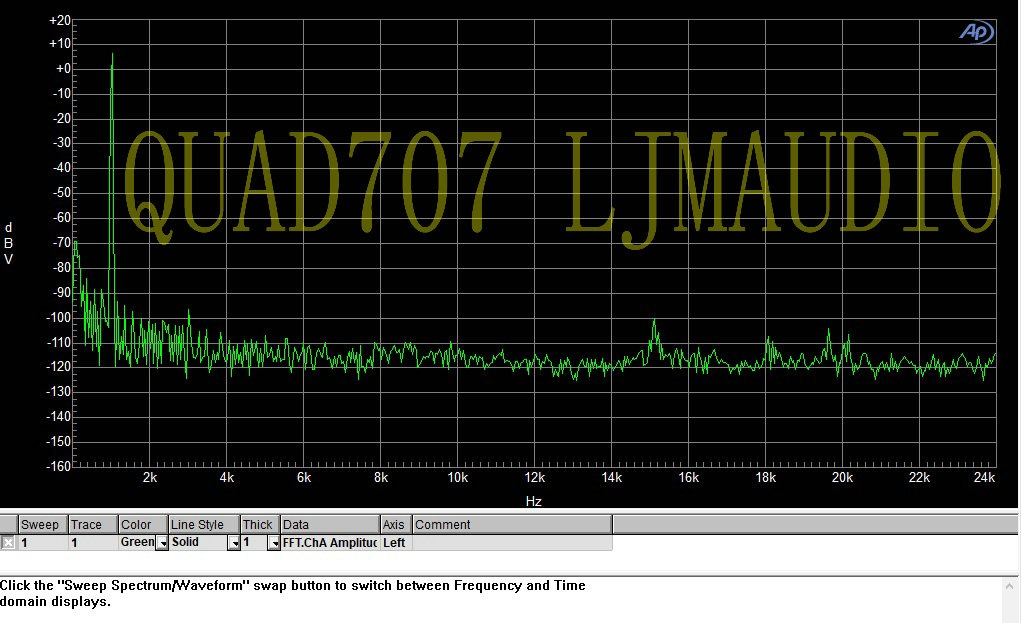

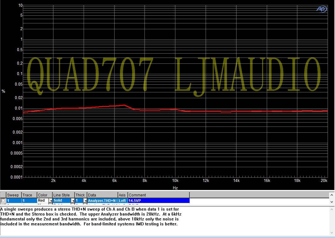

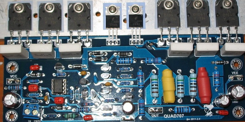

This is an amplifier I made a long time ago
But due to the parts at that time not meeting the specifications. I made it around 2012.
But the test results were very poor. So I have been improving it.
I have recently obtained some very good transistors. The test results in the new version make me feel very good.
It has almost the same performance indicators as the machines produced by QUAD's original factory.
So I'm going to take the time to assemble it and listen to it myself. I will update the assembly steps.

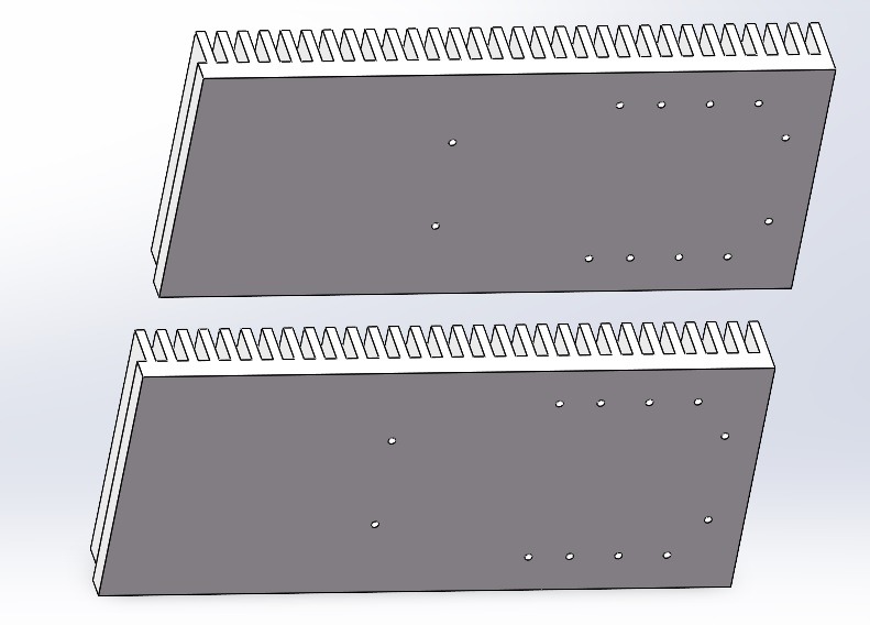

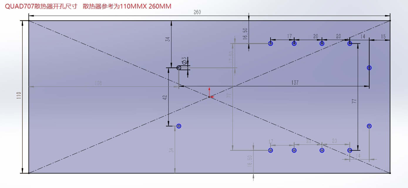

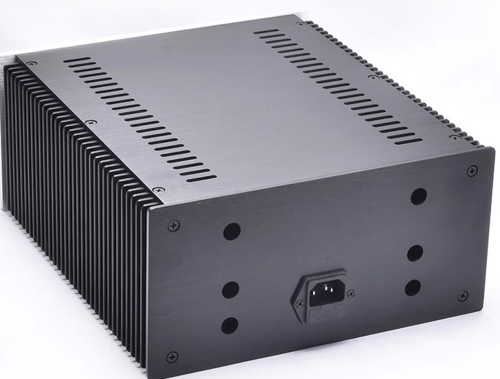

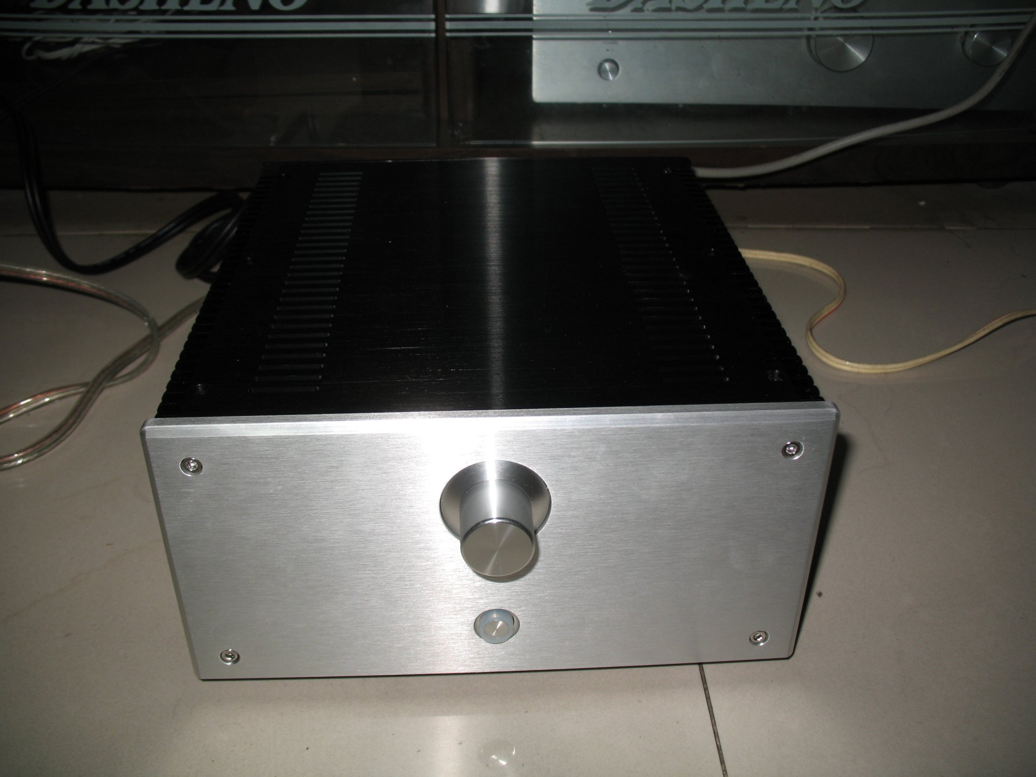

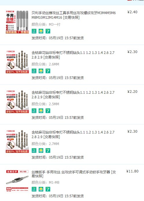

This is the chassis I purchased on Taobao
About 38 dollars

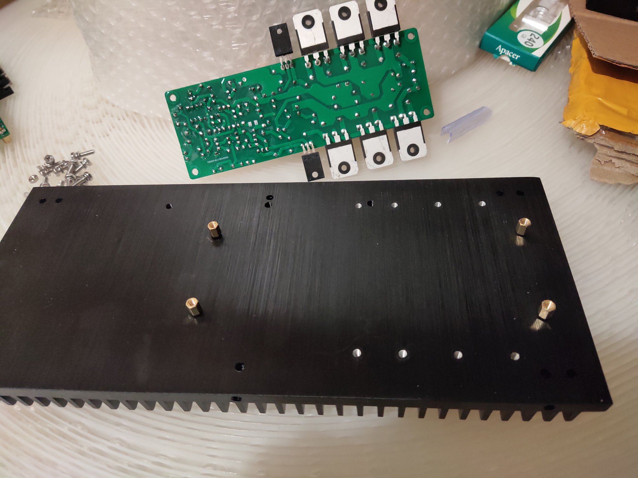

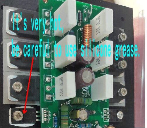

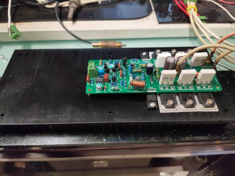

I use software to draw a fixed installation hole for the power tube.
I don't know how to make holes myself. That screw hole is too troublesome.
I will have the chassis manufacturer drill the screw holes.
About 38 dollars
Chassis punch will easily make holes larger than 12mm (0.5 inch) after drilling a small hole.
https://www.harborfreight.com/knockout-punch-kit-10-piece-60575.html
I purchased a 2.6MM drill bit. I have a fixed drilling platform. I made a hole.Chassis punch will easily make holes larger than 12mm (0.5 inch) after drilling a small hole.
Then use the M3 tapping head manually. But it takes too much effort. Then I used a 2.7MM drill bit.
be prone to.
But the screws cannot be tightened. I thought for a moment. Still spent an extra $4. Let the seller of the chassis help me with these tasks.

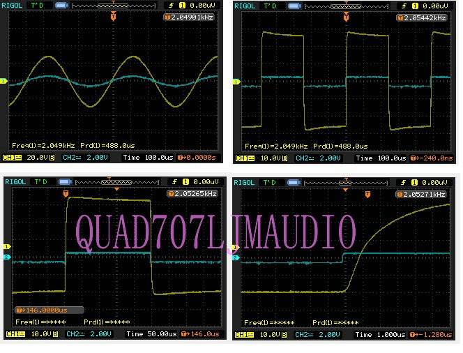

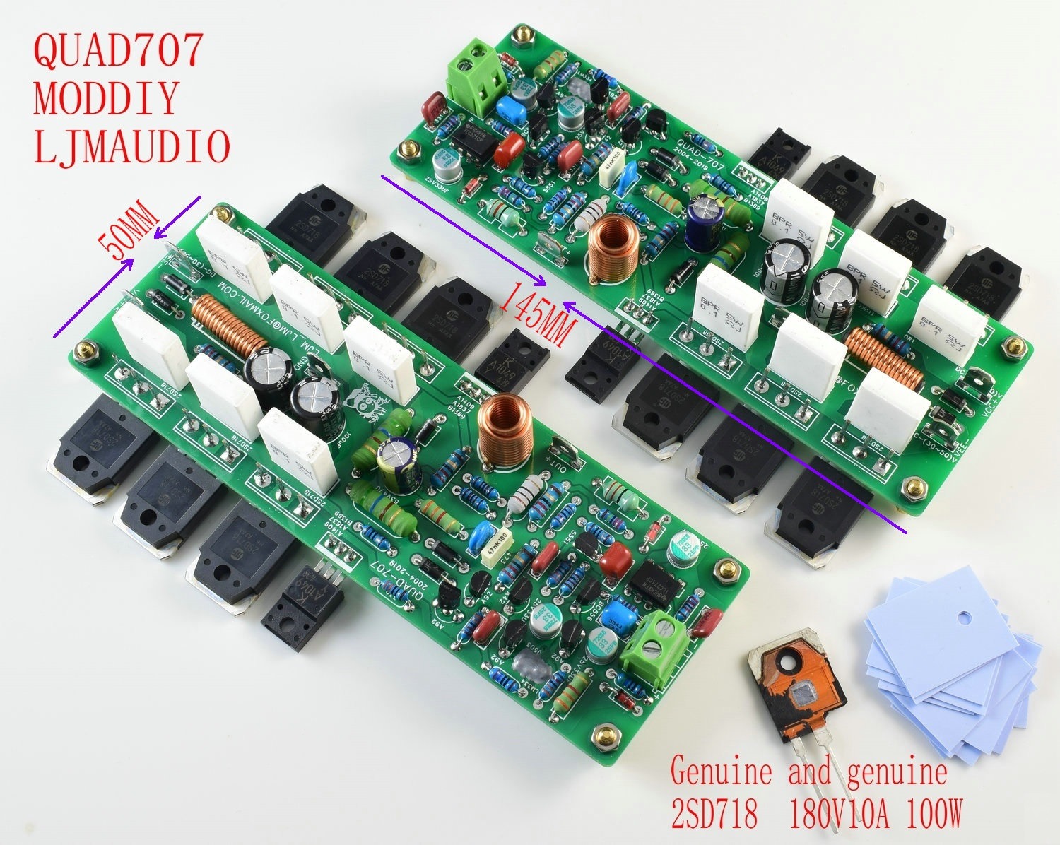

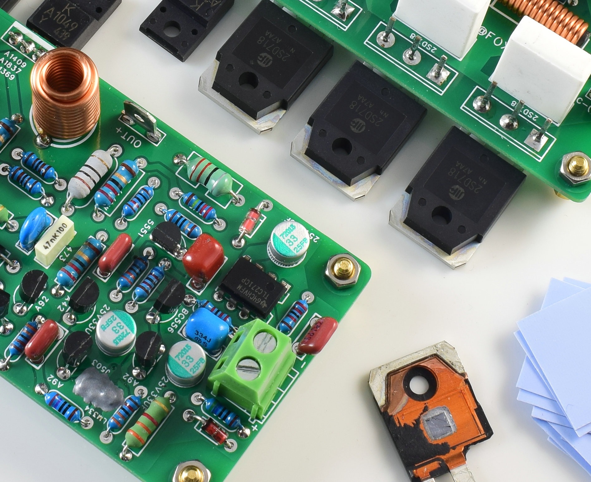

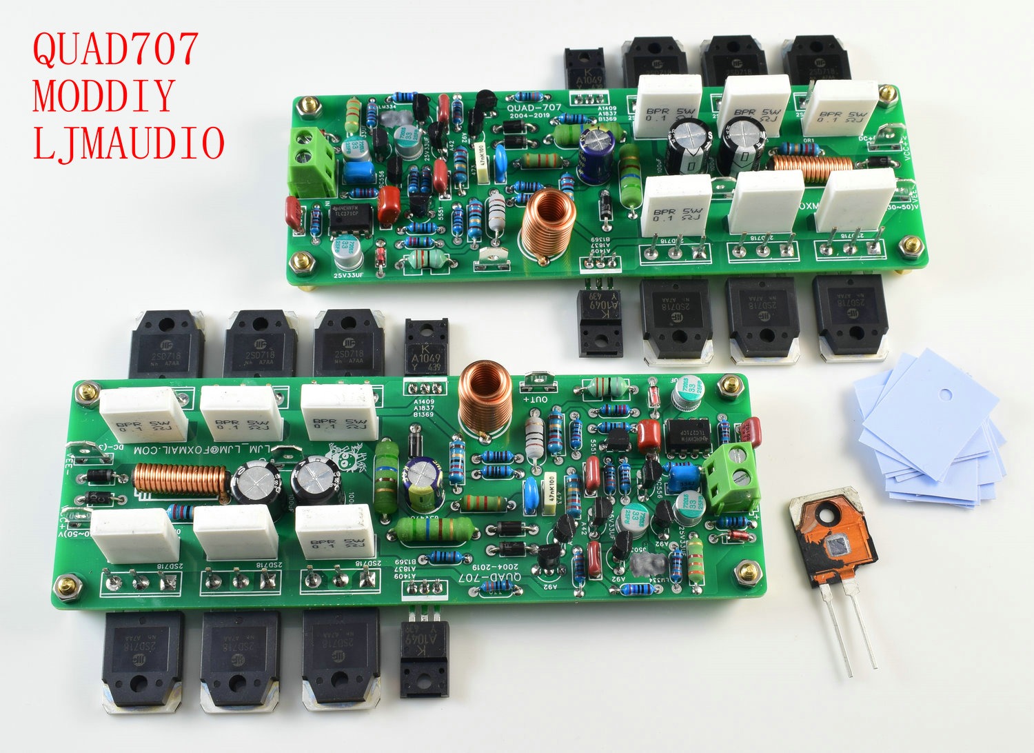

Compared to QUAD405, QUAD707 has a very significant change. Mainly for improvement.
Measure QUAD707 SR=25V/US using an oscilloscope.
QUAD405 SR=4V/US. Although it does not represent good or bad. But it is obvious that the changes in QUAD707 are significant.
Additionally, QUAD707 is high-frequency. Low frequency. The attenuation rate is smaller. It retains its beautiful sound while also preserving it.
It has significantly improved performance. It was born around 1995.
I don't know what you mean by 'high-frequency. low frequency', but all Quad amplifiers have had similar frequency response since about 1943.
The lover SR of the 405 is given by the RC low-pass between the op amp and the transistor stages. So, on should compare only the SR of the transistor stages.Measure QUAD707 SR=25V/US using an oscilloscope.
QUAD405 SR=4V/US.

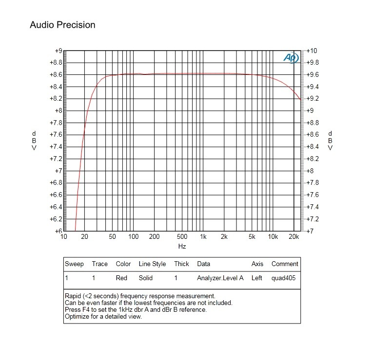

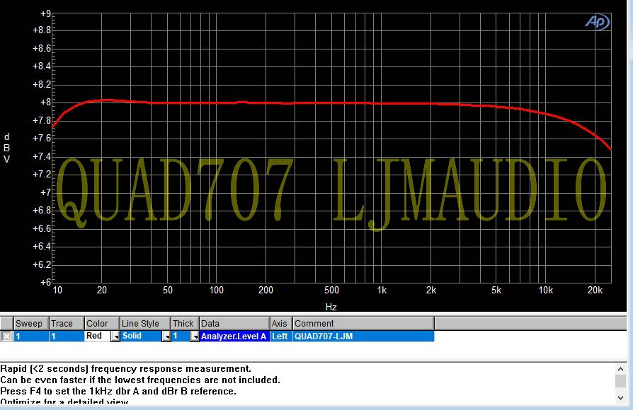

There is a frequency response test chart for APSYS above. You can take a look. Compare QUA405 with QUAD707. The difference is many times greater. Mainly 20-200HZ,I don't know what you mean by 'high-frequency. low frequency', but all Quad amplifiers have had similar frequency response since about 1943.
QUAD707 20HZ -0DB。 20000HZ - 0.4DB
QUAD405 20HZ -1 DB, 20000HZ -0.4DB。
In addition, QUAD 707 SR is 6 times higher than 405. So its high-frequency details are more abundant.
This is wrong. QUAD405 regardless of the use of any transistor output. His SR is the same. You can use an oscilloscope for measurement. SR is mainly determined by GAIN without feedback. So it can be concluded that the QUAD 707 GAIN is higher than 405 6 times. This is determined by its GAIN. It will not change due to different transistor models.The lover SR of the 405 is given by the RC low-pass between the op amp and the transistor stages. So, on should compare only the SR of the transistor stages.

The difference is -1dB which is a factor of 0.89. This is not 'many times'. This is a minor adjustment to the LF pole.The difference is many times greater.
This is not the most important thing. QUAD707 SR is 6 times higher than 405.
So its speed is very fast. It sounds like the dynamic difference is very obvious.
Additionally, 1DB is already very large. There is a 30% difference.
From a DIY perspective. The cost of QUAD707 is almost the same as that of 405.
707 uses 6 output transistors. Better driving performance.
Of course, the 707 may be wider. I can do more miniaturized QUAD707 or QUAD606 in the future, which can replace QUAD405。

No it isn't. It is a factor of 0.89 down or 1.12 up. Do the sums. It is barely audible to an expert listener. 30% is 2.28.1DB is already very large. There is a 30% difference.
Your slew rate calculation is therefore suspect as well.

SR is not calculated using. Many people here should understand.No it isn't. It is a factor of 0.89 down or 1.12 up. Do the sums. It is barely audible to an expert listener. 30% is 2.28.
It can be seen with the eyes. Because the oscilloscope has already displayed SR 25V/US
If you don't quite understand.
Actually, you can search for the official document data of QUAD707.
Of course, there is also data on QUAD405.
This amplifier was not designed by me. Its data is written by QUAD company.
I'm just measuring. And verify it.
The results are indeed the same as the nominal data of QUAD company. So QUAD's data was not falsified.
QUAD405 SR=4V/US
QUAD707 SR=25V/US
