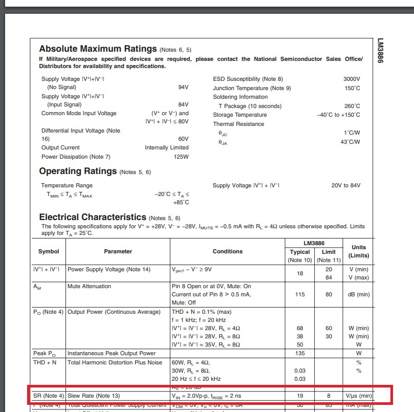

SR..SR......Please explain what your alleged slew-rate graphs are intended to exhibit. The Quad 405's slew rate is already adequate to 1MHz.
BTW your claimed 30% difference at 20Hz evaporates to 3% in terms of perceived loudness. This does not inspire confidence.
Do you know what SR means.

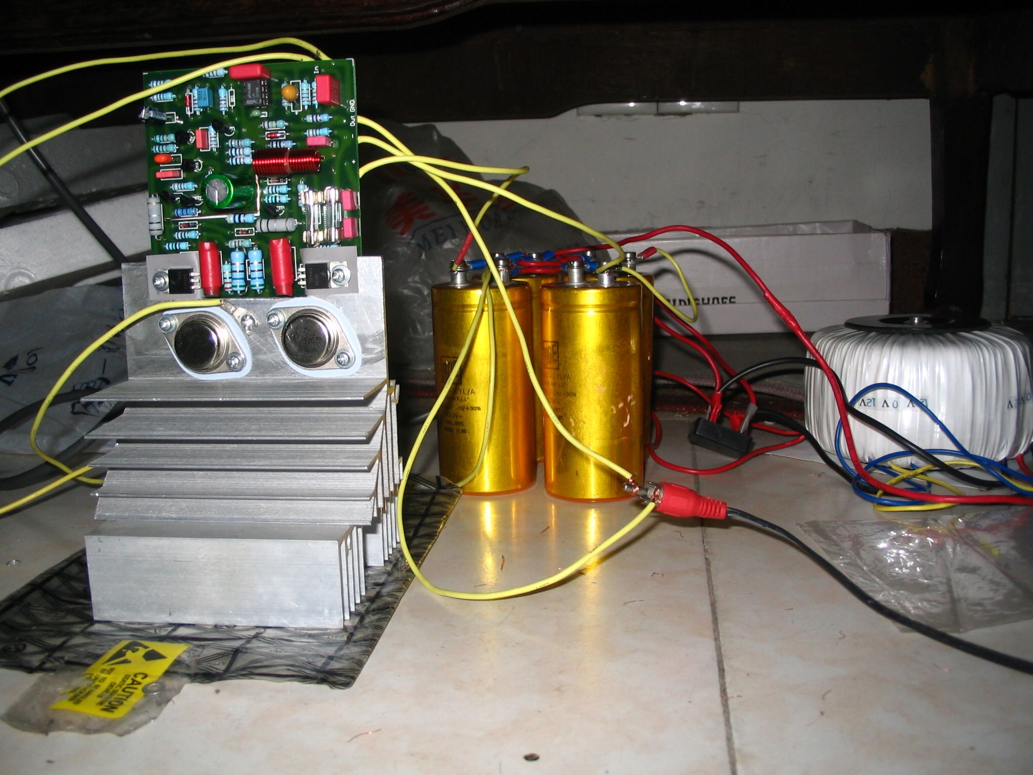

I am very familiar with QUAD405.Hi,

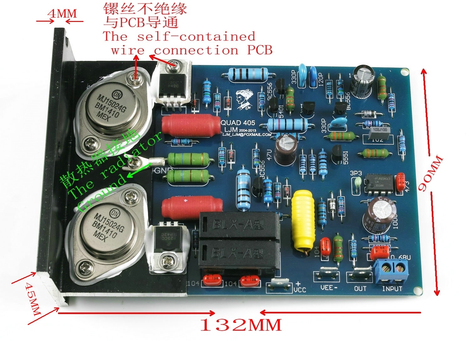

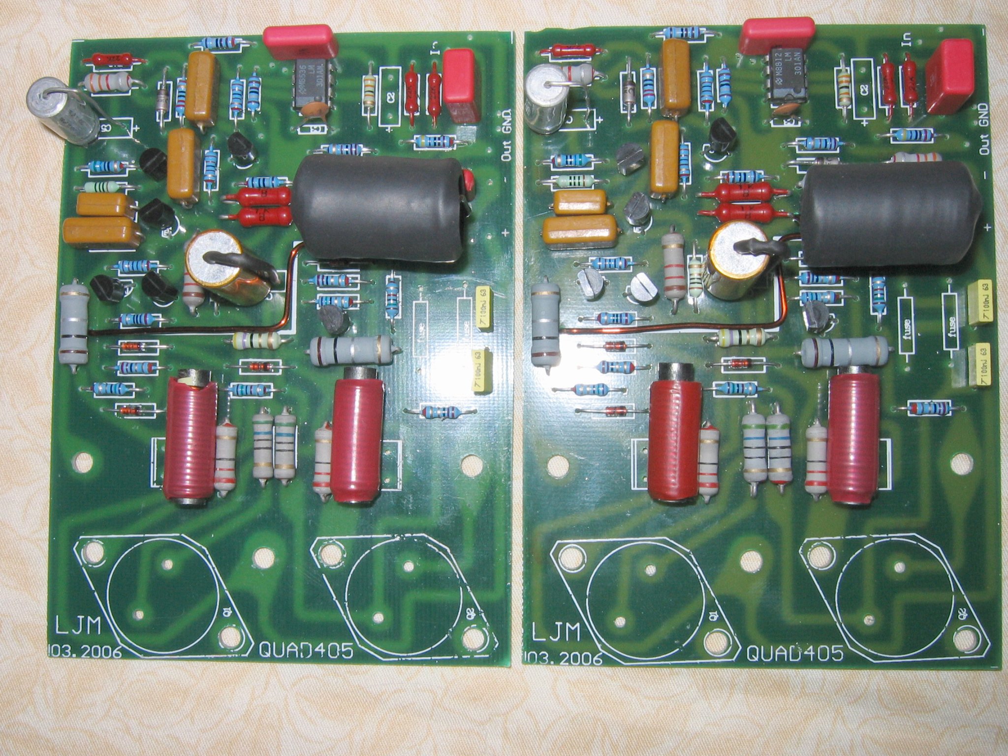

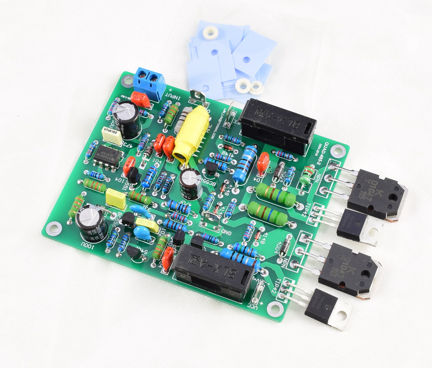

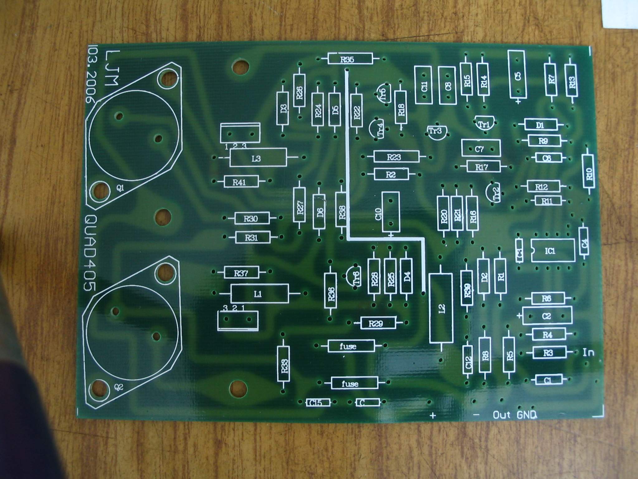

Because I may have sold 80% of the QUAD405 for DIY.
It is also a good amplifier. I have been making QUAD405 since 2006
From my research, I found that QUAD606707909 is basically the same.
And QUAD405 and 405-2 are basically the same.
Take QUAD707 as a reference. It has a significant difference compared to QUAD405.
It is more like a modern mainstream amplifier. And QUAD405 is more like an old-fashioned amplifier.
Although their structures are very similar. But performance indicators. There is a significant difference from the effect. It can be said that it sounds completely different.

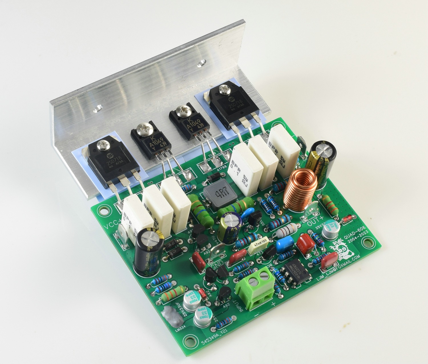

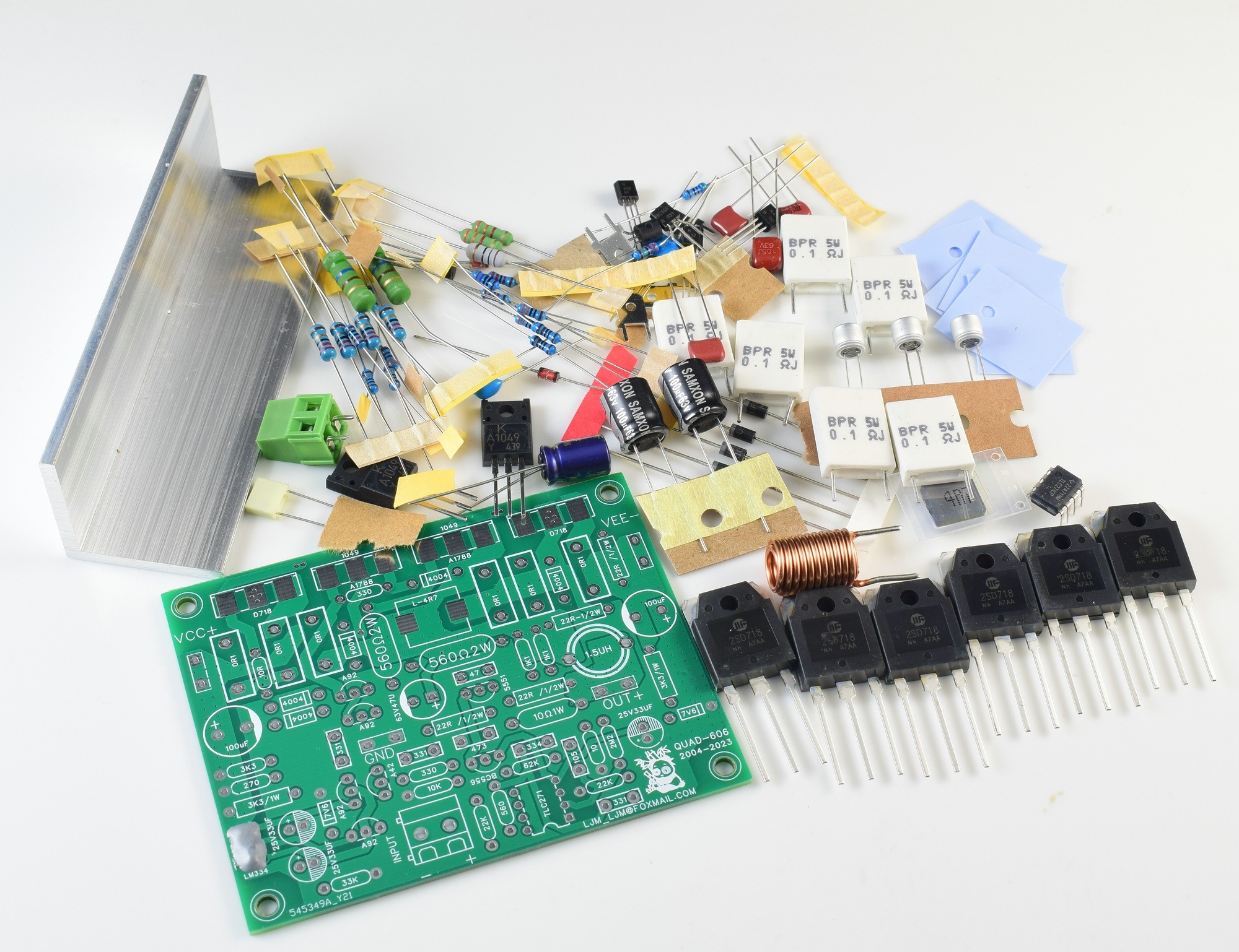

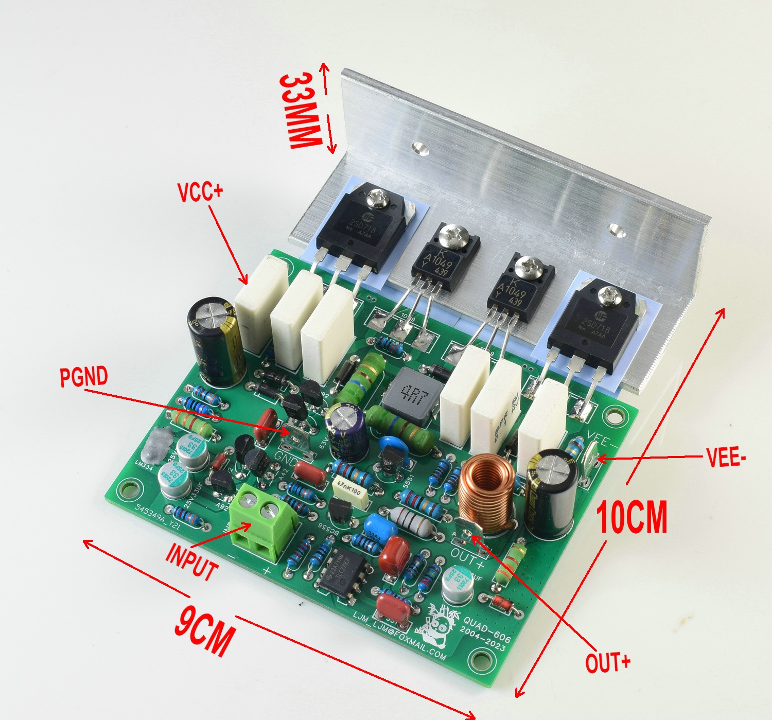

I have redesigned QUAD606. It is almost identical to QUAD707.
Looks great! Looking forward to buy it at Aliexpress / Aiyima Technology store. Let us know when it will be available to buy.I have redesigned QUAD606
There is sales. It's very cheap. All components have excellent quality.Looks great! Looking forward to buy it at Aliexpress / Aiyima Technology store. Let us know when it will be available to buy.
They are all genuine parts.
The price of mono is approximately $7. You need to assemble it yourself.

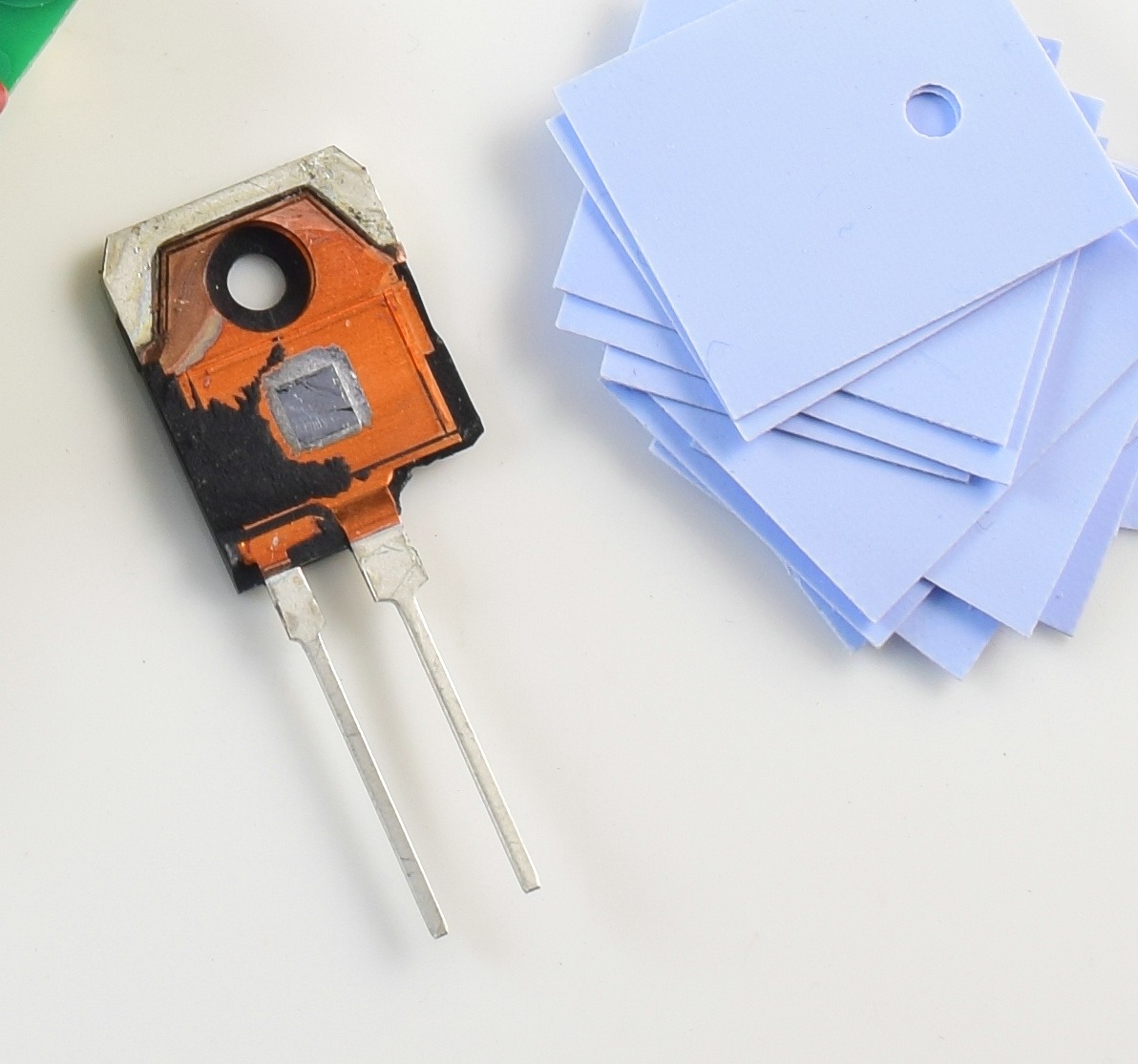

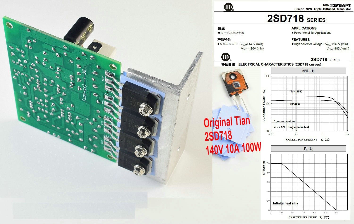

2SD718 is very good. And it is guaranteed to be genuine.LJM, are you alright?

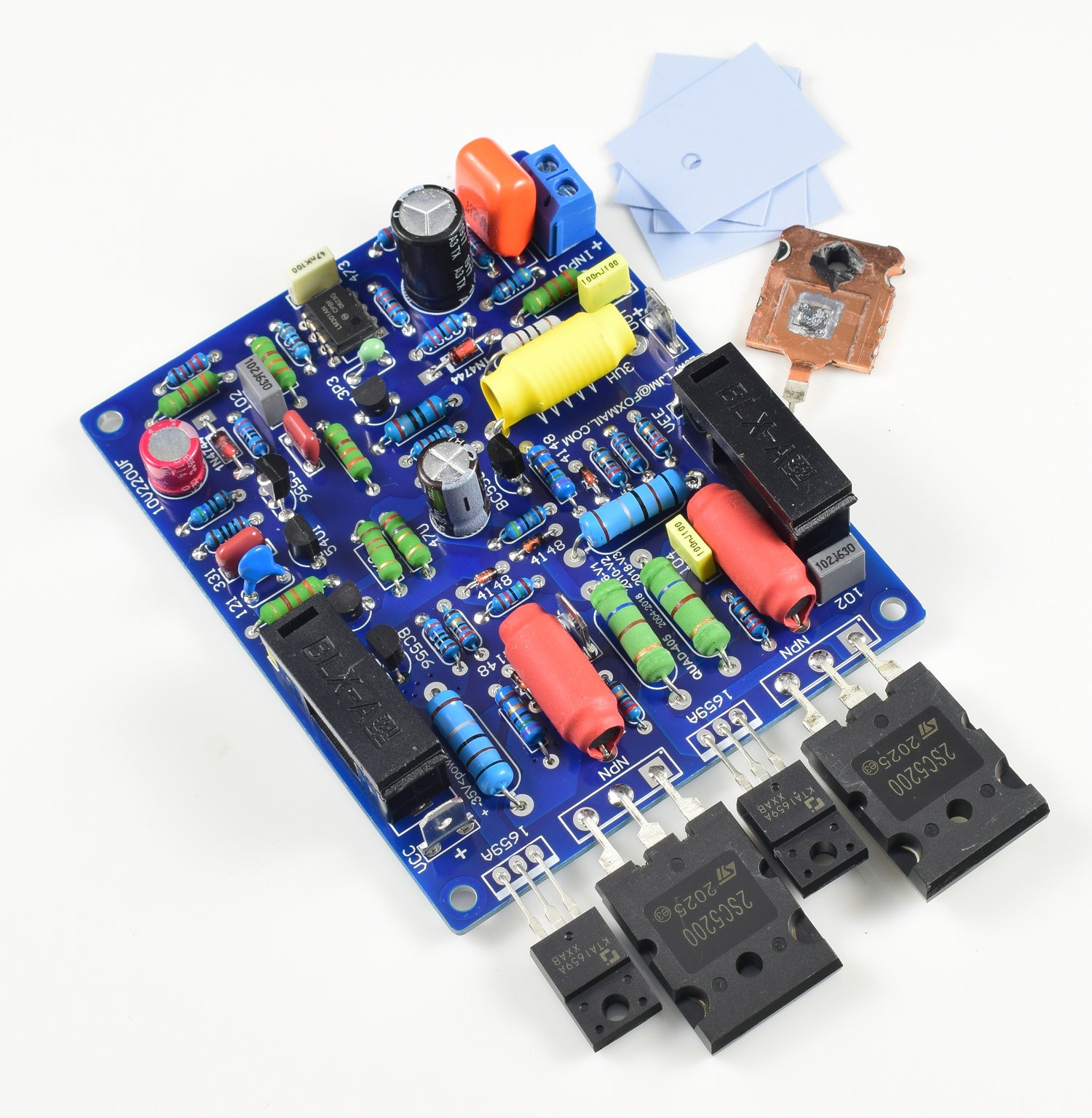

Can the 2SC718 be replaced by the 2SC5200 without damage?
There are many counterfeit goods in China for 2SC 5200. 80% is fake. It doesn't make much sense.
Of course. If you happen to have 2SC5200. It can also be replaced.
In fact. The output transistor is not important. It does not affect performance. Driving transistors is more important, which is KTA1049. I use KEC original products. It is very important. Cannot be replaced.
Thanks LJM.2SD718 is very good. And it is guaranteed to be genuine.
So I'll keep the 2SD718.

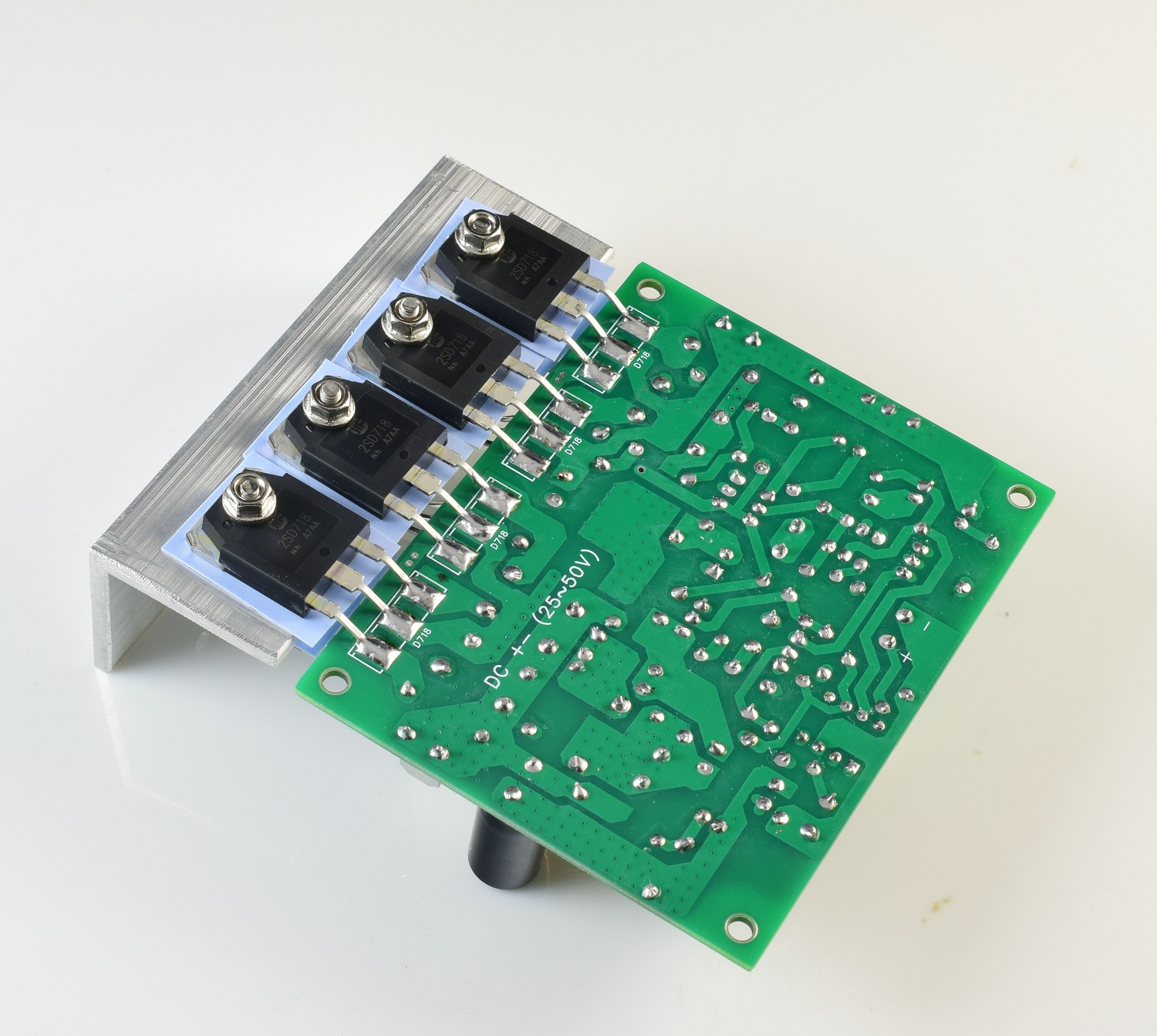

Can I use a +50/-50VDC supply normally?
There is no problem with +-50V DC. Please note that KTA1049 has a high fever. Silicone grease is required.Thanks LJM.

Is 63V symmetrical too much for this amplifier?

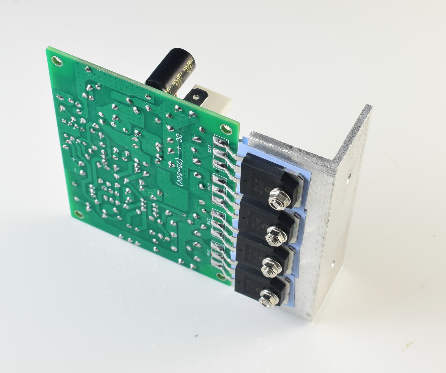

Optimizing the Quad 707 bridge
If you purchased the 707 kit, you can optimize the compensation Quad (Wheatstone/Maxwell) bridge by replacing the two presoldered parallel 1k resistors, with two resistors of 1k2 (1%) for the optimal balance.
Clarades: you cannot not apply a symmetrical 63V, see the KA1049 specs.

I will build in a dual mono configuration with a symmetrical 46VDC power supply for each Quad. So it will stay within the safety margin.
Out of curiosity, what would be the total voltage limit of this amplifier?
In the original electrical scheme we have something close to +/- 54VDC.
