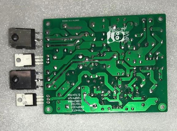

I have see on eBay and Aliexpress a new 405 clone board. They claim to be a 405-2 version. Seems to be a new designed PCB with better tracks and grounds.
Does someone know this new version?

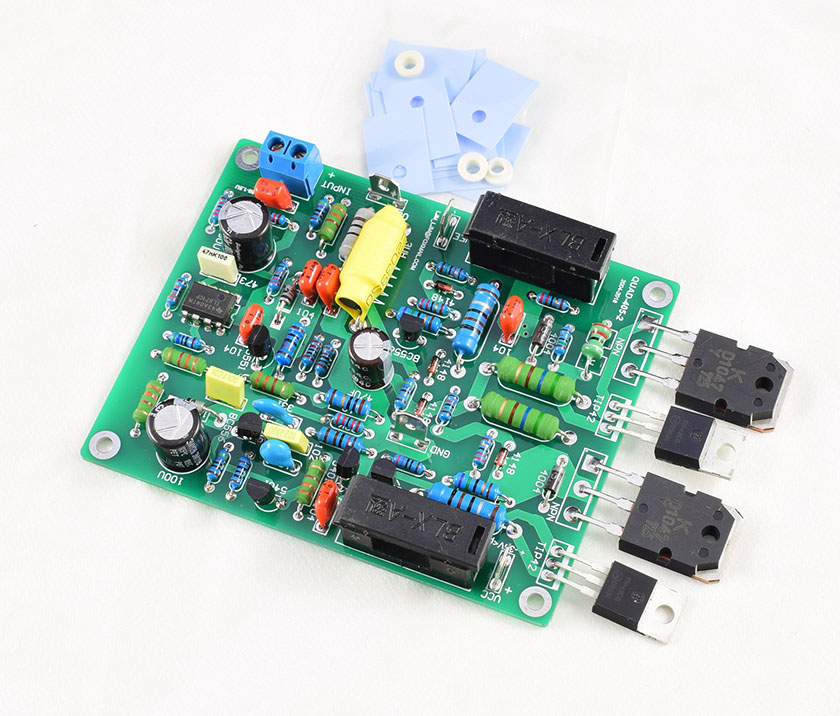

Hi!

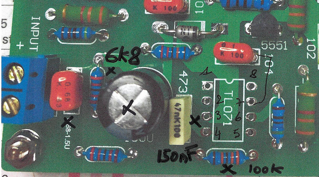

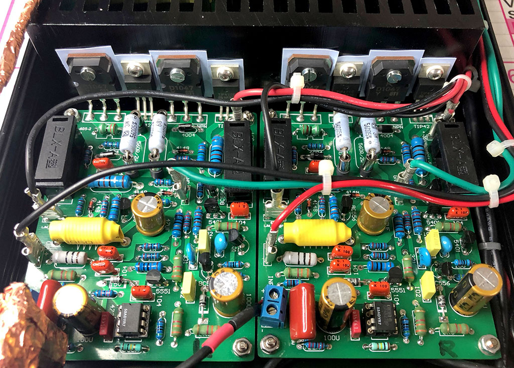

Just to write a little about the Chinese kits I finally assembled and modded.
The kits works fine but the input stage need to be adapted for modern equipment. It stay with 0.7V sensibility from original design.
3 components needed to be changed for 1.5V sensibility. See pictures.

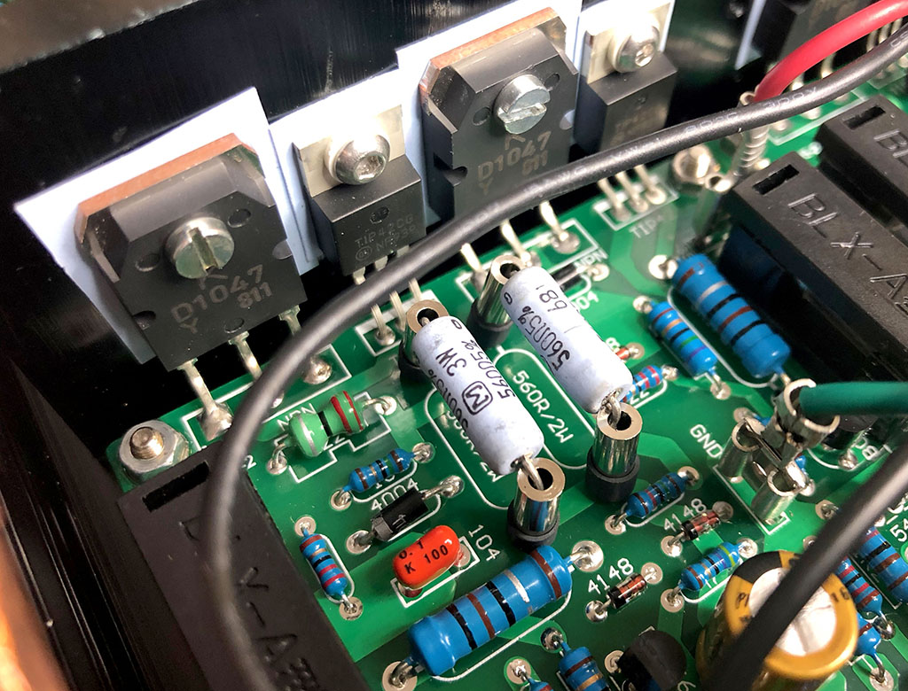

You also need to change the four 560 2W green resistors close to the power transistor. The stock resistors are stick to the pcb. Too hot -> 72°C box closed. Use 3W and it is necessary to raise them by 1cm from pcb.
Optionally, change opamps, electronics caps and input caps.
I replaced the stock TLs with OPA627.
Nice warm sound and dynamic (It use a Switching DC Power Supply).

Is that a link on pin 7 of the ic for using the OPA627 stef ?
Iv'e got a quad 34 pre amp so i can leave the 0.7v as is, i will take your advice with the resistors thanks.
Hi!
The circuit for the opamp is the same as in the original circuit except the C3 3.3PF between 1 and 8 pins that do not exist.

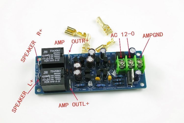

Do you have a schematic of this kit? It does not look like the original 405 or 405-2. Does it have the clamp protection circuit?
No, I don't have it. May be ask LJM.
I used an external protection circuit.
Assembled LJM Audio stereo speaker protection board | eBay
I would think tip42c is rated to low at 100v for this amplifier as the rails are 56v.
MJE15031 can handle voltage but is a lot faster.

The Max is +- 50v same as the original 405 , i got hold of a chassis im using with some burnt out net audio 405 3 boards which i would like to fix, but i can't get hold of a schematic, the boards are different from a 405 and look like they have been mucked about with and have different links and components on each one, i will try the clones and see how they sound.
I haven't found a schematic for these 405 2 boards either
Lot of schematics on Keith Snook's homepage, http://keith-snook.info/amplifier-hifi-schematics/QUAD 405 schematic evolution.pdf
There is also a way to do without the clamp protection circuitry. I recommend going through Keith Snook's Writing. I have been hoping for someone to make new PCBs following his 405-3 with the active ground circuit.

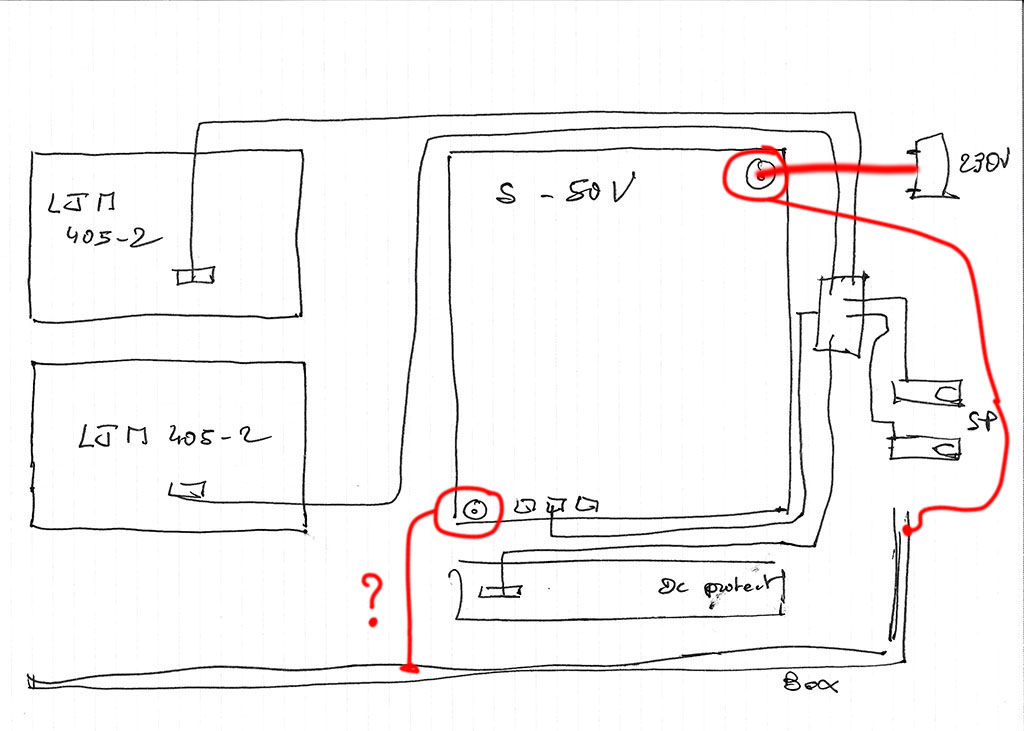

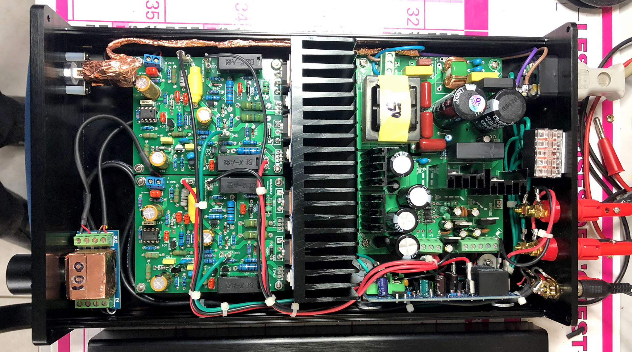

Edit // did you connect your copper foil to ground to ensure a proper shielding?
Perhaps you can move your switch on the back and put some light to fill the front hole?
I assembled an Mx50x2 and an Mx50SE with the same psu but, as I do not use a potentiometer, I put psu on front and amps to the back to shorten signal path.
Both are dead silent on my 93db speakers.
Did you connect earth (right upper screw) and ground (left lower screw) on your psu?

No luck. If I move the switch of 6mm, no more hums.
The 12V on the PSU is weak. II changed some of the caps for a better smoothing. For the DC card, I took the +12V before the 7812 on the psu to have more voltage.
I've done this. See scan. The box is connected from one of the screws but I've forgot which one.
Not sure, it's ok.

You have wired the psu different to what i would have thought ? i would connect the mains earth to ac side and case, and the grounds to dc or 0v end of psu ? it looks as though yours is all on the ac end , it must be right though if it works ??No luck. If I move the switch of 6mm, no more hums.

Yeah, earth side must be connected to ac and case to ensure input filter is working properly and case shielding.

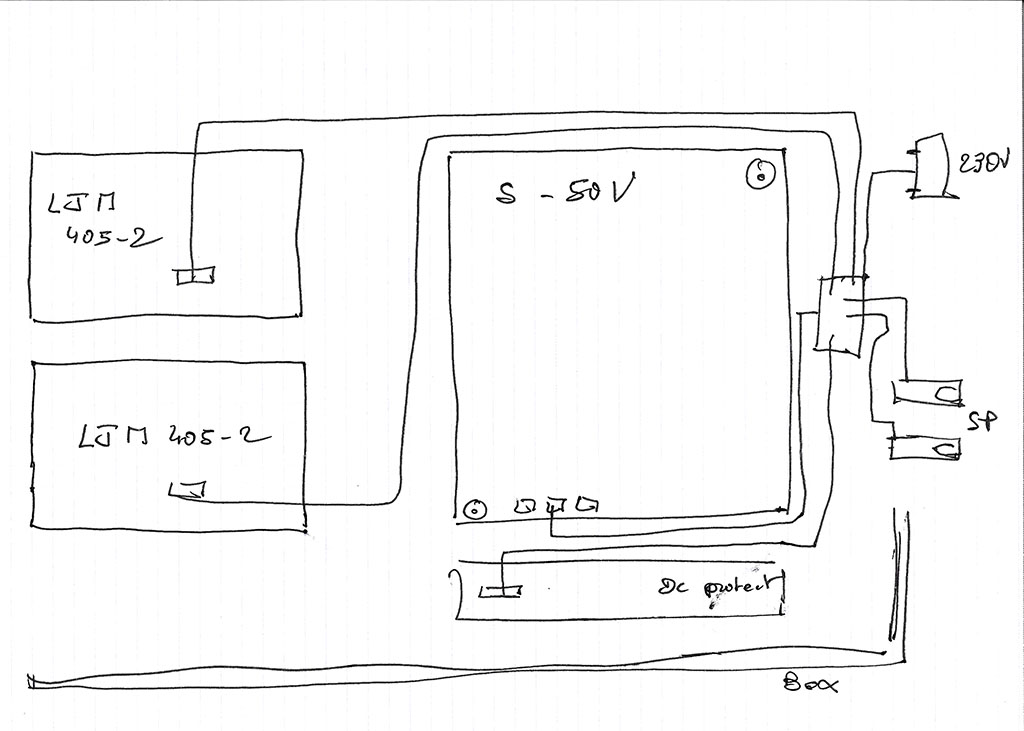

Is this ok ?
I made a change.
The case is connected to AC earth through the screw and the spacer.
But currently, the DC ground is also connected to the case through the screw and the spacer.
Is this ok ?
I made a change.
Ac hole to the case via metal spacer is ok, but you may also connect it to your ac socket.
I'm sorry but your drawing is to imprecise for me.
Your ac socket have 3 pin, L N and Earth.
L and N go to psu input (I guess L to fuse side)
Earth to the upper right screw on your picture to ensure input filter is working properly.

It's done as you said. The upper right screw is directly connected to the AC outlet earth. It was connected to the DC ground before.
The lower left hole is connected to the case too. Not a problem?
As it seem to be the DC ground (same as 0v).
The copper shield around the AC cables is also connected to the case (on one side only).
Hums seems much lower without have moved the power switch. I'll do more test tonight.
Will try to draw a news schematic. 😉
