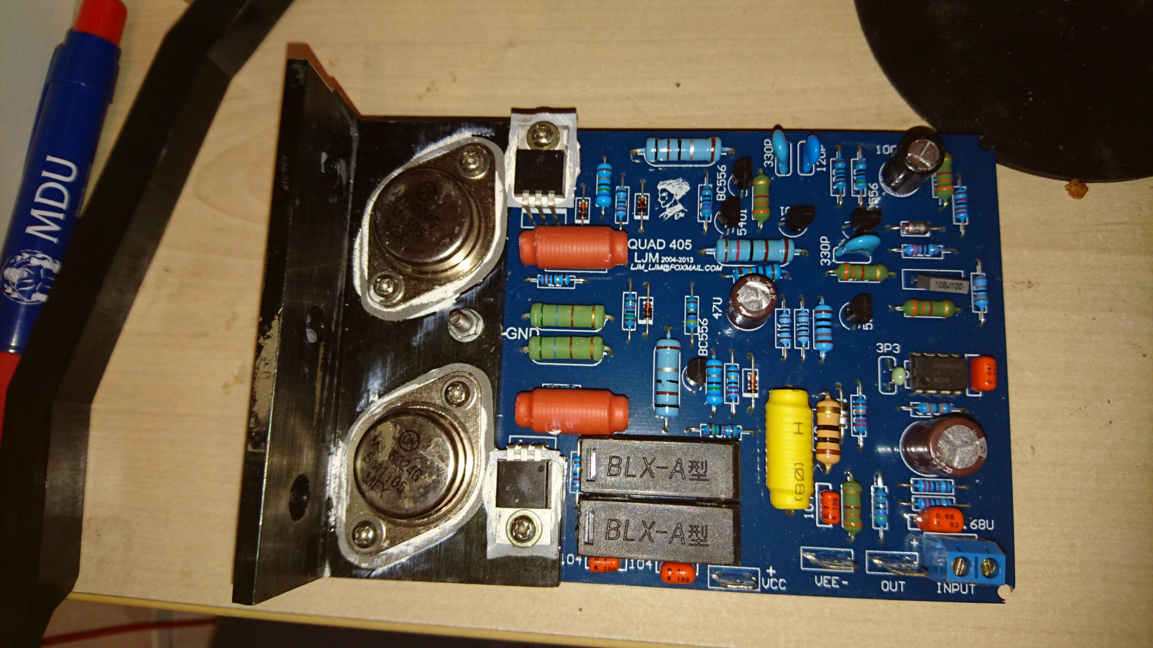

Using a lower voltage would probably just show as a reduced maximum output. In other words it would be a 55/60 watt amplifier instead of 100 watt. In subjective terms it would actually not be very noticeable.
The original Quad used simple resistor feeds to the zener stabilised supplies for the opamp. If this design is similar then those feed resistors may need dropping a little to maintain the correct operating conditions. That's a non problem though.

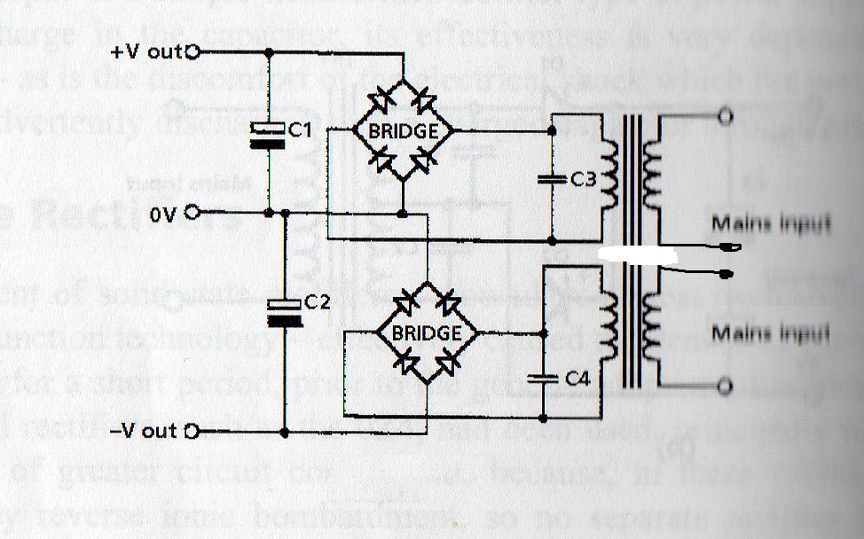

When you say 'rectifier has three terminals' I assume you are referring to the PCB. You could connect the two tranny secondaries in series to create a centre tap or you could create two totally separate 38 volt supplies and then connect them together at the reservoir caps to create a dual supply.
The main benefit of dual mono is total isolation of the channels and no interaction via their common power supply.
This image shows how would use two transformers to create a dual supply by connecting the supplies at the reservoir cap. OK, this image was originally for a two winding single tranny but its the same idea.
When you are figuring out the tranny connections ALWAYS use a bulb tester. That will prevent any damage. A small 40 watt bulb should power the tranny (s) OK on their own.
You need a 70Vac centre tapped, or a dual secondary 0-35, 0-35Vac transformer to create a ±50Vdc supply.

+/- 38V will reduce the maximum output, probably more so at higher impedances. Bass output has nothing to do with it. I am not sure if there will be other problems. I would be surprised if these boards have the latest Quad-circuitry. As far as I know, the best revision has been made by Keith Snook.

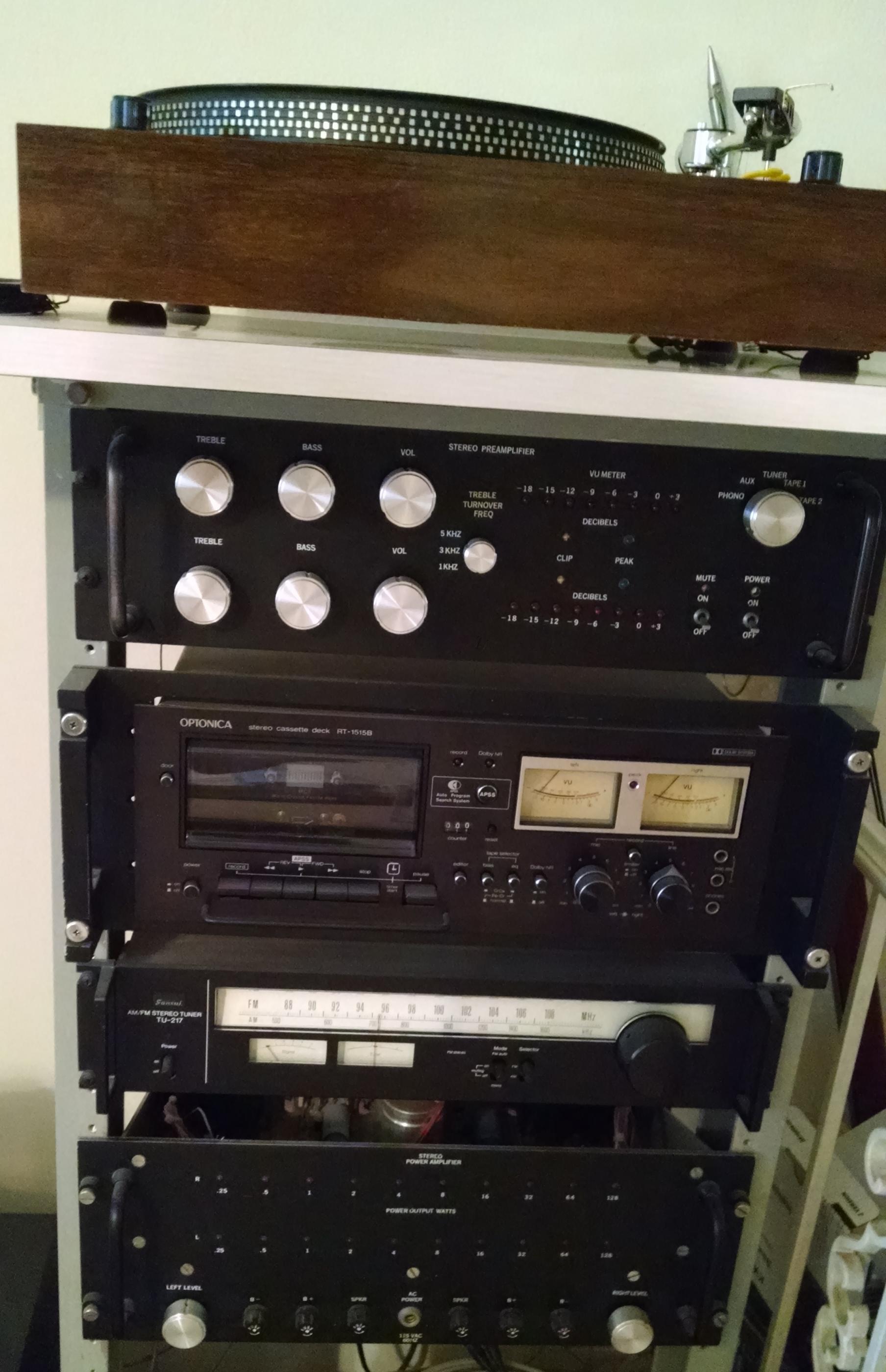

I built a clone of the 405 back in 1977 using a schematic from Electronics World. I hand etched a PCB layout I came up with. A few years later I got hold of a Quad 405 owners manual and the schematic in it has a number of differences from the original Electronics World article.
I still have the amp mated to Preamp I built in 1977 using PCBs I bought from Douglas Self for the "Advanced Preamp" in an Electronics World article. Both have worked since 1977 without issue. Pretty good considering a large number of the parts were used.

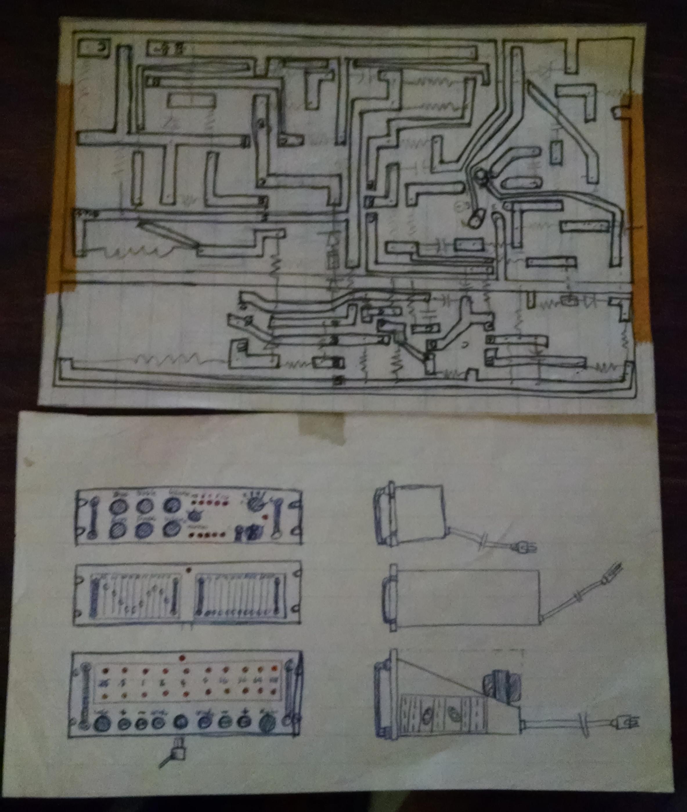

I wish I had had a real 405 PCB to look at. I was lucky that Quad sent me an owners manual. The schematic in it had multiple differences from the one in Wireless World. God only knows what value the various inductors I wound ended up being. I don't remember how I decided how to make them. It amazed me that the system worked the first time. Steve Miller Band christened the system.
I built the whole stereo using a Dremel, reamer, hack saw and a bunch of files. I blew one channel a month later when I accidently shorted it. I did a sleazy fix using substandard power NPNs. They are still in it today.
I went into the filing cabinet and found my old notes and sketches. It seems I had the Quad owners manual before the actual build. One look at the crazy template I made for the PCB layout says I was lucky the amplifier worked. I don't miss the days of tape and magic markers for teching a PCB.

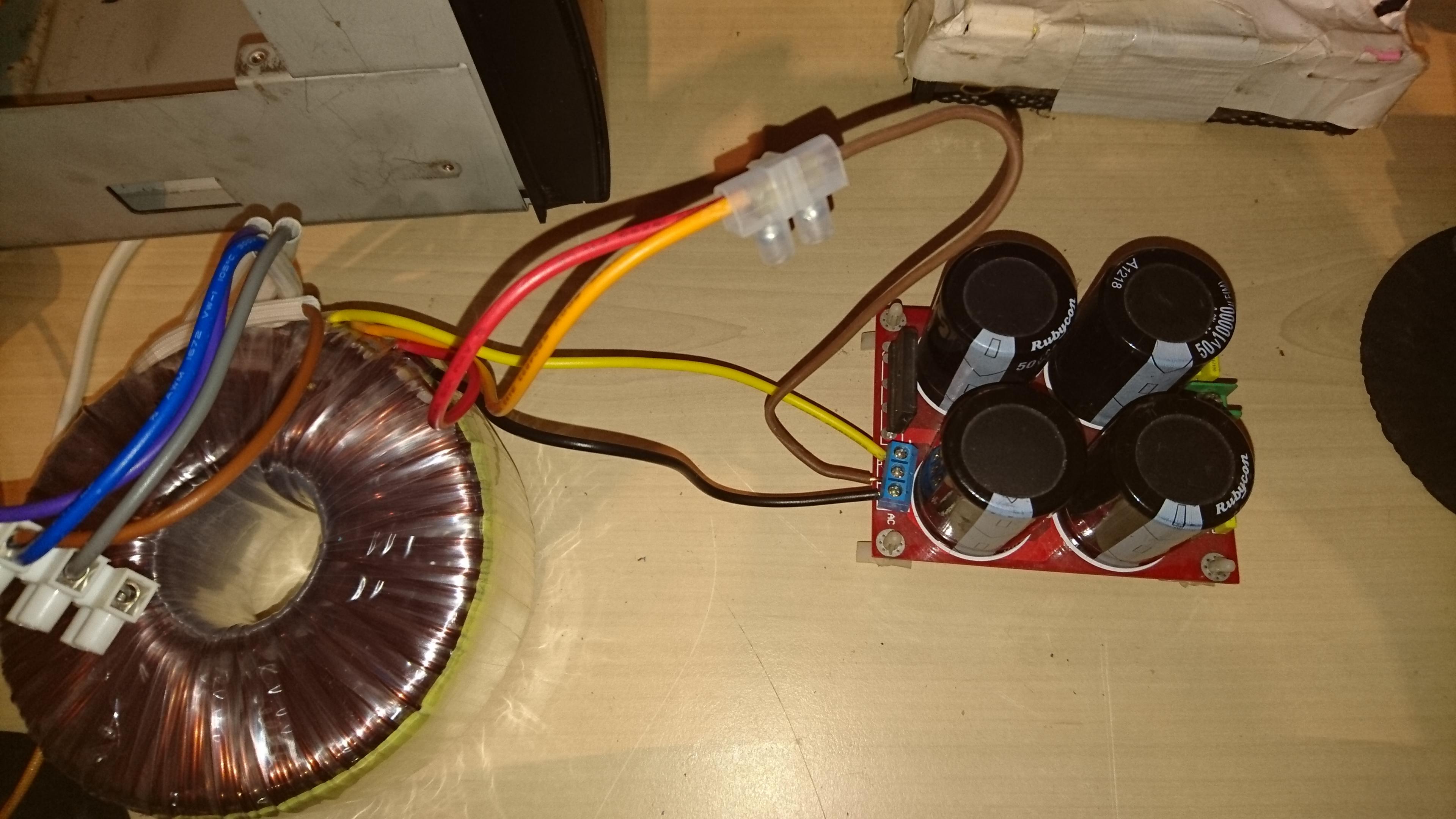

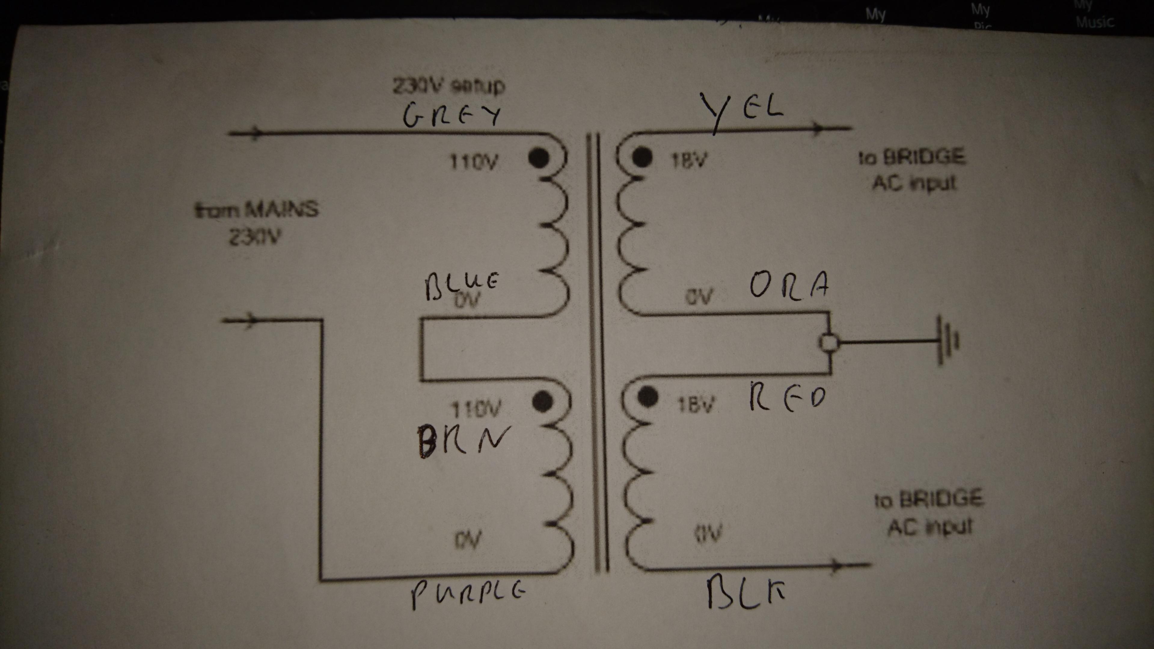

Thanks to everyone above. I've got a 2x30V toroidal and a prebuilt power supply. I'm a bit stuck with the grounding. I appreciate these are basic questions but having read through several articles I'm still not sure.
I've followed the below diagram found at Building a Gainclone chip amp power supply.
1)My PSU has a ground terminal next to the AC inputs. Should I connect this to the one that I've created by connecting the 0V and 18V secondaries (orange and red)?
2) Where do I run my signal ground to?
3) Where do I run the ground connection from the amplifier board?
4) Where do I earth my Chassis to?

On the Transformer Primaries, join the violet and grey. That leaves the brn and blu available to connect to mains. Brn is Live and Blu is Neutral.
When you come to assembling the PSU remember to twist your flow and return pairs.
The three wires into the PCB terminal block are a twisted triplet (not braided).
In any case, do not connect the amplifier's chassis as shown here Power Supply Wiring Guidelines, see picture, if only you personally, not grounding into the earth this ground loop. This particularly applies to those. who lives in apartments of high-rise buildings. There is a ground loop has no connection with the earth, and only with a power transformer substation ~110 volts. It can have capacity in relation to the physical earth, such as radiators and water pipes, which are physically grounded at least through the water. The case could end up cold heels and a tag on his toe.
If you live in a private house, ground the third pin of outlets on their own, or disconnect the third contact with the chassis of the amplifier!!!
