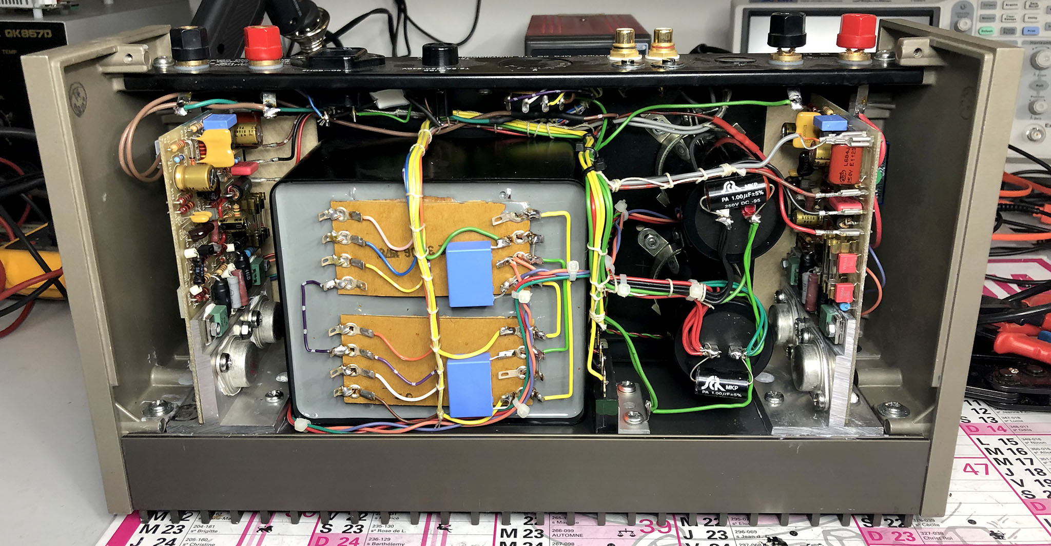

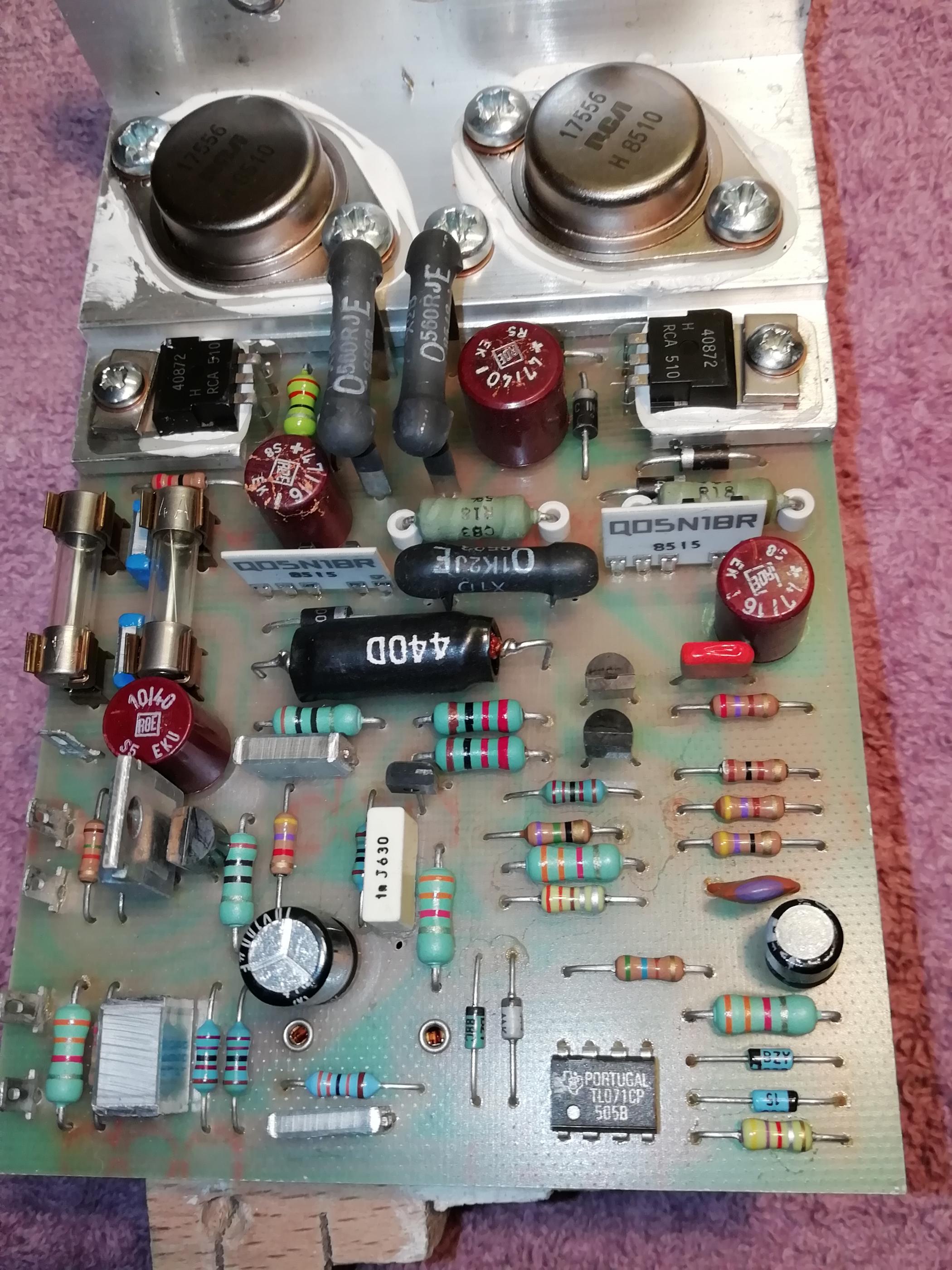

Does movin the leads to the volume pot make any difference to the hum, I built a Quad 405 clone more than 30 years ago and found it necessary to dress the power supply DC ground and input wires together to prevent a hum loop or at least minimise its ares. The 405s have very neat wireing some of which is to prevent hum.
Stuart
Currently, I don't use the pot. It goes direct to the RCA. Each channel is independent.

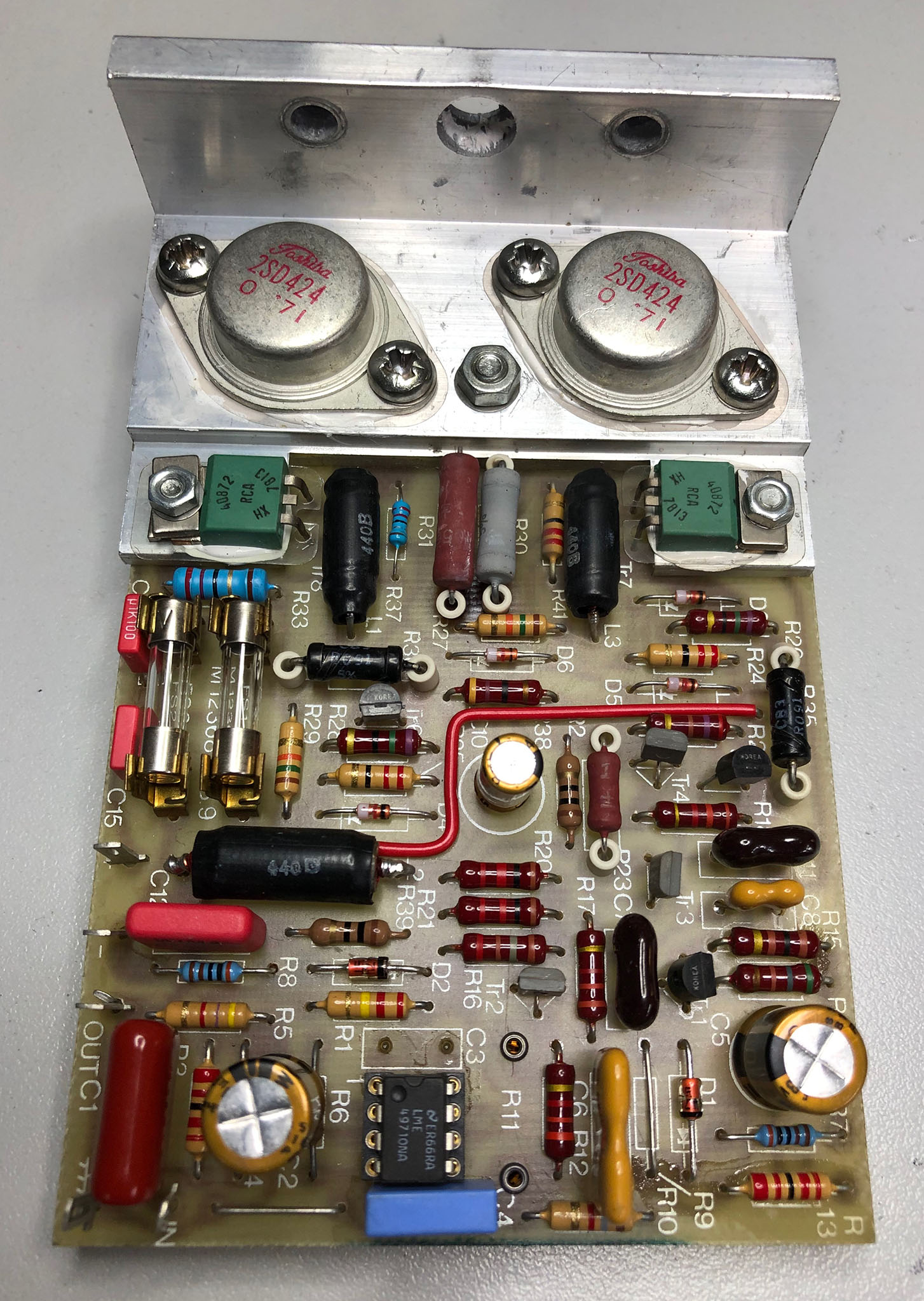

I also finished to restore my old 405.
I'll compare later. ;-)

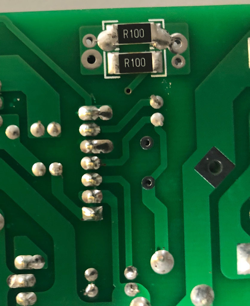

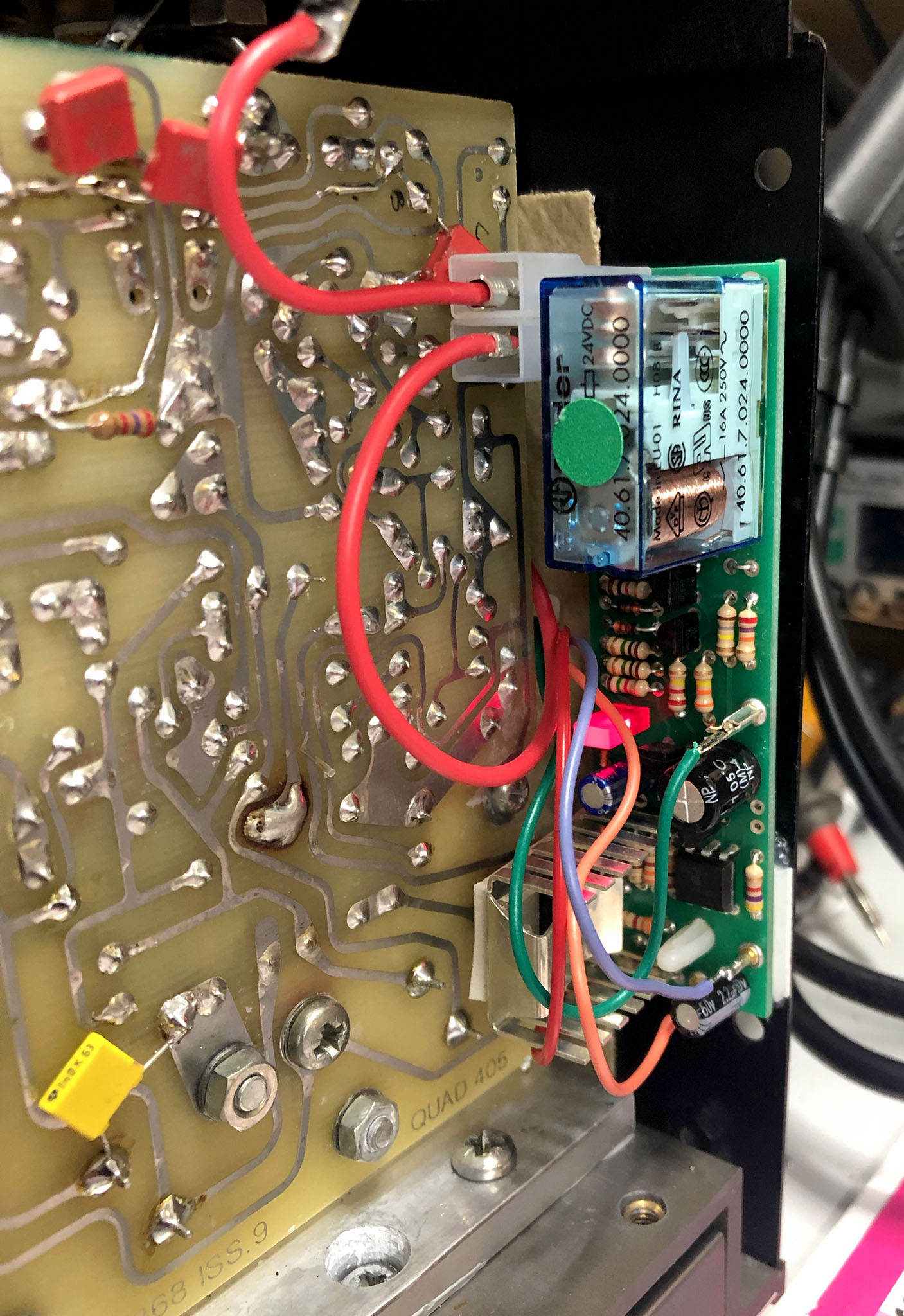

Hi.
Try to replace fried resistors with bpr56 0.25R 5w one, you can find them pretty cheap direct from China.
Measure voltage unloaded before to use.
0.25R is the value I got from the same +/-45v PSU.

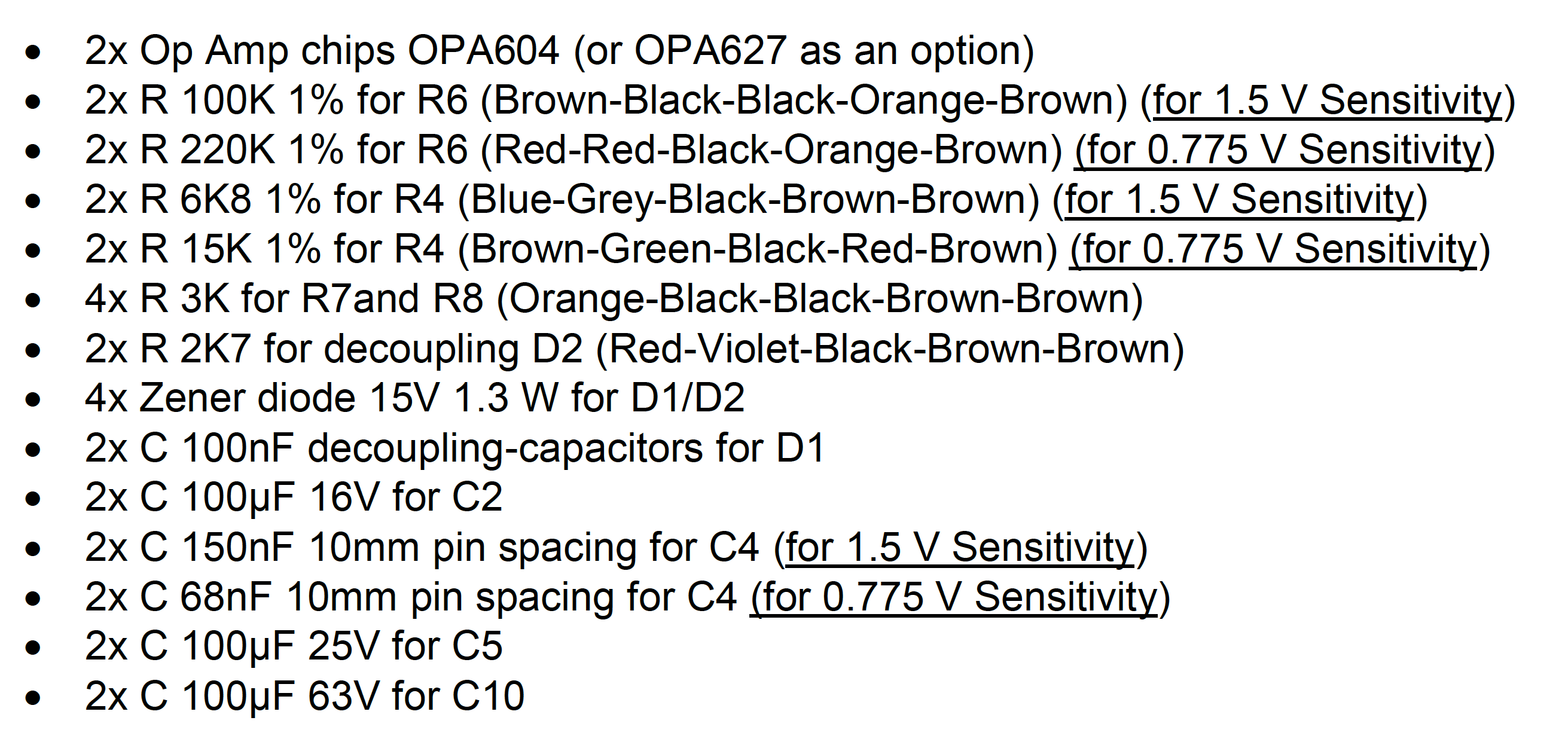

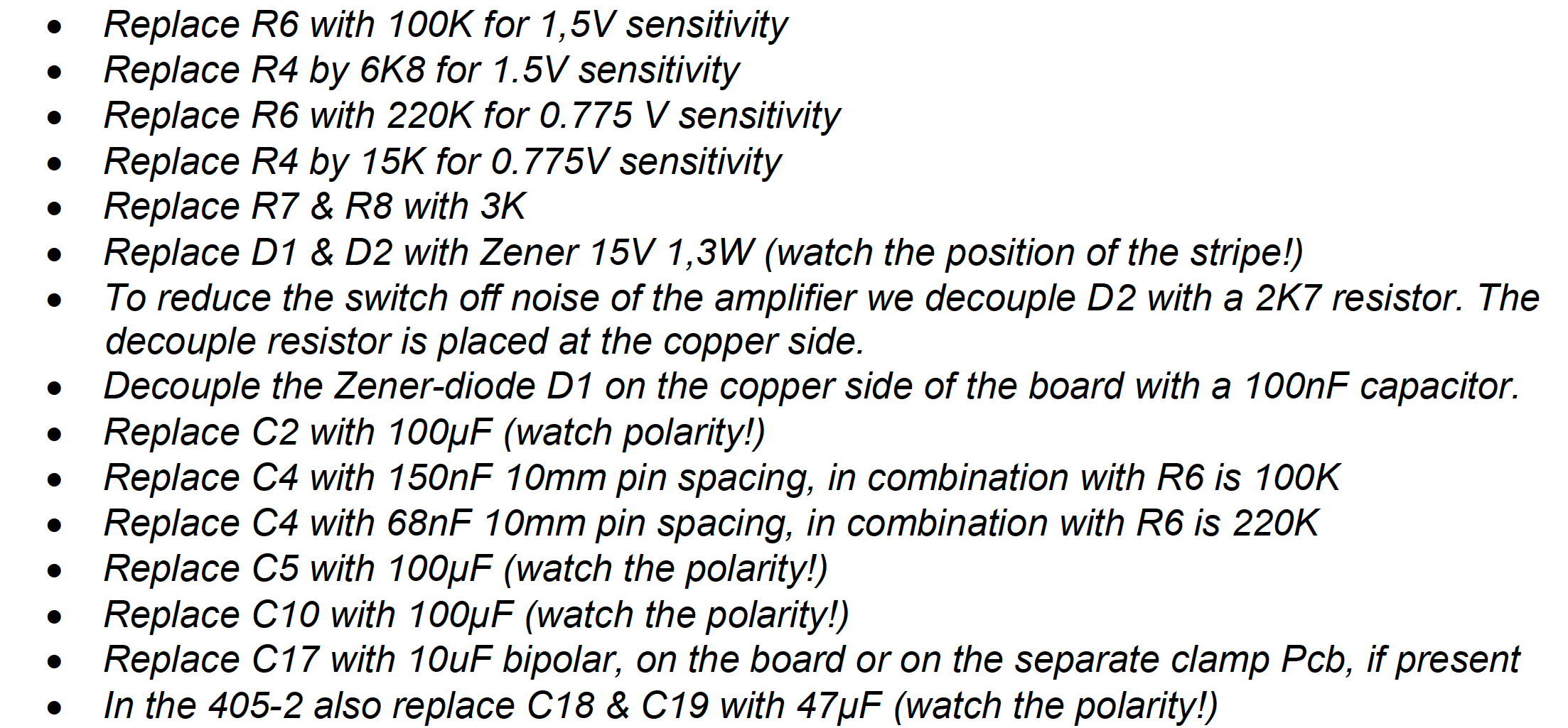

I think il'll do some maths but I think 6.8k/100k/150n in an inverting opamp stage give close to the same ratio than original 22k/330k/47n.

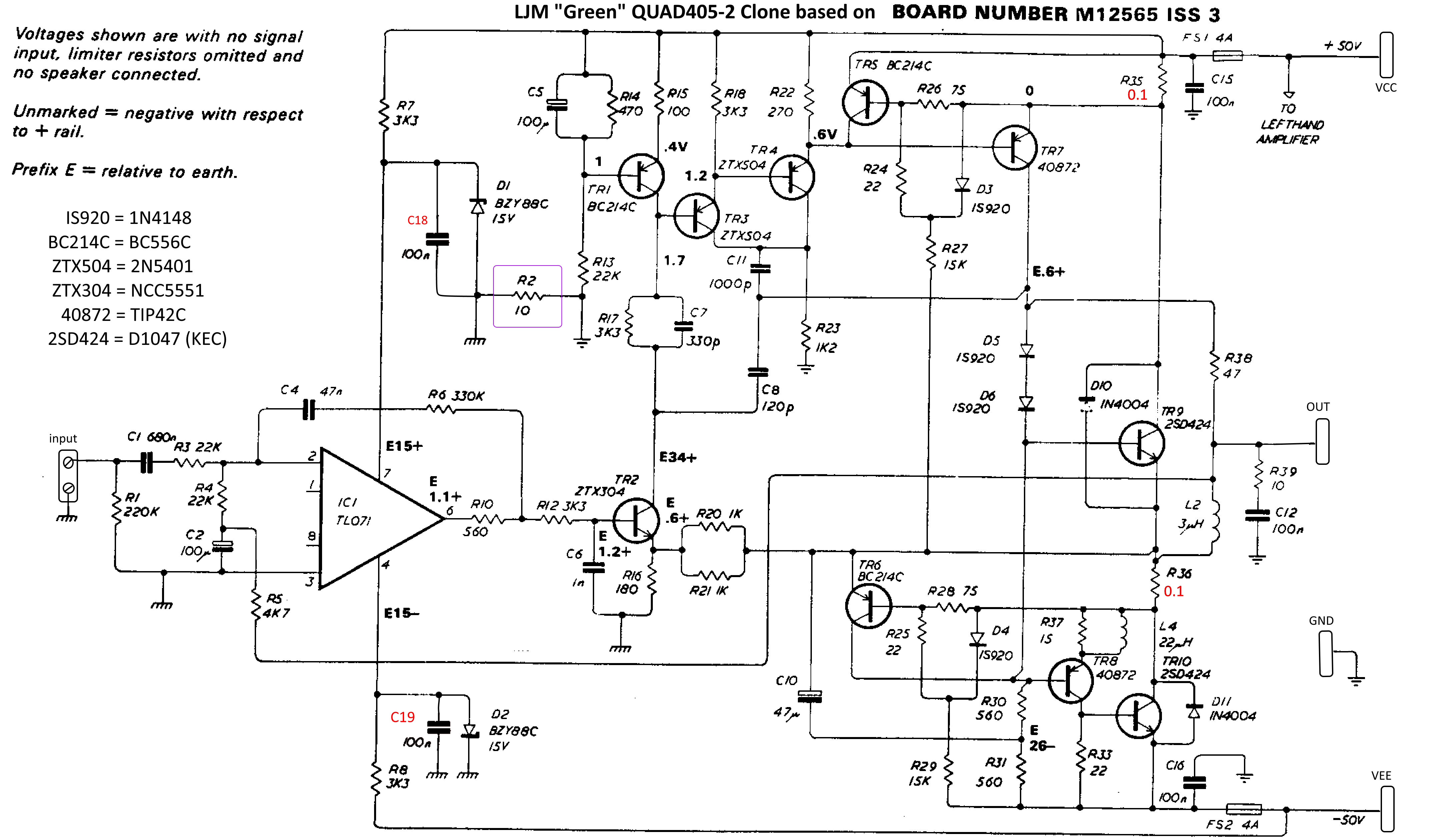

Hi I just get a pair of those green 405-2 boards to give a try.
Here is the schematics I think (I checked).
What do you think of the r2 resistor if input is not connected to chassis, can I replace it with a jumper?

I already did the Snook/Ludwig input gain reduction mod ( c2=33uf, c4=150nf, r6=100k).
My concern about R2 is because my input rca aren't connected to chassis earth and I fear about humming or R2 heating.
Will try and see.
Best regards

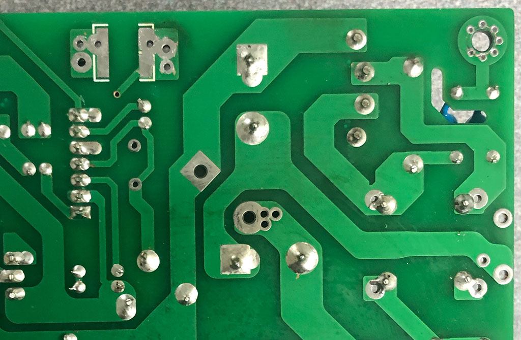

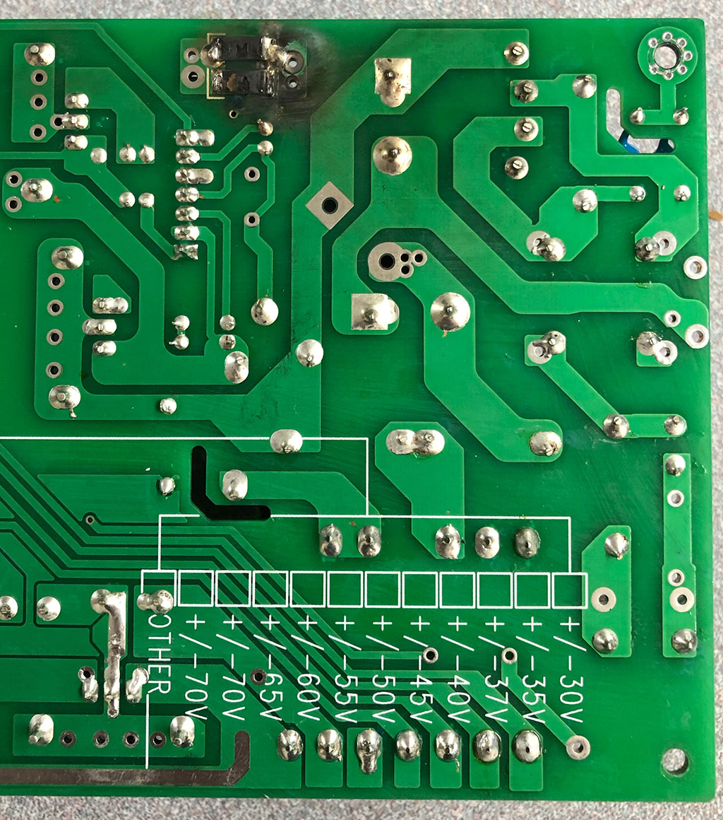

Hello,
I recieved my pcb today. First, diagram did not correspond to PCB (TOP3 transistor VS TO3 implantation).
I pointed clone vs legit composants and found differents values for
R10
R2
R27/R29
C19 new
If C19 appear to protect from oscillation, I would like to check that resistances mods was only due to transistors update.
I have BDY58 or 2N3773 transistors : do I use legit or clone values ?
thanks
