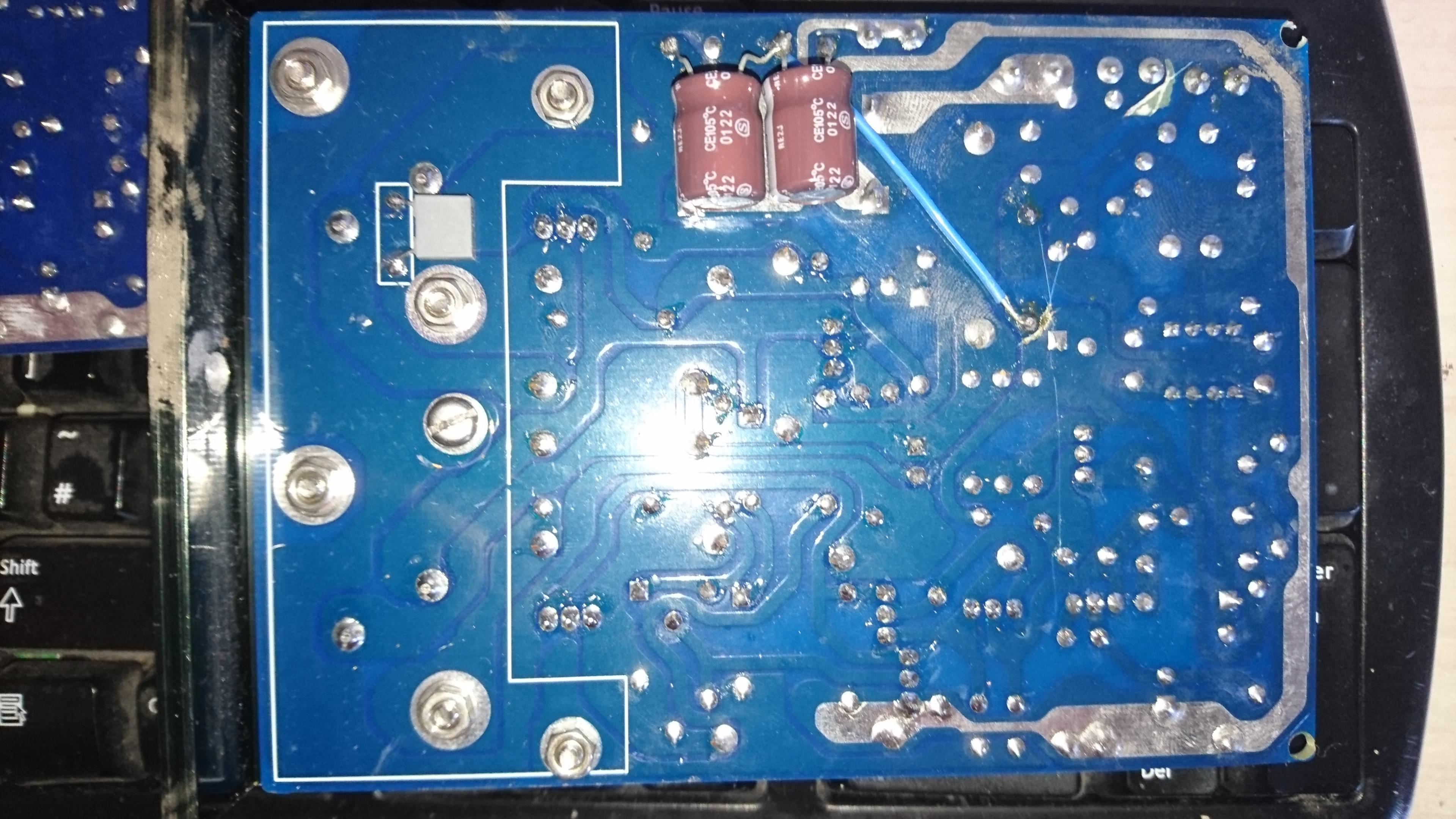

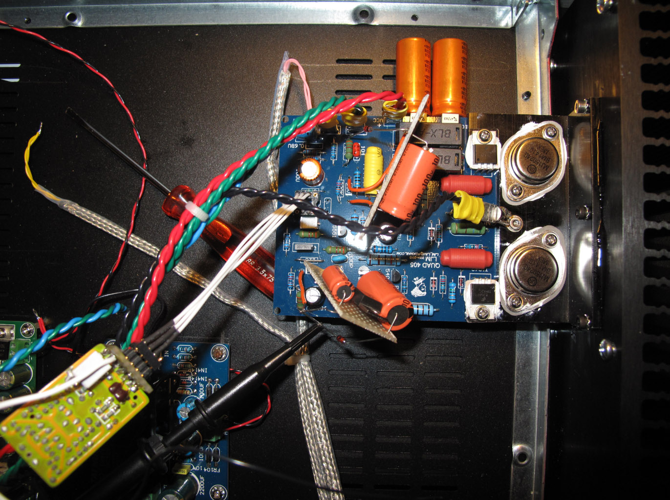

Good news, the amplifier is up and running with no damage. The only other thing it might have been was an electro-static shock, if you had picked up static while dismantling and reassembling - an ESD wrist-strap would prevent that. Looking at your previous picture, the yellow link wire probably is part of the circuit and needs to be connected. Your boards were previous to my version and they copied the original faithfully, even including this wiring link that was on the 1976 version. It is part of the -VCC current-limiting circuit that you will remove anyway if you are going to modify. The Zobel Network correction is exactly as you have shown, just isolate or cut around the leg of R39 (its currently on the signal GND) and connect it to the power GND as you have shown. Previous DIYers have blown tweeters or smoked boards by forgetting to correct this error.
Well, its not because you haven't found out what is wrong. The Zobel network error correction wont cause that. If your output oscillates, R39 will get very hot as it dumps the high frequency signal to GND - it doesn't usually survive for more than a few seconds. Find out what has damaged with a view to replacing. More likely, you need to make sure your grounding is correct.

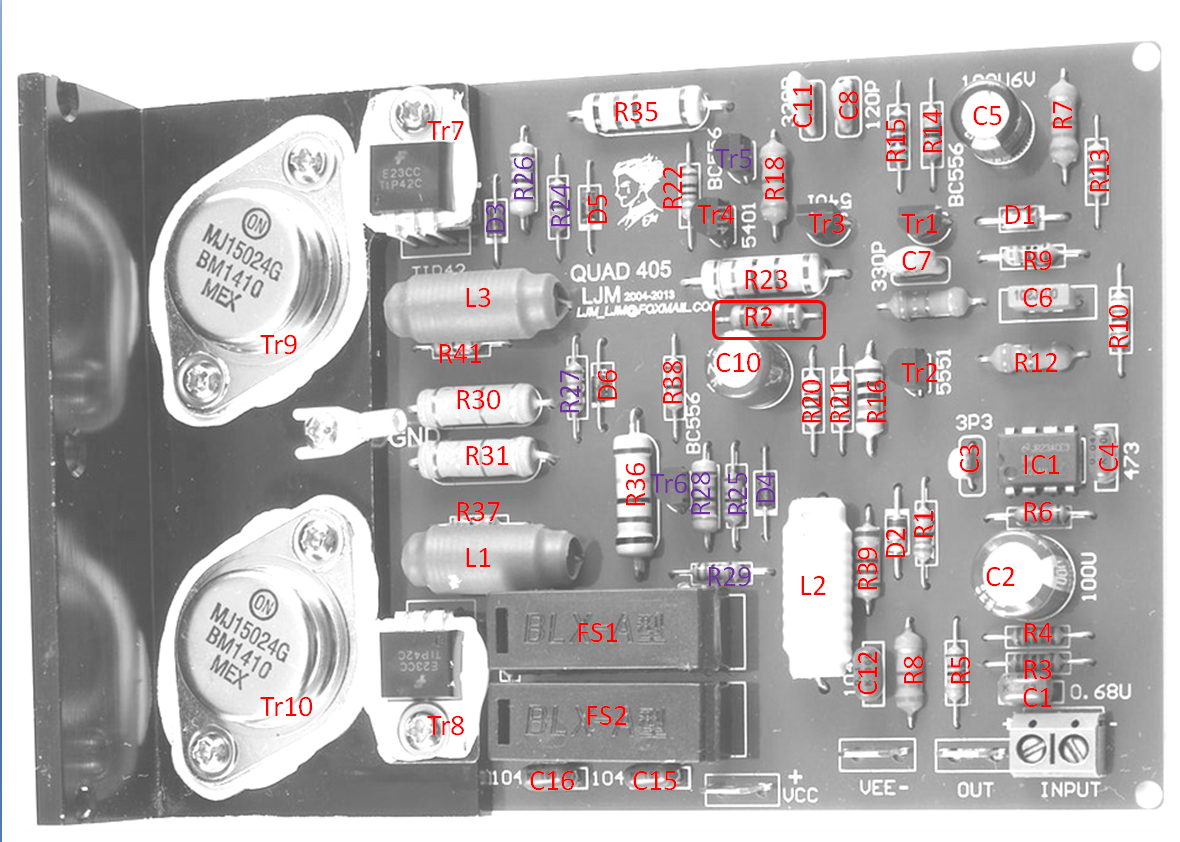

I didn't notice the presence of R2 and put only one ground connection as i am used in other amplifiers... and got a radio transmitter with 40V voltage swing.
The beast is pretty sensitive to oscillation and I went into additionnal decoupling but went into more trouble.

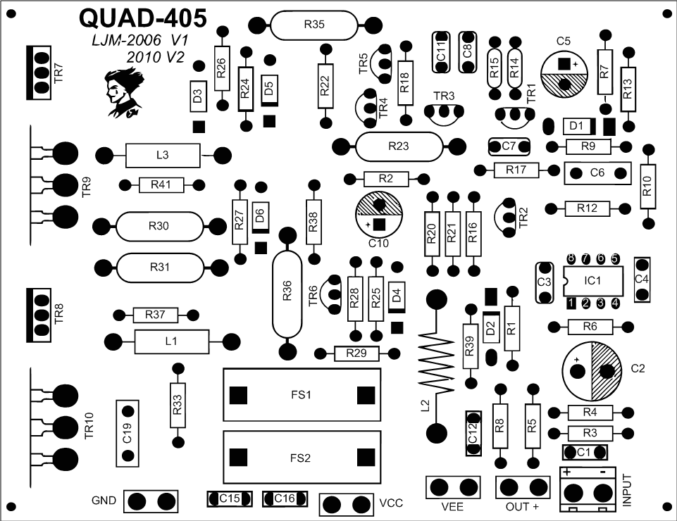

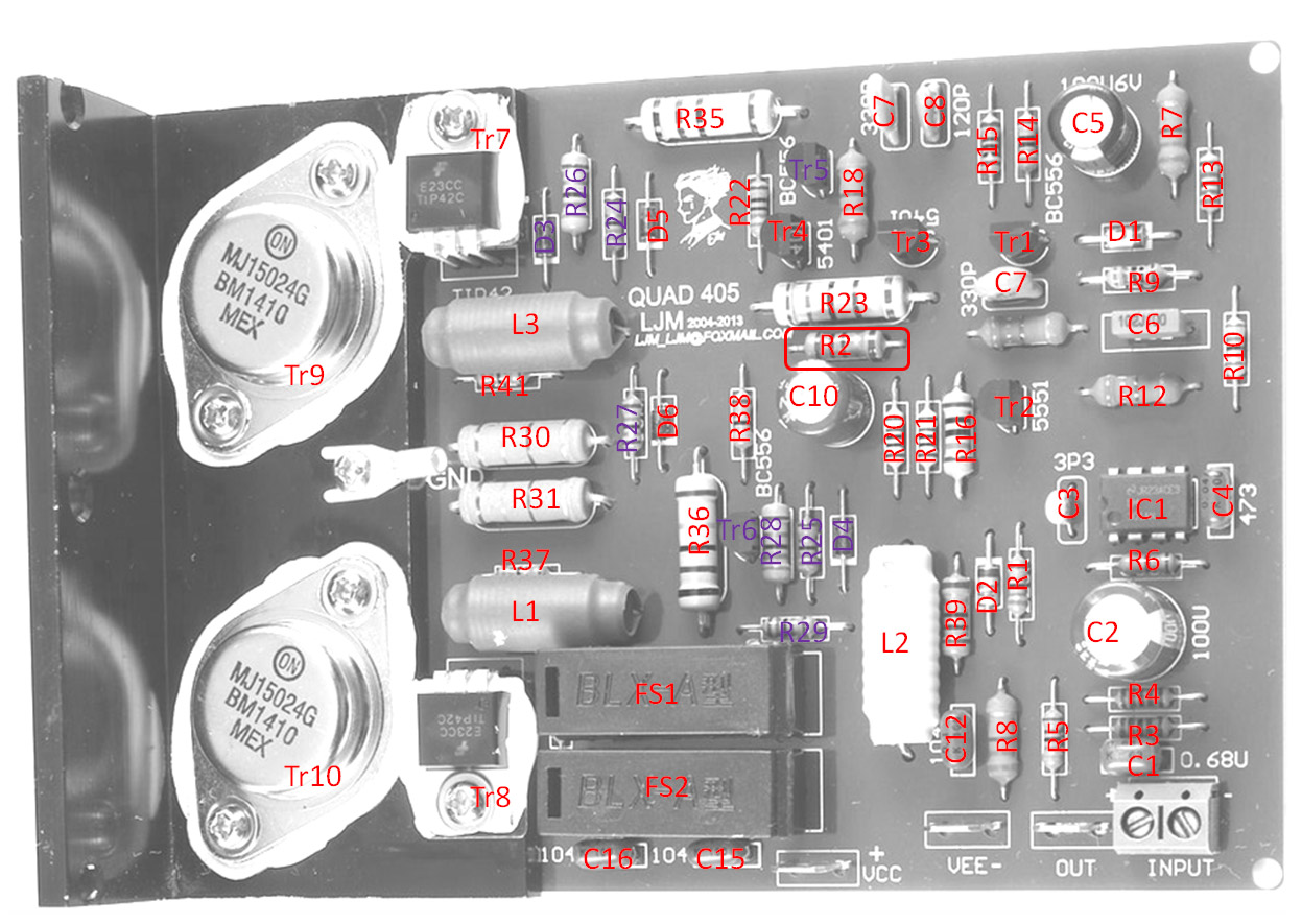

To apply some mods I found useful to get a board view with component ref.. it might be usefull for others (cf jpg attached).

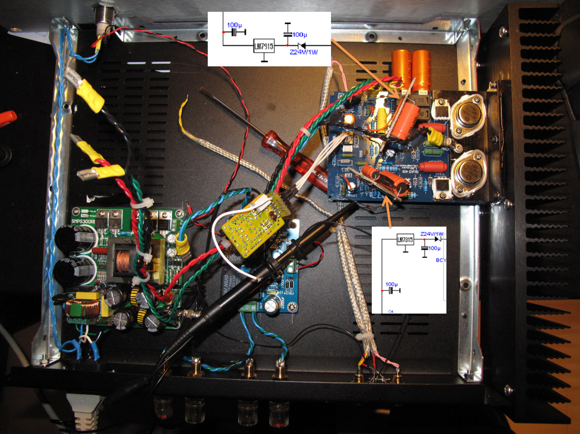

Main trouble I had was the stability of power on AOP the positive railwas more +9V than +15V, even changing the Zener for a new 1.3W 15V was not enough even with a low power fet AOP. I did try the solution of a 24V zener + LM7815/LM7915 to get perfect symetric supply on AOP. With this i can even use a discrete bipolar AOP from Audio-GD... but the 24v zener gets hot fast.
At the end i still have 200mV @ 160KHz on the speakers... guess what i'm on SMPS power supply and i was using the aux output to drive the relay protection board but on +12V only and then the load is asymetric the ripple is not the same on +45V/-45V main output and it's visible on output.
removing the aux connection switching noise ripple on main supply is down at 40mV @ 160khz ... on speaker output noise is down at 10mV
but I don't know how to get rid of this...
LC filter on power Rails ? or acceptable ?

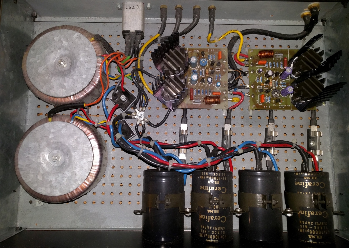

after a week of work every night after work, got 1rst music in speakers... but not a clean design.

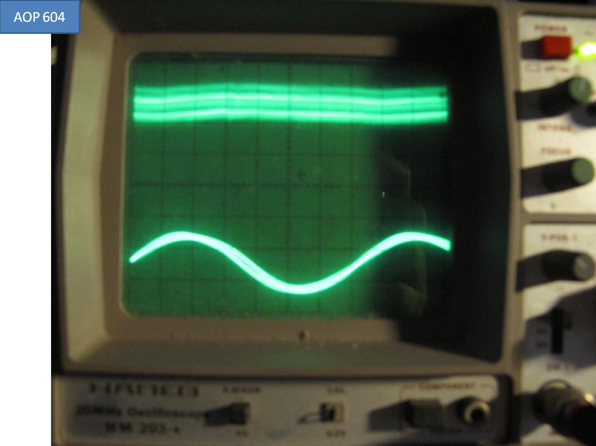

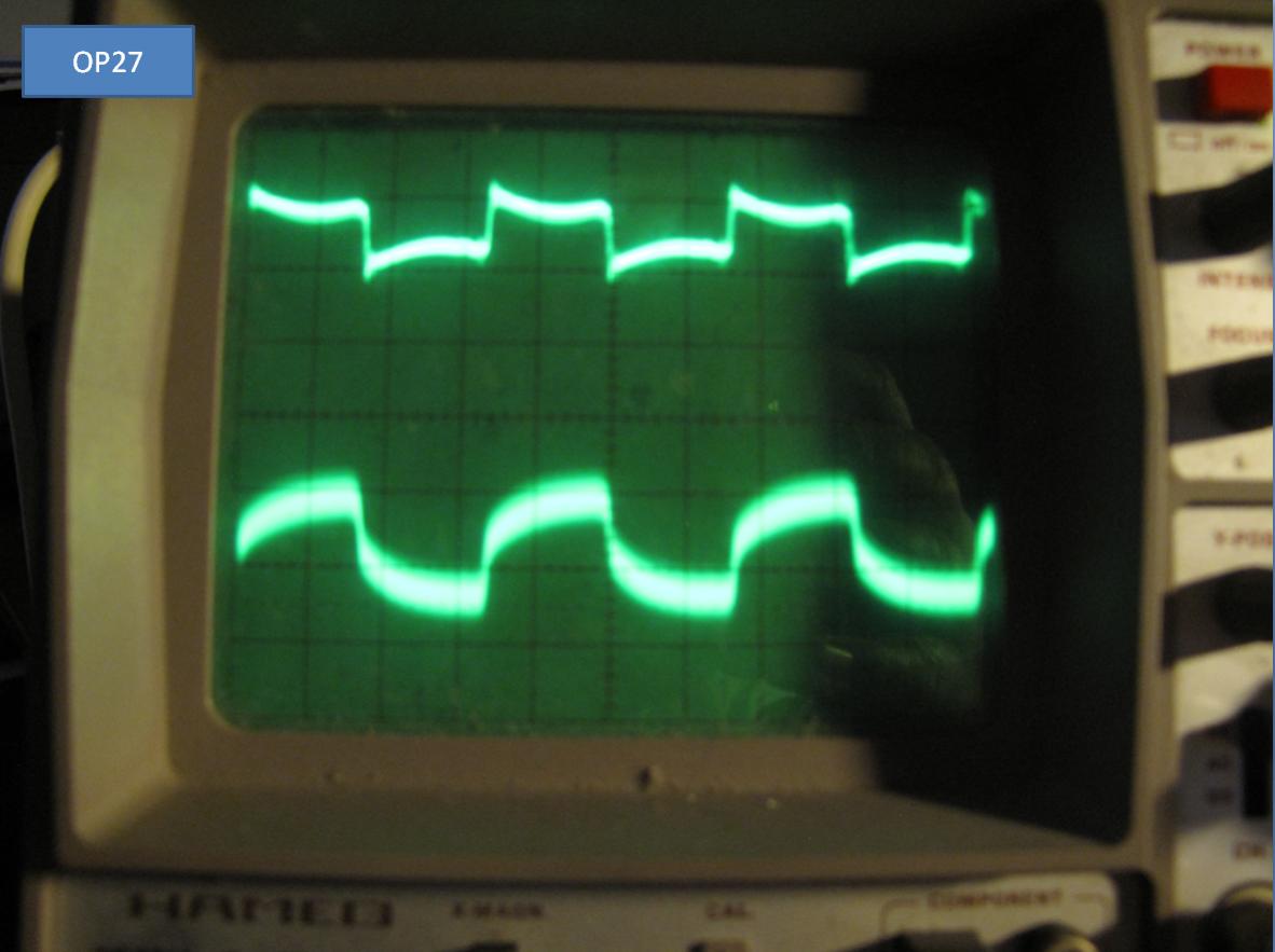

hi Stuart,
Added a little 12V transformer for protection board...
Yes, ripple is mainly coming from PSU switching via +V -V rails
Traces are not sharp as there is also a little of 50Hz
Except with OP604 where it start to oscillate by itself at onother freq
a 50mH self with the 470uF added on board should filter this
A shield around the PSU board ?
Project i've seen with SMPS are not going into those heavy solutions...

Hi Jice, I think there might be a typo in your pcb / component picture, you appear to have C7 twice? I think the one at the top of the board should be C11.
I've been trying to come up with something similar, but my board is a bit different than yours...

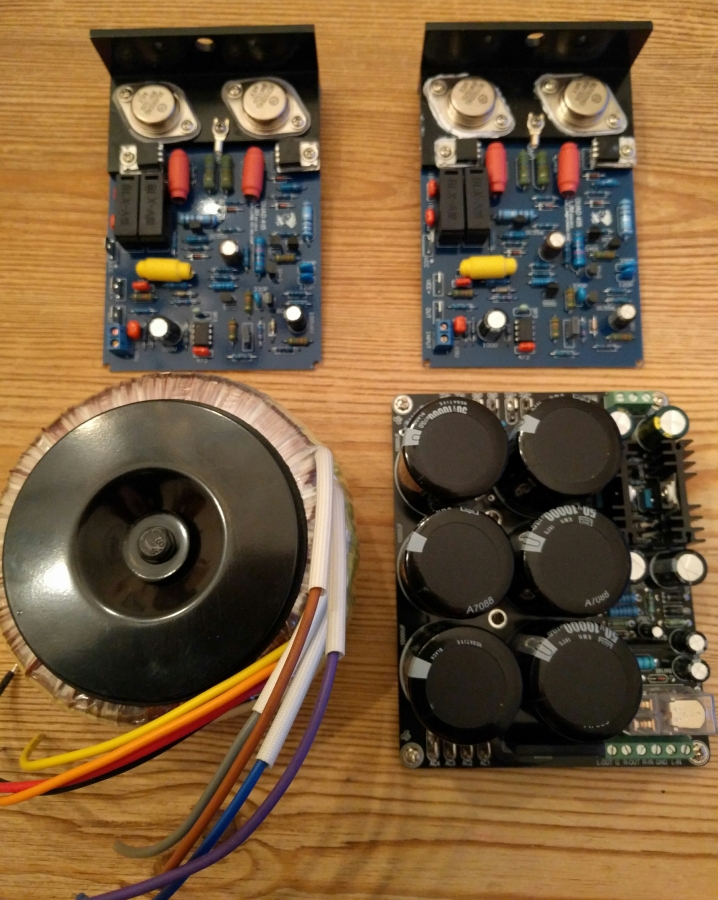

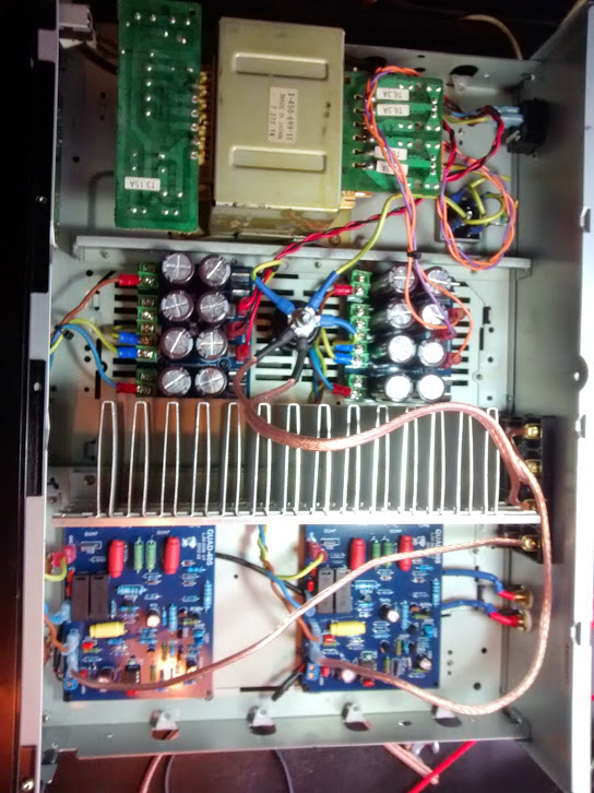

Whilst looking in Ebay, I became aware of the Chinese Quad clones, and thought that maybe it was time to build something more "pro", so I ordered a couple of those Quad clones, a 300VA toroidal, a pre-built PSU (6x 10,000uF caps and a delayed speaker switch-on), some ancillaries and one of the clone Quad 405 cases which was horribly expensive but looks wonderful from the pictures (I'm still waiting for that to turn up).
My intention is to build 2x complete 405s and then to have a go at building a pair of Rogers LS5/8 speakers. I know the particular bass driver is no longer available but there are 12" polypropylene drivers available and "versions" of the Audax tweeter (which may have less than stellar low frequency response), both of which I hope can be tailored with active crossover boards - I think I will end up with enough room in the new Quad case.
Anyway, I'll post pics as I progress although at the moment I'm still waiting on the postman for a number of critical components. In the meantime, I've adapted the Quad boards to correct the Zobel issue and I've just learned that I need a ground-breaker circuit - both with huge thanks to roclite.

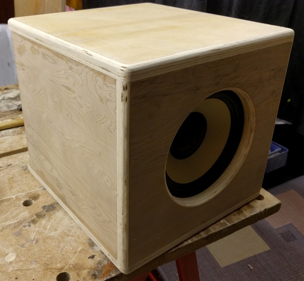

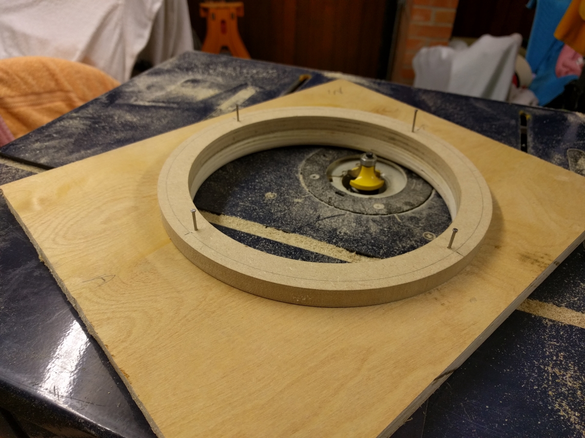

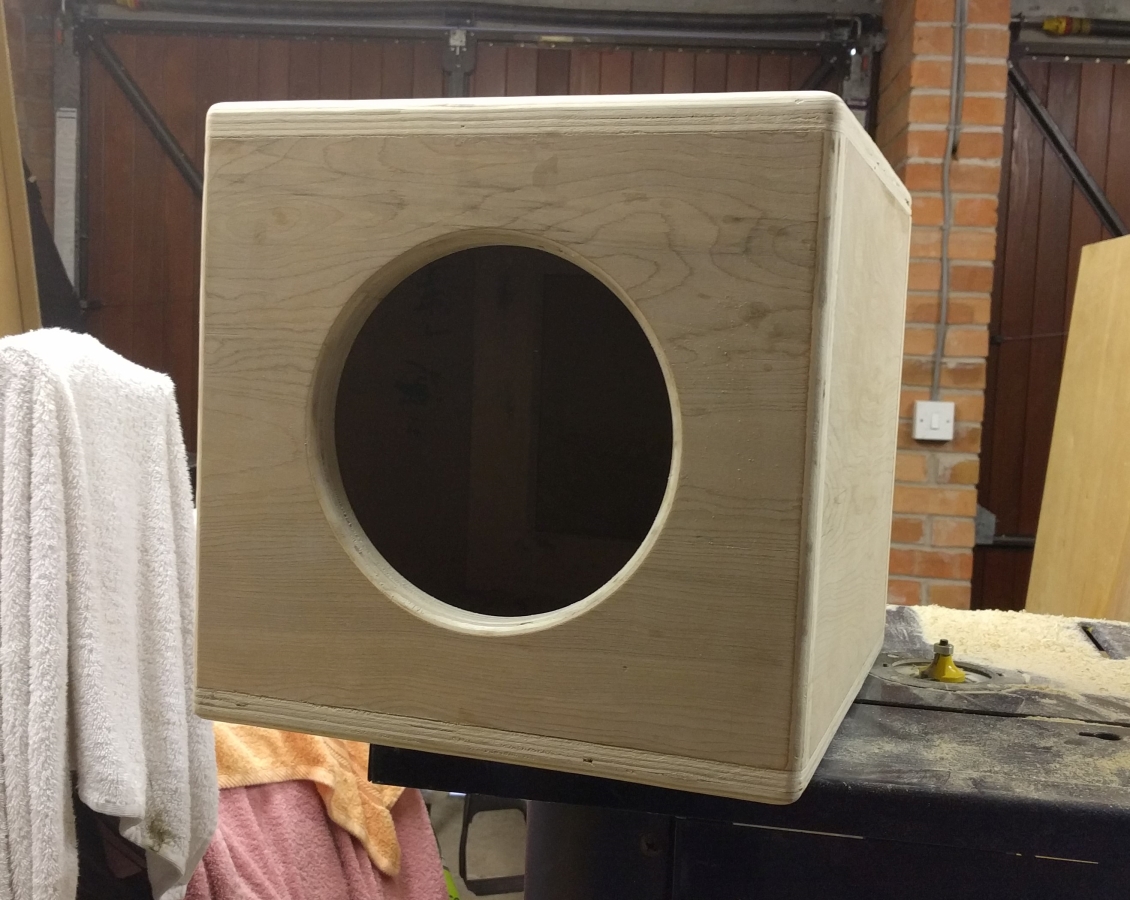

While I'm waiting, I decided to build a self-powered subwoofer for my son, and use the working Maplin amp in that.
My Maplin amp before I cannibalised it:
My growing collection of Quad components:
My son's subwoofer project. The intention is to paint it white to match the Scandyna speakers we has. I started off buying an 8 inch kevlar driver to match the Scandynas. The colour's not an accurate match but it'll do:
Bought a pre-cut speaker ring from Ebay to use as a template to guide the router:
Came out satisfactorily :
After a "first cut" sanding, it's starting to look pretty good:
The back panel rebated into the back baffle. I have an edging strip that forms a nice seal (not shown):
So far - awaiting smooth-fill, final sanding and painting:
Anyway - sorry for thread divergence. I'll stick to the Quads in future updates.

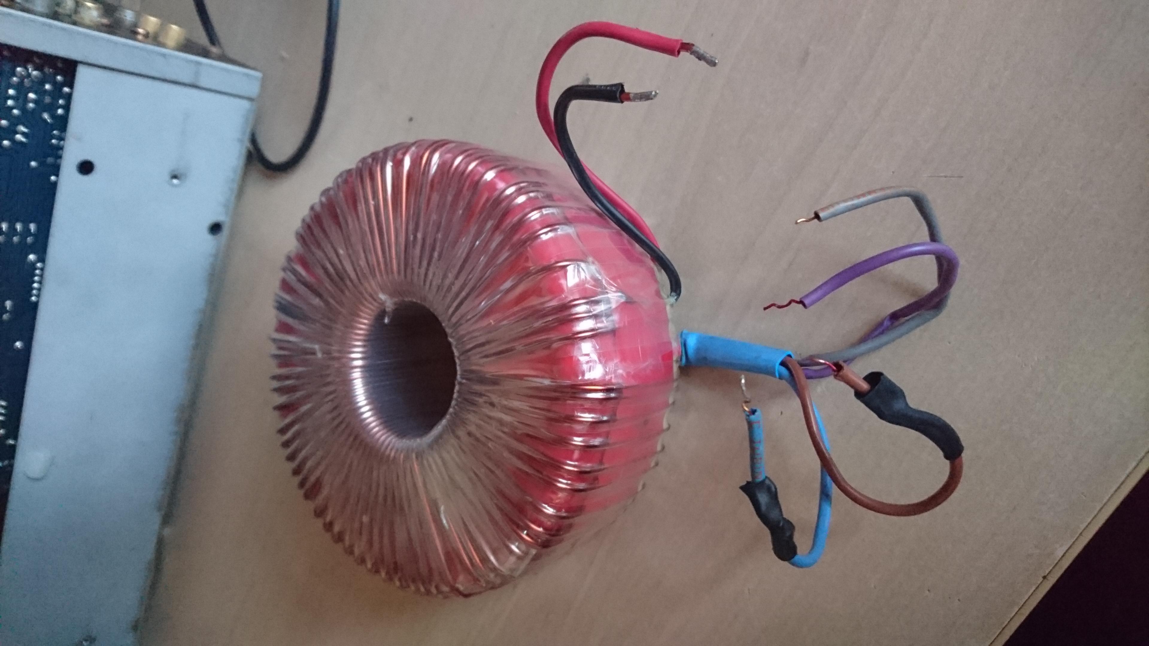

Hi everyone, I'm just about to start building a 405 clone. I previously had a lm3886 chipamp running but the (ancient) transformer gave up. Looking to upgrade I bought two 405 clone kits through eBay from a seller who builds clones and claims to have corrected the grounding error. Three questions I hope you can help me with:
1) Has the grounding correction done right?
2) Will a 27.5v 300va transformer be ok? Gives ~38.5V after the rectifier. It doesn't have a 0V wire, as compared to the previous transformer I had which was a 25-0-25. Picture attached.
3) I have two of the above transformers. Is there a realistic benefit to a dual mono configuration? Any big downsides to this other than the weight and size?

1/ No idea 😉 I don't know what the original problem was.
2/ Your single winding tranny will only generate a single rail of 38 volts DC. I would imagine the Quad clone requires a dual 'minus, ground, plus' configuration which is where the tranny with a centre tap is needed. The original Quad used -/+50 volts (so 100v in total)
3/ If those are the only trannys you have then you will need both to generate a dual rail supply. Dual mono has many advantages but you can't do that with what you have.
DSC_0114.jpgThanks Mooly.
What would be the effect of using +/-38v DC instead of 50V? Lacking volume, or bass,or not working at all? The ebay listing for similar modules suggests an input of +/-30VAC to +/-50VAC
I've been looking for a guide on making a dual rail using two transformers but have had no luck.

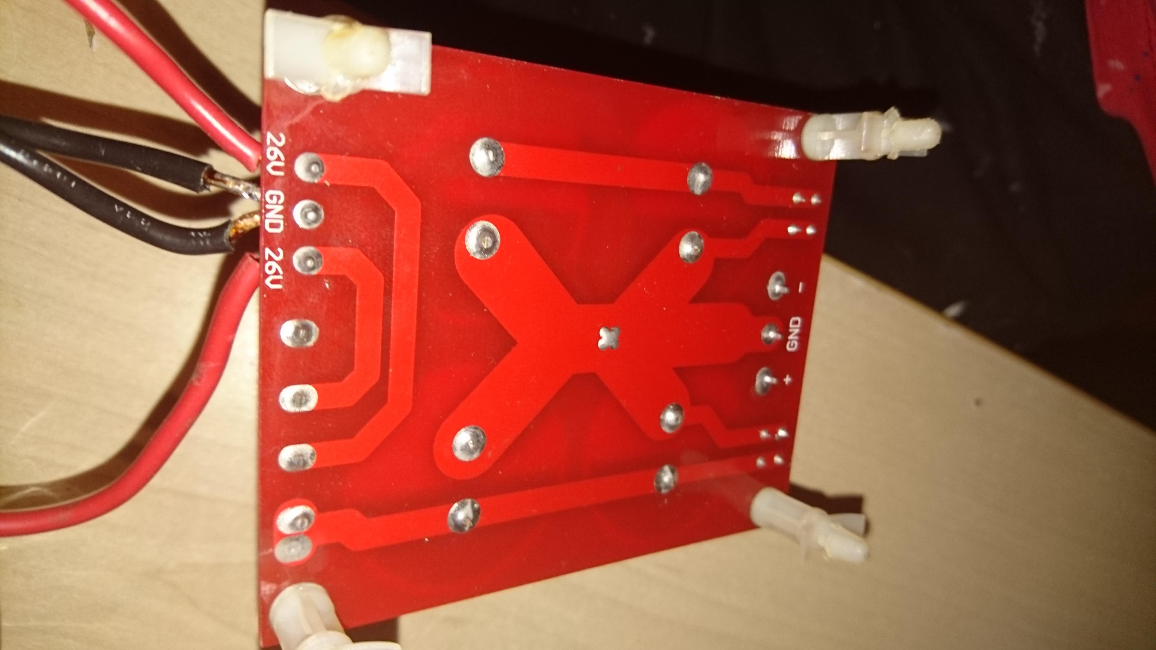

My transformers have a red and a black wire on AC secondaries. My rectifier has 3 terminals marker 26v, GND, 26v (but components are all rated at 50V or above). Can I run black leads from both transformers into GND and a red from each into the each of the 26V terminals? Or will I end up with shorting and fires?
Also from what I've been reading, wouldn't one hefty transformer, but using dual rectifiers and large capacitors give the benefits of dual mono? I'm thinking about it in terms of one channel sapping power from the other
