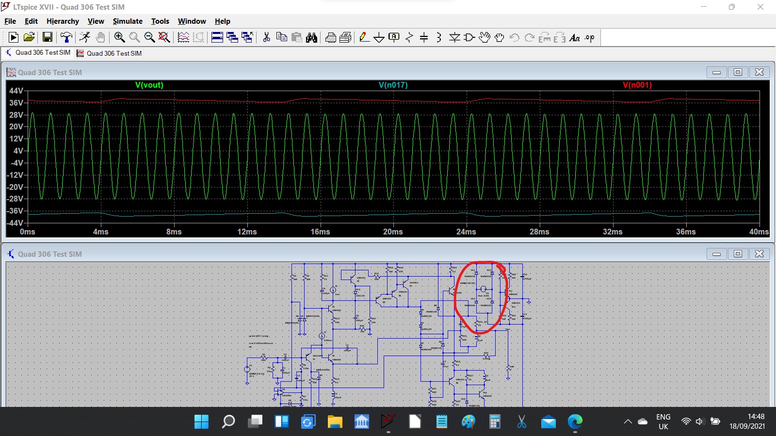

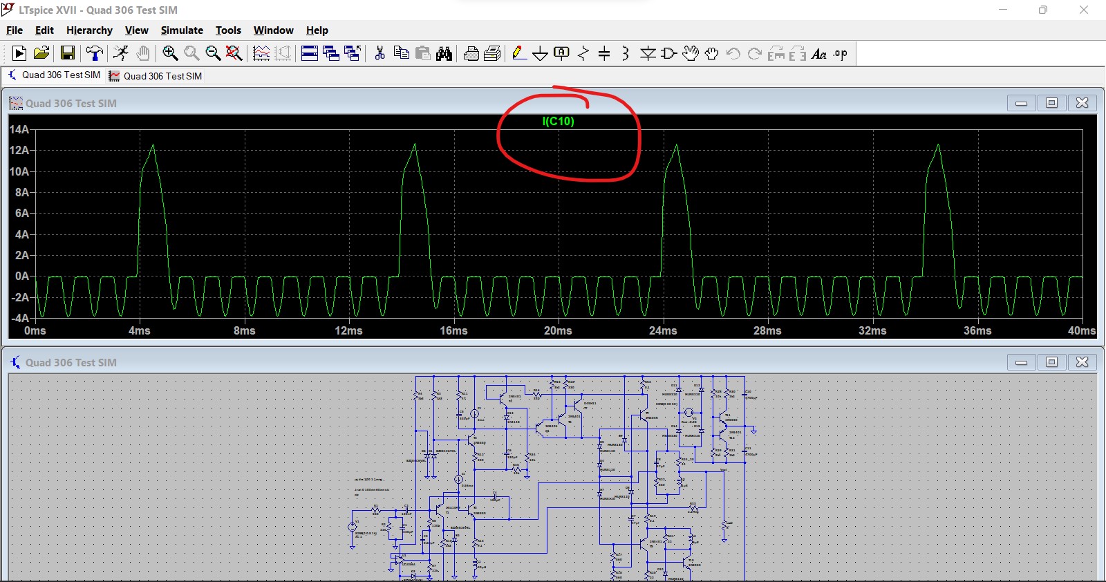

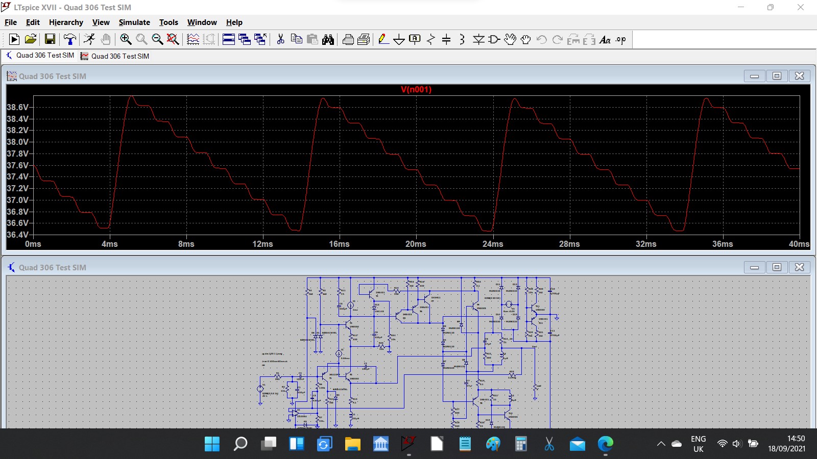

Here is the sim with a simple PSU added. You can see the ripple on the rails and the rails are modulated by the amps output which is delivering around 55 watts into 8 ohms.

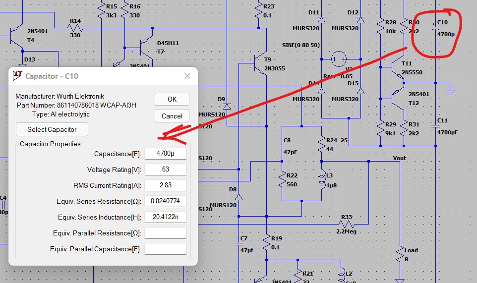

I know using LTspice is a lot to grasp in one go 🙂 When looking at ripple currents such things as wiring resistance and transformer output resistance make massive differences. Also the caps are modelled as ideal in my sim but we can add more realistic parts. For example the 4700uF cap is just that, 4700uF theoretical cap whereas the real one has lots more going on beside.
It all depends on what you are wanting to look at. For frequency response and so on it doesn't matter, for power supply issues it does.
You can right click a part and try and find something suitable from the database or you can simply add typical values yourself.

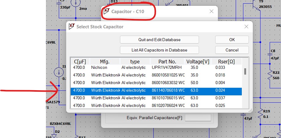

I've found some 6800 caps that are pretty similar on there, but other things such as diodes etc. I'm struggling to find good matches. Some of my diodes are different from stock, D5-D10 are UF4007 in mine. I've found some external component libraries that I'm going through to find better matches.

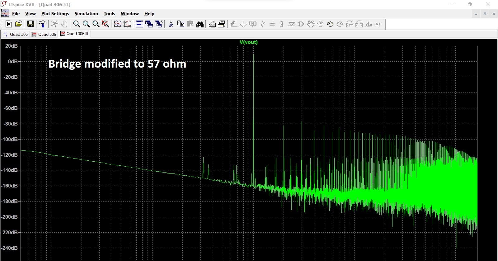

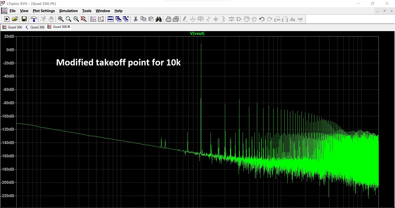

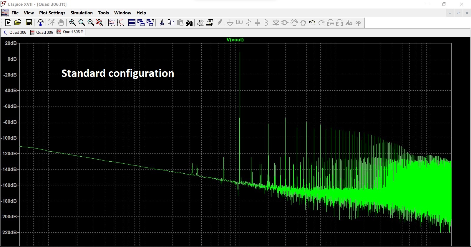

For curiosity I tried the simulation with the 10k mod vs original and then with the bridge mod vs original. No real differences in simulation.
Image 1 is original.
Image 2 is the 10k
Image 3 is the bridge.
You need to look at the amplitude of the main harmonics.
Things like the 10k might even be more related to how the amp behaves at start up and shutdown as much as anything else (noises, thumps etc).
The maths of the bridge is extremely simple: L=RRC. But PJW's original article above states that even a large imbalance there only has a very small effect on distortion.
Image 2 is the 10k
So did Quad make some error in the original design? Have you worked the optimal values out?
