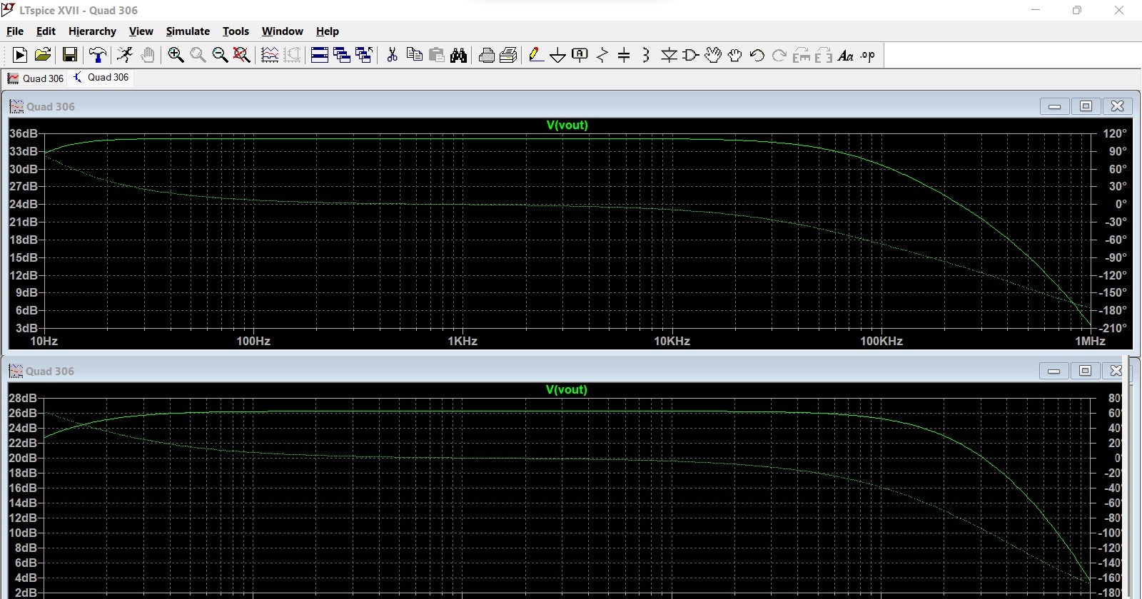

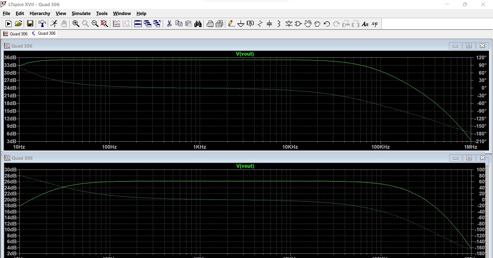

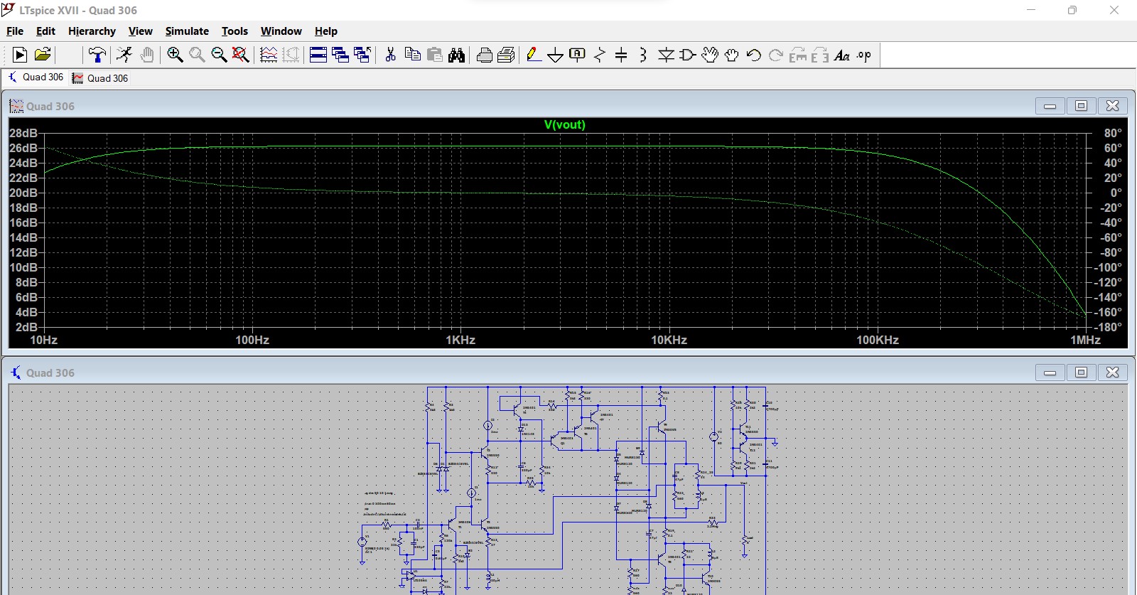

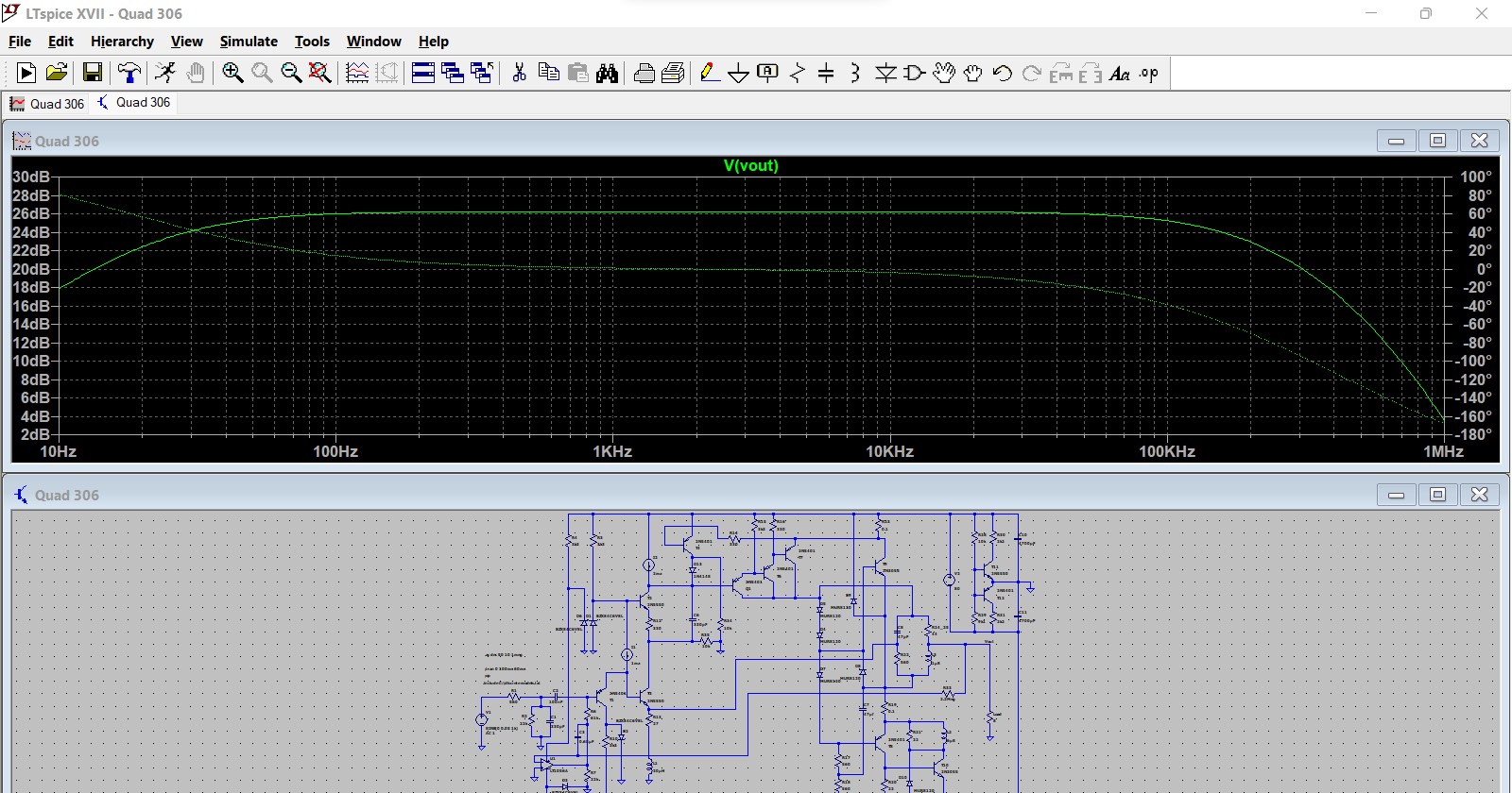

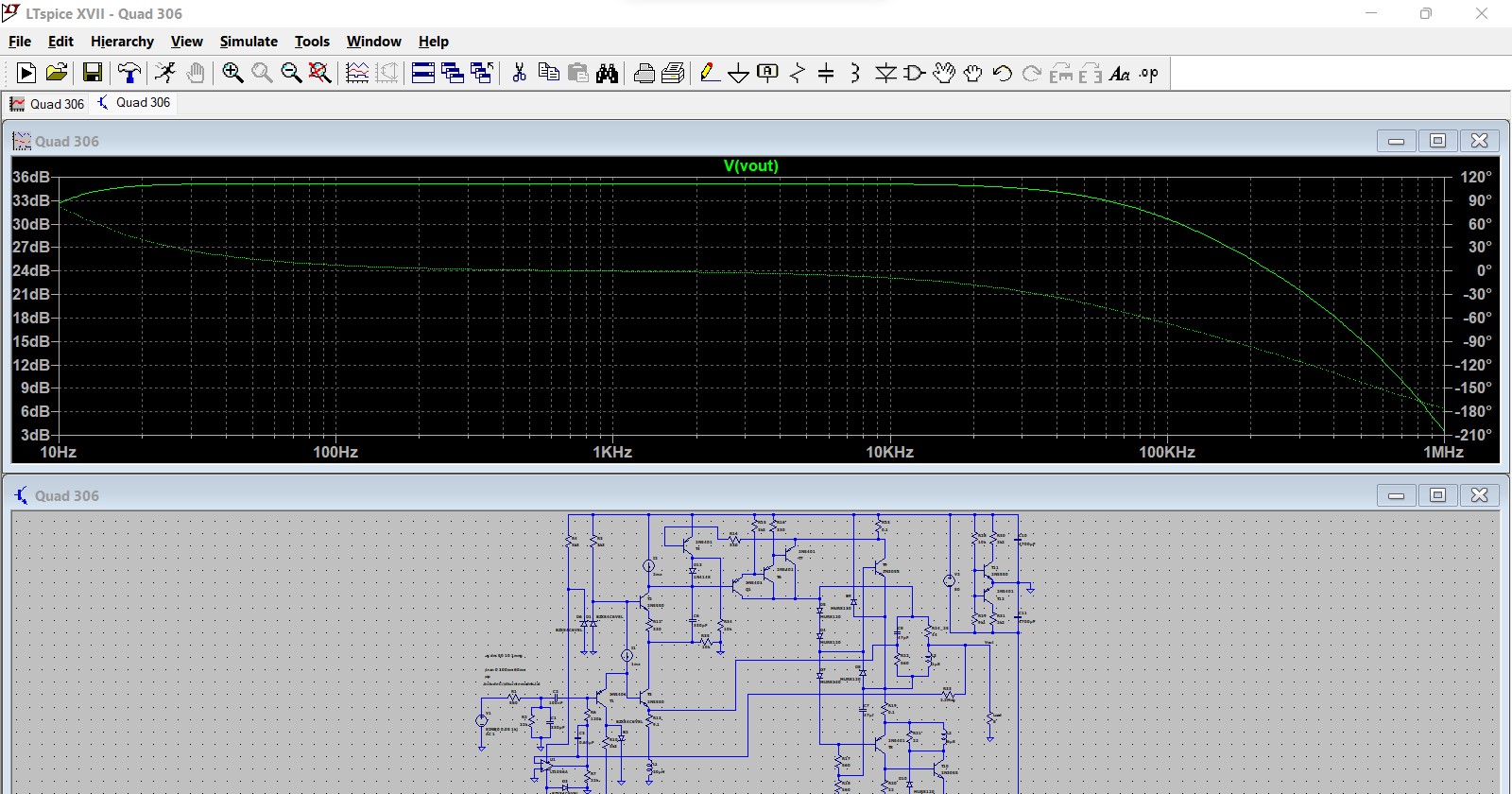

Quite an interesting amp the 306. I was curious enough to throw a rough simulation of the whole thing together.
Image 1 is the standard 306, image 2 is with 27 ohm gain set resistor and image 3 is with 27 ohm plus reducing the 120k to 62k (for some reason I used 61k... that won't make a difference)
Image 4 is standard amp (top half of image) vs 27 ohm (lower half of image).
Image 5 is standard amp vs 27 ohm and 61k.
You can see the HF stability margins remain essentially the same but the reduction to 61k does influence the LF response of the amp which is expected because of the combined effect of the resistor and the 100nF input cap.

The solid line is the amplifier output vs frequency... frequency response if you like. Gain is shown at the left in db. So you can see the effect of increasing the feedback return resistor and the gain dropping.
If you look at the last image you can see the standard amp has pretty much flat gain to around 30Hz while the altered one with 27 ohm and 61k has the gain falling away at about 90Hz.
The dotted line is phase.
I'll have to look at the other mods later, also the sim is one of the more frustrating ones because it has problems 'converging' meaning it takes it a long time to find the operating points and 'solution' to display the results. I'll have to look at that later. I made a couple of assumptions with the current sources CR1 and CR2 which need looking at.
That's why I haven't posted the simulation file as yet It's a tough one to crack is this.

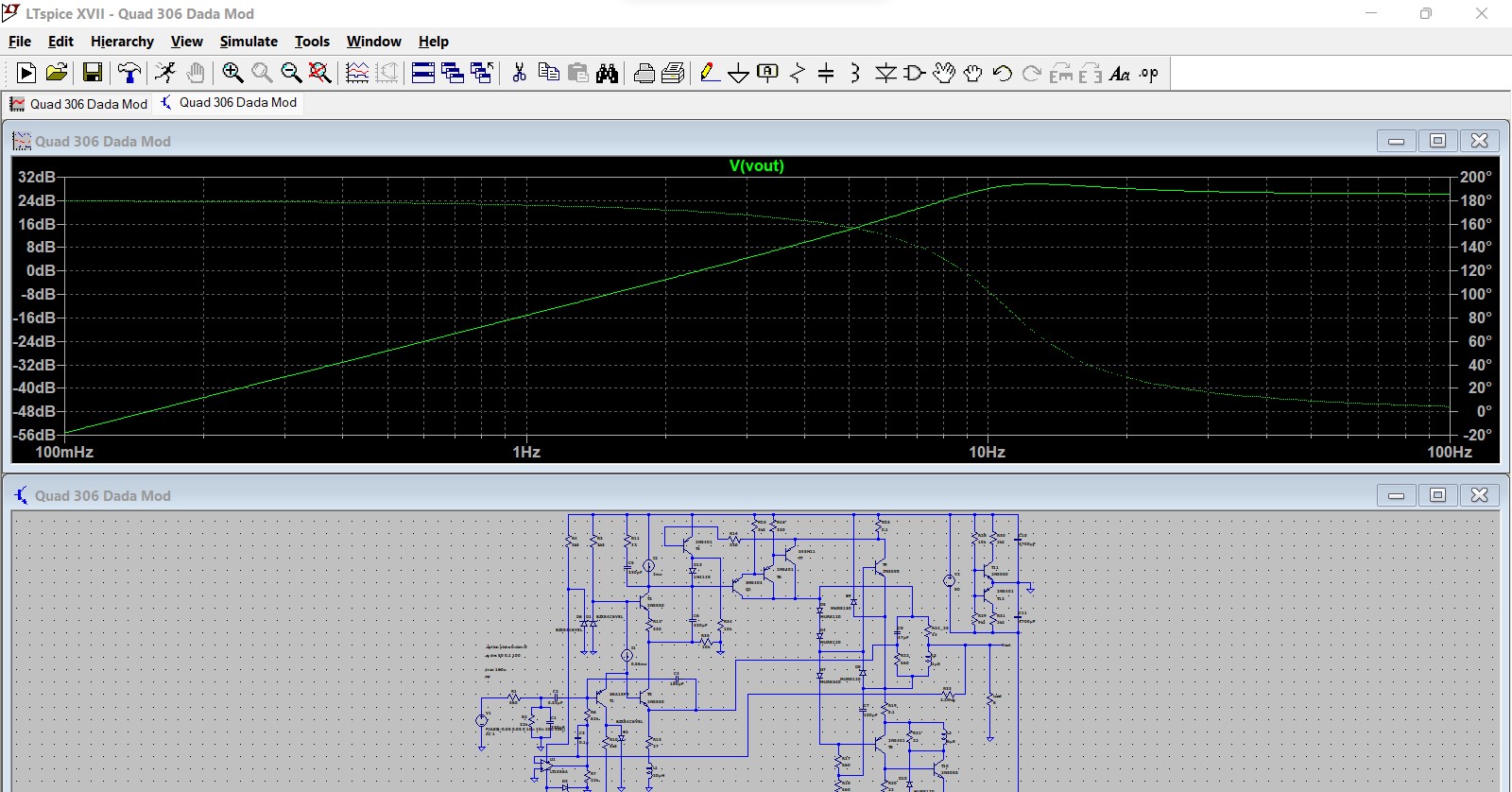

I've altered some of the cap values to match what's actually in mine, and it's improved the bass response (I think).
All default values apart from R13 changed to 27R (R6 still 120K): https://i.imgur.com/STpaGjw.png
Caps changed to match Dada electronics manual, R13=27R and R6 lowered to 62K: https://i.imgur.com/uKqFkAd.png

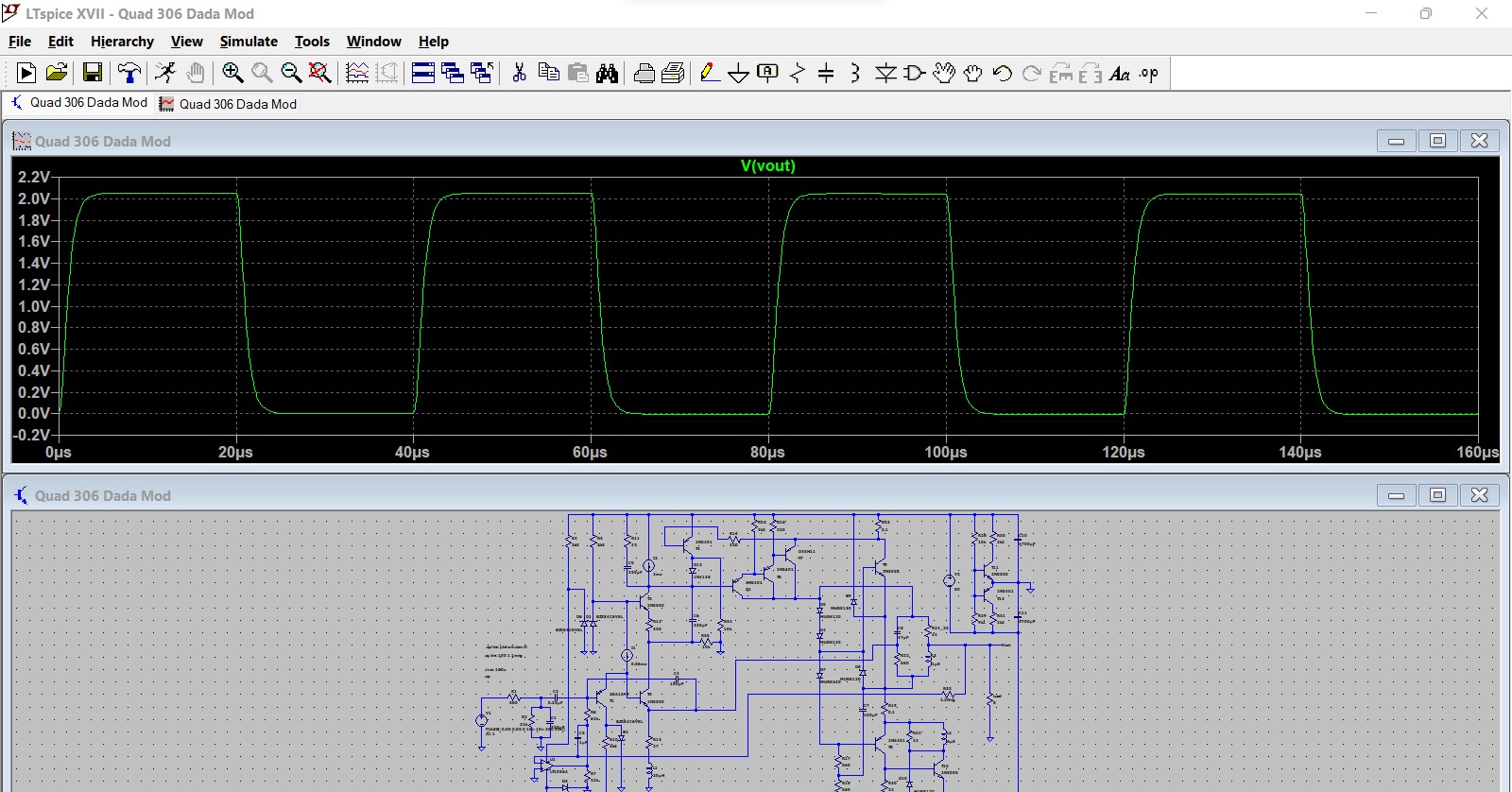

The power supply in the sim is 'perfect' at the moment because it is set up as a DC source with perfect characteristics. If the amp draw 1 Gw (giga watt) the supply will provide it, all without burning a hole in your screen
There is no mains ripple for example but non of that matters for what you were looking at.
A good test on stability is to look at how squarewaves are handled and they look fine. This is with the Dada mods at 25kHz.
Using poly caps for all the tiddlers is a good move.

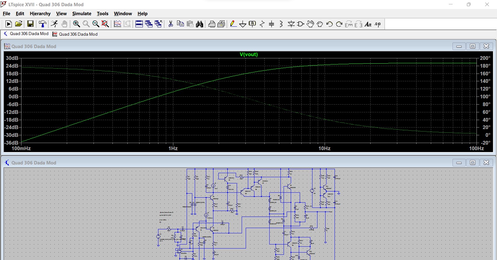

Altering C3 won't do much apart from increasing the time the DC servo around the opamp needs to settle. You can see the effect on LF performance by deliberately making the cap to small and looking at the very low frequency end of the scale.
This is 0.1 Hz to 100Hz and going from 1uF to 0.1uF
