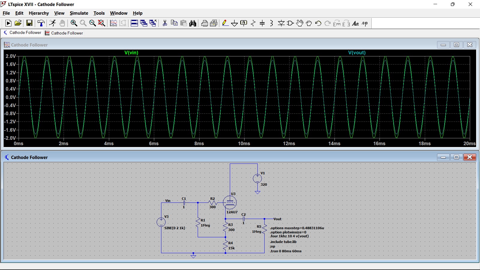

I got some advice on a line stage on another thread, and I'm going to go with a cathode follower design. I'm down to a choice between one from Glassware, a board from another user on here or possibly this Muchedumbre Buffer Preamp – wauwatosa tube factory.

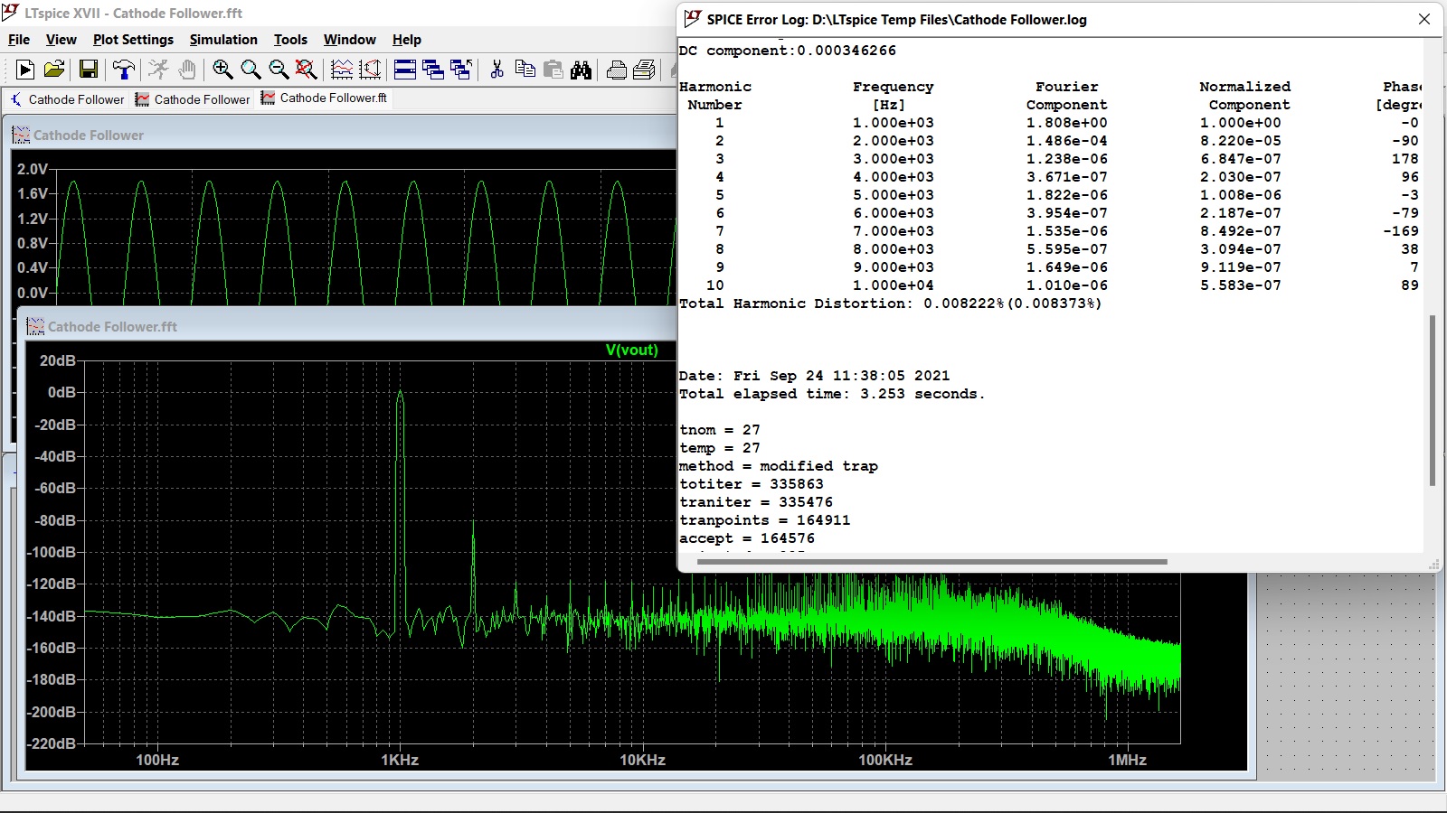

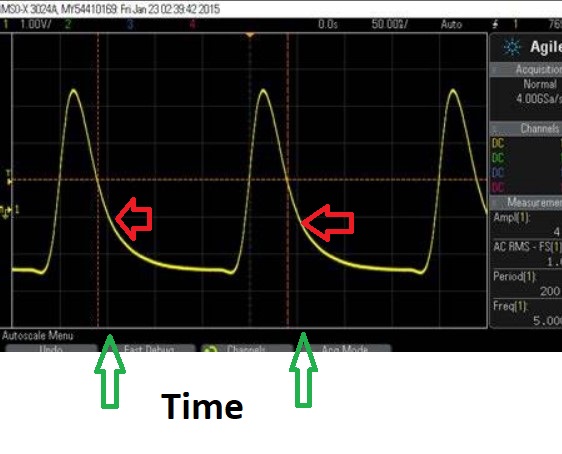

Can I use either my oscilloscope or the frequency setting on my multimeter to determine the frequency of the hum? I've had a google on how to do it, but can't find any specifics. I'm going to have a fiddle now, and see if I can do anything.

A scope is easiest. Just look for the repetition rate by picking any point on the waveform and looking for the next similar point. Count the time between them and calculate the frequency.
F=1/T
So at random... pick any two similar points and count the squares between them. Look at the scope timebase (say 5ms/div) and see how long one cycle lasts. Here it is four squares and so if the timebase were 5ms/div we have 20ms for one cycle.
F=1/20E-3 or 1/0.020 if you prefer which is 50 Hz
Make sure any variable scope settings are in the 'Cal' position.
