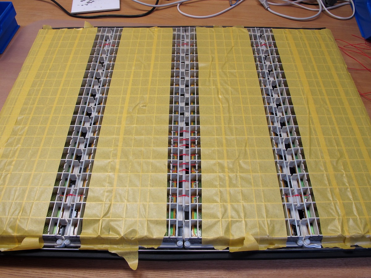

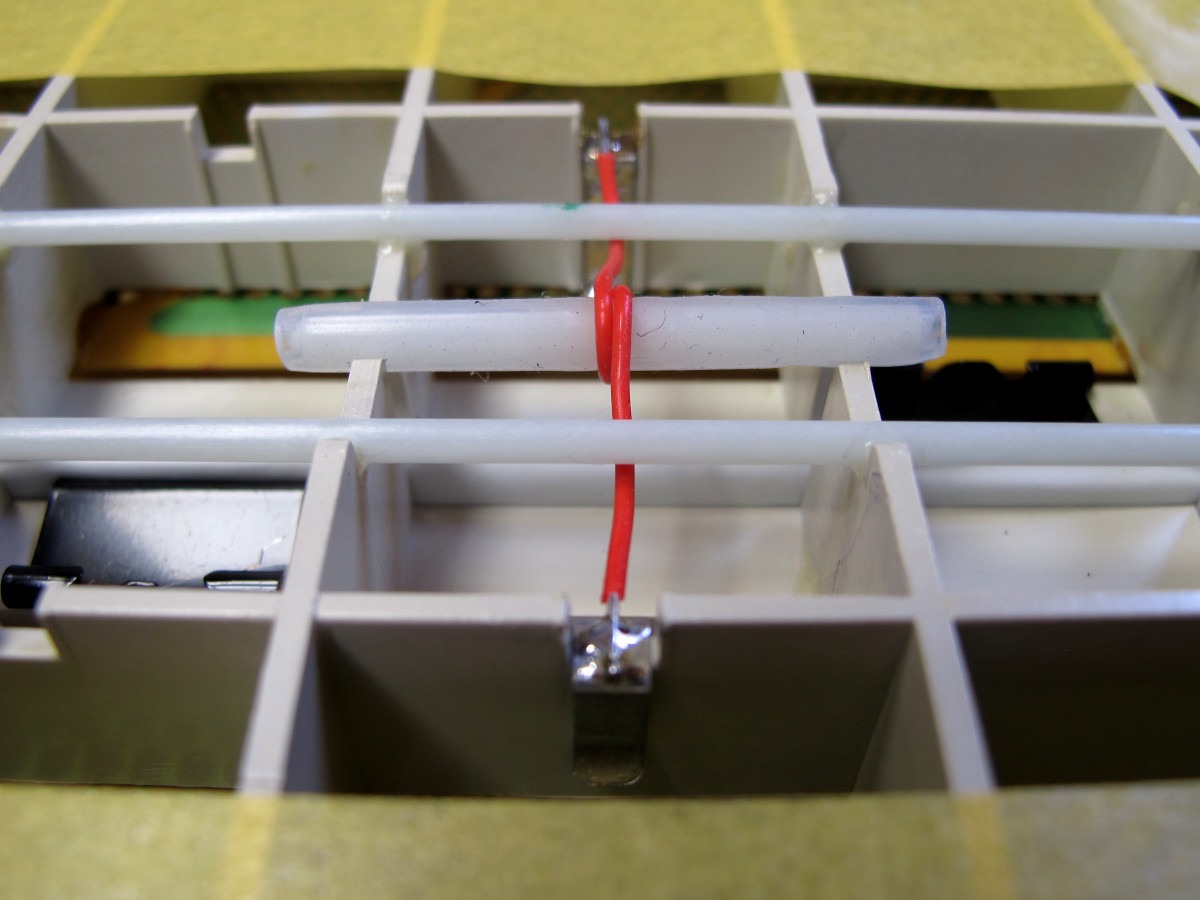

I have a question about the internal wiring, more precisely the blank, curled connections between the panels. They have a turn. The question arises then: What are these turns good for? I could not find any explanation in the net yet about this design detail.

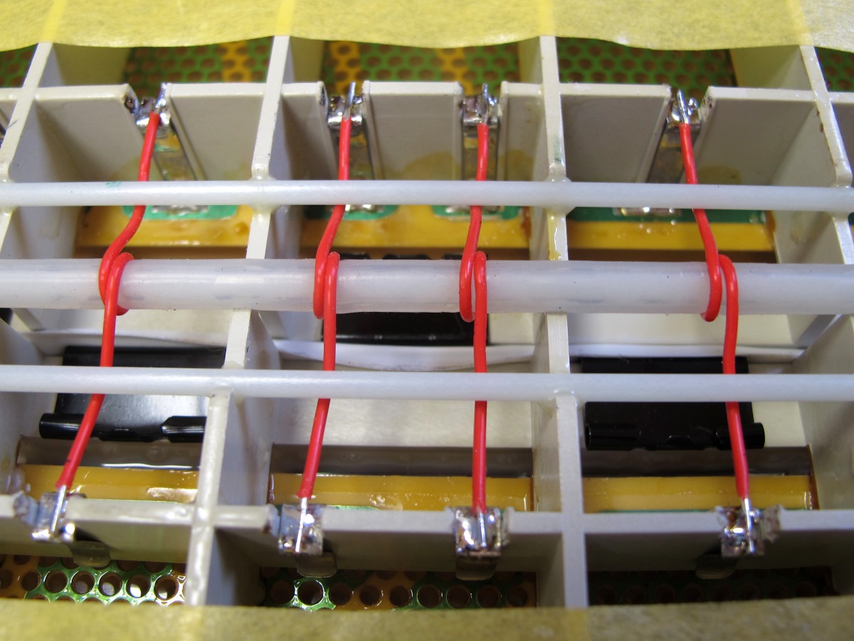

These turn have a drawback in terms of a mechanical resonance. If you gently knock them mechanically, they nicely go doingzzzz doingzzzzz doingzzzz. I guess these resonances can also be initiated by the regular music signal. So in a first go, I damped these turns by felt, in a second one with a bead of silicone, in a third one rewiring the whole setup, making these turns now really silent. These turns now are wound around a fiberglass rod mantled by a teflon tube.
I suspect that it's a matter of allowing a bit of slack to facilitate connections, and tidy the slack away.
By the way, that wire looks like PTFE insulated. If so, hope you are taking precautions, because heating PTFE above about 475 F can generate toxic gasses, including HF.

Finally an erratum: These supporting 2.5mm fiber glass rods I mentionned and showed in the fotos are not manteled with a Teflon/PTFE tube, but with a Silicon tube (2mmx4mm) instead.

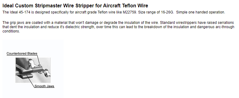

I can also recommend the hot tweezers (I have a set) and Clauss no-nik's which are hard to find except on eBay and the Ideal stripmaster with Teflon blades. I have all of these and use them all depending on what I'm doing. The challenge of soldering to the Quad panels is not dripping solder into the panel. With the right tools and setup its manageable with stranded wire.
This is the best description of the special Teflon blades. I did not know how expensive they are- $350+ for a set. I always bought second hand. They work really well on Teflon as well as PVC.

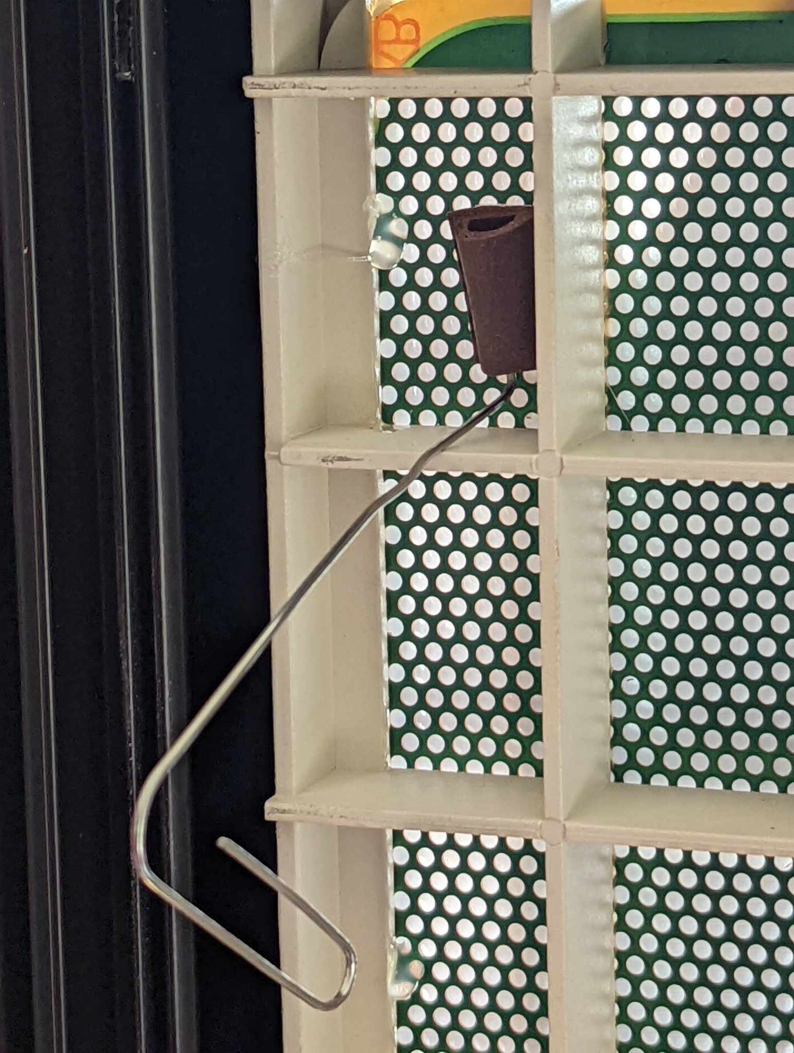

Many thanks to the OP for this guide. My 2805 panels failed after ~15 years, and I was able to inject new life into them as shown in these photos without dismantling the guts of the speaker. They've been running well for some weeks now so I thought I'd share this method in case it helps anyone avoid more hard labor.
It turns out our $9000 speakers were held together by good ole bookbinding glue, aka polyvinyl alcohol, in other words hot stick glue from the crafts store. When I took off the dust cover there was a strong smell of "old library". Surely the extra $0.02 on the BOM for a few dabs of quality epoxy would have killed them profits. The problem with PVA is it turns brittle and cracks, especially quickly at elevated temperatures. Black speaker in the living room in sunlight, planned obsolescence if I ever seen one.
The failure mode is that the green circuit boards come undone from the hard plastic grids that keep them at the correct distance from the membrane, and some want to curl in towards the membrane, causing arcing that will eventually destroy the speaker. In my case the speakers were sitting unused in storage for a couple of years, and when I powered them up I immediately heard the arcing and shut them down. There were no obvious perforations on the membranes that I could see. Some minor perforation will most likely have no audible effect; I'm not sure at what level of damage would one decide to rebuild the whole thing.
What I did was:
Find some weather striping with strong self-adhesive tape and a hollow profile into which a paper clip can be inserted.
Very gently tack a short strip of the weather striping onto the circuit boards near the corners where they curl in toward the membranes. Bend a paper clip so it can be used to pull onto the weather striping. The idea is to pull the circuit board back out toward the plastic grid while applying a dab of hot glue to hold it in place temporarily. Once the hot glue has cooled pull off the weather striping. Repeat this at every corner where the circuit board has separated from the grid.

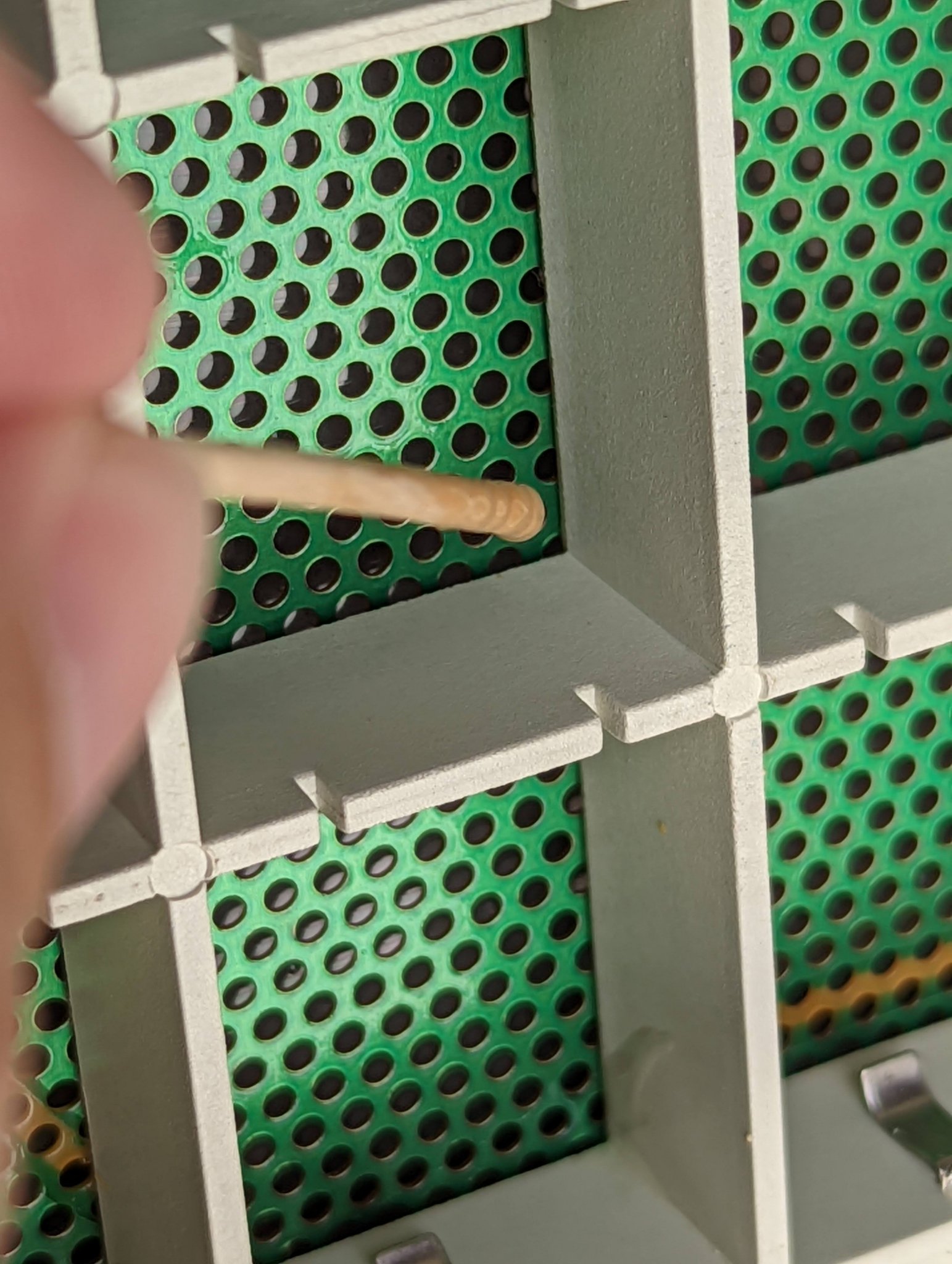

Once all of the circuit board is at its correct distance, touching the plastic grid, mix up a batch of slow epoxy and use a toothpick to place a tiny dab at most corners of the grid--especially the ones on the periphery. Let the epoxy cure for > 24 h before putting any stress on it, and surely it will outlive most of us.
YMMV and all that; for me this was well worth the effort so far.

In this way, as it is done by some/several/many repair companies and DIY persons, you have no control over, and no way to check how even the stator is glued to the grid because of the old glue remaining, no matter how hard you pull.
This means there can/will be differences in distance between stator and diaphragm over the surface.
Please don't say you can see it is even, because we are talking maximum of 0,2 mm difference allowed. You can't see that wit the naked eye.
No idea where all that temporary hot melt glue goes through the mesh?
It is a painstaking job that has to be repeated for x ribs on 16 or 24 grid panels sides,
One slip of the paperclip on the non mesh side (if you don't open up the panels) and you perforate the Mylar.
So as you might expect, prefer to take apart the stator completely, clean it thoroughly and start from scratch with new glue and new Mylar.
