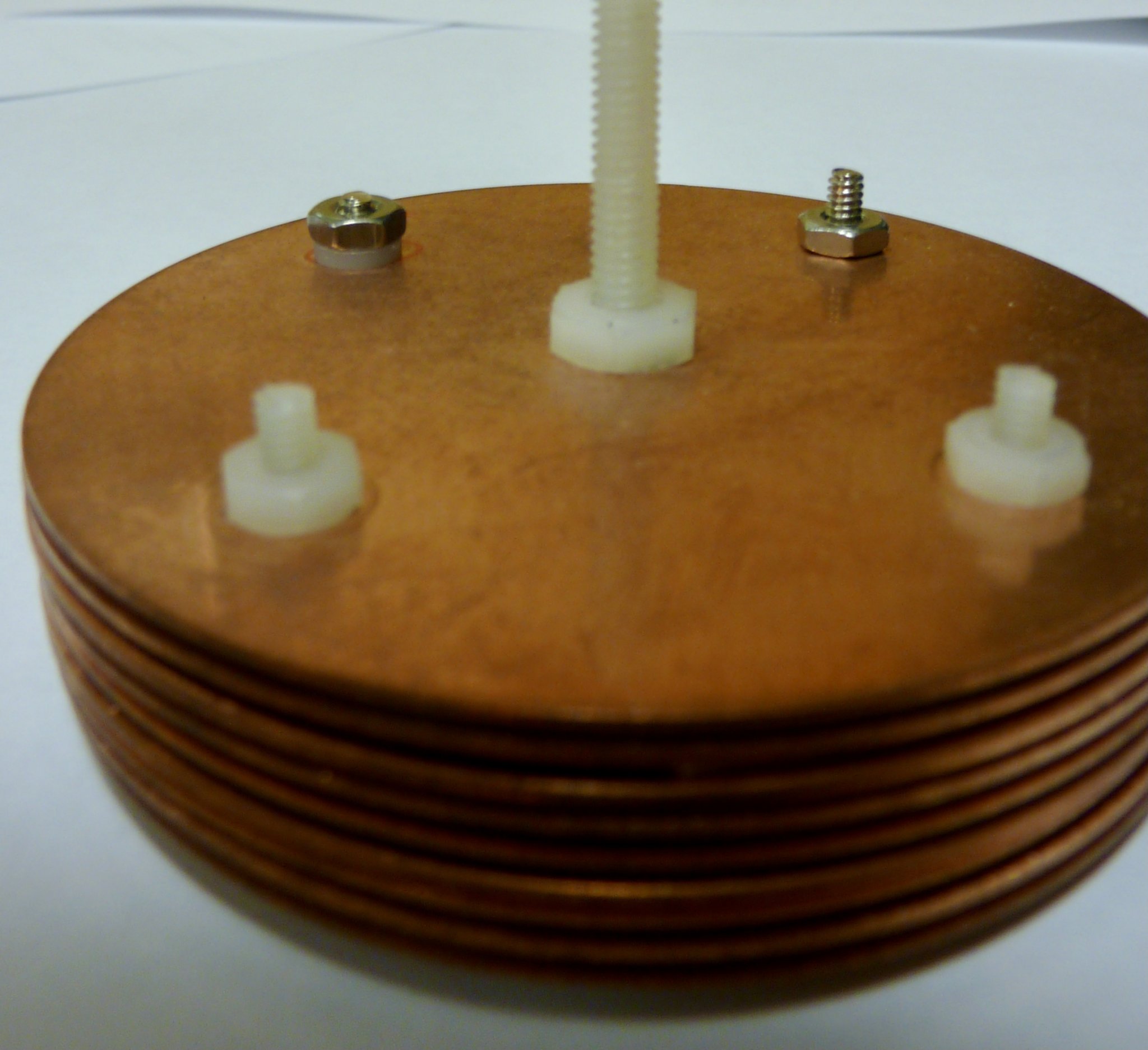

This is a copper air gap capacitor that I made for another purpose, but it shows the principles. Pretty obvious, ain't it?
The discs are 2.75" in diameter, assembled on five pillars. The central pillar is for mounting. The two white nylon pillars are for stability. The two metal pillars are for stability and serve as the terminals. Separation is done with small thin washers of preferably PTFE, or nylon, threaded onto the pillars.
This is a low voltage piece measuring 700pF, for another purpose. For the Quads, smaller discs and more air gap is used for 22pF and 10pF at 5kV.
