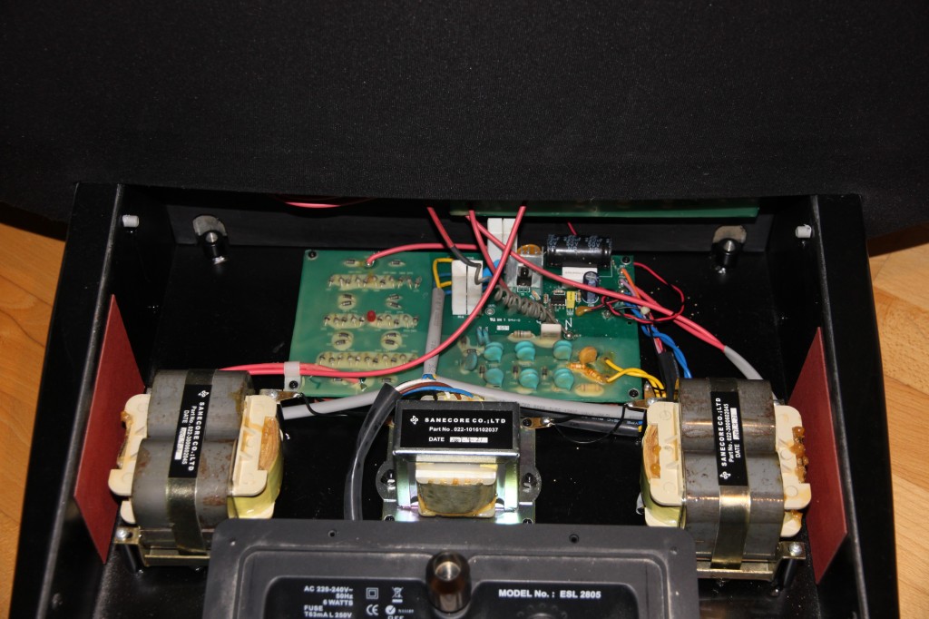

Any pics of the electronics ? Hear lots about swapping capacitors in these but it would be good to know which and how accessible they are.
Not sure what you are hearing, but here's the lay of the land on the caps in a modern quad:
The majority of the capacitors in the speaker are high voltage ones. That gives you some very limited choices in swapping.
There's a bunch of 22pF caps in the delay line and a line termination capacitor of 1320pF (made up of 4 330pF ones). These are all high voltage caps. The very early quads used a different style of cap like a simple two plate glass cap. Some people say these sound better, I've never heard a significant difference but I've not spent much time sweating it. These are undoubtedly effecting the speakers sound, but I like the sound so I'm in no hurry to change them.
There are 14 20nF ceramic caps and a 47nf film cap in the power supply. The power supply is effectively completely isolated from the audio part of the speaker unless the neon bulb is in the middle of a blink, so changing these should make zero difference to the sound quality,
In the audio input and clamp circuit is where the caps that should be changed are. And this gets into some serious religious wars here. The important one to change regardless is the power supply filter capacitor. In every model of the modern quads, this is a 1000uF 16V unit. In the USA, the clamp circuit power supply is running right at or slightly above 16V. Change this while you are in there. I replace it with a 105C long life 1000uf 25v cap in every speaker I work on. Some of the later models (2912 etc) have already changed this to 25v. If that's the case you don't have to worry about it as much.
The audio signal enters the speaker through a 220uF bipolar electrolytic cap with a 1.5ohm resistor in parallel with it. replacing it entirely is tricky because a 220uf film cap is a coke-can sized unit, It will fit into any of the quads after the 63's. But it won't be a clean install by any means. What I do is add an 8.2uF polyprop film cap in parallel with the bipolar electrolytic. That can be zip-tied to the 220uf cap and will fit nicely in all speakers. Is it as good as replacing the electrolytic entirely, probably not, but it's mechanically so much better that I go that route.
The last cap in the signal path is a 1.5uf film cap in parallel with the primary winding of the input transformer. I replace this with a 1.5uf polyprop film cap on the 63's because that weird cap on the clamp boards sometimes fails in weird ways. For example it makes the speaker sound distorted at high volumes but not at lower volumes.
There are a couple small film caps for the antenna and clamp circuit but they are not associated with the audio signal in any way. And should not be changed unless the clamp circuit is not working

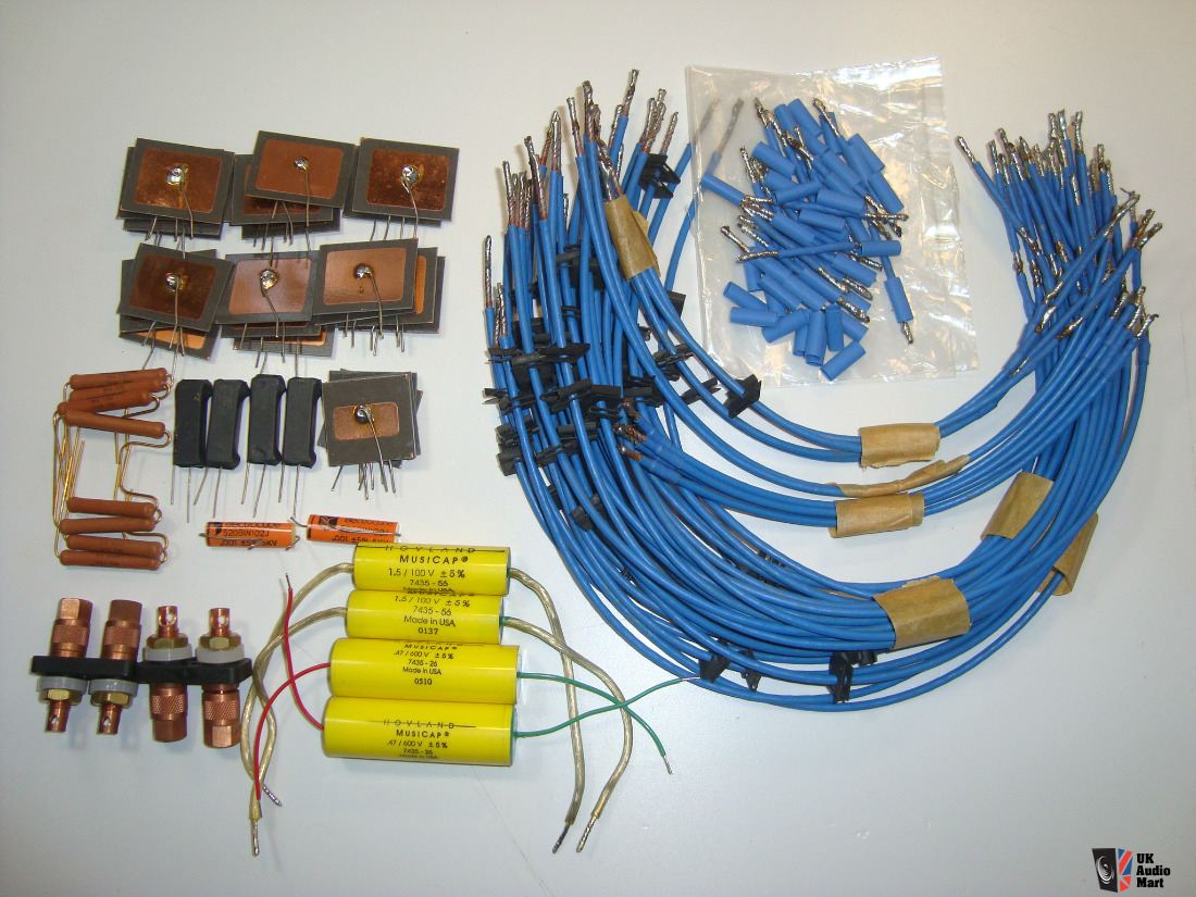

Would love to see how those Teflon caps look.On the Crosby mod we rebuild the delay line caps using Teflon PCB material. Its a pain to rework that but the original ceramic caps are not the most linear. We used a product called corona dope to cover the exposed metal. It's also important to not have any sharp edges on any of the high voltage connections or you can have corona discharge.
I made these for the 330 multi plate, for the 10 and 22 single plate.
Amazon Photos
They are definitely Teflon. I have the rest of the PCB material in my storage. Its .025" material I think. Its pretty thin.
I have not seen one of those kits in many years. The wire is a real PITA and not something I would do that way. BUT Richard Lees was convinced it made a big difference.
Ah I see, so it is PCB material which means Teflon enforced with ceramic material or fiber glass as used for HF PCB boards by Rogers and others.
It is a Rogers material. It was expensive and hard to get then. Same with the dustcover film. Probably easier today. But still expensive.
That wire and those links should be considered a hate crime...
