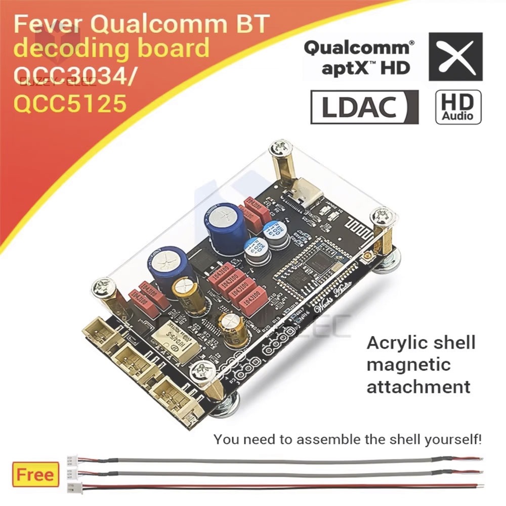

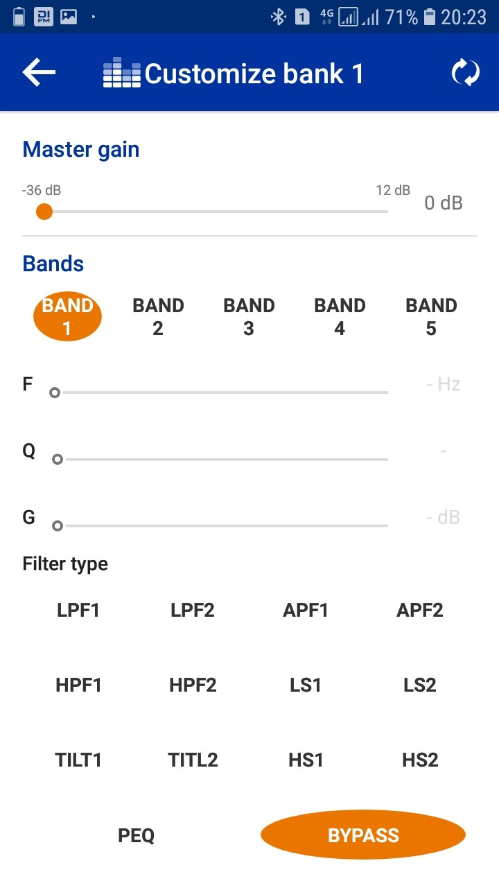

Hi, I have a question about changing the EQ bypass enable/disable parameter.
I have two of Wuzhi Audio's QCC5125 & PCM5125 BT receiver boards sold here:
https://id.aliexpress.com/item/1005006238395176.html
To change the EQ setting for my speakers, I followed the steps shown in the tutorial "How to change the QCC303x series Bluetooth EQ settings" on the TinySine website:
https://www.tinysineaudio.com/blogs/news/how-to-change-the-qcc30xx-series-bluetooth-eq-settings
I got no issues from the beginning through step 3 in "3. Save QCC30xx series Bluetooth EQ settings."
I successfully changed the EQ setting on the QACT tool and then saved the parameters using QCC_Audio_Tool.
However, the ADK_Configuration tool cannot connect to the board by USB.
The EQ setting changed the sound on the QACT tool in the monitoring mode (Full), but when resetting the board after writing the parameters on QCC_Audio_Tool, the EQ setting was not working, and the QACT tool read the parameters that I had written with QCC_Audio_Tool.
How can I get the ADK Configuration tool connected to the board and configure the parameter?
Maybe I need the same version of the ADK tool used for the development of this board, but so far I haven't got any info.
Is there a config xml file for this board? or should I need an SPI connection? any help is welcome.
Alternatively, is there any other means of disabling the EQ bypass parameter on the firmware?
Thank you very much!
FYI, All tool versions are the same as shown on the tutorial webpage.

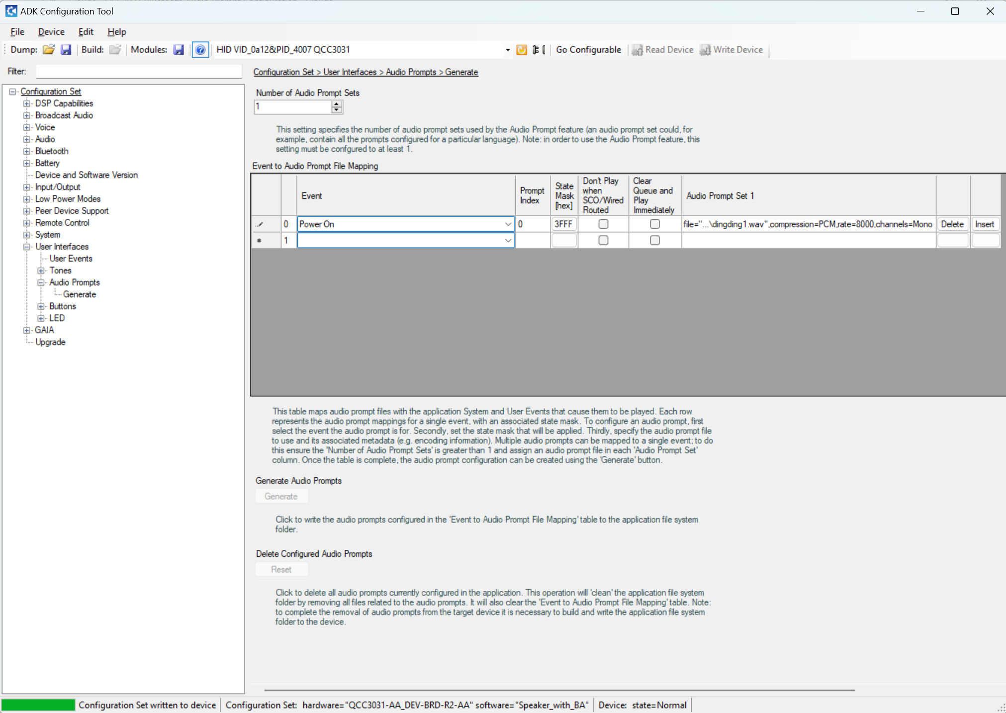

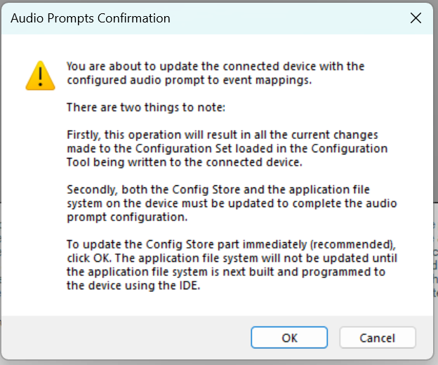

Not sure if this is possible but I've been trying to generate custom tones for the QCC3031. I'm connected via USB debug. I'm also unable to connect to QACT but I'm not really worried about that. This is for a TSA8804 although I had better luck burning the firmware for the TSA6179 as part of the requirements is to have multiple devices connected (party mode) and the firmware for the TSA8804 doesn't allow this. Right now I am happy with almost everything but it would be super cool to have some custom sounds when the amp turns on.
I am about to generate and it shows a message box with the message:

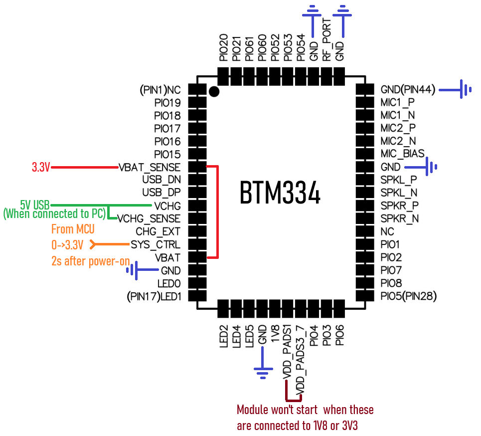

I have this module - BTM331.
965189d1625655918-qcc5125-qcc3034-qcc3031-programming-qcc3031_1-jpg
965190d1625655918-qcc5125-qcc3034-qcc3031-programming-qcc3031_2-jpg
I would like to ask you to share your experience, how connect this chip to USB? How configure DSP Kalimba on this chip by USB?
On USB we have 4 pins
  • GND,
  • Data+
  • Data-
  • +5V
And we have pins on QCC3031(BTM331):
  • VBAT_SENSE
  • USB_DN
  • USB_DP
  • VCHG
  • VCHG_SENSE
  • CHG_EXT
Which pins from qcc3031 I need to connect to USB pins?
As I understood Data+ and Data- from USB need to connect to USB_DN, USB_DP from QCC3031.

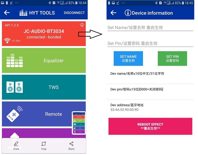

Hi all, I have updates about configuring QCC3034, and let me share those with you guys.
First many thanks to @hvmcsa, he shared with me qcc_tool where I can change the name of the chip.
Second, about backup. I understood how backup original firmware. You need to use NvsApp.exe in BlueSuite. And it works. I backed up the original firmware with this tool, broke my chip after MDE deployment, and successfully restored it from backup. Rule #1 before any changes do backup!
Third, about Kalimba DSP. You can config DSP with the QACT tool. Need to enable chip, connect to it with Bluetooth and USB, and run some audio, that gives you enable online configuration. But I have some problem with that, I can't save config on my chip. After rebooting the chip all settings became the default. And I don't know how to fix that.
How save DSP settings on the chip after reboot?
Could somebody help me with the correct orders and steps to save DSP config?
Thanks.

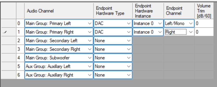

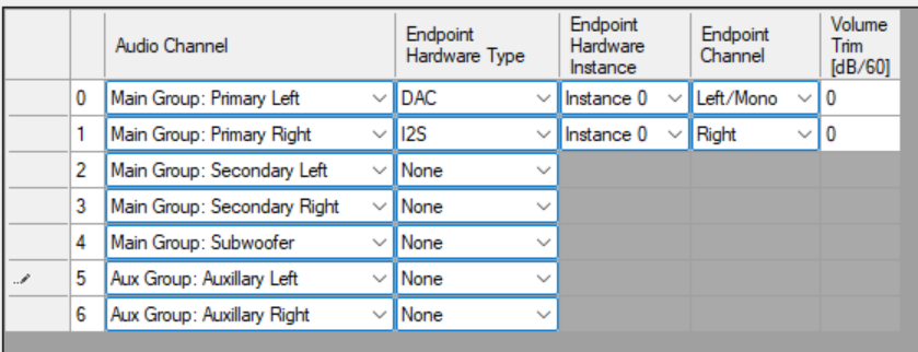

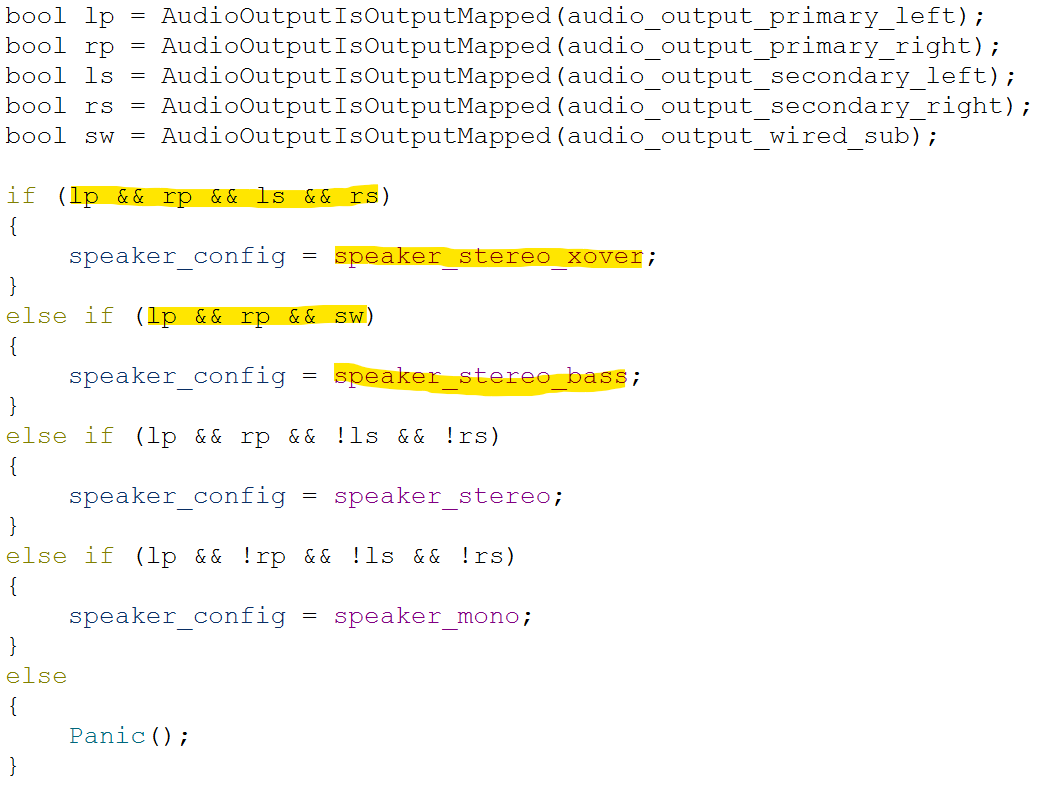

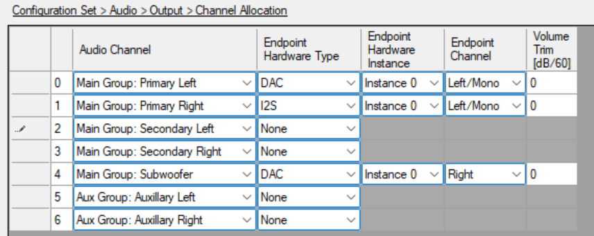

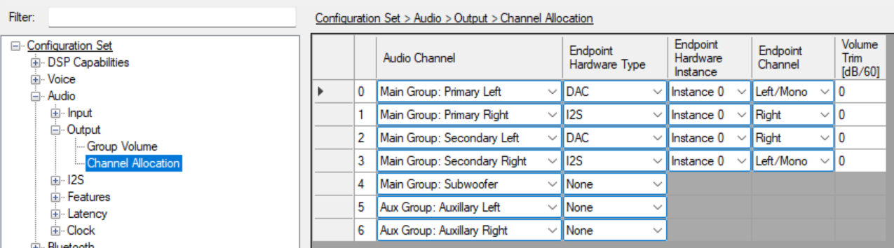

I am now able to configure qcc3031/34 modules so that the xover DSP module is activated and used. For that I have to configure three or four output channels, double stereo or stereo+sub.
To do that I have to configure I2S and DAC output together although I am only using the DAC outputs:
Unfortunately that leads to sporadic distortions (on DAC outputs). Sound is perfectly fine but has bad distortions (sounds digital) every 30 seconds or so.
If I configure only DAC or only I2C there are no distortions ever:
It seems like they only occur if DAC and I2C are outputs are used together, even with only two outputs configured (primary left->DAC left, primary right->I2C right):
DSP still has 20-30% free, doesn't seem to be the bottleneck.
I2S pins are not connected on the module and floating.
Has anyone experienced something similar?
Or has anyone used I2C and DAC outputs together without issues?
I have been doing exactly this with QCC3008 for quite some time now without any problems.

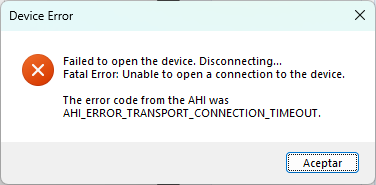

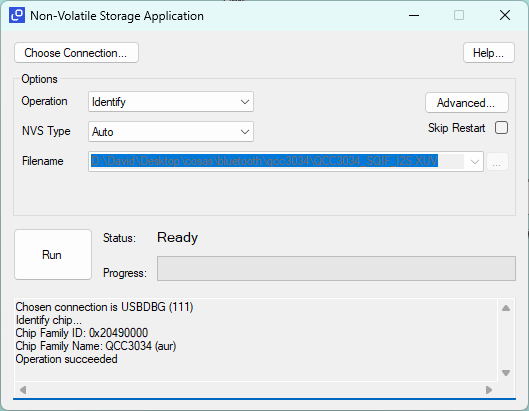

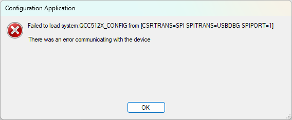

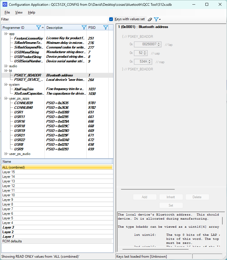

Hi guys!
Some time ago I played with CSRA64215 and QCC3005 modules, finding the software and their correct versions was a bit messy but no terrible.
Now I got a BTM334 QCC3034 module and I'm having plenty of issues.
So far:
- I unlocked the module,
- Only ConfigApp from BlueSuite 3.3.18 worked properly, I downloaded from here: https://disk.yandex.ru/d/vB-9qaWN74XXIQ/qcc5181
I can change the device name there without bricking the module.
Older versions like 3.3.3 only recognized few keys and bricked the module when writing.
- NvsApp works, I can write and read the flash just fine:
- ADK Configuration Tool from ADK_QCC512X_QCC302X_WIN_6.4.2.26 also detects the module, but fails when loading the definitions:
This is a real bummer as I wanted to modify the leds /buttons behavior.

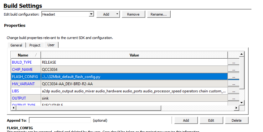

- I downloaded MDE WIN 2.3.2.126, I can build the QCC3034 Sink app...
However this module has a 32Mbit flash and the project comes with 64Mb by default.
When changing the flash config to 32Mbit the firmware deploy fails because it doesn't fit in the flash partitions.
I've removed almost everything from the options, still not fitting.
Under project config, I set STRIP_SYMBOLS to TRUE and BUILD_CONFIG to RELEASE.
I modified apps\applications\sink\32Mbit_Default_flash_config.py like this, now everything fitted.
"flash_device": {
"block_size": 64 * 1024,
"boot_block_size": None,
"alt_image_offset": 32 * 64 * 1024
"encrypt": False,
"layout": [
("curator_fs", { "capacity" : 1 * 64 * 1024, "authenticate": False, "src_file_signed": False}),
("apps_p0", { "capacity" : 9 * 64 * 1024, "authenticate": True, "src_file_signed": True}),
("apps_p1", { "capacity" : 7 * 64 * 1024, "authenticate": False}),
# Device config filesystem size limited by size of production test buffer, ( 1024*2)-10.
("device_ro_fs", { "capacity" : 1 * 64 * 1024, "authenticate": False, "inline_auth_hash": True }),
("rw_config", { "capacity" : 1 * 64 * 1024}),
("rw_fs", { "capacity" : 1 * 64 * 1024}),
("ro_cfg_fs", { "capacity" : 2 * 64 * 1024, "authenticate": False}),
("ro_fs", { "capacity" : 10 * 64 * 1024, "authenticate": False})
But, this doesn't work at all, the module dies and I have to restore it with NvsApp...
However, leaving the default 64Mbit config does work!
I can't really understand why, the flash chip has a very clear marking, "25U3235" (32Mbit)!
Did anyone got ADK Tool to work?
About the FW sources, there's any API/ FW docs I can read to undertsand how everything works?
It would be great if I could inteface the module with a MCU using a serial port...
Cheers!

Got it working after swapping the flash with a 64Mbit one, but this was far from optimal.
I kept tweaking the partitions, got it working on 32Mbit with this config:
(apps\applications\sink\32Mbit_Default_flash_config.py):
Code:
    "flash_device": {
"encrypt": False,
"layout": [
    ("apps_p1",         { "capacity" :  8 * 64 * 1024,  "authenticate": False}),
    ("ro_fs",           { "capacity" :  9 * 64 * 1024,  "authenticate": False})
Update: It's been impossible to use ADK with 32Mbit flash.
The partition hacks above made it to compile and work, but ADK crashed when connecting.
Updated to 64Mbit flash, everything works.
I simply replaced the flash, the debug interface still worked, I could upload the new fw without major issues.
It seems to me they cheapened on the modules, as all the pictures show a 64Mbit flash, but you get 32!
I'll buy these: www.aliexpress.com/item/1005001412682635.html
Note that it must be 1.8V flash! (W25Q64JW) W25Q64JV is 3.3V-only!
There was a bug in Gaia EQ, the settings were gone after powering the module off.
I found the solution here: https://www.52bluetooth.com/thread-84921-1-5.html
I'm posting the code here just in case, but it didn't work!

Oh wow, I like that post in the past, but windows machine, not on app store, qualcomm descriptions.. looked bad. I'm connected though! Countdown to firmware request has began lol Nice!
If only I could work it..
More to follow..
Opening page, and the page that opened. It looks right, but I'm more nervous than a first date
So I wrote in ROKSAN (as it's going in a Roksan) and pressed the set name button. Back page. Same name. Forward page, reboot effect button. Back page. Disconnected. Wouldn't reconnect. Cycled power and app, connects again. Phew! but the Roksan name only appears on that second page, in the middle, where it says Dev name/*#@<10.. it now says ROKSAN underneath. So this looks like a naming scheme for the app, when you have many devices to tell apart. Not to give the device a new name to broadcast
The audio section looks okay. Filters and stuff. Not dug in yet

I made a small board, I think I did everything in the same way as I had in the wired prototype, but clearly I missed something out.
The module doesn't start when VDD_PADS are connected to any power. I tried both 1v8 and 3v3.
I recall having these pins connected to 3V3, VBAT and VBAT_SENSE as well.
If I connect the module with to the USB and issue a reset with NvsApp, the module starts working.
If I leave these pads floating, it also boots properly.
I use a MCU to control the module, SYSCTRL pin is tied to ground and delayed for 2 seconds, then set to 3.3V to start the module.
In that moment the module enables the 1V8 regulator and it should work... but it doesn't.
I'm sure this approach worked well before!
What I could I be doing wrong? Thanks!!
