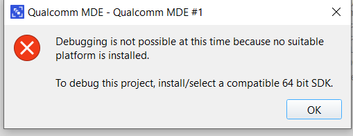

Still for some reason the v6.6.2.26 is x86 and i get an error message when I try to debug (play button) using this version:
This error doesnt appear when using the older toolkit, which was made for the 303x.

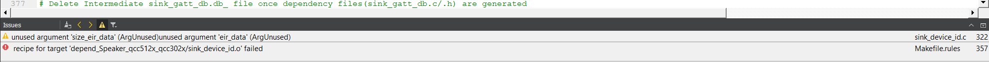

That said, I also get console errors when building with the newer ADK:
Generating GATT database
<command-line>: error: macro names must be identifiers
Assembler messages:
Fatal error: kas: preprocessing failed for : ..\..\sink_gatt_db.db
C:\qtil\ADK_QCC512X_QCC302X_WIN_6.4.2.26\tools/Makefile.rules:401: recipe for target 'PHONY_GATTDBGEN_..\..\sink_gatt_db.db' failed
make.exe: *** [PHONY_GATTDBGEN_..\..\sink_gatt_db.db] Error 1

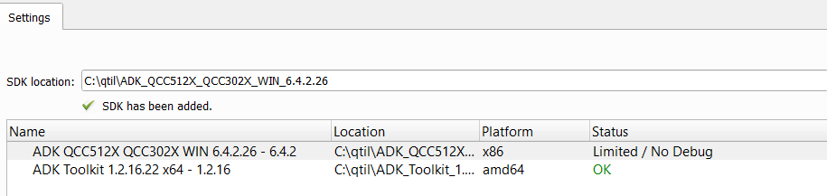

Gist is if you are using a 64-bit version of windows both the MDE and ADK compiler versions will matter, You will need specific combinations of both
Thank you @mahaju and @ntlagarde , it looks like MDE v2.8.0.37 is not compatible with this ADK version or something. Installing the 2.3 version solved the issue. @ntlagarde I don't know what this .SDB file is for, apart from changing the bluetooth name with the configuration app.

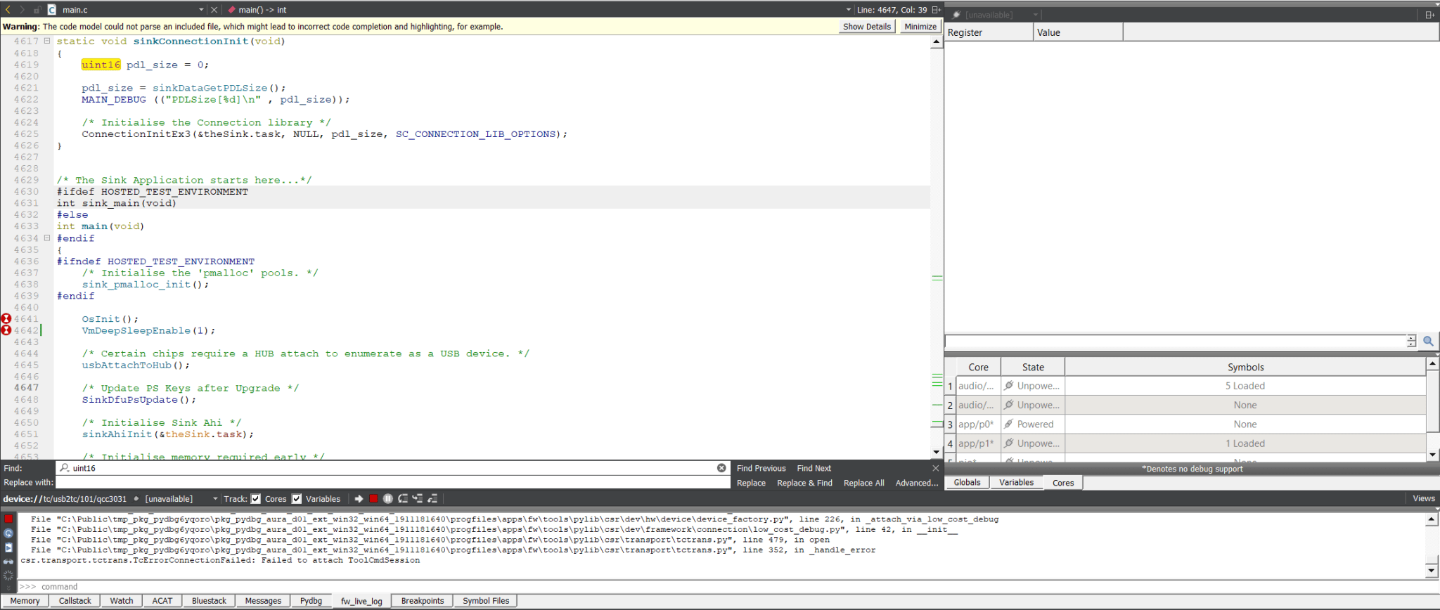

Now, I am not sure if the chip is actually running, because I can't see any register values. There is also a tag saying "unavailable" which I am not sure what that means. I am a bit lost with this IDE, I pushed the play button on PyDbg which I guess is some kind of Python debugger. This is what I have so far:
I am connected over USB only, but I have a CSR debugger, which maybe is necessary for real-time debugging?
Btw, I thought it may be a good idea to open a discord server for this topic, but I don't know if many of you would be into making custom firmwares for QCCs. I will be working with these for long because I need to make some specific features for a project. If you like the idea hit the like or give me some feedback.

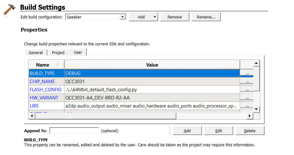

If I remember there is a "debug build" you need to do in order to be able to stop at the breakpoint and see the registers. It looks like the chip hasn't stopped at a break point which is probably why it says unavailable and the registers window isn't showing anything. I think there is a pdf file about debugging that shows a basic example. I suggest you find that file and follow every step to get an understanding on how the IDE's debugging options work. The python debugger will let you do a lot more but I don't think you will be able to use it as a complete beginner. Try getting the IDE to stop at a break point and looking at register values first.
I also suggest using the passthrough (loopback?) sample program instead of the Sink (headset?) project to practice single step debugging. I think there is a pdf file on how to run the loopback project.
I guess this option is set here, it was like that by default:
Exactly, this is what I was trying to do first, just simple breakpoints to see if the program is running, but it's not stopping.
Maybe it has to do with these issues showing on the build log (i think it is not completely building):

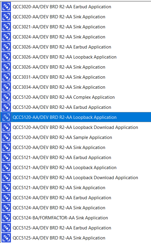

Hmm... the bad thing is I don't have a loopback project for QCC3031:

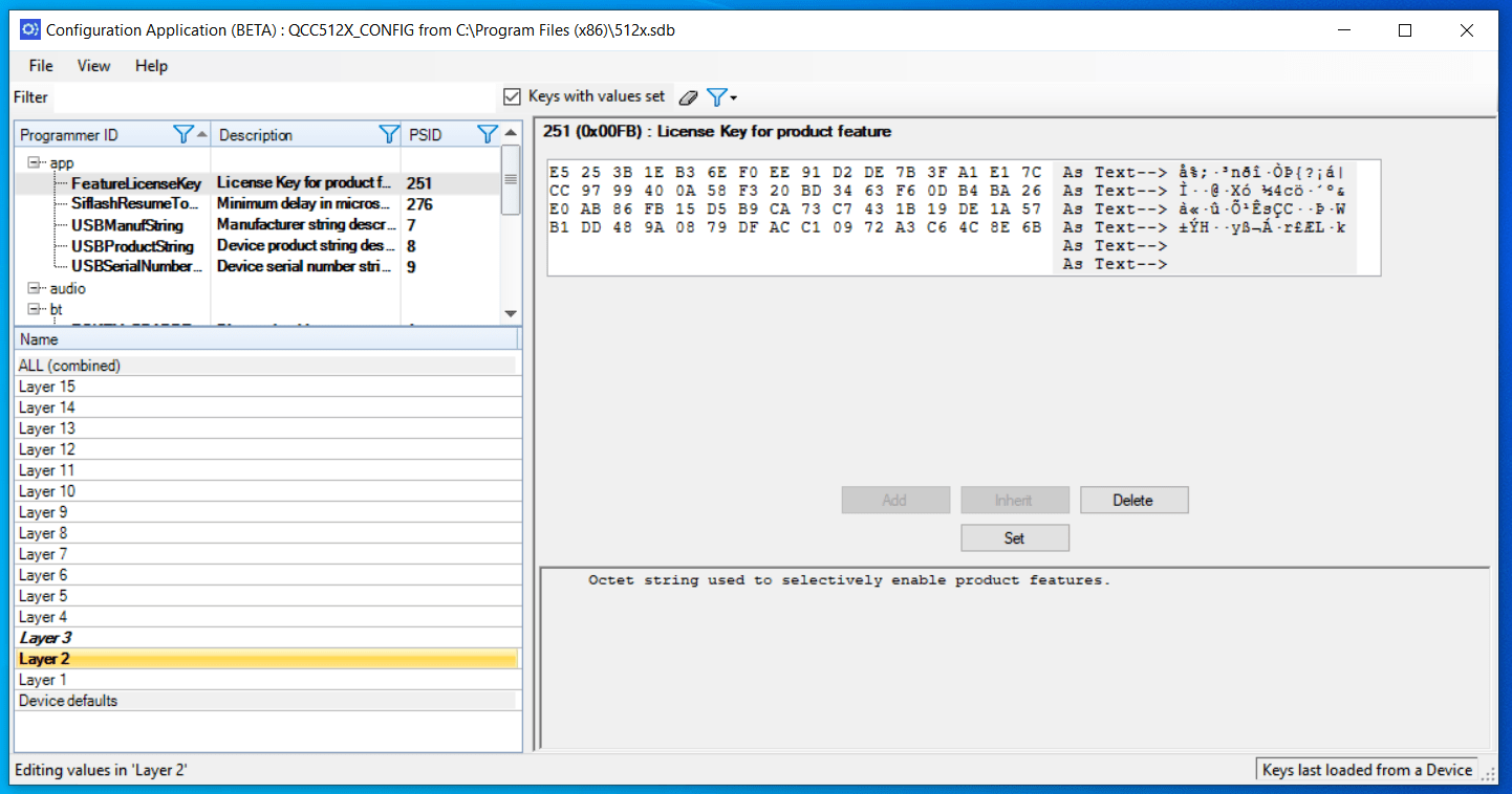

So, I've spent countless hours trying to figure out how to get different QACT modules to load into QACT for use. For example, the TinySine TSA6179 (QCC3031) module has the Dynamic Bass module available when you connect to QACT with the TSA6179. I bought some of the AliExpress/Ebay QCC3034 modules and they do not have the Dynamic Bass module available. If you try to save the TSA6179 .htf file from QACT and load in the modules on the QCC33034, the modules are greyed out and do not load in. If you try to merge the .htf file with QCC_Audio_Tool, the modules still do not load into QACT. I was at a loss. I was thinking the only way to get different modules to load into QACT was to build new firmware. Alas, I decided to try one last thing before giving up. I used ConfigApp to copy/paste the license key from the TSA6179 and set it on the QCC3034 and, to my surprise, it worked! I was able to load Dynamic Bass into QACT on the QCC3034. I believe the last step was to use QCC_Audio_Tool to merge the .htf file from the TSA6179 to the QCC3034, but I am not positive. If anyone wants to give it a go and confirm, that would be helpful. Just make sure you save the original license key in a text file before changing it.
Here is the TSA6179 license key in text form->
E5 25 3B 1E B3 6E F0 EE 91 D2 DE 7B 3F A1 E1 7C CC 97 99 40 0A 58 F3 20 BD 34 63 F6 0D B4 BA 26 E0 AB 86 FB 15 D5 B9 CA 73 C7 43 1B 19 DE 1A 57 B1 DD 48 9A 08 79 DF AC C1 09 72 A3 C6 4C 8E 6B
Also, if anyone would be so kind as to share a license key for a module that has the crossover modules enabled, I would be very grateful.
