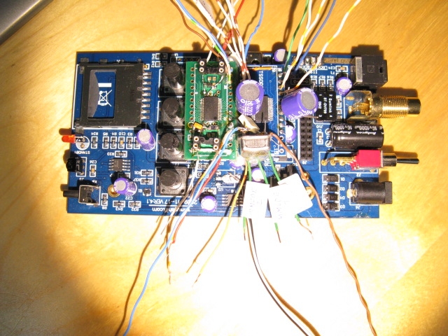

The traces are underneath the board.
Scrape off some solder mask at the goundplane next to the vias.
Then do the same close to the I2S output pins.
Now apply liquid-silver from the scraped off groundplane next to the vias
and cover the traces going all the way to the scraped off groundplane at the
I2S pins. Of course, do not get any liquid silver on the vias or on the I2S output pins.
This is just one way to do it but it is very effective and easy.
Klaus
But this is the better way:
At the moment it is just a test setup that's not yet finished.
AD1896 SRC to AK4396 DAC with on board 24Mhz TendClock.
44.1khz via AD1896 to 96khz. I don't use the 1896 only to upsample
but also for it's jitter reduction ability.
All will be fed by LiFePo4 cells and one 5V TeddySuperReg.
Klaus

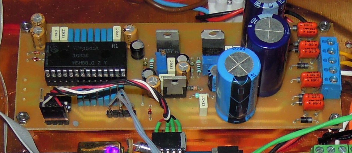

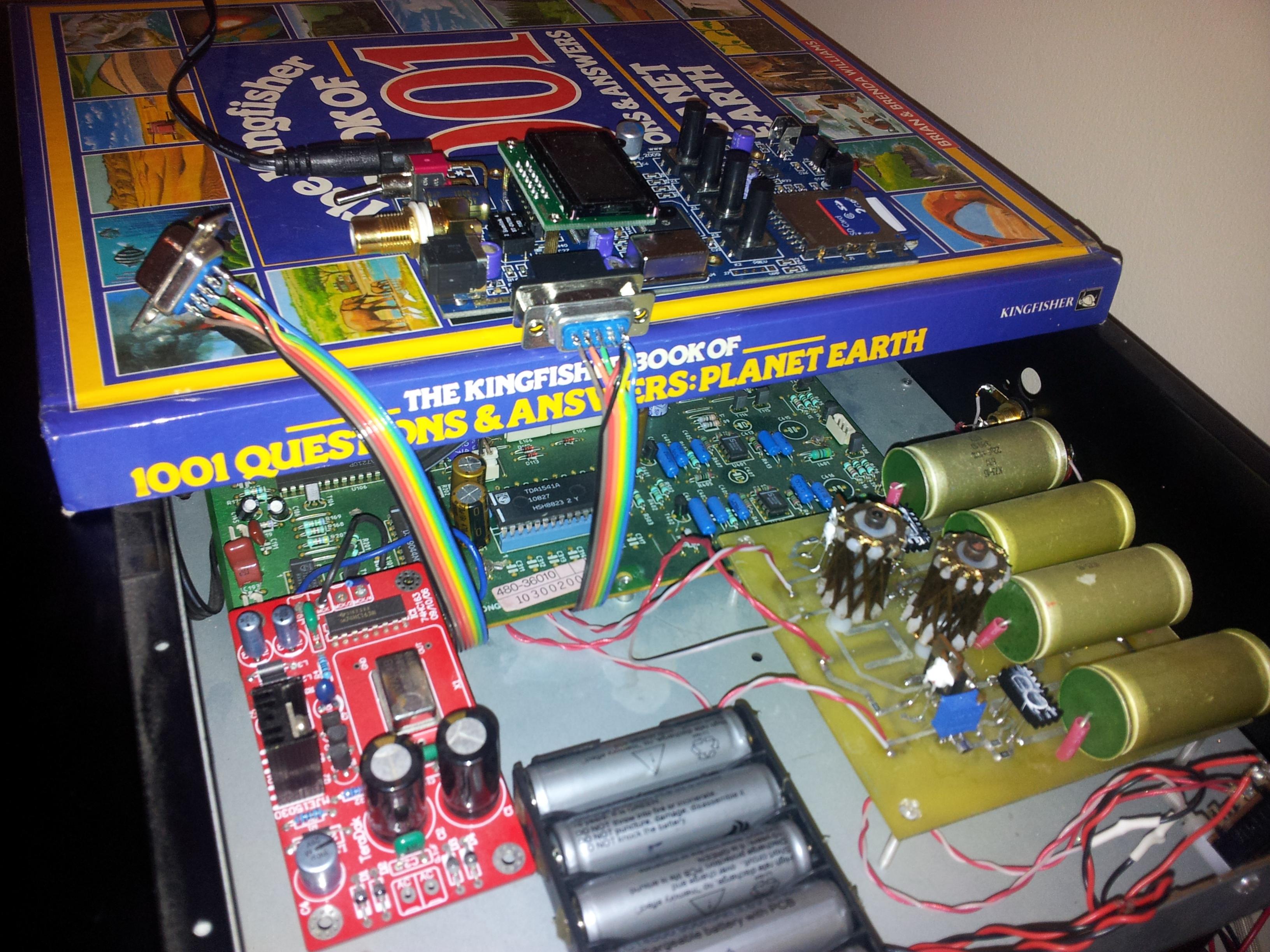

Hey Guys,
Just thought I'd share my experience so far with the QA550.
Its very hard to describe the improvement without sounding idiotic or way over the top like "lampizator" but ill try.
Imaging has improved, voices sound more defined to their position on the stage but also the detail around the voice/instrument has been extended. Its early days yet to pass judgement as its only been a few days since i installed it, but I'm liking it so far, and my implementation is far from perfect so i can only imagine what improvements will bring with shorter wiring, better power supply, etc.
Currently, as you can see in the attached photo, im using the TDA1541A as my DAC, which is currently installed in my Rotel RCD855 with various mods and the CEN output stage running off lithium batteries(18 - 20 volt range).
I've given myself the option of doing easy A B comparison due to the connector i've used. Ill give it a few weeks then ill go back to the CD transport and by then the change should hit me in the face.
Ill also be doing a comparison with the ESS9023 DAC.
Eventually ill have a complete Transport/DAC...

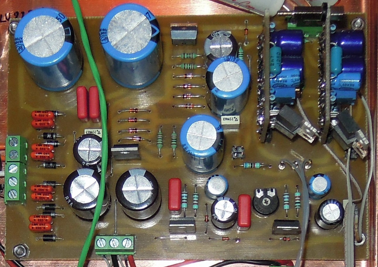

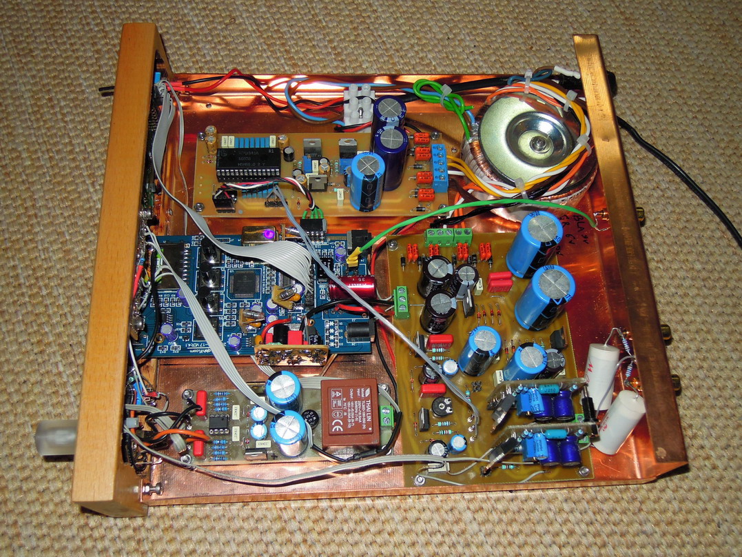

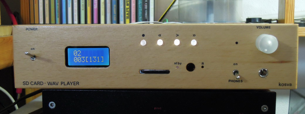

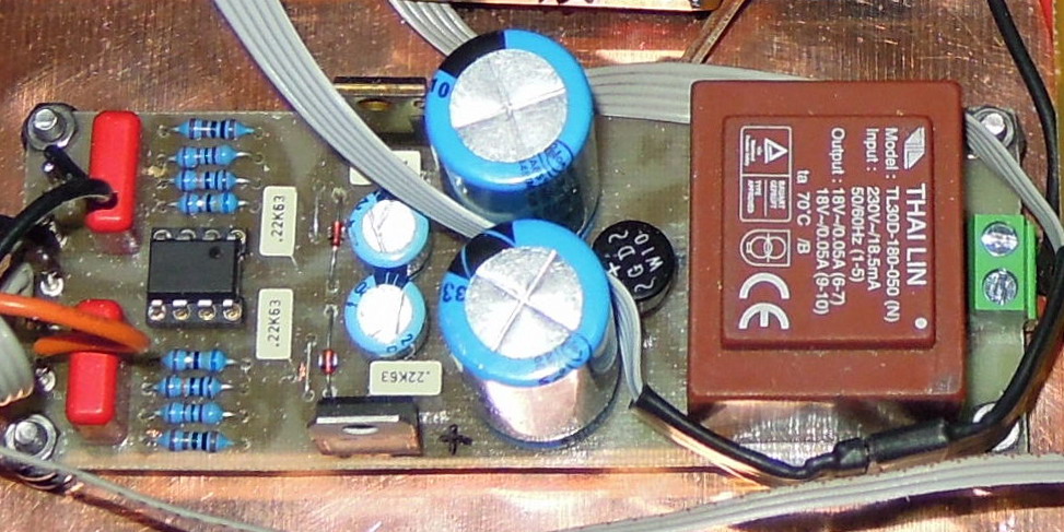

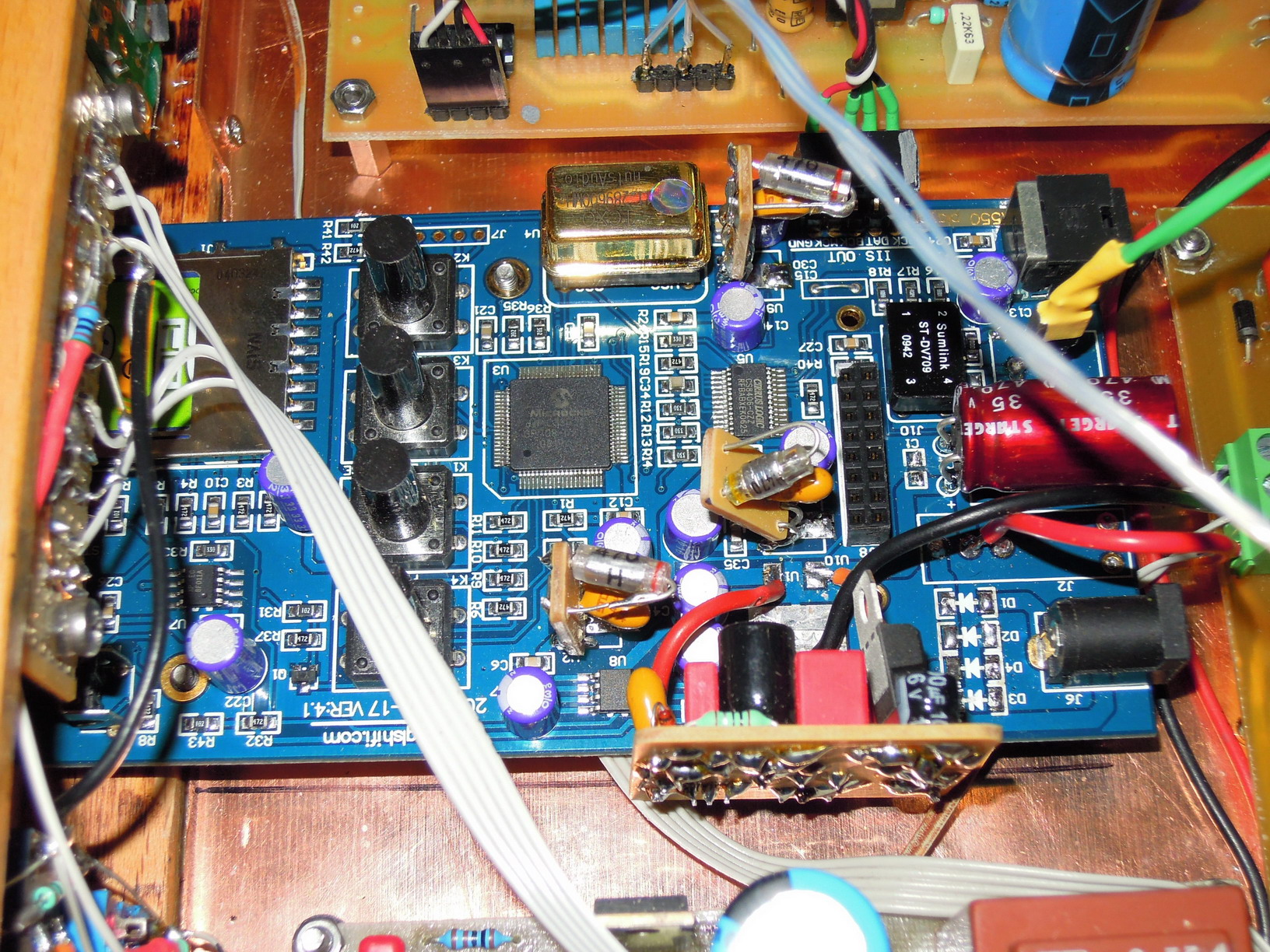

Hi
Here is my QA550 in an enclosure with I2S connection to a TDA1541A DAC and the unbalanced D1 of N.Pass as I/V and buffer.
The sound is great and only my diy Philips PRO2 has a little more detailed sound via I2S and the same DAC.
The value for money of the QA550 is 10/10. I bought it early in 2010, and a year later I made this enclosure as a stand alone SD WAV player.
I changed almost all the PSUs on the board of the QA550 and the TCXO with a 0.3 ppm Nuts Audio. Also the LCD display with a little more bigger and backlighted.
The only lack are the FastForward button and more informations on the display (16x2 or 16x4 size). Maybe the next QA5..?
