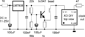

Here's an example of the replacement I've started using for the ams1117 3.3V reg (from Tent Labs site):
For DC, it is a potential divider to drop the voltage through the transistor. For AC, it is a filter to ground through the capacitor = a capacitance multiplier that helps to isolate it from the noise etc of other power drains.
Instead of a 7808 source, I have a Sigma11 5V, and I'm using a Bourns 10K divider, a BC550B and a 2.7K R load. Here's a picture of one I'm using on a Teralink X2 - it is a definite improvement - but it needs an excellent regulator before it to really impress.
