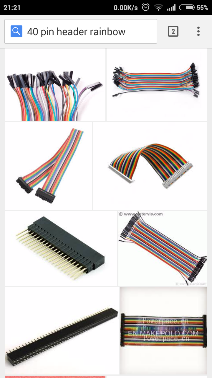

try to google "40pin header rainbow", below sample from my local webstore:
https://m.tokopedia.com/ujungsolder/jumper-pelangi-40-pin-male-female
https://m.tokopedia.com/ujungsolder/pin-header-male-tulang-ikan

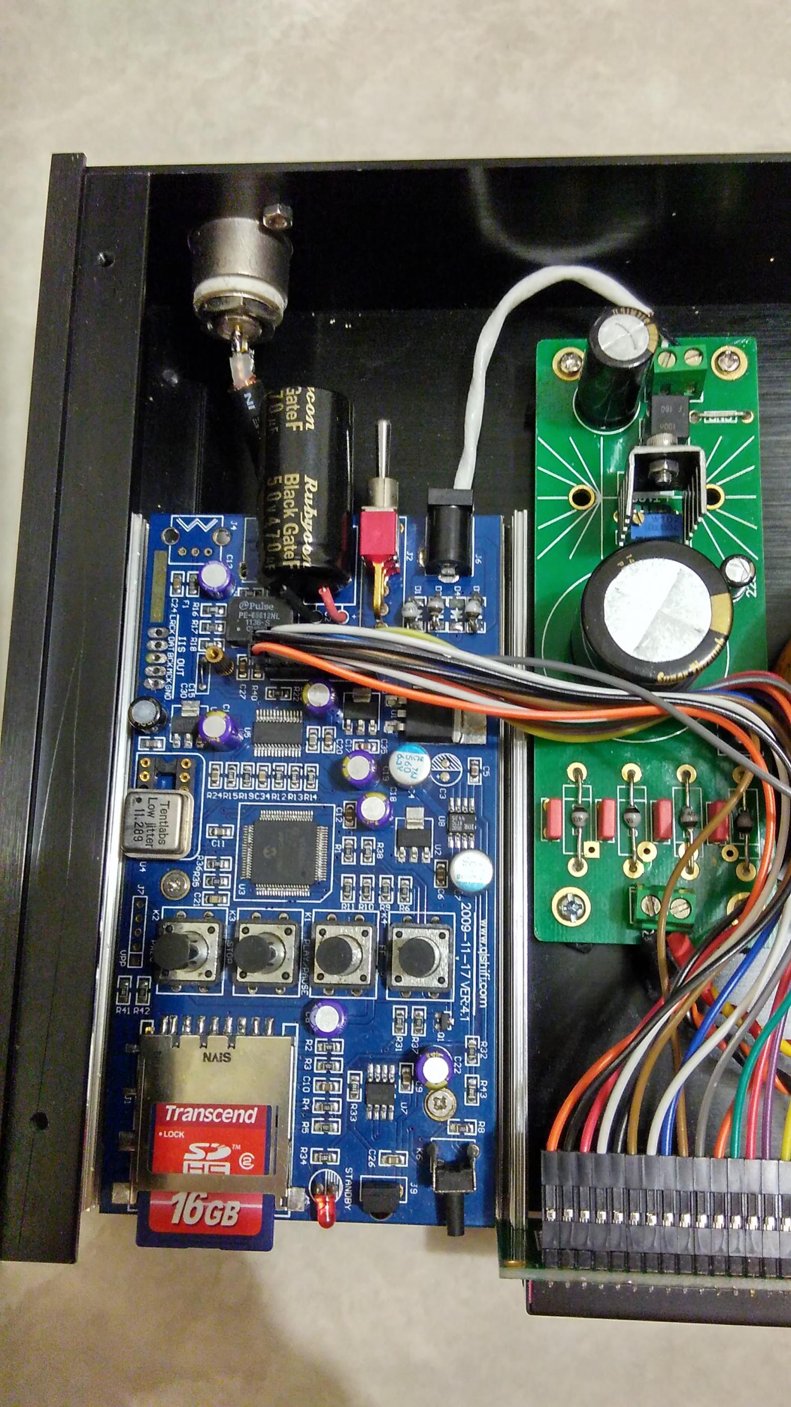

i put aditional resistor 1k5 on pin 3 V0 to reduce contrast, use some oscon sg 47uf and bg pk, clock to tentlabs.
got lcd 40x2 from ebay, it' huge. i'm expecting to get a new firmware for this displayed, but qls reply " Sorry, This product has been discontinued for a long time, and the original code design staff has been replaced " so 16x2 is the maximum display you can get, most important thing is to keep this player to work as long as possible
