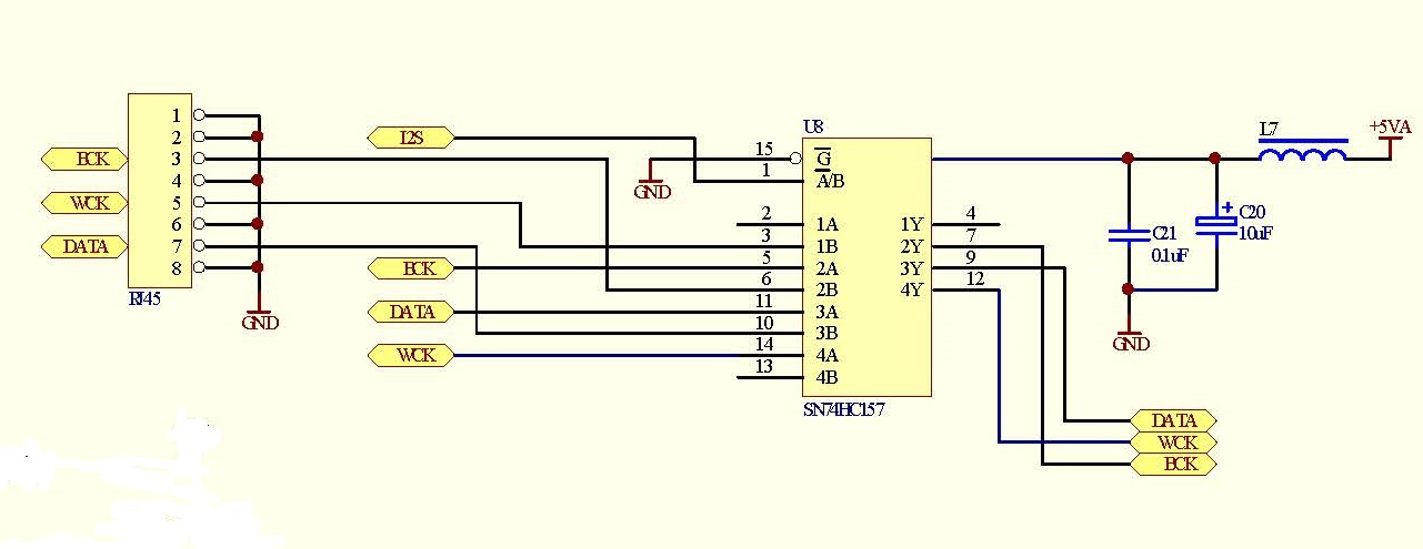

how do you connect via I2S TDA1541A and QLS QA550?
i have both devices and solder 4 wires from qls qa550 board to 1,2,3 and 5 (gnd) pins on tda1541a but i don't hear normal sound - only on highest volume level i hear music with many noises. so it's not direct connection? i connect ESI Juli@ by 4 wires tomy tda1541a and its work perfect! what's wrong now with QLS QA550?
it seems not so simple, I am not an expert but have a look at my DAC schematics/abstract/
Ignat

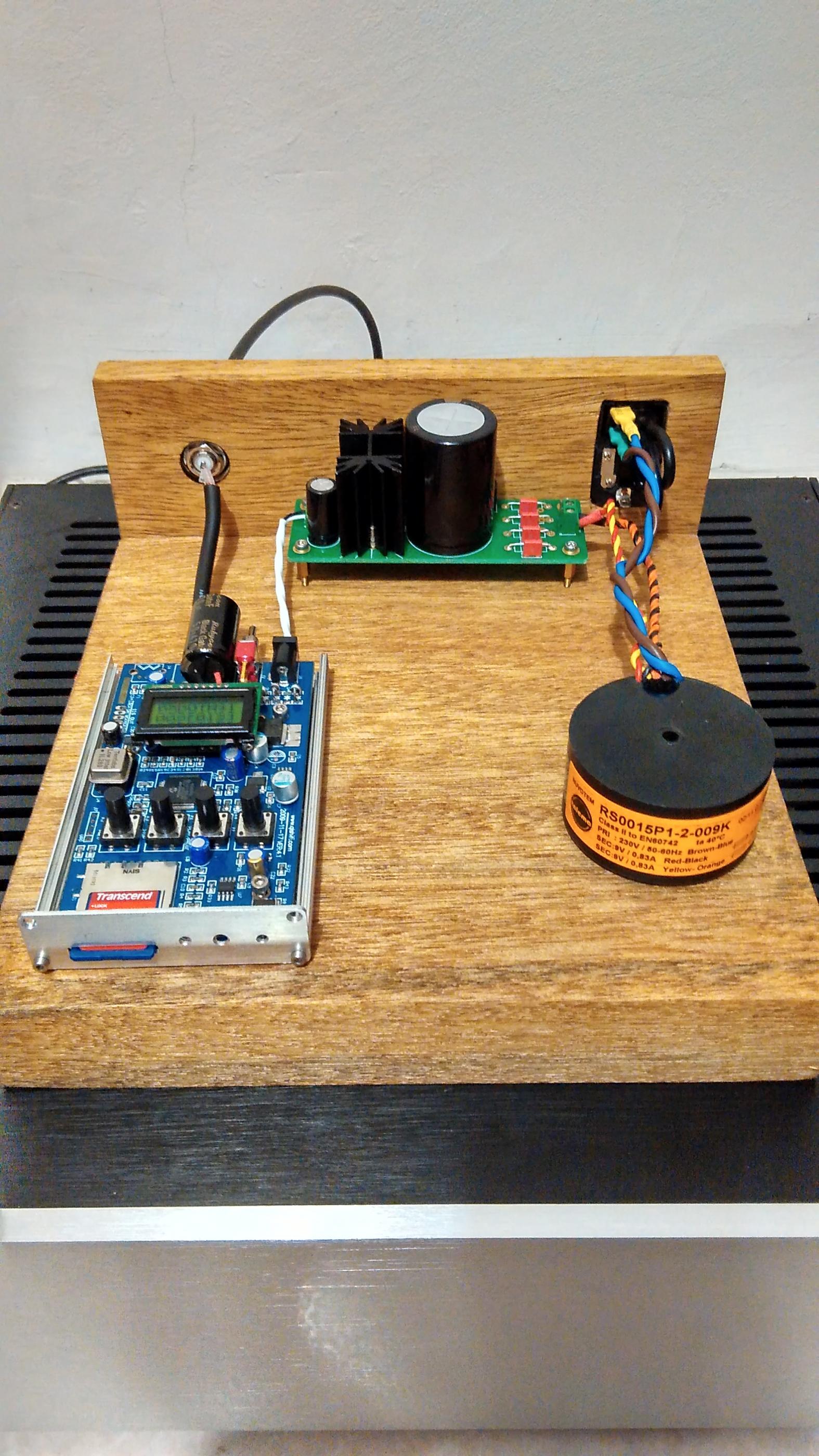

it seems that this product no longer imported by kk anymore, i got lucky that my friend let me buy his player. I've just replaced the clock to tentlabs, change some caps, remove optical out, change coax to bnc, and lastly use separate regulator using LT1085

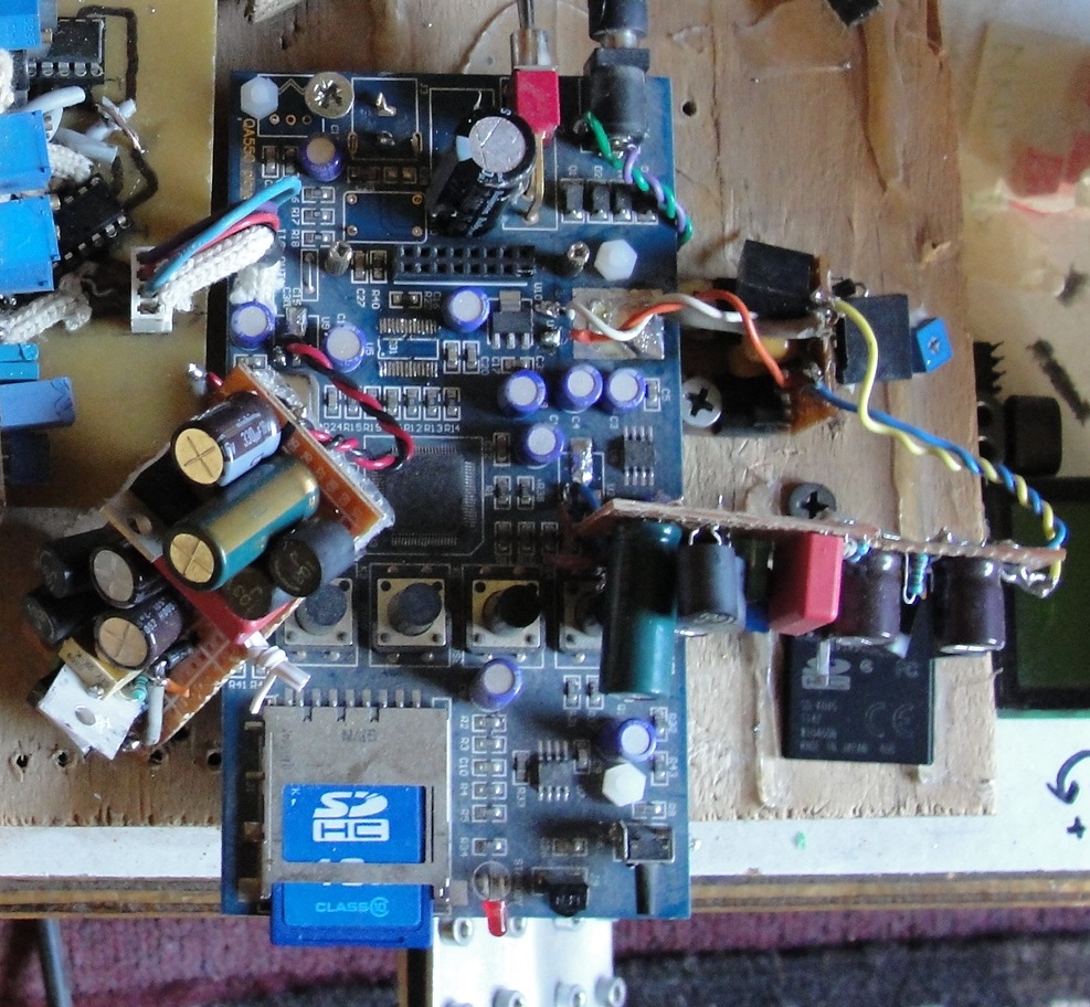

Present state of one of my QA550's:
Shunt-regs from -EC Designs- on clock and main receiver chip supplies, the last one in series from a Teddyreg.
I am waiting for a better quality clock.
Guys, put good discrete regulators: it is worthwhile. 😎
Best regards,
M.
Best regards,
M.
Best regards,
M.
that's fugly 😀

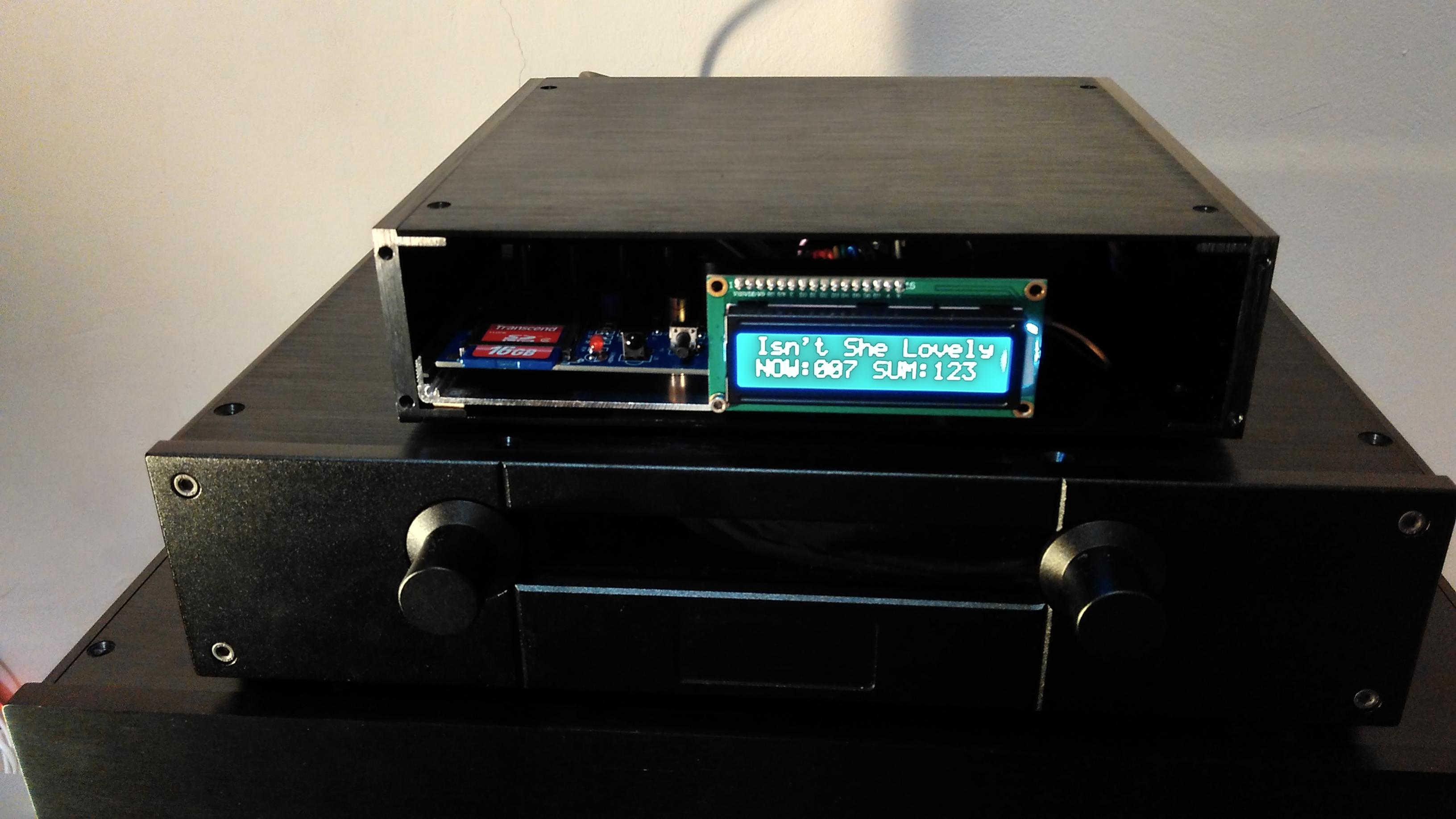

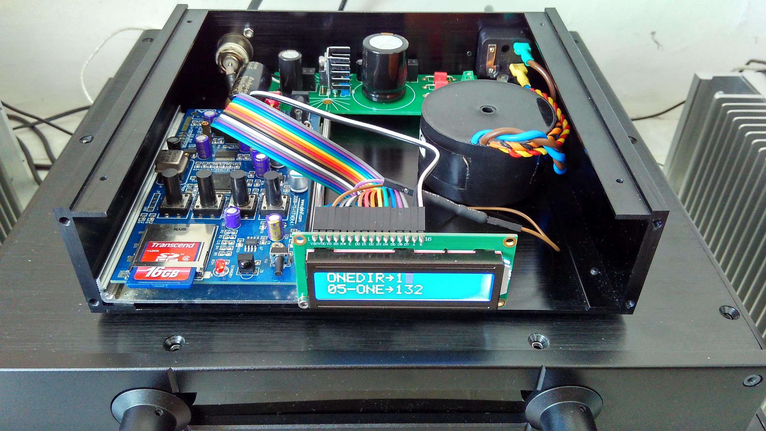

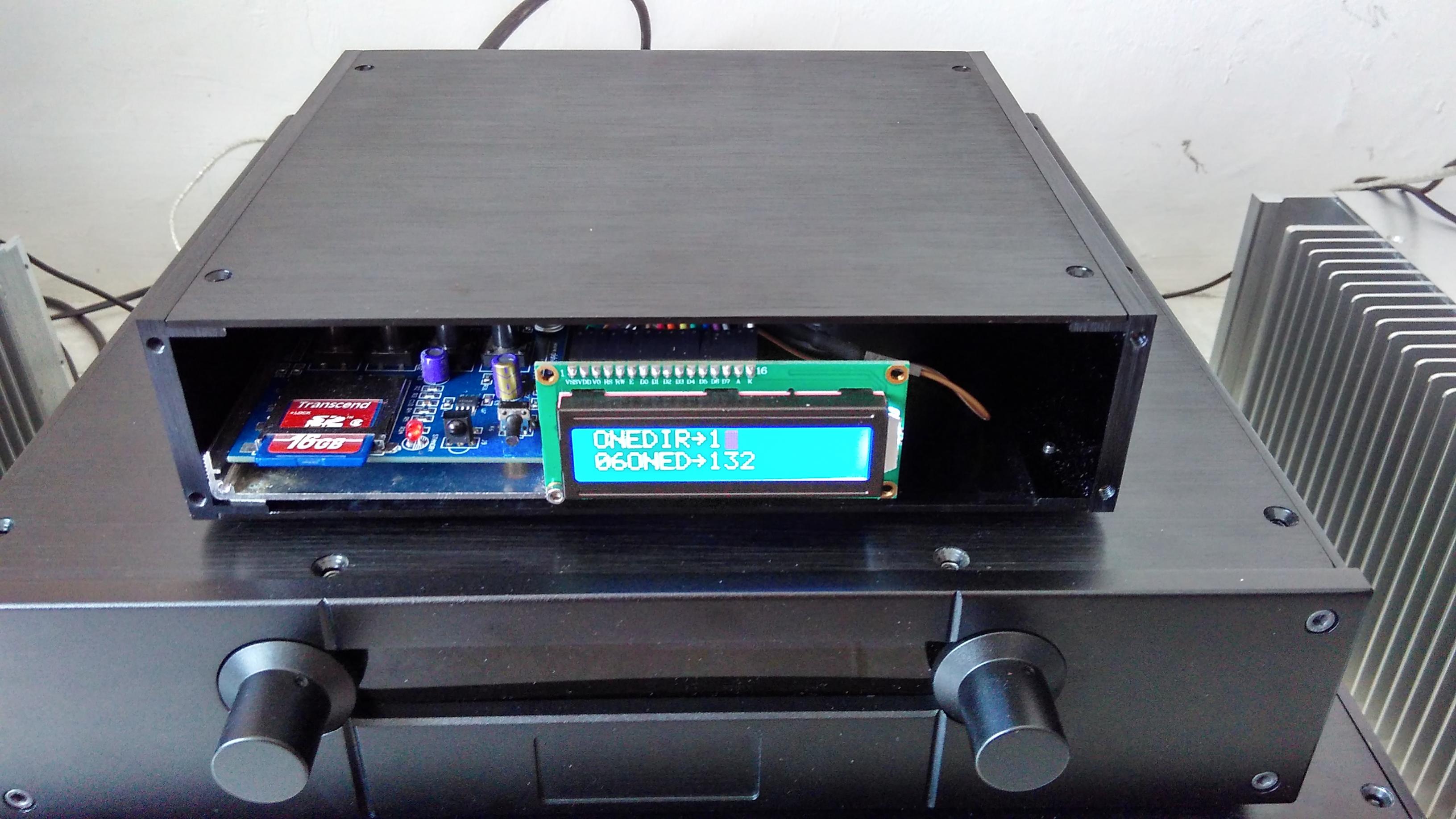

I just tested using 16x2 lcd, bought it from arduino community, it's cheap and have backlitgh, but the char displayed is only 8x2, i'm emailing clark from qls if any other firmware can be used to display more char.
I just find a proper case for this player, only need to make a custom faceplate, maybe using hardwood. original one is 10mm thickness, impossible for handrill
that's fugly
Yeah, I'm dirty to work... 🙁
Yours is lovely.
Consider using the I2S out directly to a DAC and upgrading regulators.
My secret weapon for digital sounding analog, which make the skeptics laugh, is Dammar varnish enriched with graphite powder applied to the receiver and DAC chips. Almost free tweak 😎
I have to revarnish this unit.
Good luck.
M.

good news for anyone who is interested to get more text, Clark just sent me a dedicated firmware for 16x2 display (firmware name has suffix 1602) and it works. However some differences compared to original firmware on how items are ordered, which you may like or dislike.
I also asked clark if any firmware for bigger display, maybe 32 or 64 char
