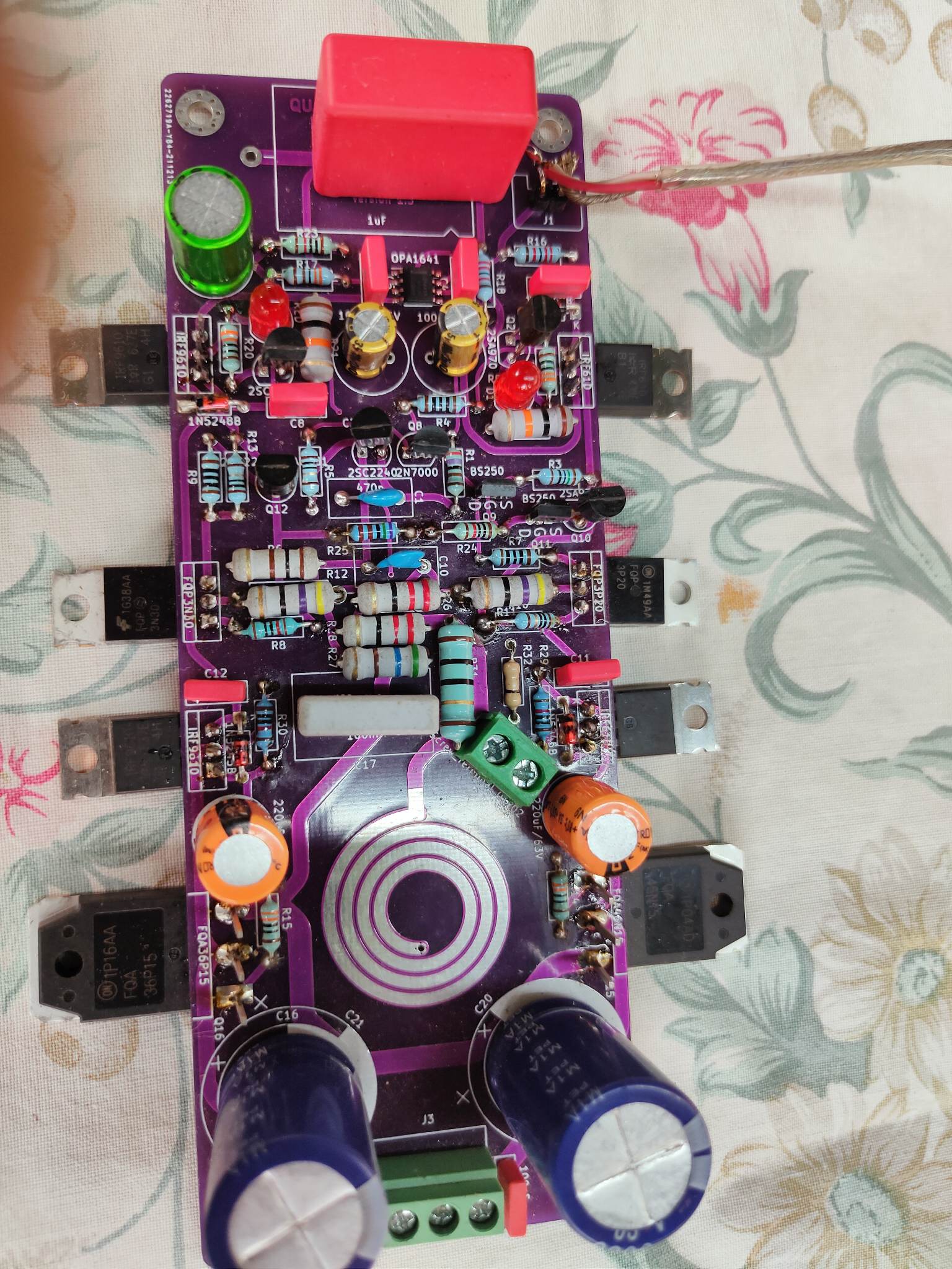

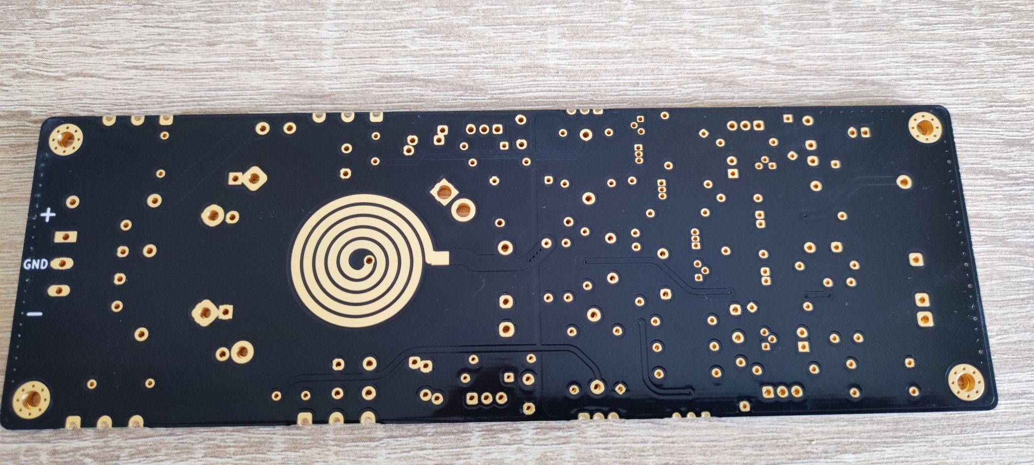

A small improvement could be made to the decoupling of the OPA1641. Rather than using C4, C5, which are connected to ground, it is better practice to put a single decoupling capacitor directly between V+ and V- as close as possible to the pins 4 and 7.
Tibi, you mentioned earlier that the matching of Q9 and Q11 is important. When using NDC7003, can we take the satisfactory matching granted, or is it still necessary to measure the two transistors within the same package? Thank you, MiklosNDC7003 is a nice sounding improvement. It will be included in schematic.
NDC7003 mosfets are already matched and beside this are on the same silicon substrate, this mean the mosfets are also thermally matched.

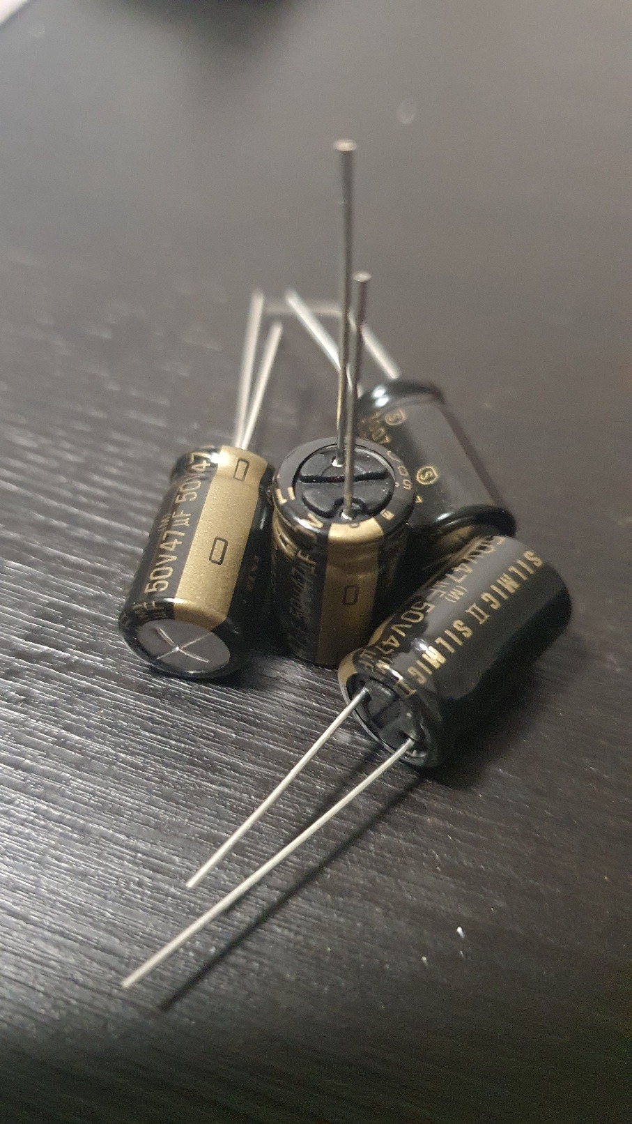

I highly NOT recommend low ESR and low ESL capacitors on Q17 and in general on any analog design.
Sanyo Oscon are very low ESR capacitors designed specifically for digital applications. It will improve your low jitter clock, or digital reclocking circuit, but will kill sound of your preamp or amplifier.
Selecting the right capacitor for a specific application is science, but unfortunately on this forum is lot of voodoo.

C7 is placed in negative loop of OPA1641. Will contribute to dc blocking, but you still need to take care on previous stage to be DC free. C7 can not be eliminated, due output is lifted by Q7.

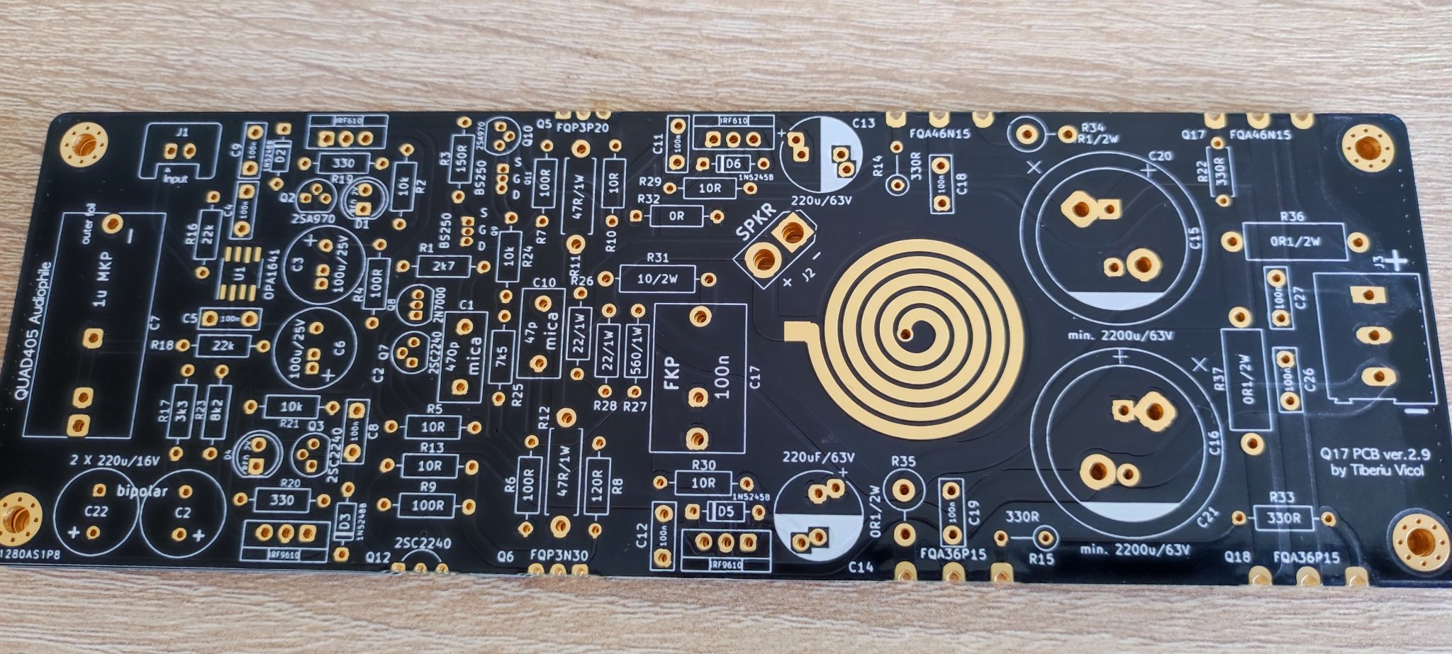

PCB's are at home.
PCBs look great, no visual blemish or scratch. I am satisfied!
I'm busy with work for the next week, but next weekend I'll finally get around to mounting the pcb. I plan to turn the Q17 into a design gem. The board itself as well as the transistors will be attached with golden screws. I asked Tibi about the sound difference between the Auricap XO and the Mundorf from the MESGO series, because I'm planning to choose between the two. But I'm leaning more towards Mundorf, in conjunction with pcb this combination will look really great. CDE looks kind of plain to me.
