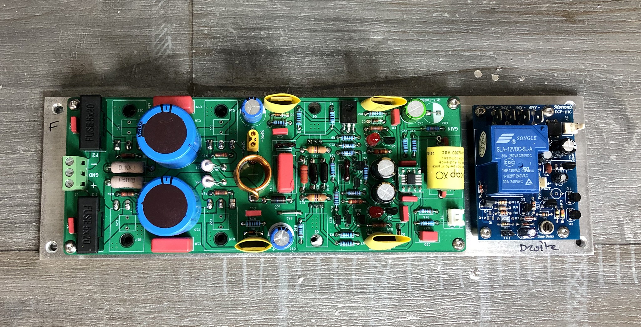

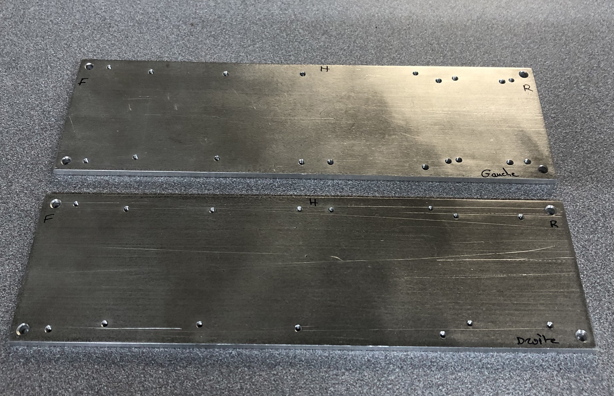

I had time to work a little on the Q17 Turbo. All holes are done. 😉
The Tap Machine is awesome. I just spent a little hour tapping all those holes.
Stef.
Sweet work, I’m envious Stef! I was busy most of a Saturday drilling and tapping 😩. I know my amplifier building will not stop, it may be time to invest in a tool to save time, which when converted IS worth money😉.
Kudos to you fearless amplifier builders that successfully do your own thread tapping. I’ve been scared off of tapping aluminum from the stories of snapped taps and Swiss cheese panels/heat sinks in this forum. ☺️
I have no shame in drilling holes and using machine screws with nuts, instead. Time is indeed valuable, Vunce.

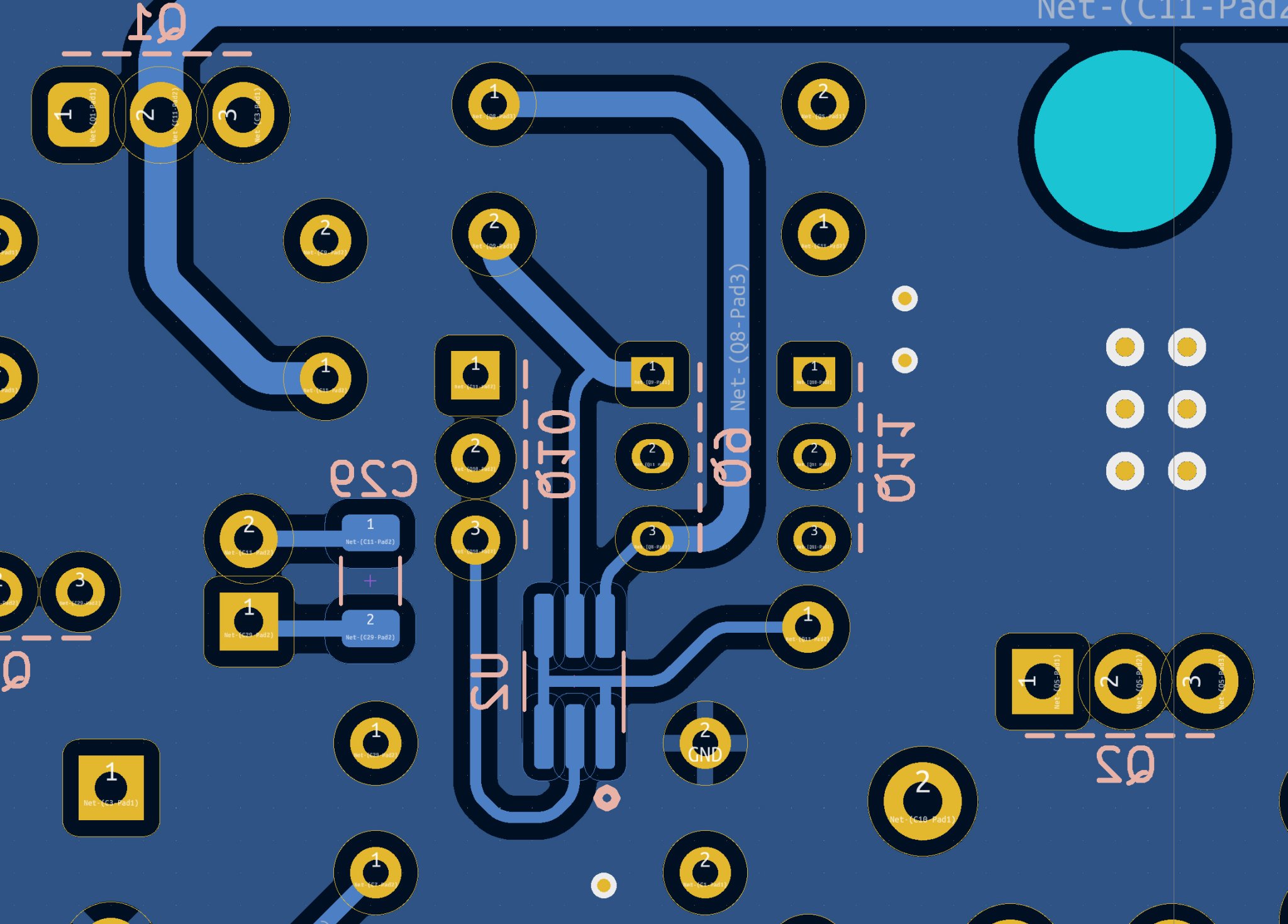

I published version 1.0.1 of the Q17-TURBO.
I did not print myself a PCB of this version 1.0.1 so use with caution.
- Added U2 footprint on back PCB (NDC7003P replace Q9 and Q11).
- Updated some silkscreen on back PCB.
- Updated schematic with new parts.

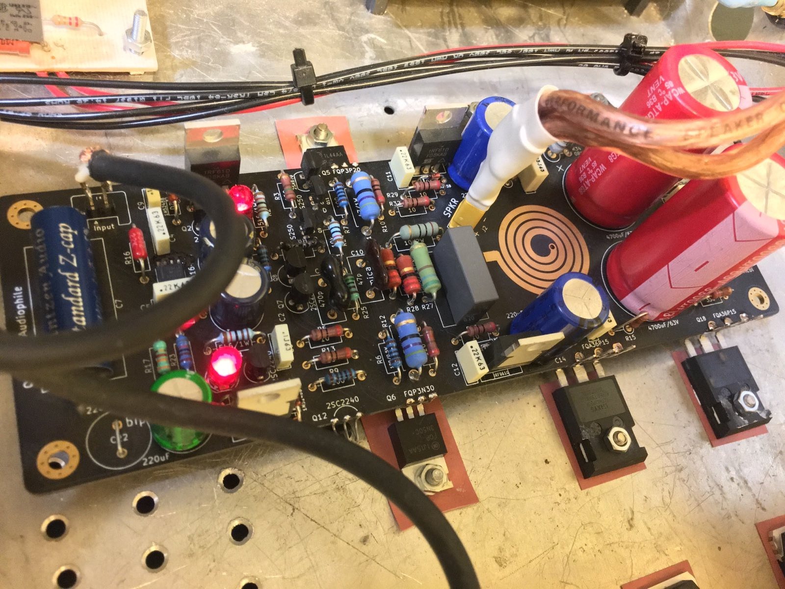

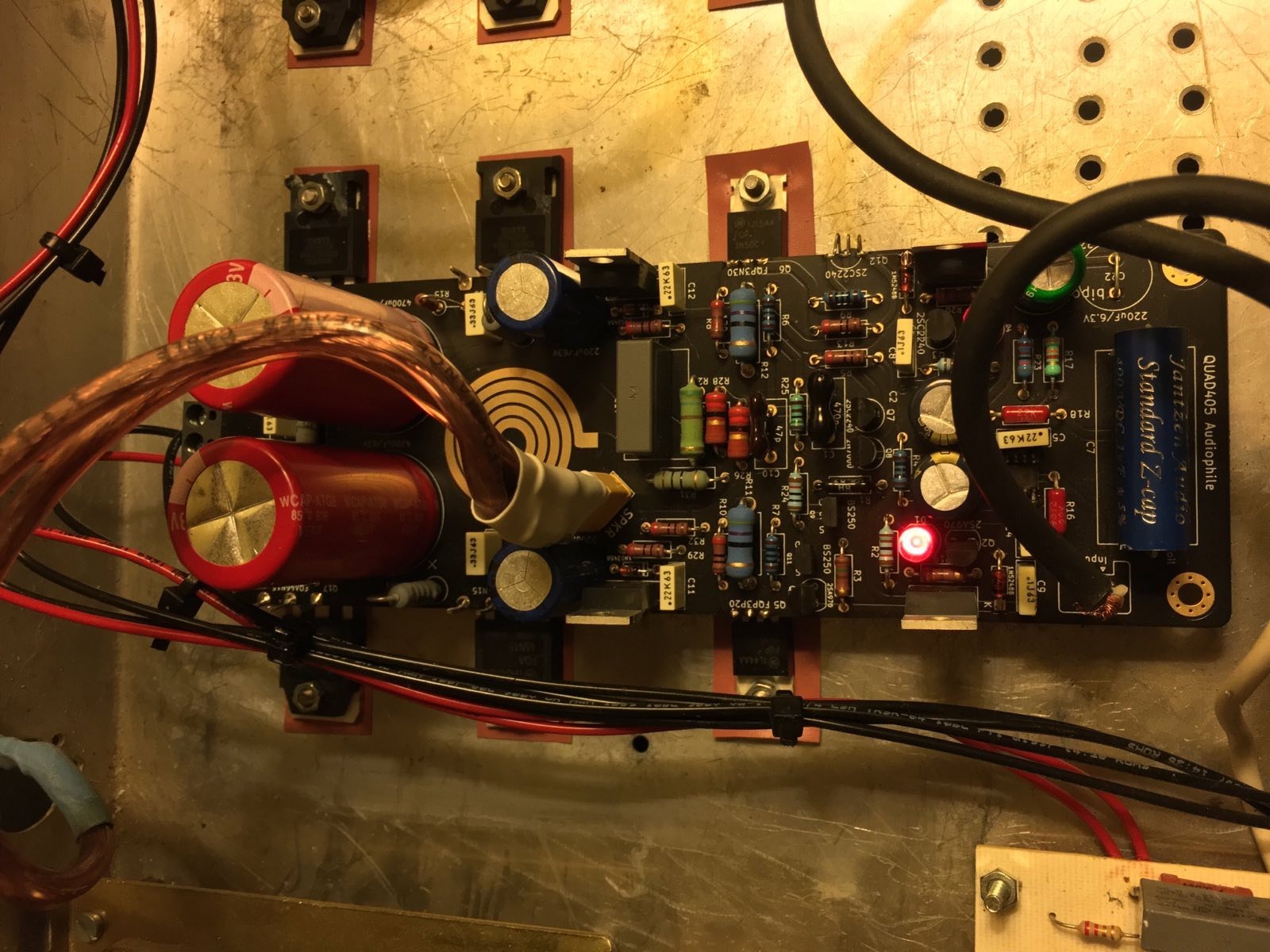

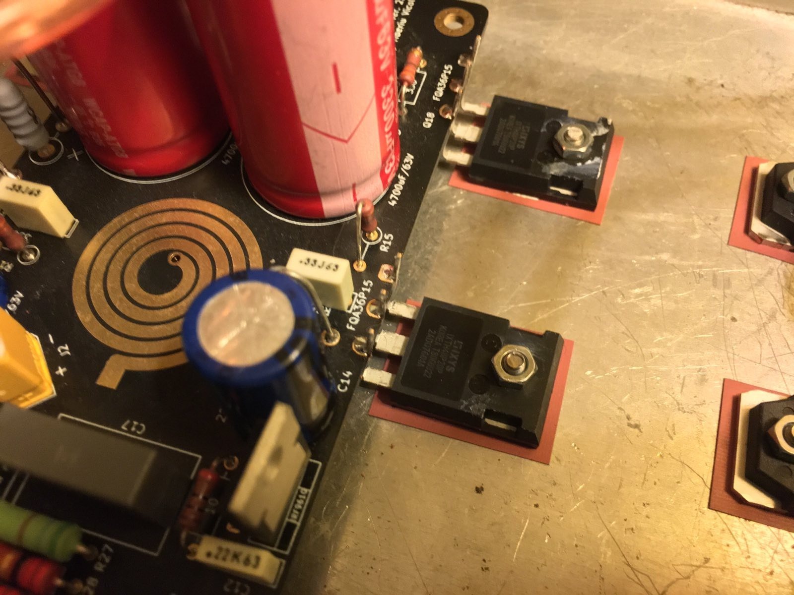

Just confirmed to myself that FQA46N15 & IXTH48P20P make a better pair. Both have almost same Vgs(threshold) and transconductance.
Bass is deeper and amplifier get more control at any volume.
Another nice discovery are Wurth Electronic electrolytics. I like them a lot. To my ears, they sound better than anything I have used so far in this position.
View attachment 1156533View attachment 1156534View attachment 1156536
Now after more than one week with this pair, I must say there is no way to comeback at FQA36P15.

Thank you for your feed back and congratulation for your build !
Yes, Q17 is one amplifier to keep and the best amplifiers I ever built.
I already compared this amplifier with some 5 digit $ commercial amplifiers and Q17 is by far the best.
When I say "by far" mean there is a very audible difference in dynamics, resolution, 3D soundtstage, clarity and distorison. Yes, distorsion as well.
Q17 is a class B amplifier but have trashed all class A amplifiers it was A/B compared.
Well, we need to learn something from this.
About hum. Please use shielded cable on input.

I got IXTH48P20P and made measurements, also FQA36P15 and FQA46N15 for comparison
Regards Tim
I installed the IXTH48P20P and have been listening to it for a few days. The two amplifiers are essentially the same, but the large electrolytic capacitors are from different brands, which also has an influence. Therefore, my conclusion is that I can say that the IXTH48P20P are not very different from the FQA36P15. I only have a pair of power mosfet each. When building with the IXTH48P20P I paired the FQA46N15 related to Vgs(on). For me, the IXTH48P20P are an equivalent replacement, but I can't hear any "advantage" for me, both MosFETs seem to be too similar.
Regards Tim

Hi Stef,Hello!
https://github.com/stefaweb/Q17-a-QUAD405-audiophile-approach/tree/main/Q17-TURBO 1.0.1
I did not print myself a PCB of this version 1.0.1 so use with caution…….

There are of course many amplifiers that clearly fall behind the Q17, to list them here would perhaps be borderline (and I have not kept a list of names and types, I run regular comparisons of different listeners to work my way up to the optimum).
An important aspect in the test listening of the MosFET is that I prefer the FQA with one pair of power transistors, Tibi prefers the IX with two pairs. Here is my thesis, since the IX are subtly dull in sound - which should not be overinterpreted - this is for me a sign that these as two pairs probably also play more balanced than the FQA in this form. This is a question of the correction function of the circuit, which can undoubtedly work more precisely with one pair than with two pairs, of course related to the errors of each individual Mosfet.
I can describe it another way: the errors take place at very small deviations from the setpoint, and the IXs here seem to be more imprecise in these details. But two FQAs play against each other more clearly than two IXs, if my thesis is correct that the IXs are basically inaccurate in these last details. That is at least my understanding of it and therefore I find the statement of me and Tibi not contradictory, but understandable.
