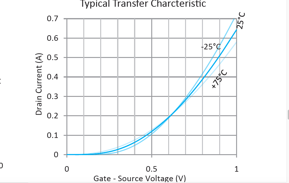

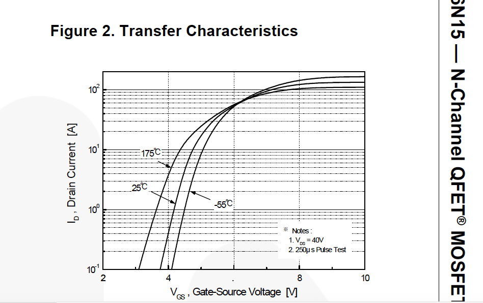

I have attached transfer vs temperature for an Exicon duble die mosfet - left picture -, and transfer vs temperature for Firechild DMOS used in Q17 -right picture.
You may see that over Id~200mA the Exicon exhibit negative tempco. The Vgs increase with temperature. Meaning that Exicon drain current decrease with temperature. This is acting like a thermal protection.
On Firechild you can see that up to Id~60A, this exhibit positive temco. Drain current will increase with temperature. As you push hard the amplifier, stronger this will become. If you push over Id~60A, this will exhibit negative temco as well, but @60A most probably you are already far away and out of SOA. 😛
From sonic point of view, in our case, Q17 and class B operation, I prefer FQA DMOS from Firechild.

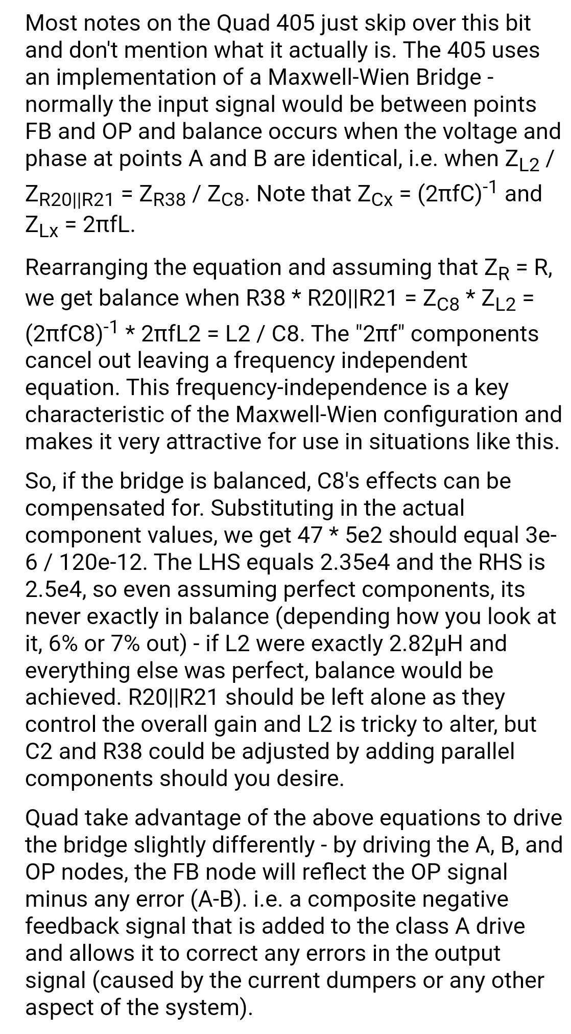

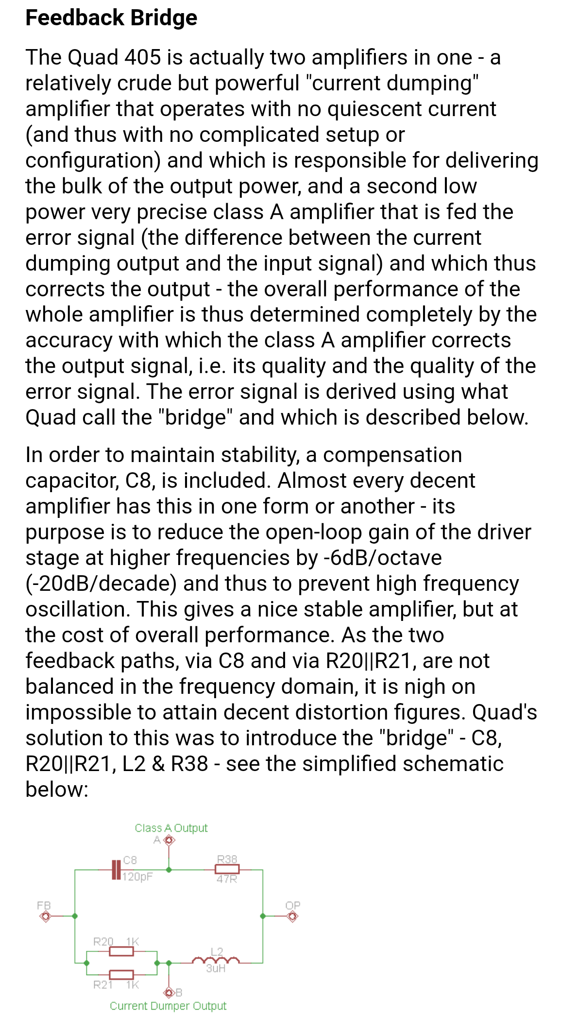

Plus , help to compute maths : how tot dimension value of Damping bridged if L =0.8 uH ?

Keeping original QUAD405 values for bridge resistors (one is part of NFB) and for L=0.8uH, you get bridge capacitor 34pF. So you may go for standard 33pF and add a 5pF ceramic trimmer for fine tuning.
ZL2 / ZR20||R21 = ZR38 / ZC8
2πfL / 500 = 47 / (2πfC)-1
2πf x 0,8x10-6/ 500 = 47 / (2πfC)-1
2πf x 0,8x10-6/ 500 = 47 x 2πfC
C = 0,8x10-6/ (500 x 47)
C = 0,000034x10-6
C = 34pF

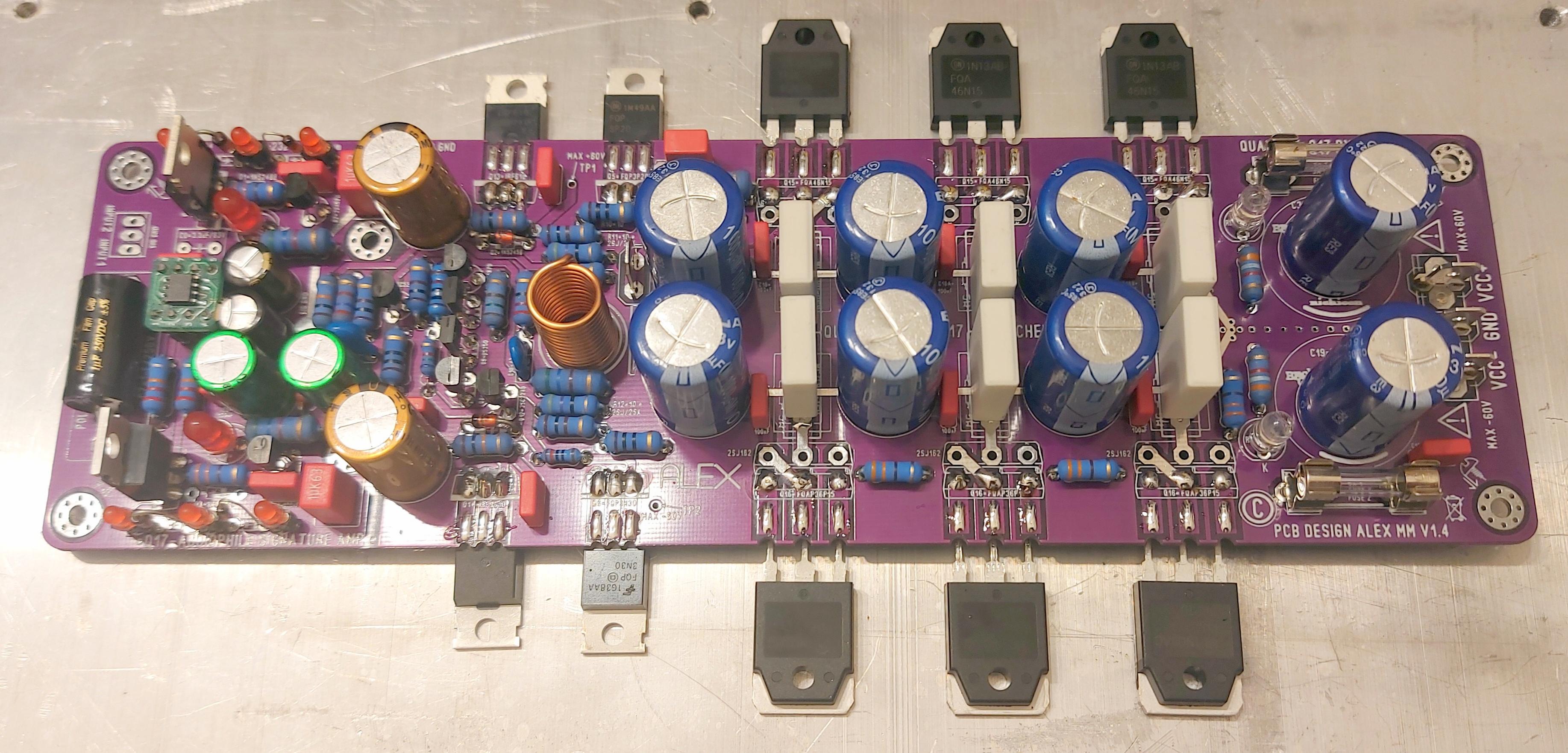

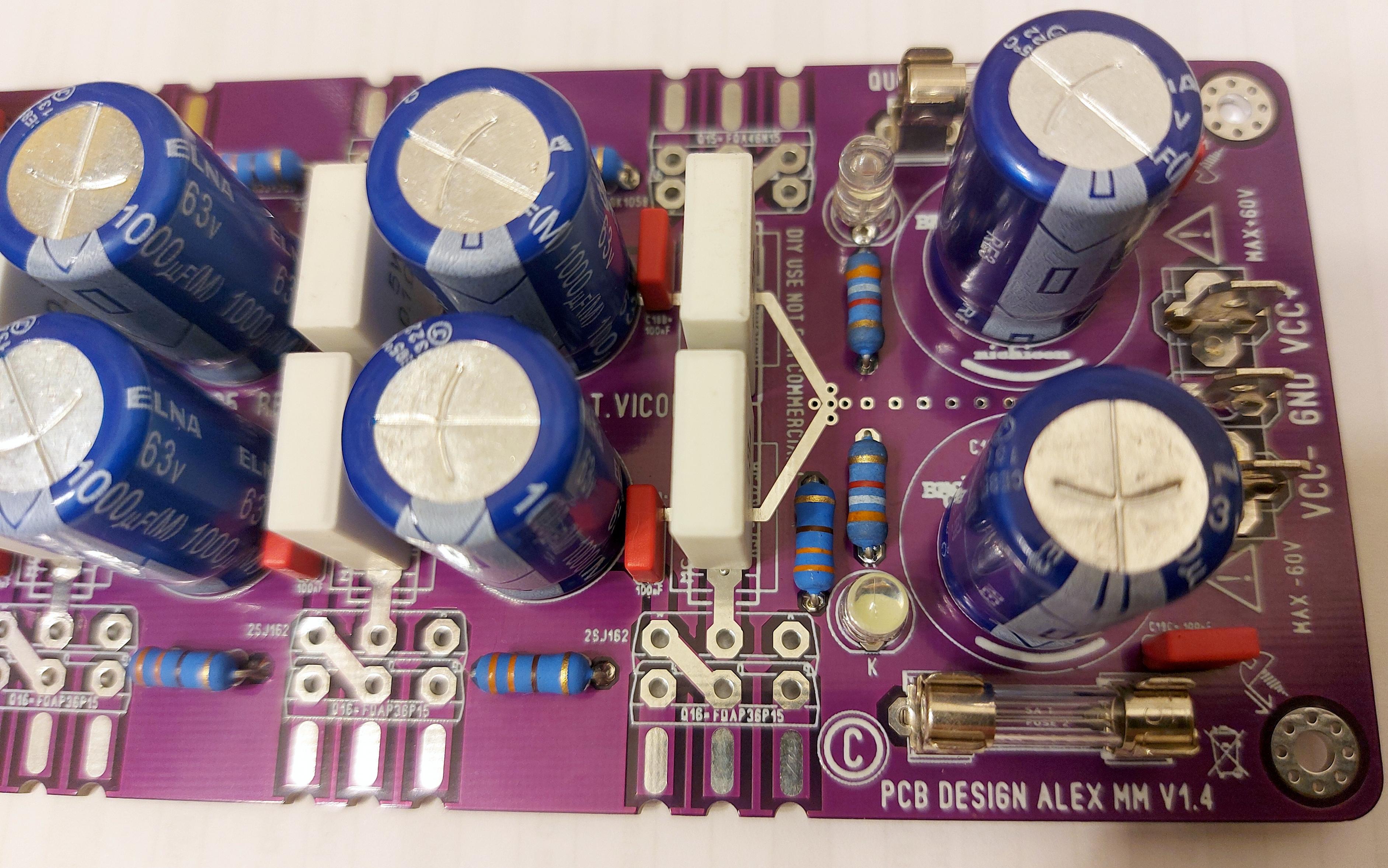

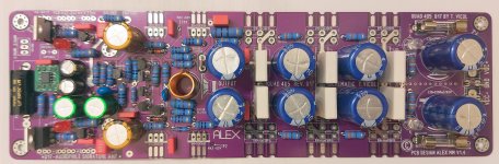

Hello Alex,
It looks beautiful.
Is your first variant already playing?
Have you been able to hear your 1st setup with a pair of power transistors yet?
It looks beautiful.

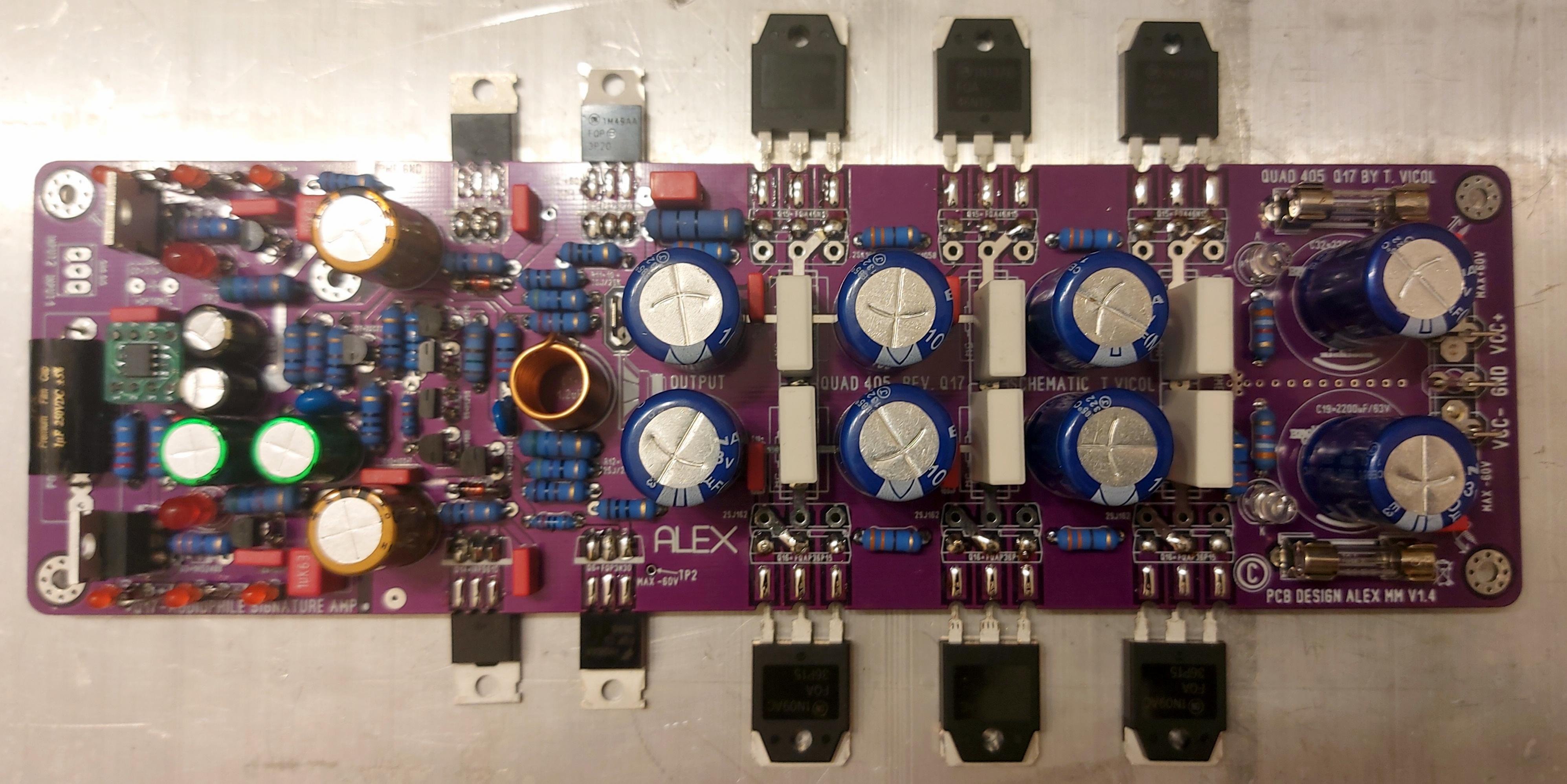

I like your boards Alex, but I'm eagerly waiting to hear your impression about sound.
Tibi
Tibi
Hello Alex,
It looks beautiful.
Hi Tim,
Neither the first nor the second variant was tested, I work slower when I have time and materials. 🙂
