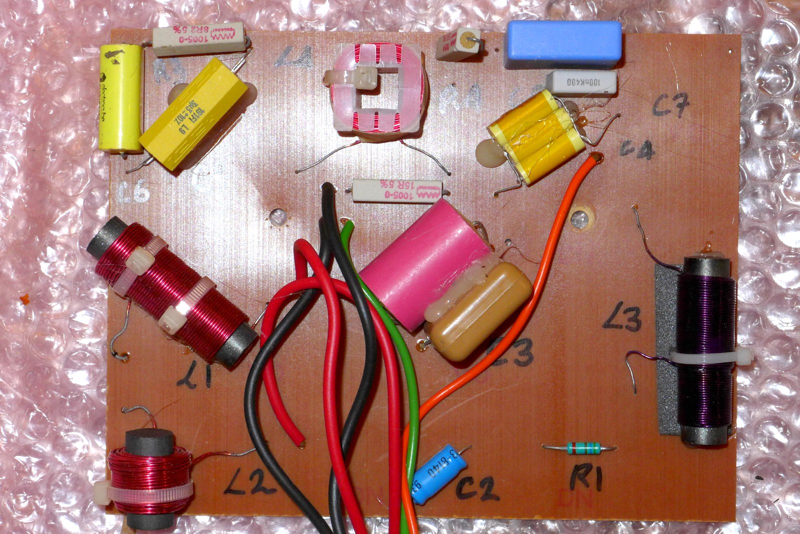

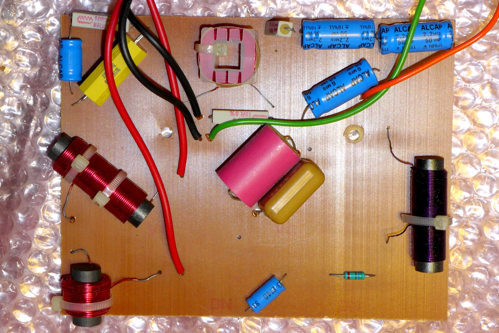

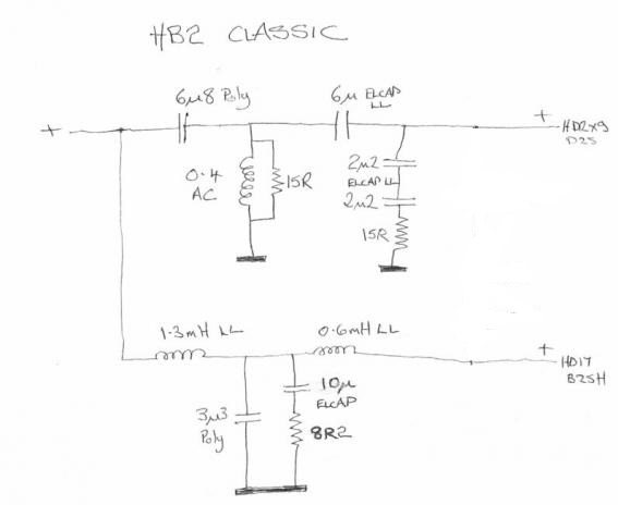

I have just completed a rebuild of my HB2s, including replacing the tweeter coil with the latest Audax version (RW025A0 supplied by Falcon Acoustics) and a re-working of the cross-overs. In doing this I have discovered errors in all the schemtics published here. The CAD drawing (as shown by system7) is prossibly the closest but I found these differences:
C6 is a 10uF 50V NP electrolytic, not 3u3
L4 (air-cored) measures at 382uH, not 2mH
C3 was built from 4u7 and 2u2 film caps in parallel (6u9, not 6u8)
The last was probably a response to a supply problem but the other value differences would make any of the above attempts to model the response inaccurate.
Most of the electrolytics were within spec. on value and ESR, but the 2u2 (C5,C7) were significantly higher in capacitance and with an ESR spread of 2.5 - 6.5 ohm.
I replaced C6 with a 10uF 100V film part, C4 with 3, parallel 2uF film caps, and (C5, C7) with 1uF MKT and 0.1uF PPS parts in parallel (to give the required 1u1). I also anchored all parts with hot-melt adhesive.
The end result is most pleasing 🙂

I thought the 3.3uF shunt C6 was small. And 2mH L4 too big.

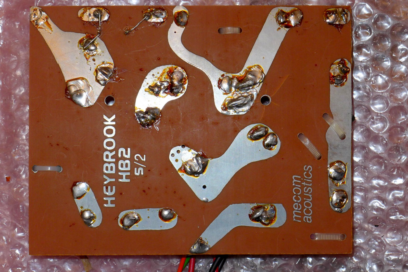

I have attached some photos of the "before" and "after". The capacitors I used were just the ones I had in stock and not necessarily the optimum. They certainly used a lot of solder back then!

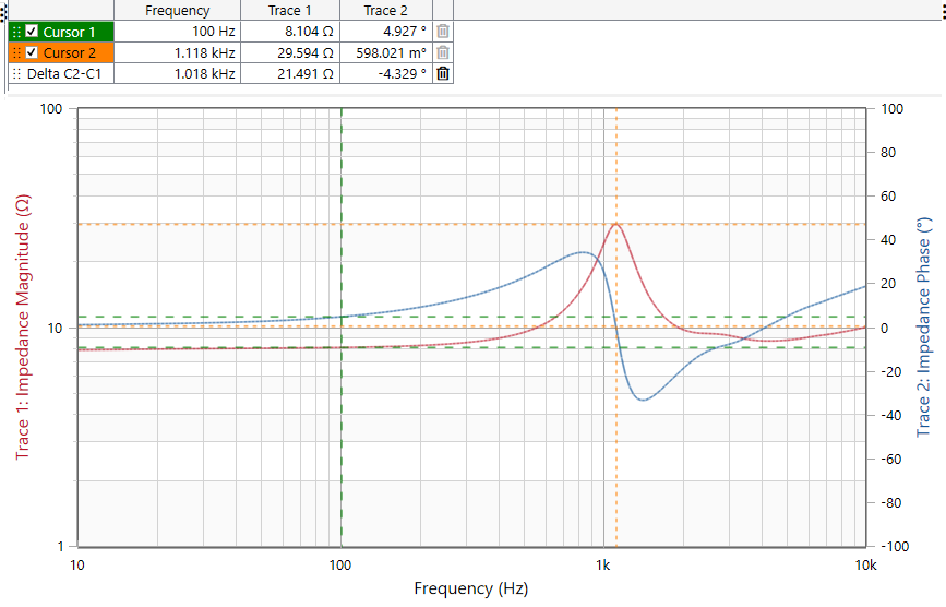

Heybrook HB2 coil: 2mH vs 0.2mH
Steve I have to agree with you on it likely being 0.2 mH. In a 2020 entry on the HB2s you posted photos of the xover. If that were a 2mH air core, given its small size, the wire diameter would have to be tiny which would, I presume, lower its power capability & dramatically increase the DCR. I think it must be a 0.2mH & as you pointed out that would be appropriate for a 3rd order filter.
Ah, the wrath of sreten falls on Heybrook! 😀

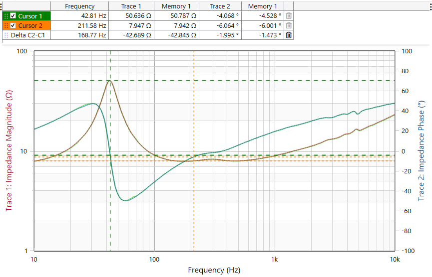

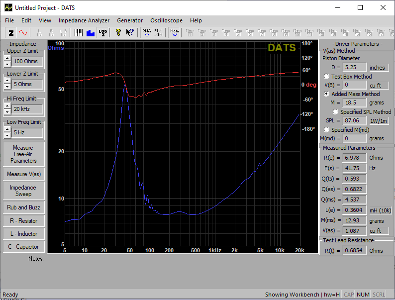

But really, we aren't getting very far on this. It's time for some proper analysis.
An externally hosted image should be here but it no longer works. Please upload images instead of linking to them to prevent this.
See, we KNOW that LCR with the 560R might as well not be there. The 15R + 2X 2.2uF is actually a 15R +1uF Zobel, which actually does almost nothing either, because it has no series filter resistance to work with.
But it's that little (L4?) nylon bobbin air coil that is bothering me. Like I say, 0.2mH or thereabouts would make sense for a third order filter. I'm also guessing the tweeter could be wired in reverse polarity, but that's a guess.
I ought to drop in here more often it seems!
Look, that's my sketch of the HB2 crossover that system7 posted and it clearly shows a 0.4mH air core for the treble circuit. So I don't understand this discussion of L4 being 2mH or 0.2mH? It's 0.4mH, that's it.
You're welcome to leave out the bridge circuit with 560 Ohm resistor if you wish. The difference having it in is very subtle and can't be measured, even though it can be heard. We thought it was worth it at the time (we'd have been stupid to spend the extra pounds on the components, which ate into profits, otherwise), but you can decide.
Similarly the crossover layout, with widely spaced components and angled coils, is critical and caused us a lot of work to get into production to achieve the same sound as our external hand-wired crossovers in the prototypes.
In terms of replacing the caps, note that we preferred the sound of reversible electrolytic (ELCAP type) in the positions shown because of their ESR characteristic. Replacing these with modern PP types will improve detail but you might find the treble to be a little harsh as a result, especially with digital sources.
Remember that these speakers were voiced with LP and the overall power response is balanced to suit vinyl sources.
