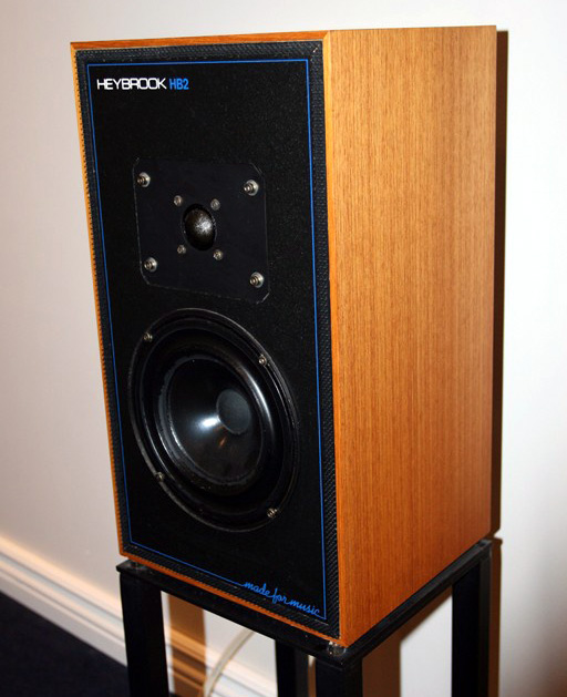

Here's one pic of it. Classic British. What happened in the end? Made any alterations to the XO jackinnj?
No, I haven't made any modifications to the XO. These speakers are currently in my upstairs office.
I purchased them from PAC in Millburn NJ perhaps 15 or more years ago. They don't have the lettering at the bottom of the box as shown on yours -- but they did come with dedicated stands.

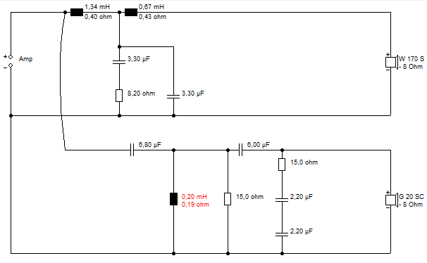

I can't help noticing the L4 coil looks nearer 0.2mH than 2mH, which makes this a third order treble, rather than near first order.
As far as I can see, Heybrook have been doing a bit of quick and dirty crossover modding for different drivers and models. The tiny 1W 560 ohm resistance takes the LCR out of circuit, but it would make more sense at 4.7uF, 0.2mH and about 2.2 ohms anyway if it was a bass shunt. The mystery 2kHz notch may have been originally there for some polycone nasty on a previous model.
My best guess of the circuit is below. I could simplify that a lot, I reckon. Or design it with an LCR bass notch.

Sorry, my HB2s are the original versions with a bextrene mid/woofer and one Audax HD12x925A tweeter. I haven´t been able to check the coils but the circuit is this one :

The circuit is correct as it stands as confirmed on another forum by an ex-employee of Heybrook. (By the way he says that all your conjections on this thread are incorrect). Although not directly involved in speakers, he believes the enigma circuit has something to do with "smoothing out the phase response".
Well...MAYBE...🙄
I can only tell you the LCR with 560R in it does next to nothing to ANYTHING! I modelled it. 😀
The LCR with about 10R in it, connected to earth, might tame a Bextrene-type 2kHz midrange peak, which was Lynn Olson's idea. Now that man is pretty good, I tell you. 😎
There is still doubt in my mind whether the tweeter filter coil is 2mH or nearer 0.2mH. Both work after a fashion, but the smaller one takes the filter steeper. Can't remember if phase is affected offhand.

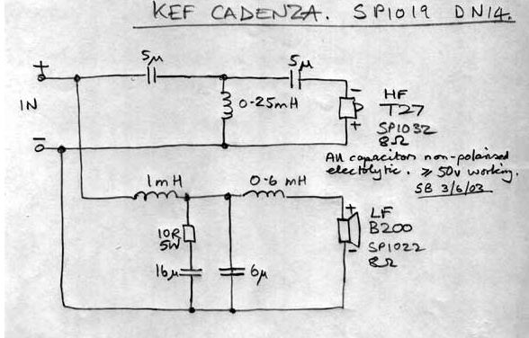

But those of us who like this game have seen this sort of thing before. Here's the 8" B200 bextrene ABR/reflex KEF Cadenza. Not a million miles away, I think you'll agree. 🙂

But really, we aren't getting very far on this. It's time for some proper analysis.
See, we KNOW that LCR with the 560R might as well not be there. The 15R + 2X 2.2uF is actually a 15R +1uF Zobel, which actually does almost nothing either, because it has no series filter resistance to work with.
But it's that little (L4?) nylon bobbin air coil that is bothering me. Like I say, 0.2mH or thereabouts would make sense for a third order filter. I'm also guessing the tweeter could be wired in reverse polarity, but that's a guess.
