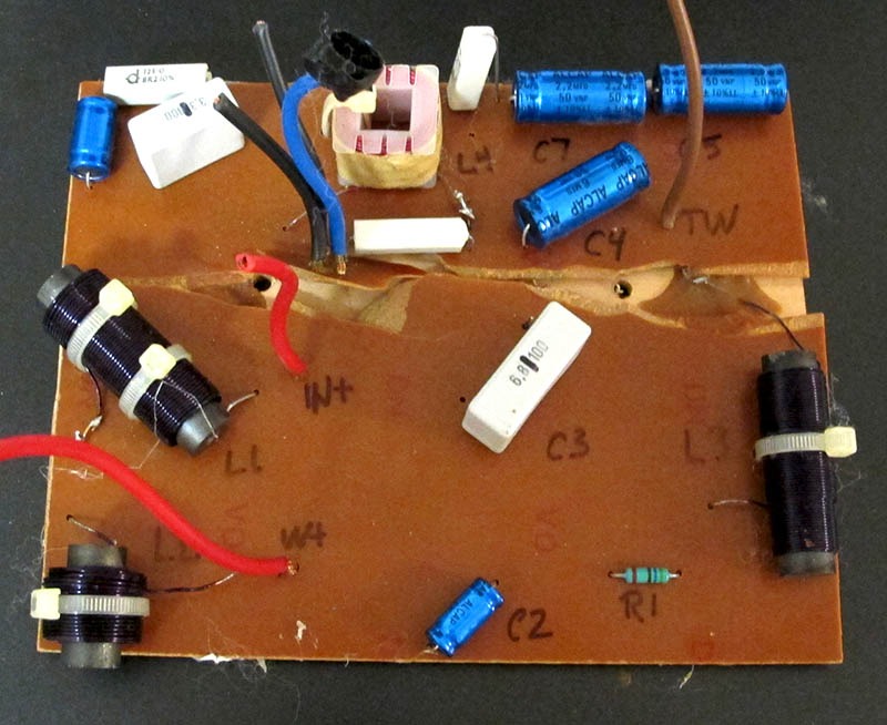

We also had this one which looked a bit dubious:
432152d1407548319-heybrook-hb2-xo-heybrook-hbr-classic-crossover-jpg

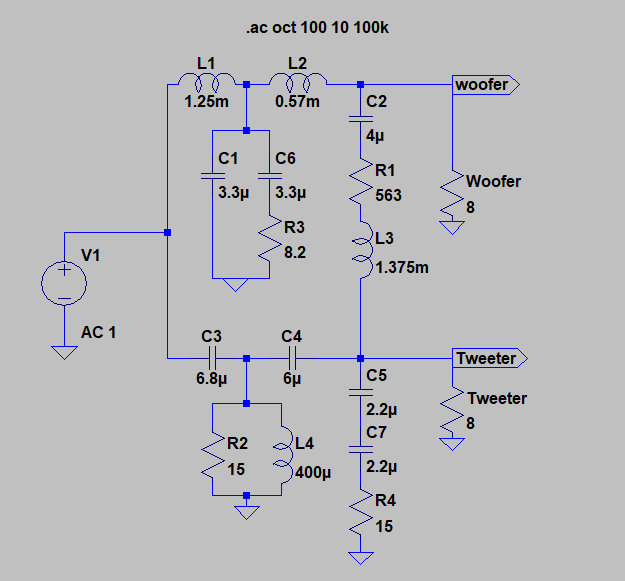

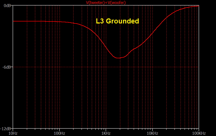

I thought the 3.3uF shunt C6 was small. And 2mH L4 too big.
Nice work.

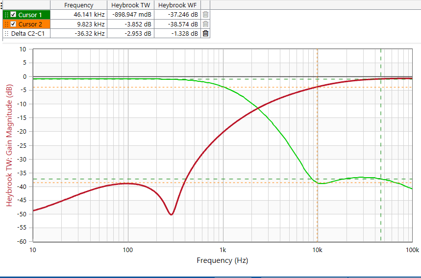

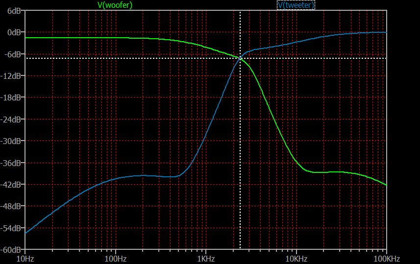

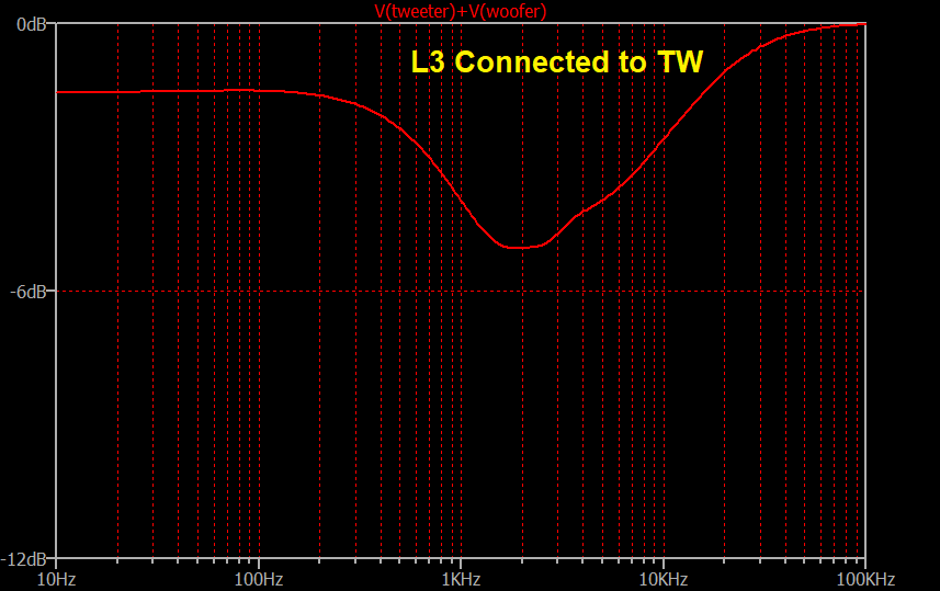

I re-measured L4, you're correct it is 400uH, R 0.7 Ohm. However, L3 is connected to TW+. Pulled it out of the cabinet and did some measurements of the electrical response (8 Ohm resistor loads).

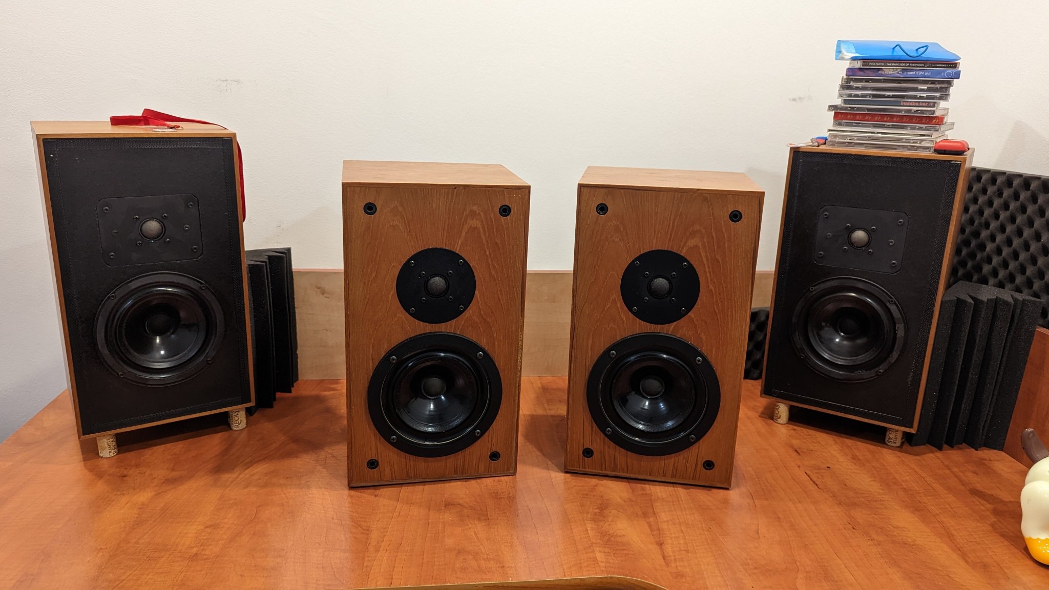

I've currently got a pair of HB2s, one of which needs a new bass unit. I'm trying to find someone who can repair the bass unit, which has rubbing voice coil, and will post again if I find a solution.
