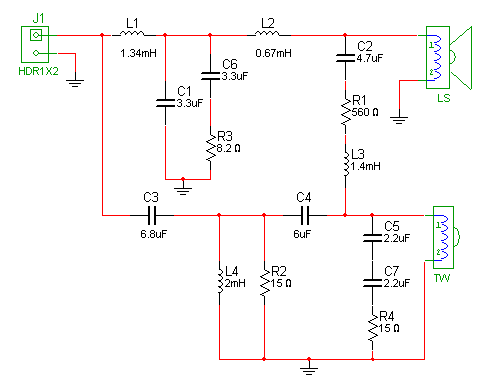

This is probably the Saturday Night Party syndrome.
Some drunk turns the amp up too high and the 6R tweeter blows. Now the speaker has no top end so he turns it up even more into clipping, which directs huge power (like 20W) at the tweeter crossover circuit.
This all goes into the 7W 15R resistor, rather than being shared with the 6R tweeter. Which burns. Often damages the amp too.
Better designs have a resistor at the input, which can help. But clipping is never good. A tweeter section rarely takes more than 5W in normal use.

These speakers were purchased by my parents when they were in their late 70's and the picture you paint made me smile....
I think the problem occurred when these speakers were passed on to me and where used for a time as test speakers for amplifiers I was renovating. One particular amplifier, an Onkyo, had major issues with overheating on one channel - probably due to oscillation (?) and this could have caused the damage.
It was my fault for using good speakers in this role... I no longer do this!

I was just reminding myself what this thread was about...
The mysterious "Enigma" LCR.
Most of the circuit is fairly standard for the time, and KEF used something like it in the 8" bextrene Cadenza:
I did run a sim of the circuit, although I can't remember if I used 0.2 or 2mH in the tweeter circuit. Looks like the bass circuit is mostly bafflestep and 3rd order rolloff. So my guess is almost any well behaved polycone should do the right things.
Peter Comeau might add something.
