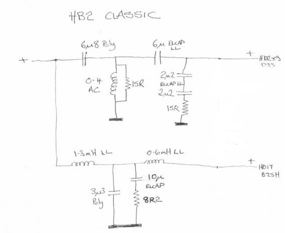

Ho hum, the crossover in the photo doesn´t resemble the Xovers in my original Heybrooks- the use of Alcaps (cobalt blue) instead of Elcaps (black with red ends) suggests it has been rebuilt and as far as I can see there is at least one Poly missing and a 10uF lytic.. Also my circuit (Post 30) doesn´t look the same although I am not the best person to express an opinion about a circuit schematic.
Ah, I missed that link. Yes, this all makes sense now. The LCR is unnecessary, but I'd say this might work well enough. Thanks, Swarky. I hate stuff unresolved.
The circuit is correct as it stands as confirmed on another forum by an ex-employee of Heybrook. (By the way he says that all your conjections on this thread are incorrect). Although not directly involved in speakers, he believes the enigma circuit has something to do with "smoothing out the phase response".
That would be me. I spent a lot of my life between 1981 and 1984 soldering up HB2 PCBs and assembling the complete speakers.
There seems to be a bit of an upsurge in interest in HB2s at the moment, and many will need attention to their crossovers by now, so we need to make sure that not to much misinformation is being distributed.

No we didn't, or at least not while I was there.. Obviously, drive units and cross-over components were bought in. Crossover PCBs were to our design, and assembled in house (originally by me). Cabinets were made, again entirely to our design, by a cabinet maker whose name I completely forget who belonged to Monitor Audio. Assembly was again entirely in house, and QC was meticulous.
I vote for an assembly error (with no effective QC procedure), more common than you might think in boutique speakers. Don't kid yourself that all expensive speakers are individually tested - at those price points they should be, but they're not. It's entirely possible the "master" crossover the assembler was required to copy was wrong, thus many speakers would have the same mistake. It might be days - or weeks - until the error was discovered. This kind of thing really happens, especially when the original speaker designer is off-site and doesn't make frequent visits to the assembly plant.
Nope. Not an error. And we didn't work like that. Every single pair of speakers was plugged into a system and given a listening test. If you listen to the same track 20 times a day for 4 years, you very quickly learn to spot problems, especially when the "original speaker designer" has his desk in the same room. The listening test was more than adequate for catching wiring and crossover assembly errors, of which there were a few . I don't ever recall a pair of speakers being returned for incorrect assembly.
We didn't have a "master crossover". I knew what it was supposed to look like....

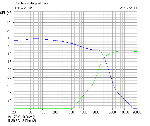

The reception received by the HB2 was universally positive. It sounded bloody good and it still does, for two main reasons. First was the rear-firing friction-loaded port which gave it a decent bottom end. Second was the choice of drivers, along with the crossover design. Two blokes with brilliant analytical skills but little in the way of intrumentation put two years of their lives into getting it how they wanted, and succeeded in making a speaker which was a step ahead of anything around at the time, so in what way is it "wrong"? It worked, and it worked really, really well. If that's shoddy design, I'm all for it. As for shoddy assembly and clueless ex-employees, I couldn't possibly comment....
Hi, I'm coming a little late to this party because I've only just found this thread by accident while looking for something else.
As it turns out everything shanewhite says is true and I thank him for his diligence in re-constructing the company history in a potted precis.

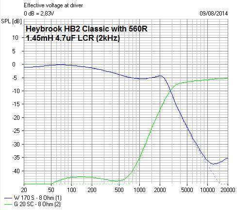

Now, that peculiar bridge circuit! Hah, yes it doesn't model in a circuit simulator, does it? And therein lies a peculiar effect caused by the fact that it is actually quite difficult to reproduce reality in a circuit simulator when you are dealing with gross electromechanical devices like loudspeaker drive units. These things are really very difficult to model effectively due to their mechanical distortions, which are level related, and their constantly changing impedance with frequency. Put that together with a crossover where the load reflected to the amplifier also changes dramatically with frequency and you have a whole catalogue of sonic effects which circuit simulators don't take into account.
Look, if it was that easy to design loudspeakers everyone would be putting together award winning speakers from every company every month. However we all know that doesn't happen. The number of good sounding speakers which are accurate enough to replay a wide range of music enjoyably and with realism are actually quite hard to find.
So, back to that pesky 'bridge' circuit as we called it originally. There's no apparent reason for it being there. But when we were designing the original prototypes we just felt that we were missing some integration between the drivers. Like most things in audiophile hifi, this 'bridge' circuit came about as the result of a fortuitous experiment.
It doesn't affect the measured response and, as you'd expect from the 560 Ohm resistor, it doesn't affect the impedance. But I can tell you it DOES affect the sound. Change that 560 Ohm resistor value or remove it and the coherence between the drivers subtly changes. The speakers just don't sound so coherent and the stereo image isn't so 'out of the box' without it. Similarly we tried different types of coil for the 1.45mH in series with it and they just sounded 'wrong'. Go figure!
I also noticed a comment on the 1.1uF and 15R across the tweeter as a 'Zobel' network. As pointed out these are the wrong values for a Zobel network. That's not surprising as that's not what it is. All it does is just tame a little bit of 'zing' from the Audax tweeter.
Also note the layout of the crossover PCB, the distance between the components and the odd angles of the coils. These were all part and parcel of listening to the magnetic interaction between coils and capacitors and our way of minimizing coloration due to it.
Furthermore we developed the crossover sitting on top of the cabinets, so it sounds best on the inside of the top of the cabinet or behind the tweeter, NOT behind the bass unit where most people put crossovers for ease of assembly.
Nowadays I wouldn't do it this way. There are better ways of effecting good coherence between drivers using more conventional circuit ideas. But, at the time, we didn't have the luxury of simulation software like LspCAD to help us. So we just tried things and listened. The HB2 crossover, with its odd circuit, was the result. And it worked. It worked so well that the HB2 became a landmark product at the time and put the company on the map. That the HB2 remained in production for a decade, practically unchanged, is testament to its performance and popularity.

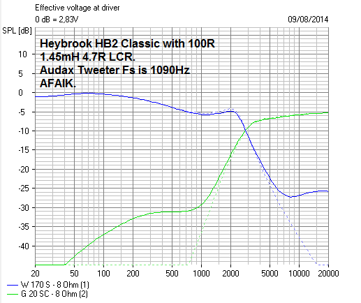

This is a Third Order Butterworth filter AFAIK, quite the vogue at the time, rather than the currently fashionable LR4. Very flat power delivery being its strength.
Of course, the mystery was the odd 560R LCR connecting the two drivers. It DOES actually DO something, but does a lot more with a 100R resistor. In fact it all then looks terribly familiar if you know the whole crossover oeuvre.
What an artist might call an "interesting failure", if he's honest.

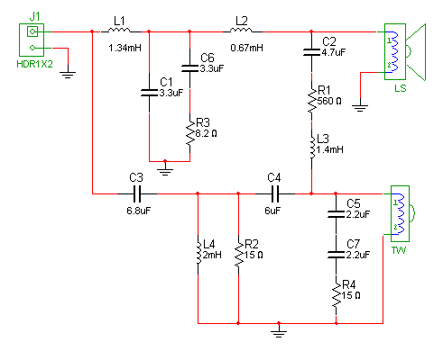

Resistor in HB2 Crossover has run very hot...
My apologies for attempting to reopen such an old thread but I am in the process of recapping my father's HB2s and have come across a bit of a puzzler.
The 15 ohm resistor R2 in one of the crossover has obviously been running very hot as the PCB underneath it is substantially charred. The other crossover shows no sign of excess heat.
I don't pretend to really understand this circuit, particularly after digesting this thread!
Could a burnt out tweeter voice coil have caused this? If not has anyone any ideas what could have happened here.

I'm no speaker expert but a couple of thoughts...
1/ Could the amplifier it was used with have a problem such as high frequency oscillation/instability ? That could cause a very high dissipation in the resistor.
2/ Make sure that the other passives around the resistor are OK. L4 should have continuity when tested out of circuit, so make sure its not open. If C3 were short circuit then it would stress the resistor.
It is certainly possible that it could have been exposed to high frequency oscillation as these speakers have been used with many amps over the years.
L4 and C3 are good
Thanks for your comments .. my concern is that I don't want to blow the new tweeter voice coils... the amplifier I will be using is totally stable and will not oscillate
