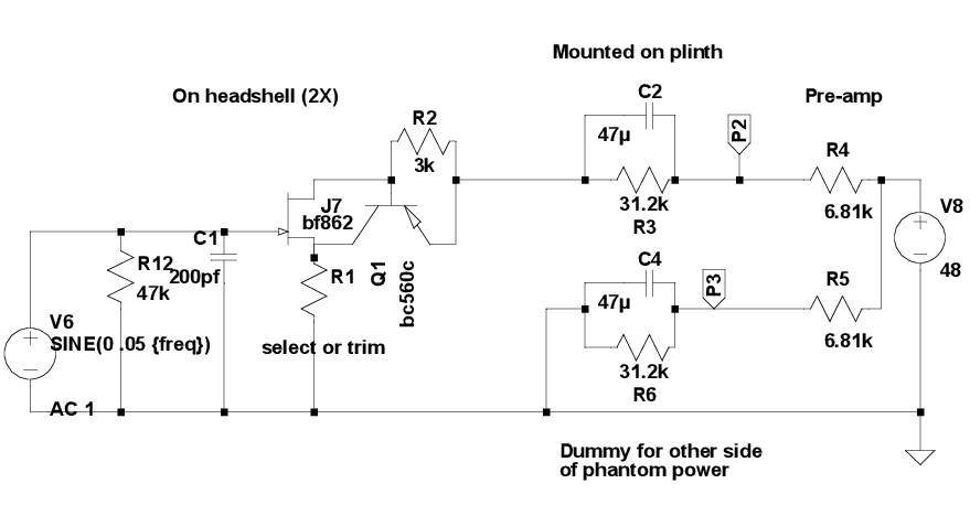

Patrick: What I posted from the other thread was 1C, 3R and 2Q per channel for MM. Is saving one SMT resistor and 1 sot23 really that vital other than fun value?
Also 5g!!! I have tonearms with that effective mass. Then again putting it in the base is almost as good.
Too many components at the headshell for my taste...
imagine how it was made ~40 years ago with th parts and probably metal die of BC109C...

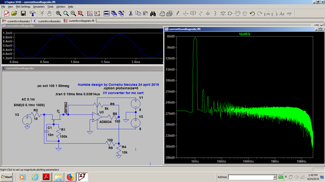

I just modified one of my latest designs for i/v conversion for a mc cart input...I'm not an expert in mc carts...i just put a 0.1mv voltage source and a 10 ohm series resistor to sim the cart and an approximate 10x gain...I just used an available fet opamp in the library but that opa1692 might fit the bill.You get the fet bjt input and the transistor bjt input...You can do a lot of things with this arrangement I'm still studying it .Some of the components might be skipped , capacitors made smaller in value or removed.
Something like this ?
Won't win any spec contest (-100dB pure 2nd).

Certainly works, are we still talking in the headshell here?

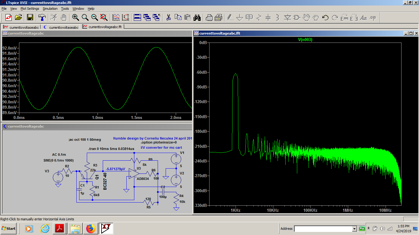

The third picture is using the 5v usb supply so YOU, the digital masters can add adc , dsp and blutooth 🙂 Lt Spice made us a present of -126db THD.We should grab it as it is still for free !
These circuits seem to put DC current through the cart, not recommended. The first one also has both the gate and drain of the FET at ground potential?
It might put some dc in at startup , that is true...I only tried the bjt version on DAC output (there's a long topic about it ) , today i'm going to try the fet version (2sk117) on a pcm1701, but i think you can figure out a solution for that dc at startup.It's virtual ground after all.220uf/6v might be small enough with some manufacturers.
It's virtual ground after that.
OK, so in the first circuit all three terminals of the FET are at ground potential, how does it do anything? It will act like small resistor but I don't think that is what you want.

It's true indeed that biasing the gate is improving the distortion figure by 10db, but i really am curious if the spice prediction is right cause i tried with three different fet trz and it works with all of them in simulation.Today i'm going to find the truth with my Denon DCD 1560 as Guinea pig .If it's not working , just use the positive rail and a second resistor...

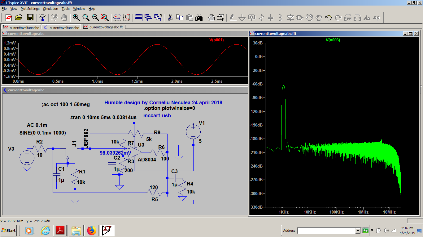

God damn! It's working really great without positive bias!
The noise level is ...next to NONE! That fet i/v section is getting me about 5v RMS from 1ma...
I'm absolutely positive about it used with an mc cart, but i'd probably go with the bjt version for mc cart because of the noise reasons.

The FET has 0 volts on all three terminals it indeed does nothing but act as a low value resistor, you get exactly the same result simply shorting it out. You clearly have little or no understanding of how these devices work.
If you would have looked at my schematics in my other topic you'd see that i tried both, fixed bias and autobias , you can see the 5 v separate power supply on the schematic.I didn't wanted to use it mainly for i didn't wanted to deal with power supply induced noise.I lost 10 db thd out of 130db...so it doesn't really matter.

It doesn't work, the FET does nothing and the op-amp does all the work and you can't figure out the difference.
If you are claiming a novel circuit you must verify that the FET is not behaving like a resistor. This should be easy to do. Also bear in mind that FET models are woefully inaccurate.
