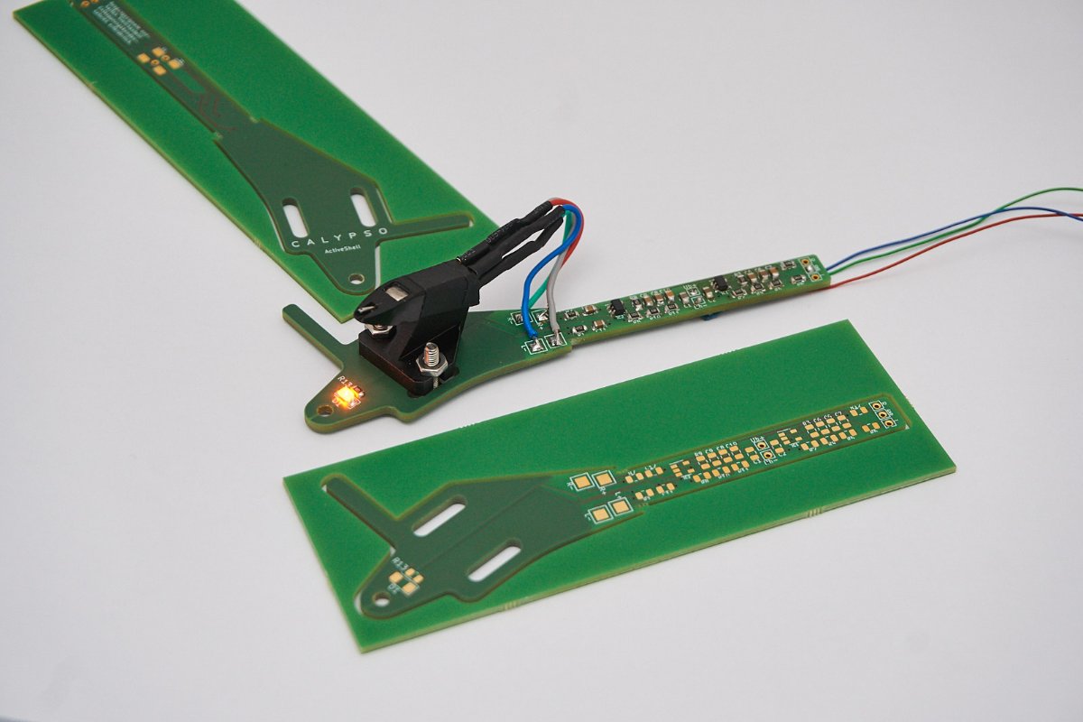

I have wondered about this and designed a PCB 7.5mm wide with RIAA stages and 4-pole rumble filter. So far one of them has seen service inside a diecast box rather than a tonearm, since building or altering a tonearm is a more daunting prospect for me.
One thing that strikes me is that mounting such a long thin pcb inside a metal tube using foam inserts might act as effective damping of tonearm resonances, and keep the signal wires short enough that they cannot rattle around inside (is this an issue?)
Of course one downside is changing the cartridge (type) means having to change the arm too.
I used SMT NE5532's and OPA1612's in a couple of copies of the board, the picture doesn't show the PPS RIAA capacitors and decoupling caps which are on the underside. Mass is a couple of grams or so.
This brings up another thought of mine - could the tone arm itself be made from FR4 PCB material? Its tough glass fibre composite after all.
