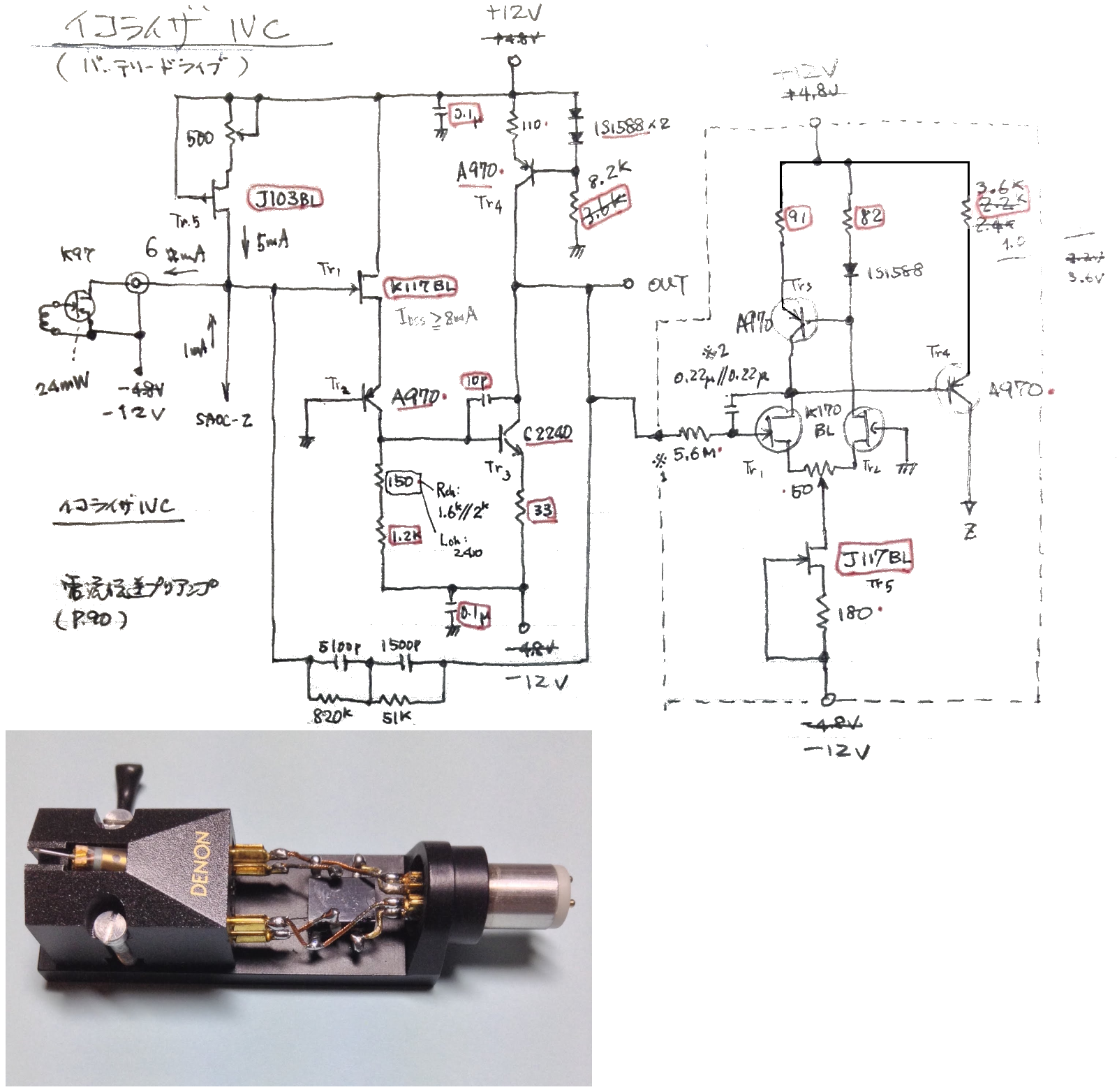

Wonder why with today technical possibility nobody built a A/D convertor inside cartridge. With all correction done digital. Can be small, light and noise free.

Series resistance in cables is almost always not a problem. Hence, the preamp in a tonearm is creating new problems in order to 'solve' something which is not a problem.impuls60 said:I read somewhere that the cable resistance from cartridge cables quickly could be
0.4 ohms. Series resistance is usally bad..
It isn't the problem is capacitance for MM. Now putting the preamp in the base of the cartridge solves the capacitance problem, or at least reduces it to a manageable amount. Many if not most turntables have more capacitance in their cabling than some cartridges call for in total.
I had a serious talk with a Sony engineer(from Oxford digital) about the possibility of doing something similar a few years ago and he said that the main problem would be the digital filtering delay which wouldn't be acceptable for such an application as he allready designed a digital phono preamp on a dedicated DSP made out of a Xilinx fpga by himself a decade ago...
That doesn't make any sense to me. If both channels have the same delay, you cannot even measure it without comparing to a second cartridge in the same groove!
Also RIAA eq is naturally an IIR filter, not FIR, so any delay would be minimal (a few sample periods). Trying to do an IIR filter using FIR is always asking for trouble.
What does make sense is to do the RIAA EQ in analog due to the large dynamic range needed, as in digital domain you lose many bits at the low-end and would have a hard time avoiding audible quantization artifacts after the EQ.
The analog filtering doesn't have to be accurate RIAA if you compensate for it in digital, you just want that low frequency boosted before quantization. Even a one-pole analog filter will do I reckon.

I didn't say anything about inter channel delay...That doesn't make any sense to me. If both channels have the same delay, you cannot even measure it without comparing to a second cartridge in the same groove!
If you're doing the riaa analogue...then you get to the same problem that you needed to cover with a dsp(analogue component's weight).
