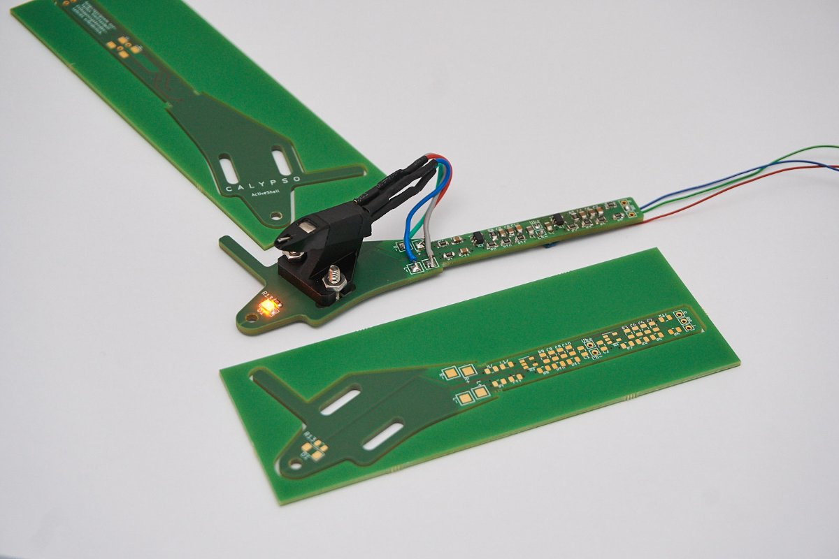

I saw this too, in a German journal. Looks very nice, but would worry about resonances in the pcb though. And probably best to put a high gain 1st stage at the tip.

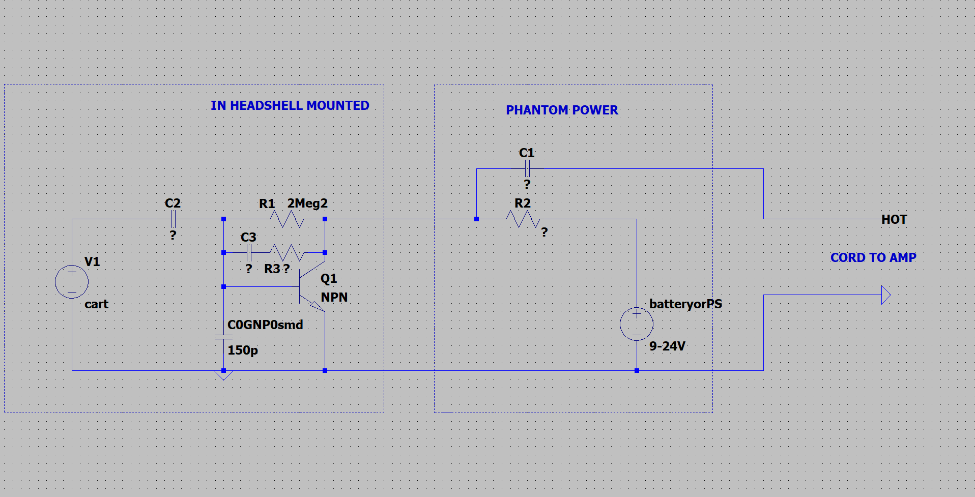

Can you reduce any of those to have just one SOT23 device per channel close to the cartridge ?
I just laid out a PCB which measures 4x12mm, including loading resistors and caps for the cartridge, 2 channels.
It will fit into any tonearm tube, and have next to no weight with 0.5mm FR4.
The connection between main part and in-situ part is also in current mode.
Patrick
I think one FET and one bipolar per channel was the lowest we got. As the coupling caps are waaay bigger than anything else do we need to worry.

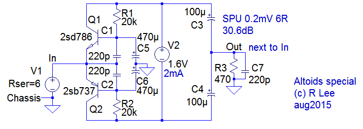

For MC there is the rather nice version of the leach design that Richard Lee did. Only really works on low resistance coils but should convert to phantom power ok.

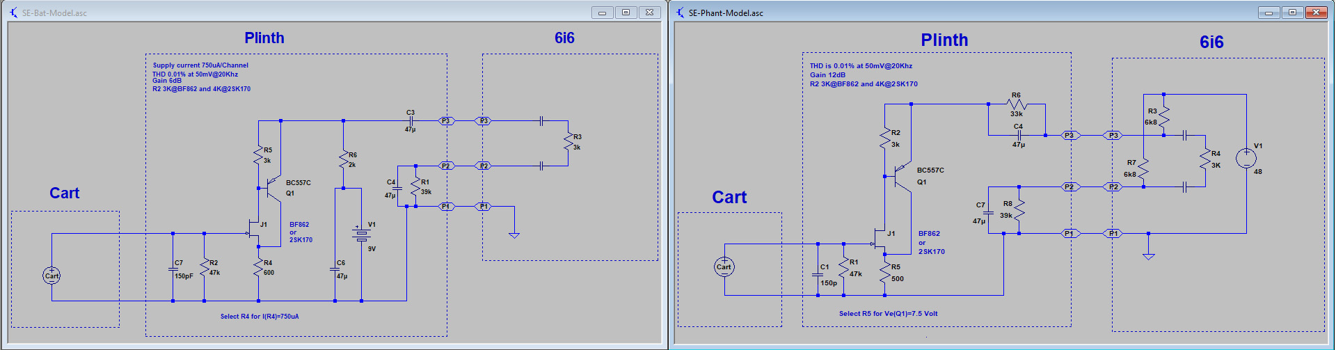

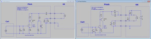

Let's say restrict to 1Q, 2R's, 1C, and 4 wires per channel (2 towards cartridge, 2 towards amp), just for the sake of the challenge.
These include loading resistors and capacitors for the cartridge.
Gain 10x, input 0.35mV at 1kHz, typical for MC.
People will complain 2SK209 is not low noise enough.
So in comes BF862, even though obsolete.

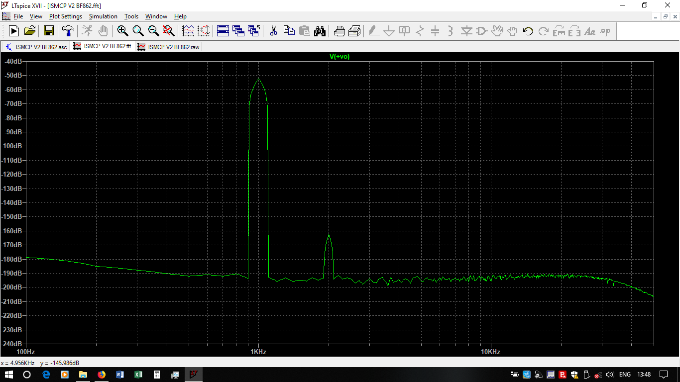

Not bad at -110dB H2, with the rest ~10x lower.
I think I might be tempted to build this, just to prove in reality.
The PCB in the tone arm / headshell will not weigh more than 5g.
