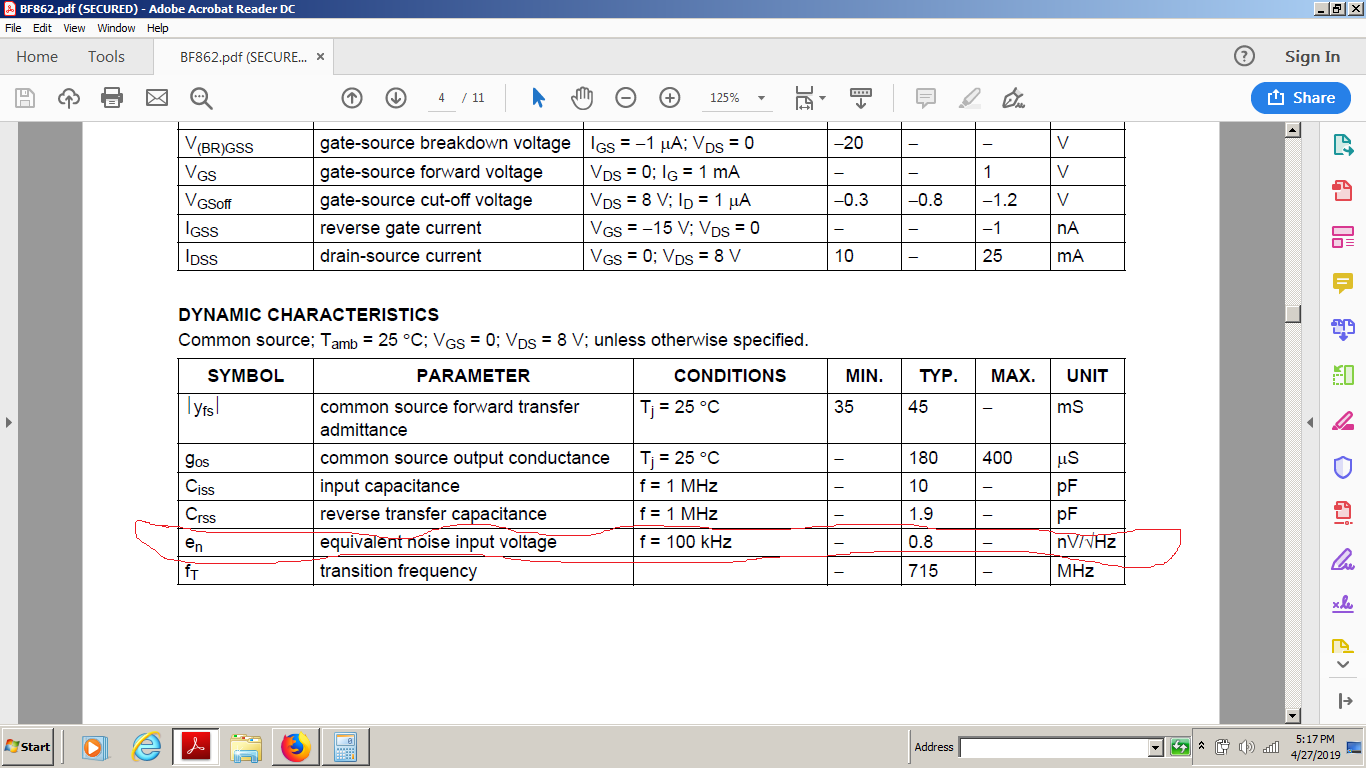

My dac output was 1ma and the minimum guaranteed noise of 2sk117 is met at 0.5ma in the datasheet.I could have used 2sk369 or 2sk170 but their minimum noise is at 5ma while bf862 might be even worse so their higher transconductance might not guarantee anything at 0.5ma .

Actually the simulations are better with lower transconductance transistors than like with bf862 and by the way...there's no noise spec of bf862 in the audio range...................................

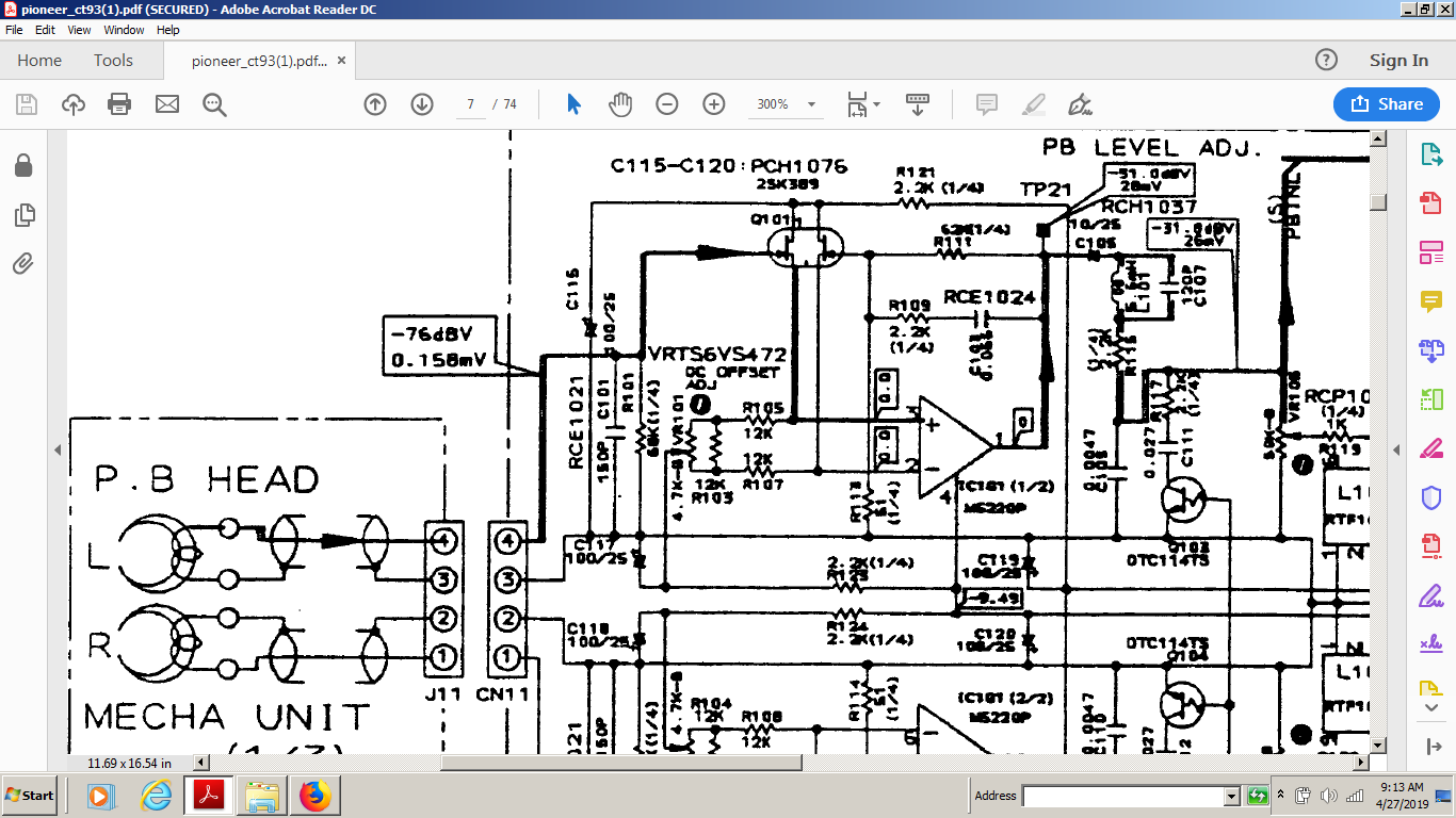

The only commercial circuit that i'm aware doing a similar thing at such low levels is the cassette tapehead preamp used in the Pioneer top models but they take benefit of even a bigger elephant in that room, the cassette tape hiss at 4.78cm/s.
I built that thing by adding the missing parts on another model which was stripped by the fet parts , left only with the op-amp using the holes and pcb traces that were identical just left unsued.
When deactivating the muting transistors(Pioneer, like many others has a smart sistem of hiding the preamp noise when not in contact with the tape ) i could clearly hear a loud noise due to that stage although i used even lower noise op-amps than the original one.
A.N.T. on Tapeheads is using a small 1 stage fet amp next to the head to deal with that noise in some high end cassette players that he is modding, but it's the dolby system that is more effective in reducing noise than any fet input.Fet are only oreffered for the high impedance and their low noise with high z sources...Otherwise Nakamichi had the only real solution with using a fet input in a preamp. You don't need a fet trz with an mc cartridge anyway.
