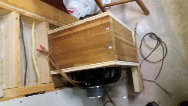

I built manifold loaded infinite baffle subs and the "hit" against the room is negligible where a plain wall mounted woofer shakes the whole room and is unusable. The high frequency cutoff has to be below the 1/4 wavelength on the manifolds longest dimension. With 15" woofers that's about 100hz.
The manifold gives us the ability to add compression to the party, increasing air velocity while adding mass to the cones. Depending on the woofer this can be good or bad.
Did you actually wall mount the subs, I imagine that's asking for trouble?
The manifolds sit on the floor and opens into the room. This view is from the rear and should be rotated 90 degrees.

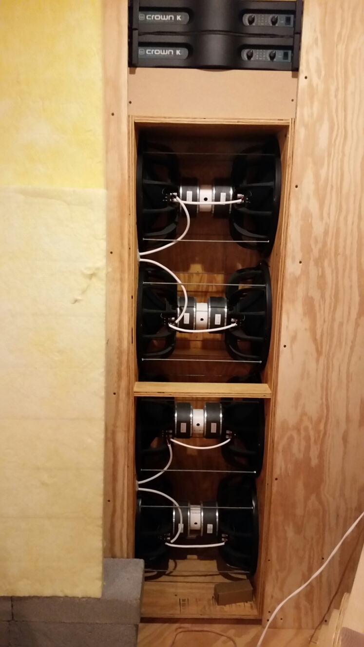

For the infinite baffle bass section that I built, the area behind the device is a closet, which is not heated, nor cooled. It does maintain some of the ambient temperature of the house, but I wanted the magnet assemblies occupying the space shared with the listening room. Thus, I am listening to the backs on the cones. This also allowed me to direct-couple the magnets, for true 100% force-cancelling. The closet space is just shy of 500 cubic feet. The I.B. was built into a jutted out corner. The Fc/Fs of the system is 17Hz.
There is a horizontal brace between each of the 4 banks of woofers. I had a listener visit me and walk over and grab the brace. He proclaimed with the most confounded expression on his face,
"I don't feel any vibration ??"
To which I replied, "That's the whole point"

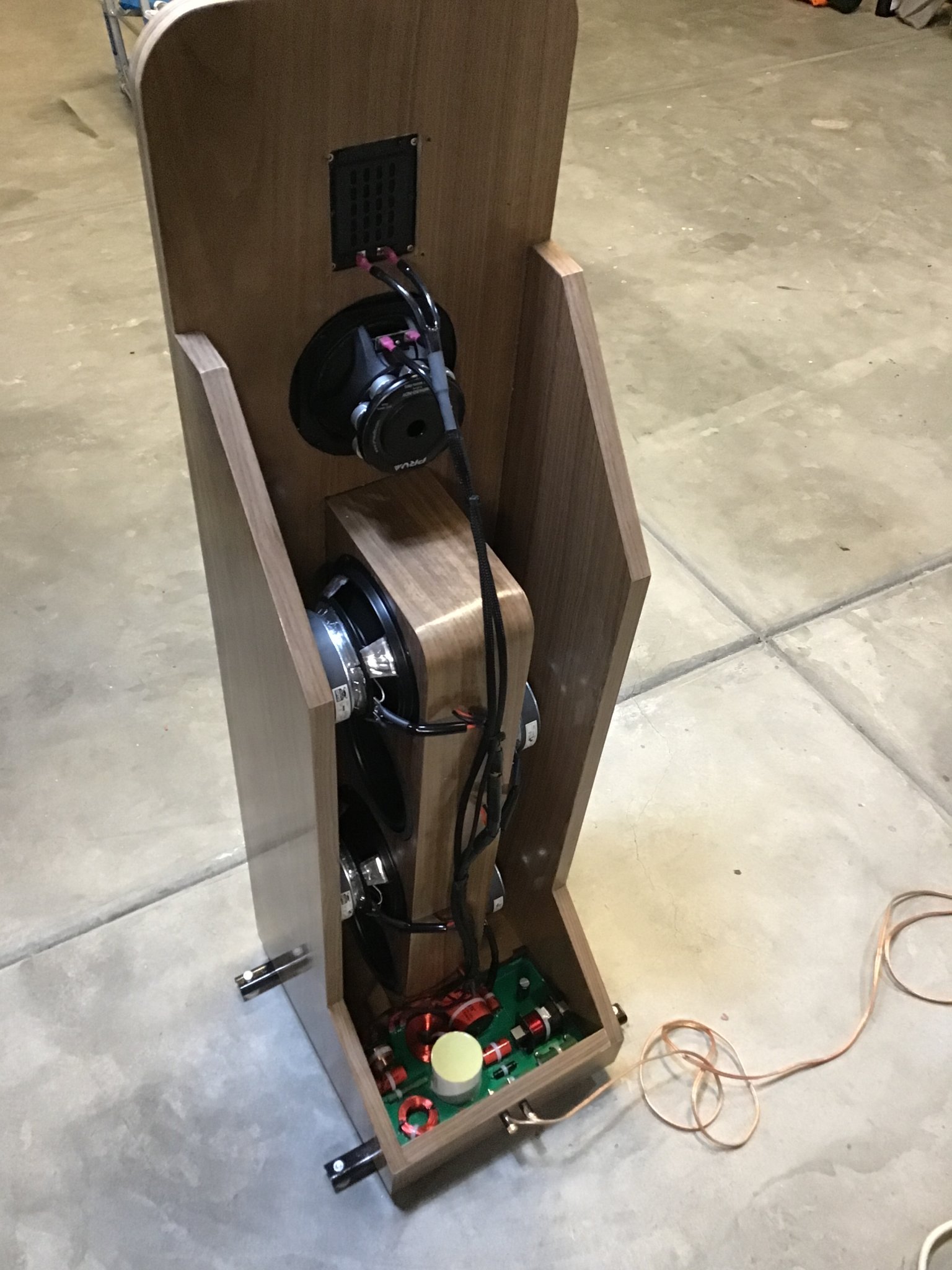

I recently discovered that there is still a slight transmission of vibrations from the cabinet to the mid-high satellites that are just sitting on top.
It should be noted that the small, braced, top panel (on my 2x10” push-push woofers) was the only thing i could get to move. A slab of marble or granite (or solid surface material) sitting on something squishy should squash that. if you just want to isolate the sats, this is where spikes or springs can work. Or half teenis or squash balls)
dave

The area between the magnets which appears to have the horizontal brace you mentioned, is that a PVC pipe with a hole drilled in it? Is there a rod coupling the magnets internally?
Thanks,
Anand.
Hey there Anand,
Good to hear from you, ole buddy. You've got a good eye for detail. Here's what I did for the mounting configuration:
Considering each driver has 8 mounting holes, I devoted 4 of them to threaded rods connected between/and/to the opposing driver, and 4 to mount them to the baffle boards. As I created the tension fit, I slipped in a fabricated for size, PVC pipe, such that the magnets would also be coupled. In this manner, both the driver frames and the magnets are coupled; hence 100%. Considering that the drivers have vented pole pieces, I calculation the cross section area and [yes] drilled holes in the pvc pipe, to avoid air constriction. For the most part though, the cones barely move. For average playback levels, we are talking about maybe 1mm~~probably less.
Eight 15's have a total cone area of 1064 square inches. It's a very high efficiency system. Most times the amps loaf along at less than 1 watt.

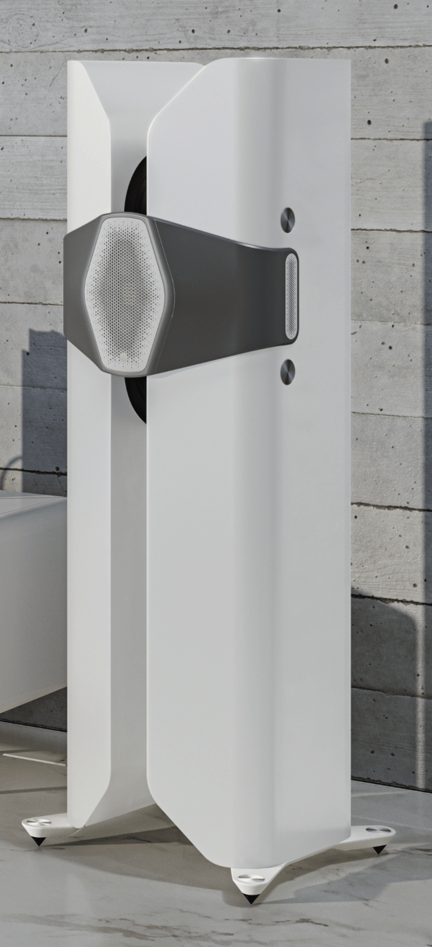

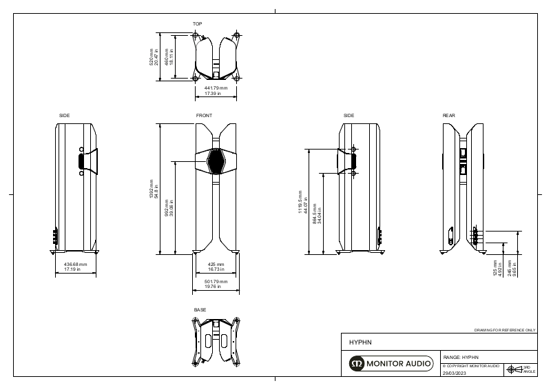

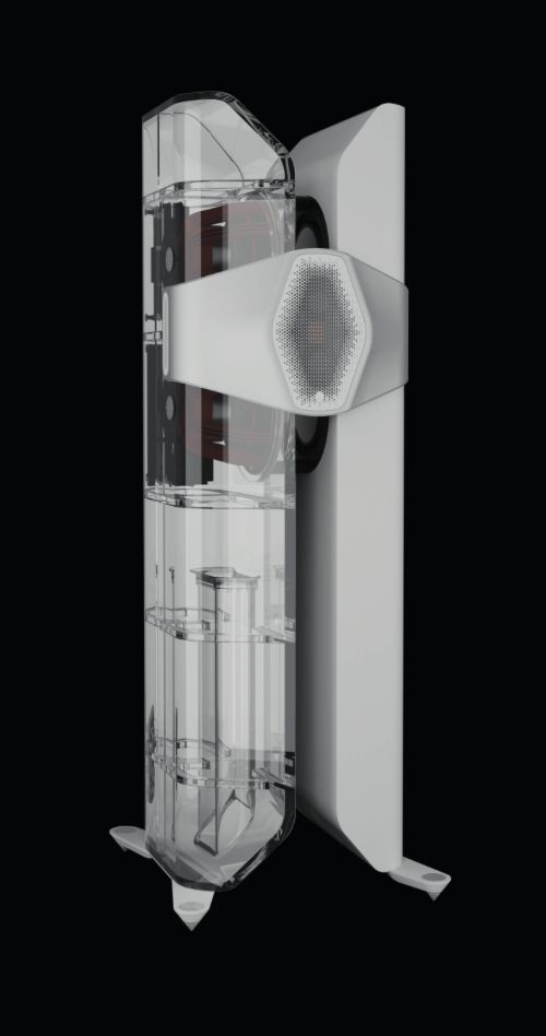

As long as the bass drivers are equaly loaded it can be 1 enclosure (all the ones i have built (or drawn), Monitor Audio has an example where the push-push drivers load into a central slot and there are 2 enclosures. In the latter case it could be more difficualt to get good coupling between the drivers.
dave

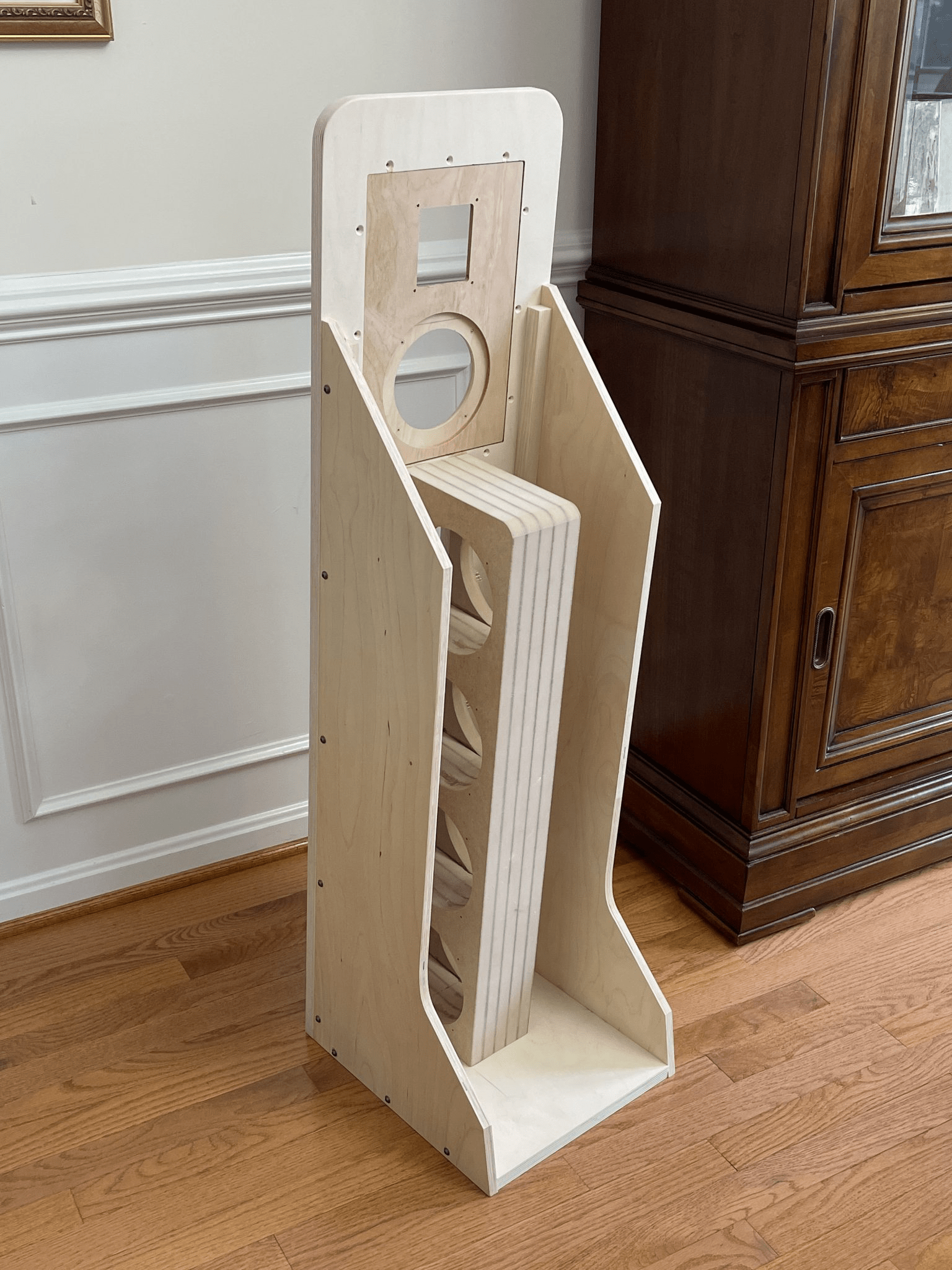

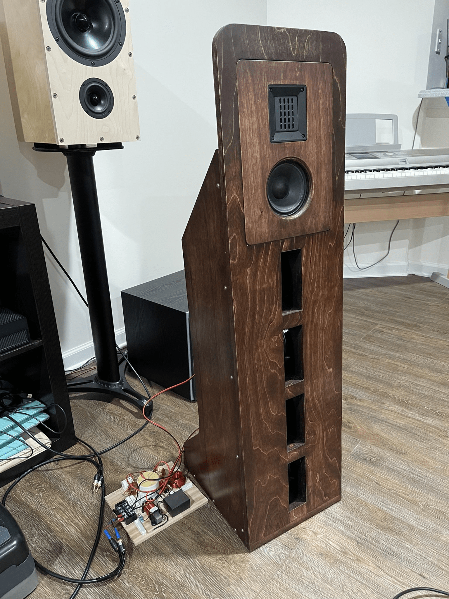

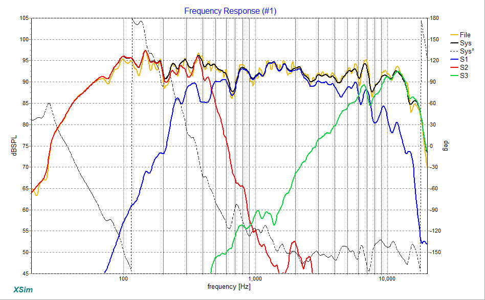

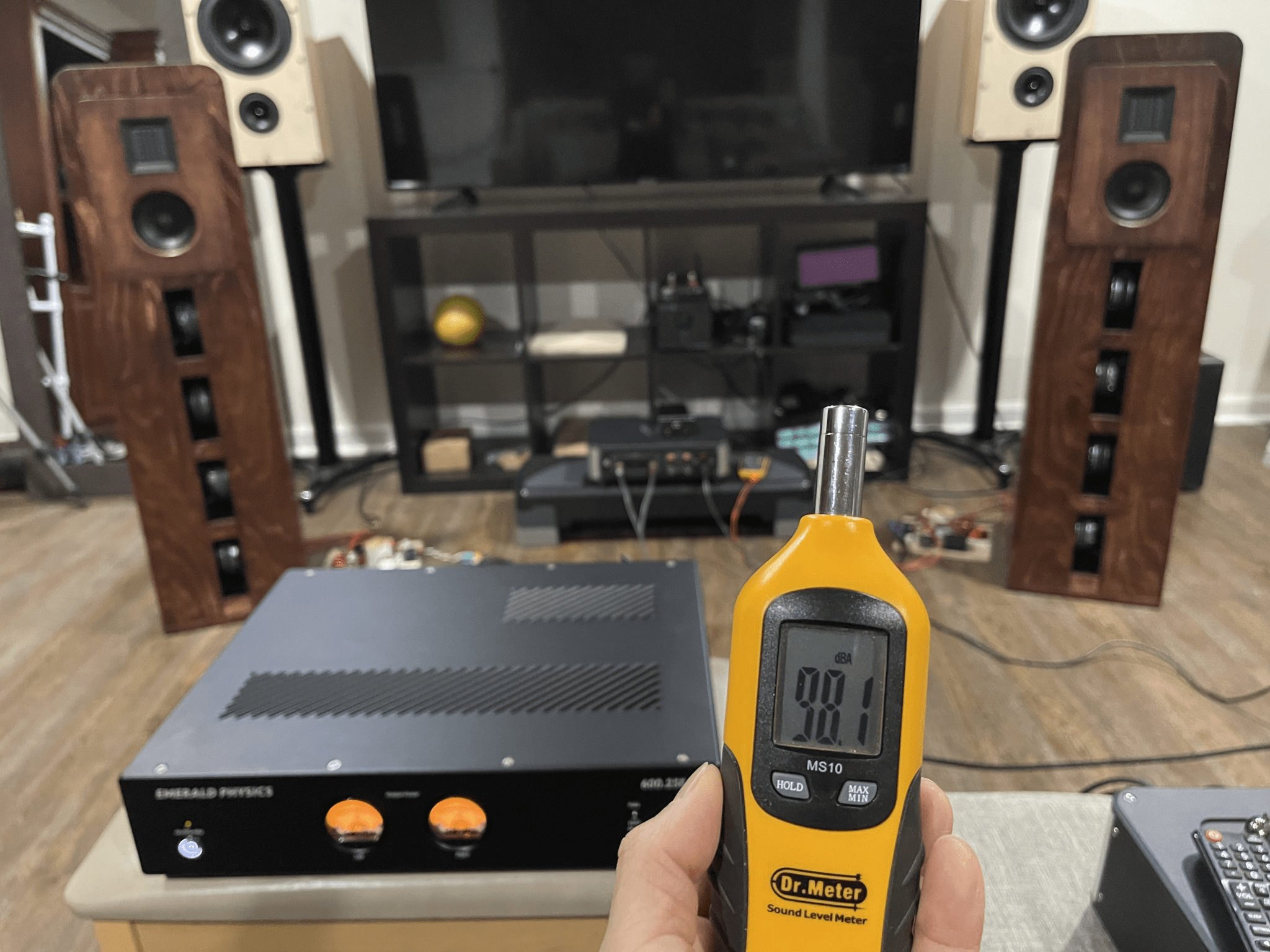

The slot loaded open baffle (SLOB) woofer (inspired by Nelson Pass) that I developed does not have a reflex chamber like the Monitor Audio, but I can attest to the wonderful bass that this type of slot loading push push design makes. I am also using a similar AMT tweeter, and a pro-audio 5in midrange for a 3 way but not in a coax. This is one of the best sounding speakers I have heard.
Here is how the slot loaded push push chambers work:

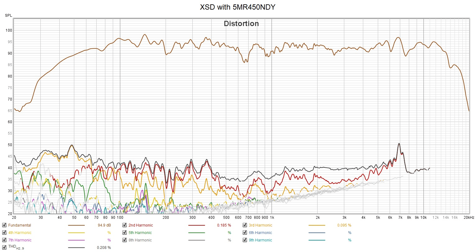

Although it’s a dipole, the slots give some directionality to the bass and enhance the efficiency by about 2-3dB. The slot chamber also acoustically modifies the upper bandwidth to give it a natural falloff (based on depth), so that I can get a really steep 4th order filter at 470Hz using only a second order electrical filter.
The dual driver design with one woofer flipped helps to cancel suspension induced distortion and the bass is very low distortion - even at high SPLs.
I normally don’t listen to music this loud, but this speaker has the ability to play loudly and very clean. Organ pipes in Bach’s Fugue in D minor at 98dB at listening position sounds glorious:
More info in thread.
