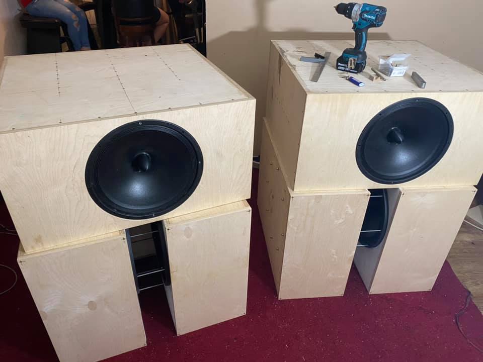

Heres my version of push push slot load. I designed it in Horn resp and so far it looks to be relatively accurate to the design...I won't know until I put it together fully and measure.
Isobaric clamshell configuration is akin to push-pull and should exhibit some of the 2nd order harmonic reduction.
True but off topic. And reduced 2nd may or may not be a good thing and only with cheap woofers.
Nice looking woofers. A but fiddly looking.
dave
Ok....thats good to know about pros of push pull (or lack thereof). Ty for the compliment. As for fiddly...fingers crossed lol.
Did you guys cover the dispersion affects of side mounted woofers in push push? Its a particular polar pattern is it not?
I quick thought experiment was enough, no need to see what was happening. I have tried it BTW, works like a dream, of course, it puts more demands on the cabinet, one way or another, so is debateable how desireable it is, it stops a subwoofer from dancing around though. 🙂I have a quick question: how many experiments did you have to accomplish before you actually started to 'SEE' what was happening?
Thot experiemnt clearly showed the benefits. Series of experiments did greatly improve the effectiveness of the way we achieved coupling.
dave
dave
Basically omnidirectional below 60Hz or so, with a pair of side lobes developing above, their directionality depending on cone size and frequency.Did you guys cover the dispersion affects of side mounted woofers in push push? Its a particular polar pattern is it not?
