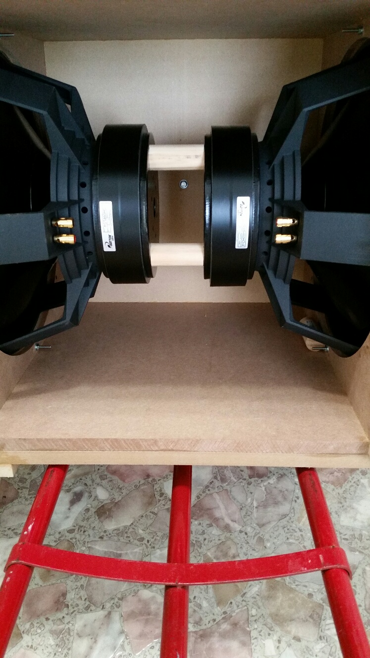

I i ever get them finished, I´ll be more than happy to share some measurements. The nice one is 4x 8" from Seas , and the mean one two 18" PA woofers. Nothing fancy I think, but I figured a party sub might be fun.

We built a pair of push-push subs with SDX10. Part of the effort was to see how much push-push reduced the box load. The box is made of 15mm BB plywood with a simple cross-brace scheme. I can pick up the box with one hand with no drivers, it is a big lift with drivers (i usually get help). To get the box to start ringing i have to turn things up near 10dB louder than i would ever use it. And only the top starts going. And that could be due to amp clipping as the frequencies detected were higher than the woofers pass-band.

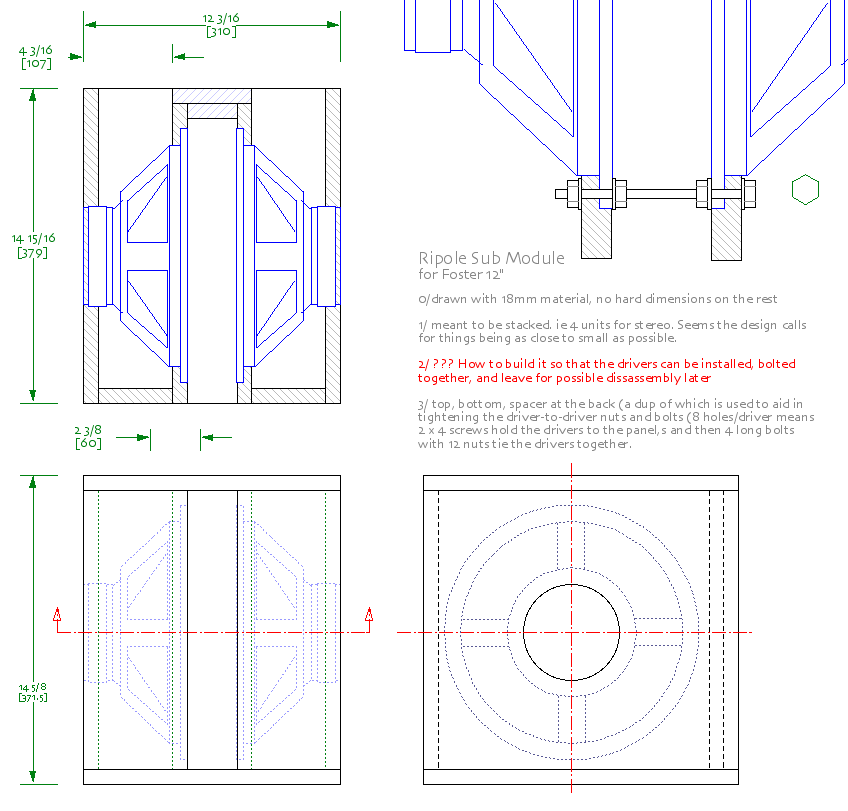

It works either way. With magnet to cone you get reduced 2nd order harmonic distortion due to the hysteresis cancellation. Force cancellation comes from masses moving in opposite direction. Regardless of orientation the mass is the same.
Interesting, I've not considered that distortion could also be reduced in this way. Tight magnet to magnet coupling can actually be very difficult in practice, try it 😉. I did manage it once with a pair of speakers I wasn't too worried about damaging and the vibration reduction was dramatic, I would be concerned though about distortion of the basket if the force of the coupling came from the usual mounting method. The only fool proof way might be to clamp or even glue the magnets together.
Direct vrs indirect force transfer.
The Ripole is a cherry picked example. COmpact size, many small panels make the enclosure more rigid than most.
And there is no reason it can’t be push-push.
attachment.php
Direct connection thru the mounting bolts. Too tight a fit to have room for magnet to magnet.
dave
Reactions: techsi
But one has to worry about it increasing 3rd and less 2nd than 3rd has shown to less sonically pleasing than the other way around.
