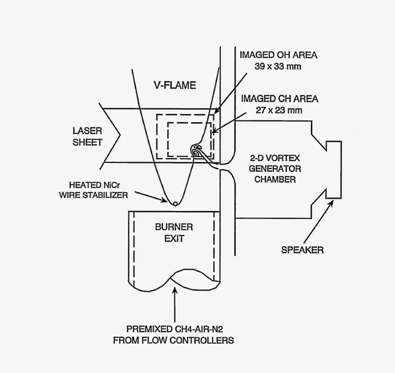

However, a pre-print with poor graphics is available here (original has color images). But the setup Figure of the slot 2D jet with a speaker driver is good since black and white.

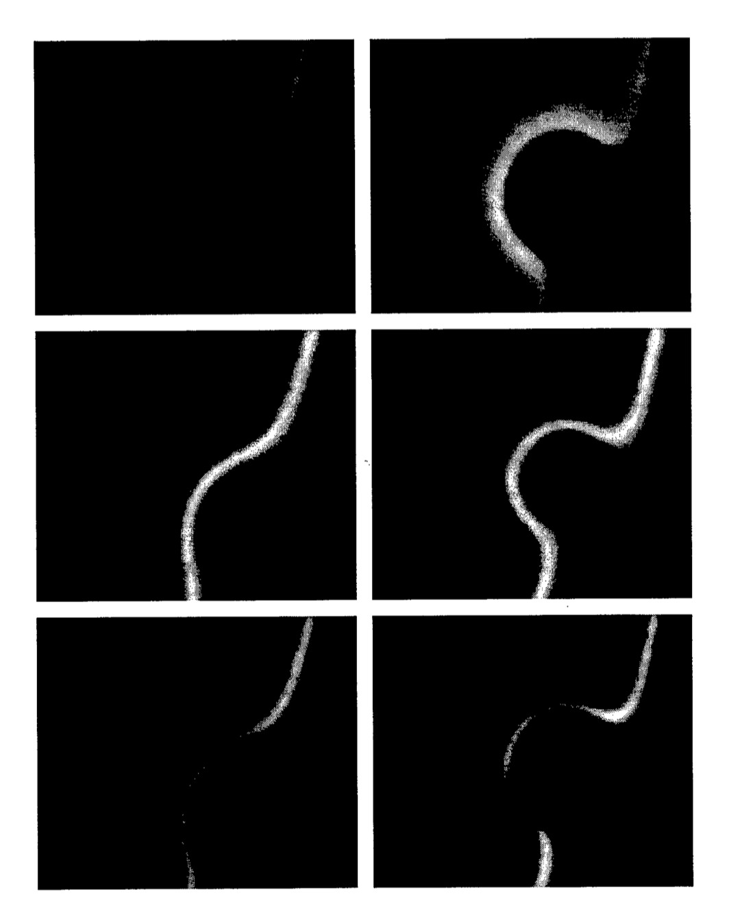

Images from a later paper using same setup but by my co-author, came out better in B&W and looks like this (top is OH (hydroxyl radical), middle is CH2O (formyl radical), bottom is processed image showing a derived energy production rate. First column is an earlier time and second column is a later time (milliseconds apart). I’m sure all of this is way off topic, but the 2D rectangular speaker driven double vortex is just like a slot loaded push push woofer aperture.

Thank you, AllenB. That was a fun experiment and I built a speaker excited slot woofer purely for the fluids aspect. Not shown was a water cooling channel used to keep the whole chamber cool enough as it sat next to a flame. I recall the amp was a rack mount Tektronix general purpose signal amplifier for instrumentation (not audio). I didn’t touch a speaker driver or audio for listening again until 2012 when I joined DIYA. Totally forgot all about it.

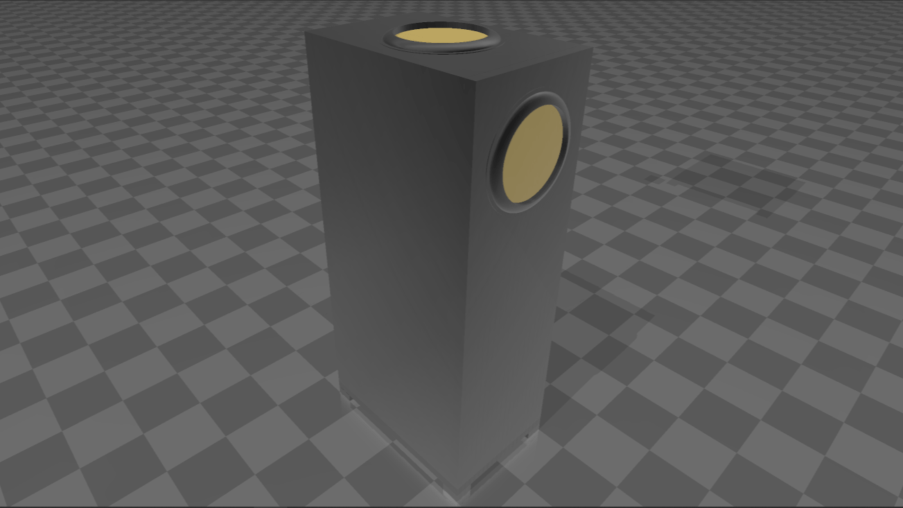

A quick question: Is there a triple push-push (front, top, rear)?
I made a 3D mold to show what it would look like:
The rear part is the same as the front, except it has cable ends.

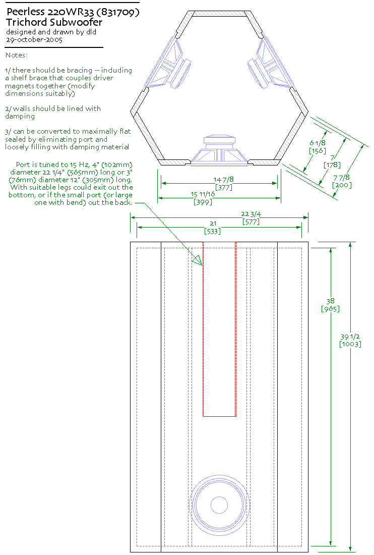

The top driver will not be push-push
3 need to be arranged like this (proper bracing not shown):
