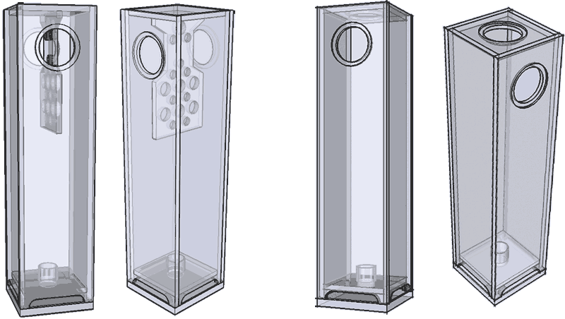

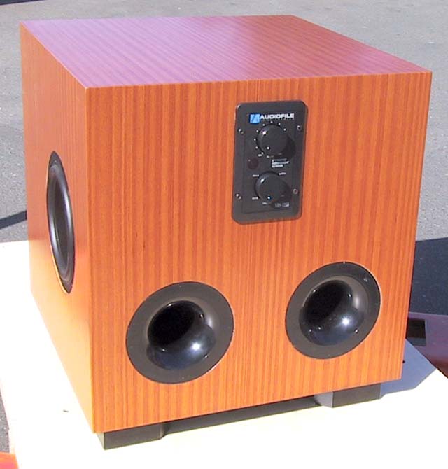

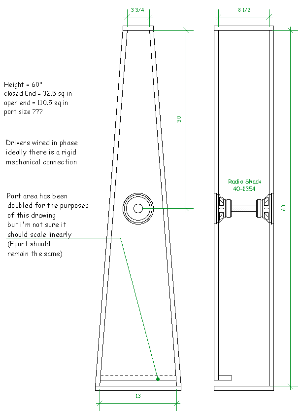

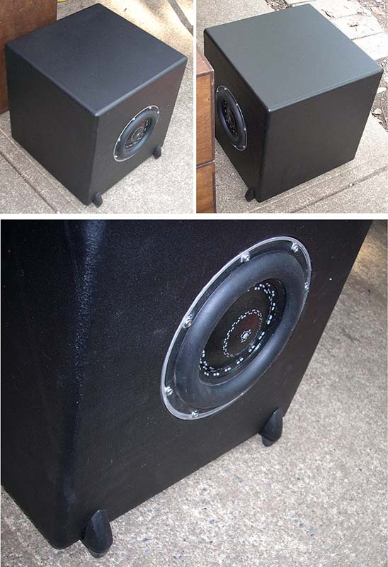

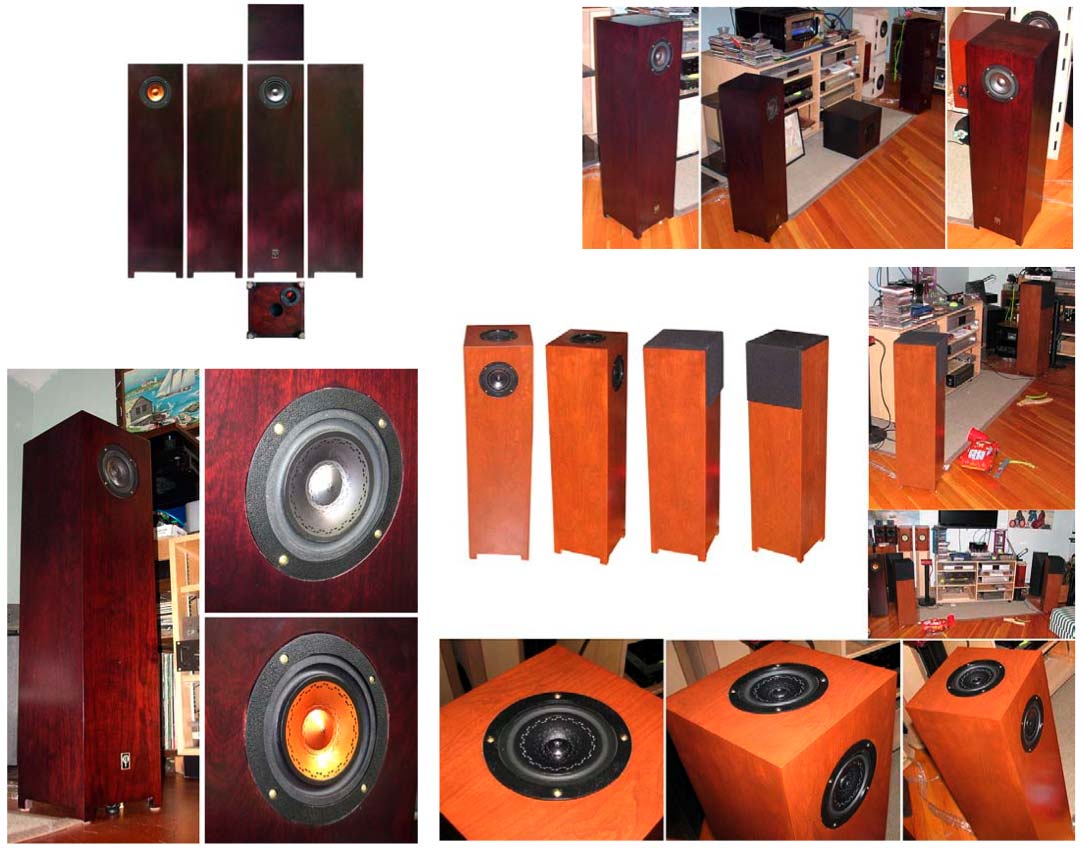

First became aware in the early 80s i guess. A series of thot experiments:
Recycle Woofer
Push-Push Dipole Concept
Bipolar RS 40-1394 ML-TQWT
toobz woofer

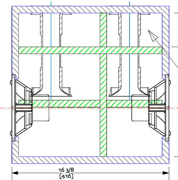

The last using woofers meant to have a lag bolt thru thru polepiece into the box which allowed for bolting the 2 together in a ridgid configuration. This is tricky for amateurs, so mstly , what i shall call, SE Push-Push. Trying the bolt holes together with ready rod, or some other way of tieing the driver bezels together.
Kef in their 104 Mkii tied the drivers together with rods and even more dramatic measures have been made.
It is possible to diy, i worked with a fellow in Scandinavia on an A7/Scan WAW and he devised a clever coupling that alowed him to tie the drivers tightly together and still removable.
This woofer went to somewhere in the US. An early example of more serious driver bracing.
This playe da role as well Mr J did a lot of measuring and work on these:
toobz woofer

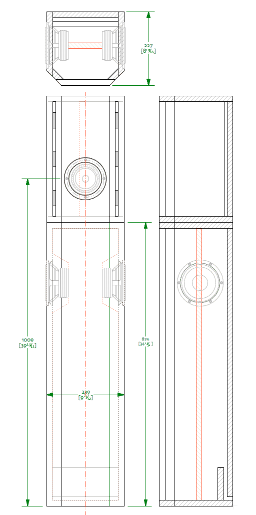

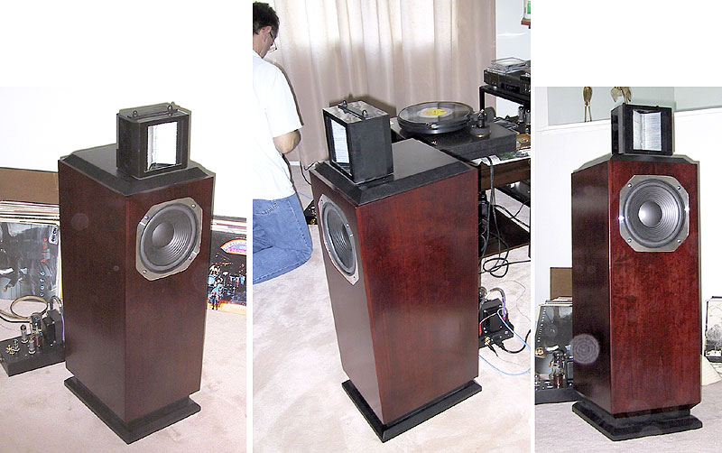

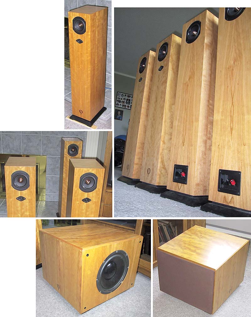

The first PP build i recall was sort of a large microTower with 2 5.25” + tweeters. My brother loves them. Just a hardwood “stick shoved between the 2 magnets (tricky to do). The compact width/depth of the box meant more than useua coupling between drivers due to just the box. Numerous other biPole FRs evolved th ecoupling mechanism, and we found the simple bracing as in that dual 10” subwoofer experiment. Purposely built with 15mm BB, one could pick up the box with 2 fingers in a driver cut-out, but it became a 2-man lift with woofers installed. I had to turn off the HF amp, and set the subs to some 10dB louder than it would ever be played. I could get teh top panel moving. A constrained layer of rock on top would sort that.
We built the smaller one at the end of the doc: http://www.planet10-hifi.com/downloads/SDX10-woofPlans-240418.pdf

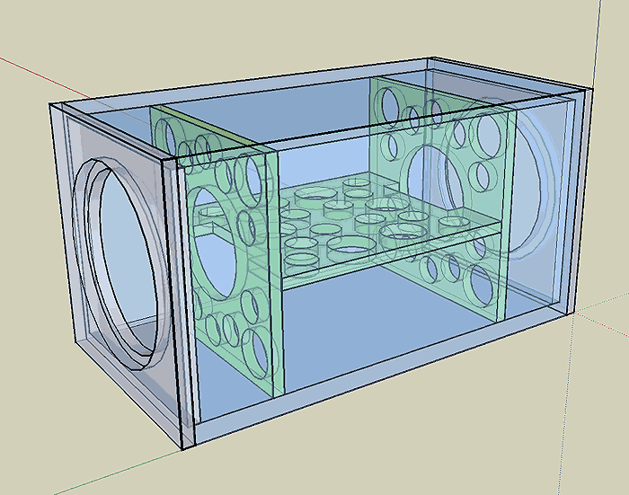

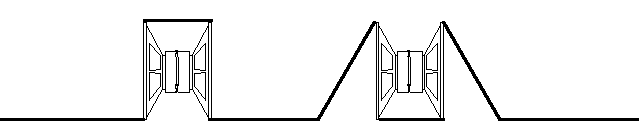

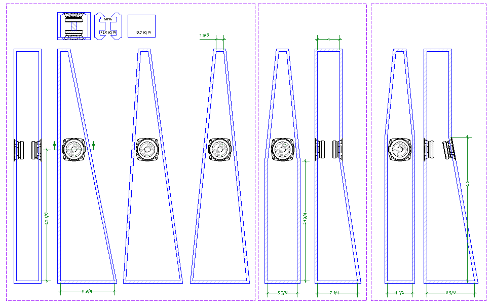

Simplified with no direct coupling:
Ouch-push-push-pull:
A practical coffee table:

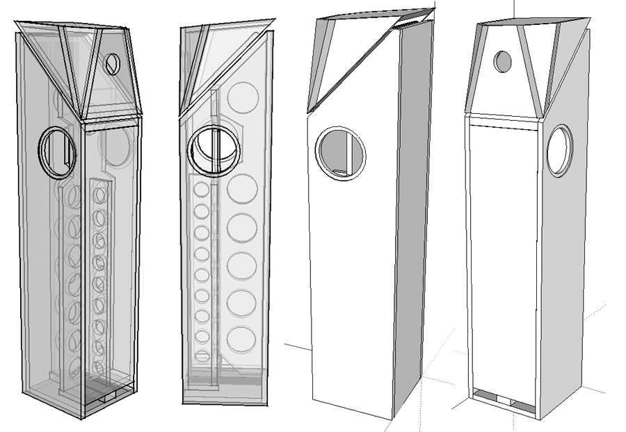

microTowers
Ripple push-push mostly relies on the small “box” (can’t find the simple concept drawing.
http://www.p10hifi.net/planet10/forum/ripole-woofer-module.pdf

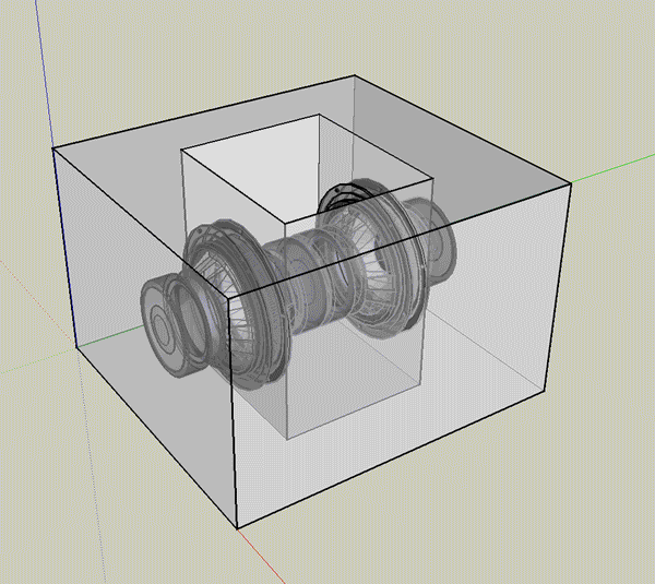

How is this push-push?
It can only be push-pull [or the dorky push-push/pull-pull moniker I saw somewhere] since the drivers are physically tied together:

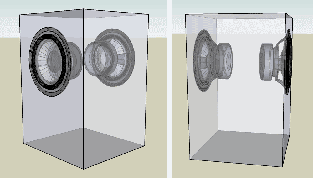

You asked this before on my thread in subwoofer forum. The woofers are acoustically in phase...everything behind the woofer baffles represents the inside of the box. The diaphragms are not physically connected...I think thats what you thought last time you seen this pic lol
It is 2 drivers in phase in physical opposition. The rest is just bolting them together.

push-push/pull-pull is a pair of push-pull isobrail “modules” mounted push-push.
Somehow you are missing something Greg. These are clearly push-push.
Oh well, apparently starting to 'circle the drain' to dementia.......and can't imagine me 'seeing' it any different then too.

The woofer is somewhat unique in that it is designed to have a lag-bolt thru the polepiece.
Yes, a very poorly executed example. 🙁
Had the rod been terminated inside the magnets, not at the diaphragm to clearly show it a bipole and while I would presume it's in phase, it really should have been labeled as such.

There are no dustcap on the woofers. Bolt goes thru the polepiece and does not conact the cones… it does sort of look like a rod connecting the cones — which would make it dipole (push-pull with a wasted box). A felt dustcap is stuck to the head of the bolt.
