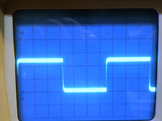

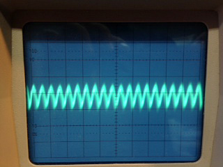

While looking for a alternative volume control I had a go at my new to me oscilloscope. I think I'm finding oscillations in the Pumpy. I've attached photos showing a 1K square wave and then of the 1K up close and the last one is the Pumpy inputs grounded. What ever it is it is the same frequency so I don't know if it just noise or there is a problem. The scope is at the end of it's adjustments, .2uS and 5mV with x5 setting. I see the same results all up and down the volume control settings as well as grounded inputs.

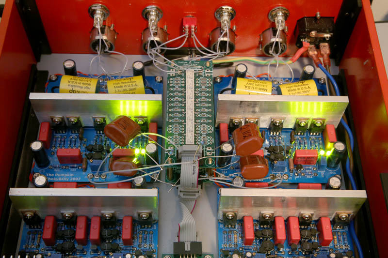

input wires to Pumpkin twisted ?
if that's no helping , tell me values (you're using ) of R5 and R6 , same as C1 and C2
you can try with disarming JP1 as first step , or increasing values of C1 and C2
you can go down to 45-50K (1/(2ΠRC)) without harm
Thanks,
The R5 and R6 are 100k and C1 and 2 are 5pF as per Cookbook. When you say disarming JP1 you mean separate the ground planes? The input wires are not twisted but are short at about 50-60mm.

You're getting something in the range of low MHz - generally I have found that poor wiring on the bench induced positive feedback around an amplifier produces oscillations in the few hundred kHz range. To get oscillations in MHz range I found it more likely to be quite localized to an unstable feedback loop on the circuit board itself, possibly via the power rails or the grounds. Are those heatsinks grounded ? You could try taking a board or two out of the chassis and separating them a bit to see if some local coupling is the problem.
Once I had similar very low level oscillations at the limit of my scope and it turned out not to be oscillations from my amplifier but from another source (another piece of test gear or a nearby appliance - there are lots of sources of 'environmental noise' around my house, including my CD player) that was getting picked up by the scope probe or grounding. The oscillations were still there when my amplifier was not powered!

Thanks for the help. No, the heatsinks are not grounded. I've actually probed them and see the same oscillations. It could be environmental noise. I've done what I could to eliminate as much as possible. Lights off, just the scope and Pumpy on. I'm in my garage and there is nothing else on the power circuit.
