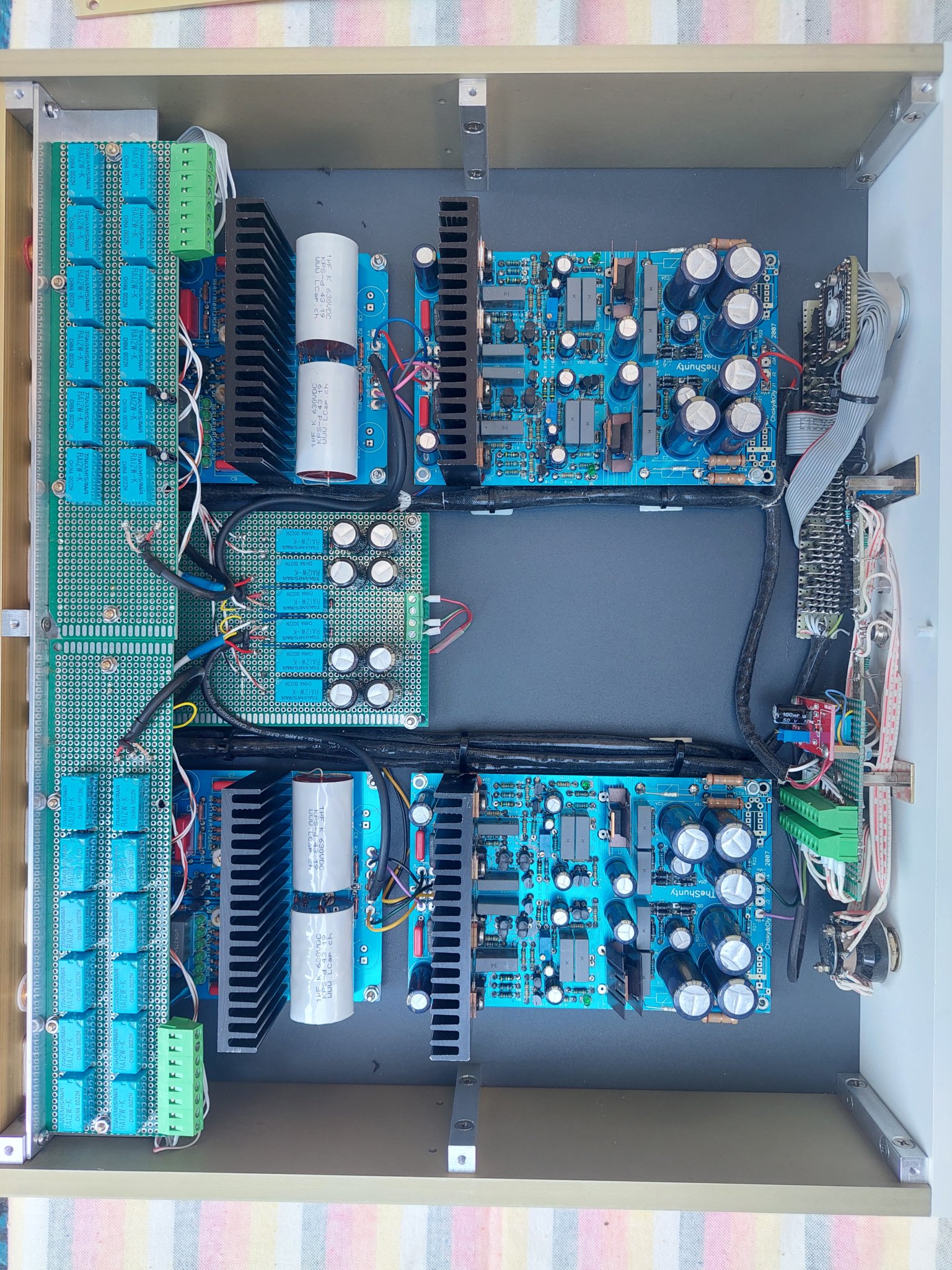

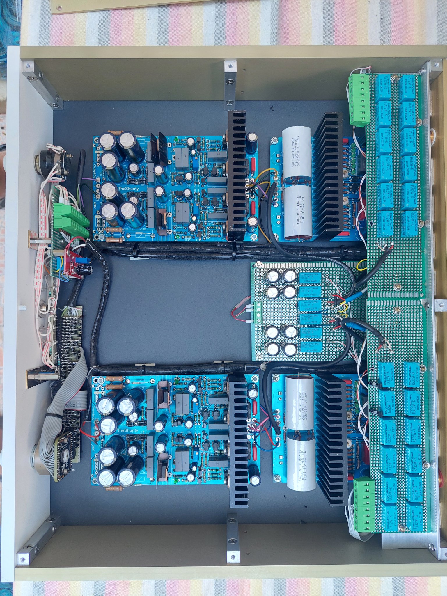

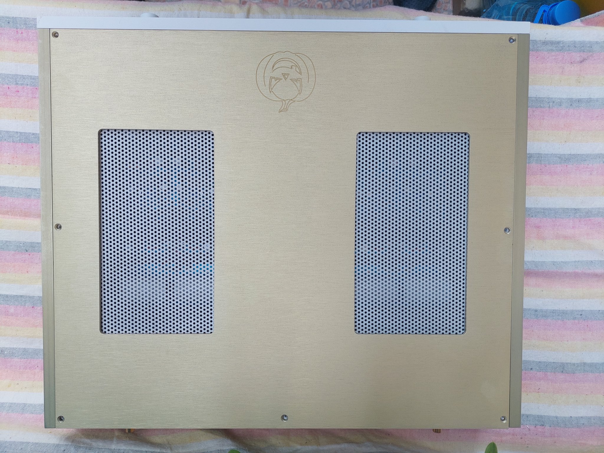

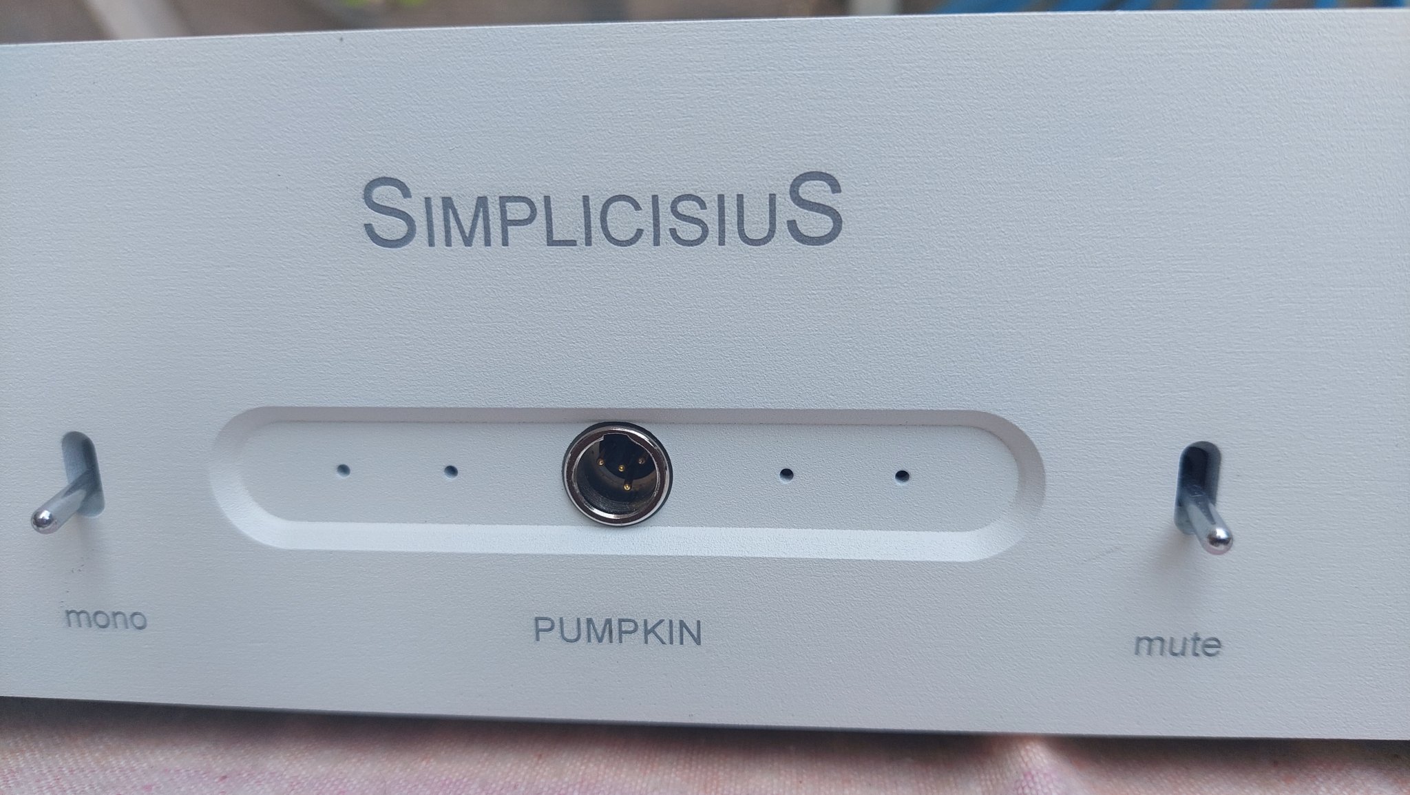

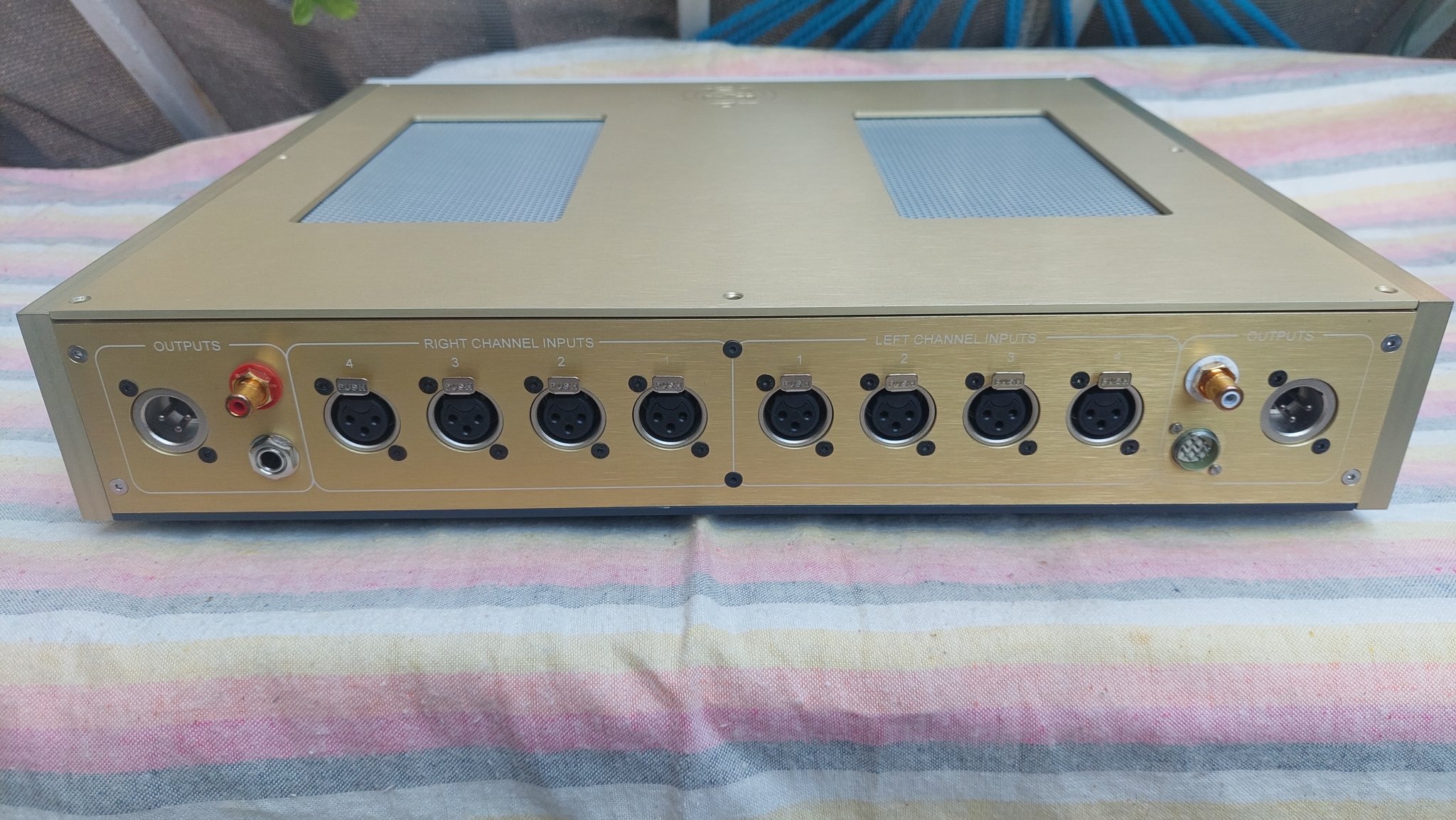

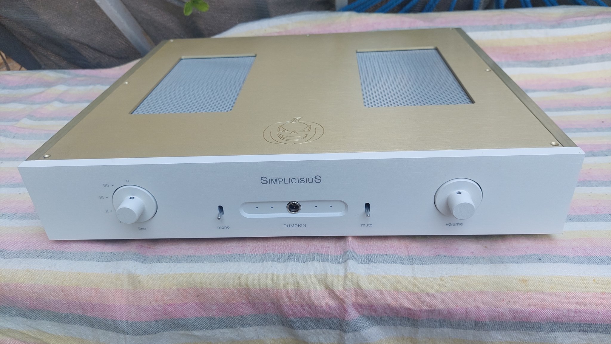

Finally I finished preamp!
Tried with LDR potentiometer, but not saccesfully!
Now pot is 52 positions ELMA driving, by diode matrix, two time 6 reley. Resistors is SUSUMU thin film smd!

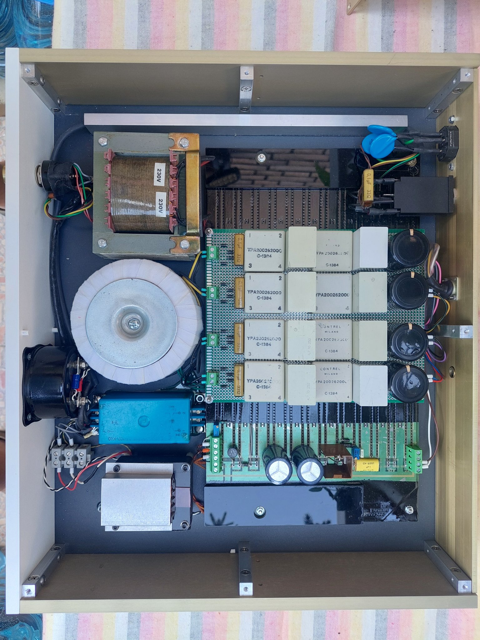

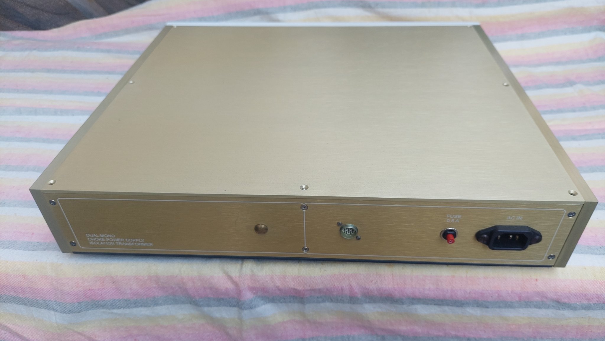

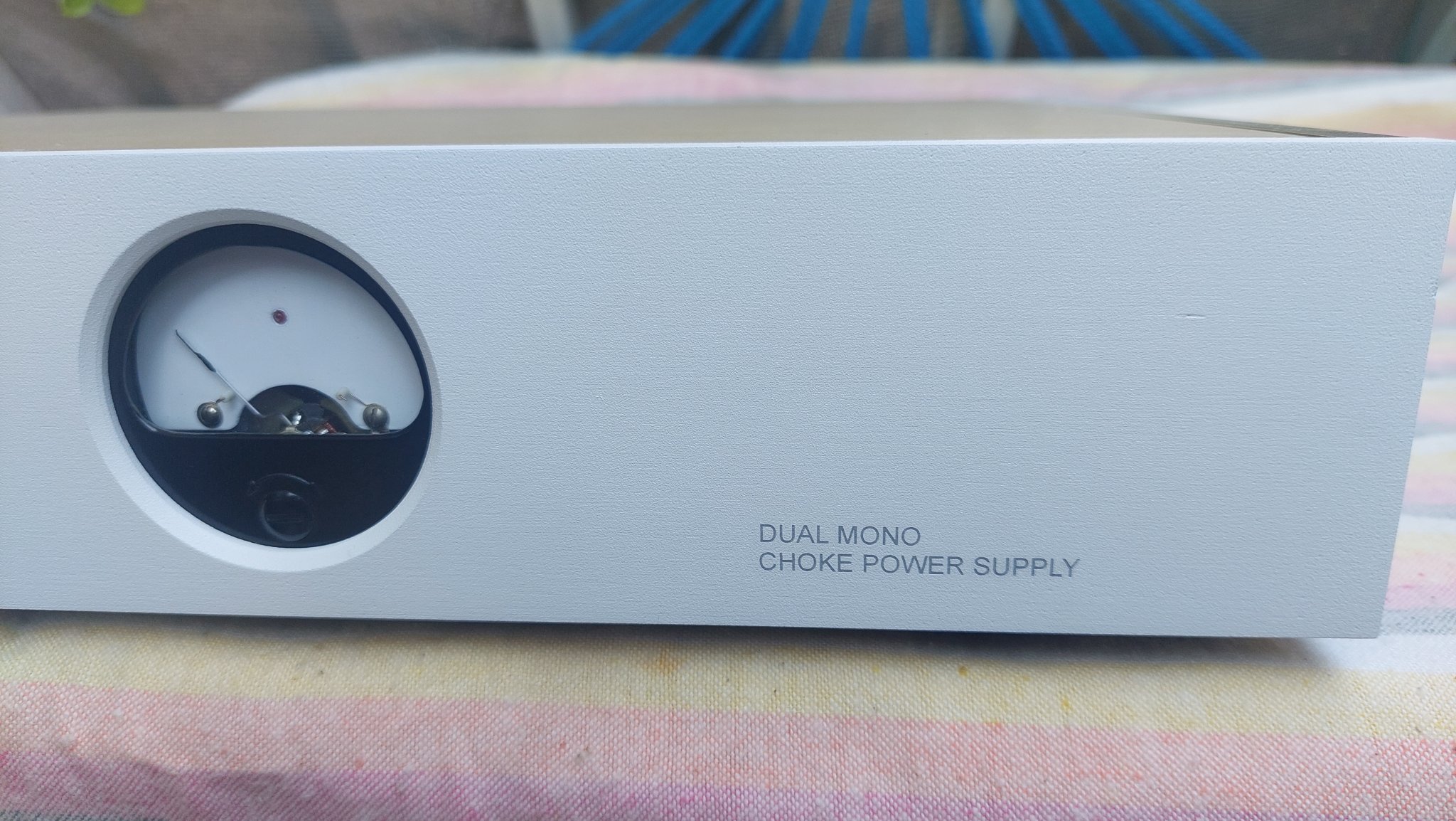

Power suply is quite exeptional!
EI trafo 230/230 for balanced in.
Toroid 200W, 4×45V with electrostatic barrier and magnetic schild.
Four time schotky gretz, RC, duble choke, polypro 4,7uF, duble choke, polypro, MUNDORF electrolitic 10000uF.
Four time separate 60V and graund is separate to the preamp!

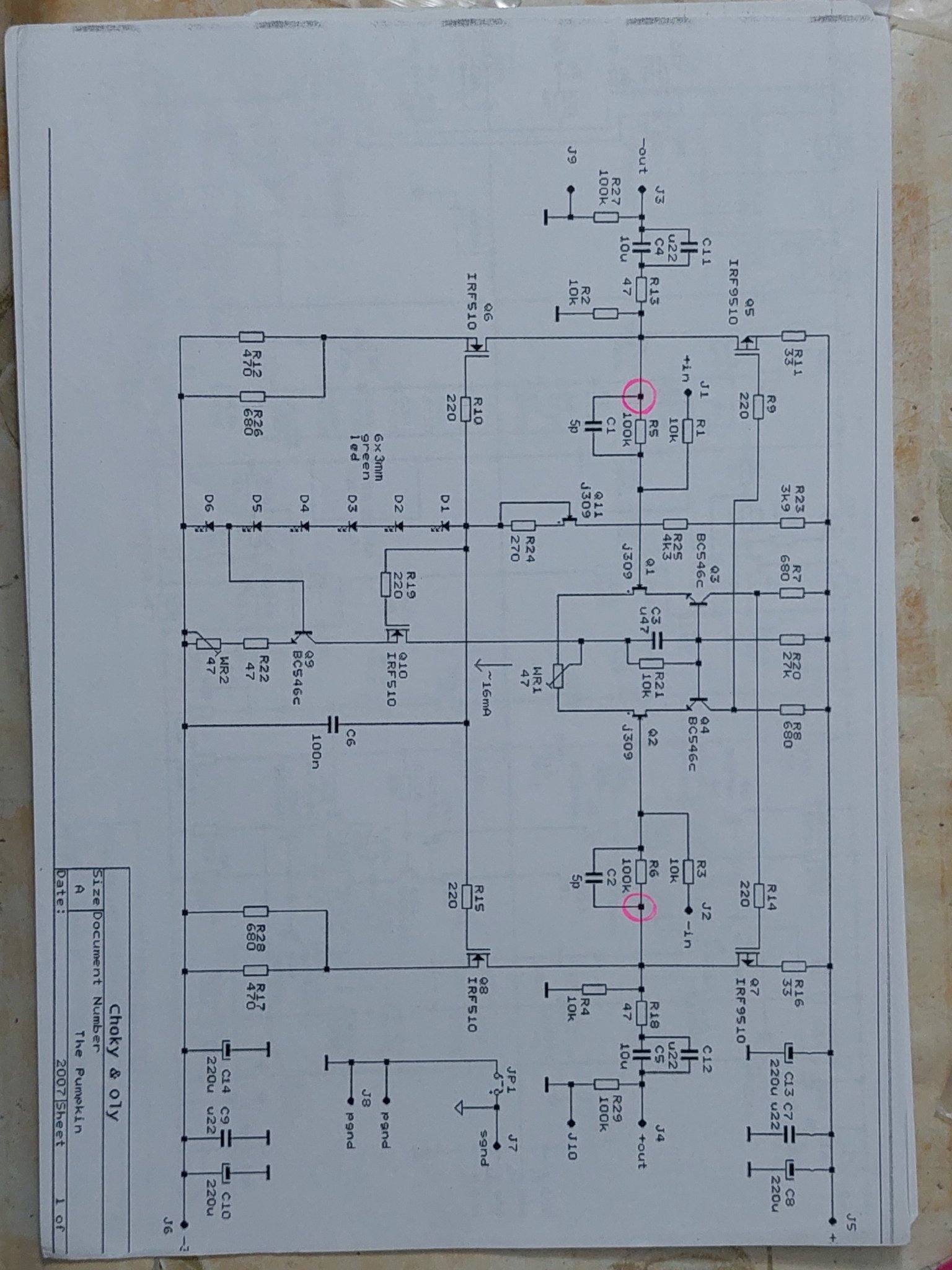

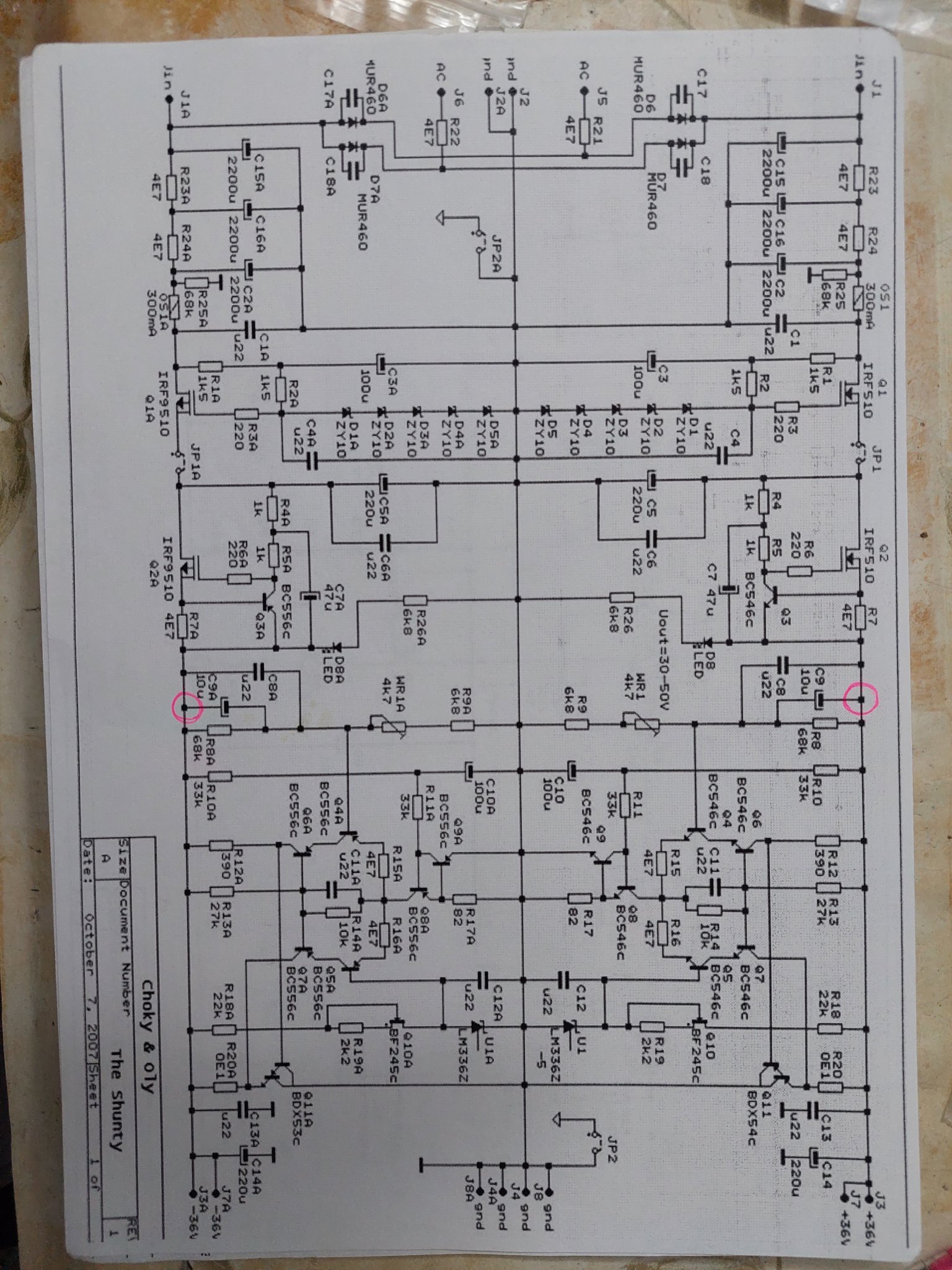

Layout of printed circuit bord is phenomenal! But, there is some bad metalized thru-hole.
On Shunty capacitor C9 and C9A.
On Pumpkin resistor R5 and R6 for NFB.
It is marked on scheme!
Signal going from one side bord to other thru metalized holes.
You must better soldering and make wire bridges point to point!
I took over a members defective Pumpkin/Shunty project and vaguely remember a couple of pcb issues that were a little time consuming to figure out. It was like 12 years ago so I can't remember exactly what was done. It was one of my "never finalized" projects. Those boards are still in my basement workshop with a nice layer of dust.. Anyone interested in them? Shoot me a PM.. 🙂
