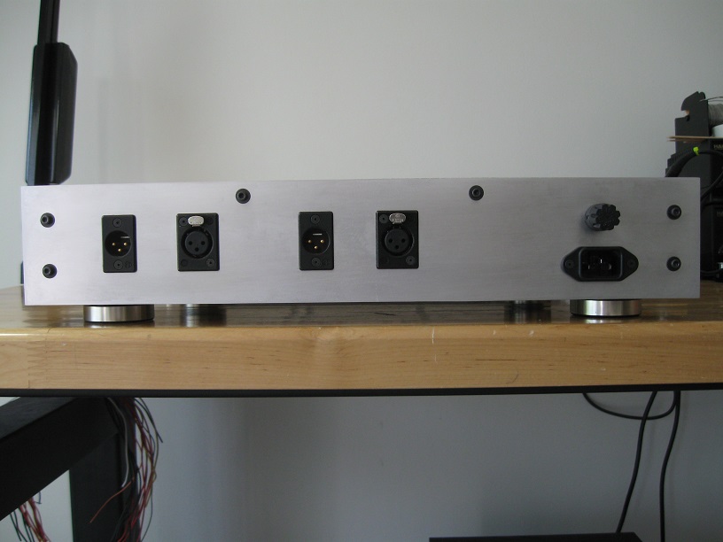

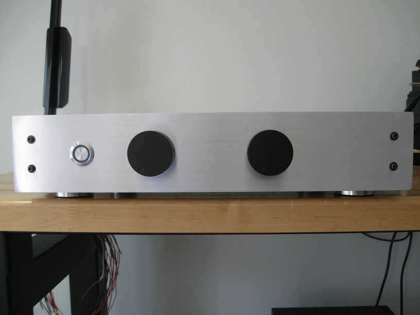

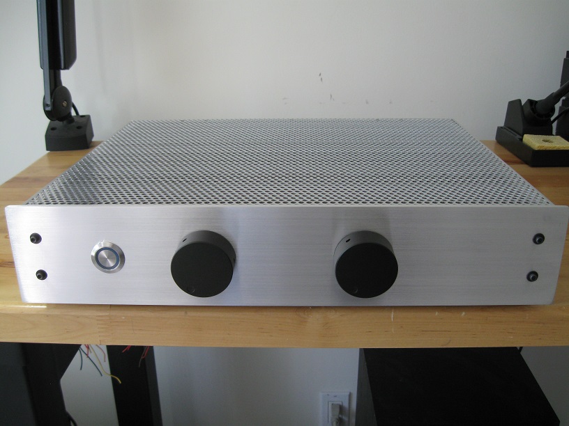

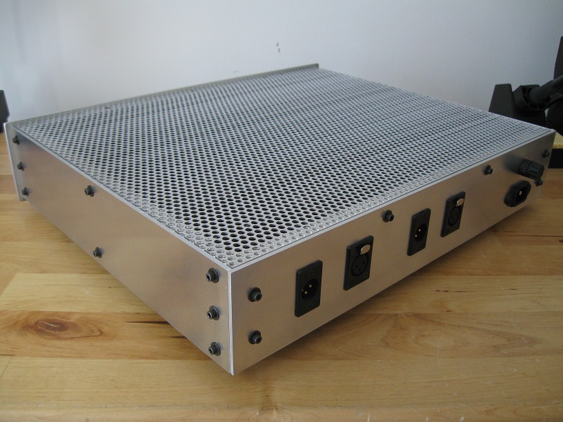

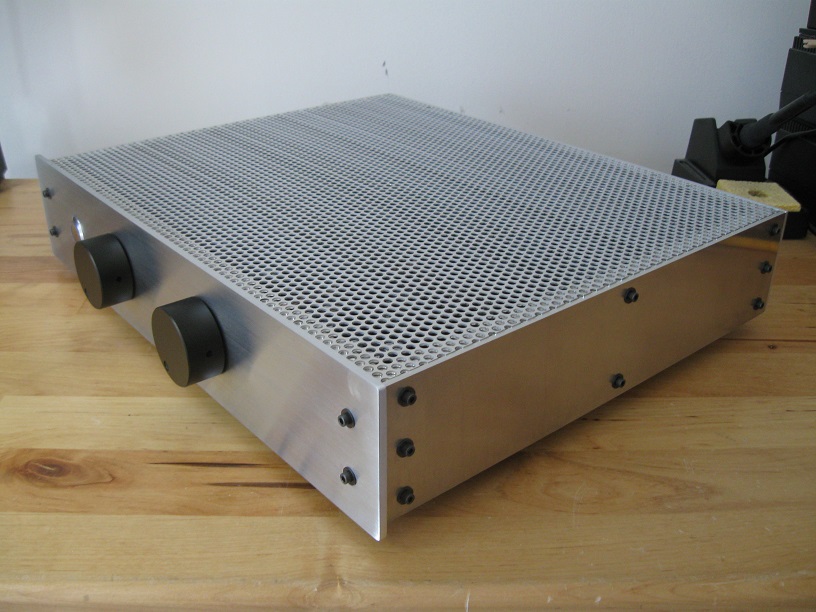

After a few years distracted by other hobbies ......
It's finally finished! Thanks for your help along the way Zen Mod.
- Pumpkin Preamp - Perfect for F4
