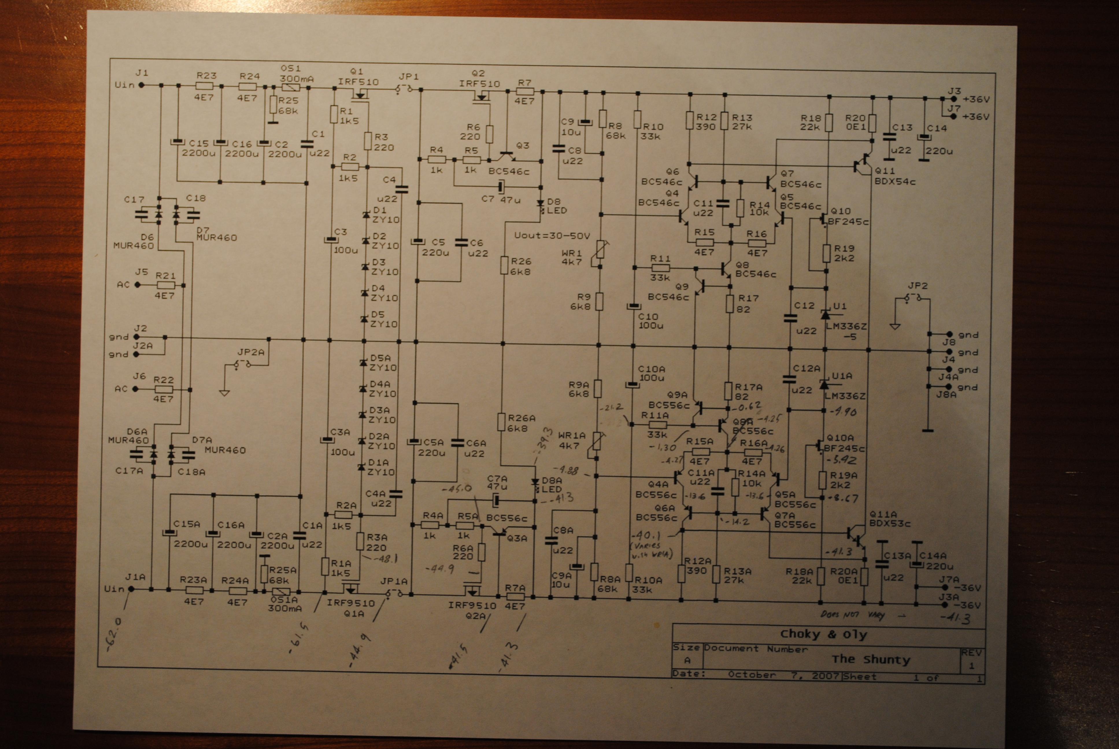

are you sure that darlingtons are genuine ?
for test , you can replace it ditto with any TO220 bjt , taking care of pinout or even N-type mosfet (G to B, D to C , S to E) ; for mosfet change R12A to 2K2
Vbe of Q3a is 0.2V ?
it isn't .............. problem is that CCS can't establish it's function without load
