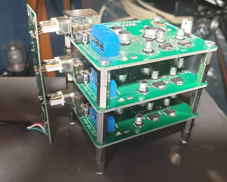

@Tfive As I didn't installed your software yet I can't check myself so I would like to ask you: will it work with 3x stereo PCM2706 INSTEAD multichannel card? In total we have 6 channels but from 3 USB devices. For testing purposes I made set which is USB hub and 3 times cheap Chinese PCM2706 card. See picture 20200708_221954.jpg

You mentioned that you had a USBstreamer... If those DACs have i2s input you can create a 8ch DAC with it.
PCM2706 are USB-adaptive devices, they will generate synchronous clock PLLed from the common USB signal. OK.
But three devices connected to a serial bus receive their data at different time. The time difference between first and third device will be at least 2 packet lengths, i.e. 2 x 48 audio frames at 12MHz, i.e. for 16 bits 2 x 48 x 16 x 2 = 256us. In reality probably more (USB frame overhead).
However, the PCM2706 datasheet says:
When receiving the audio data, the PCM2704/5/6/7 stores the first audio packet, which contains 1 ms of audio data, into the internal storage buffer. The PCM2704/5/6/7 starts playing the audio data after detecting the next subsequent start-of-frame (SOF) packet.
That would mean all three chips will be synchronized by the common SOF packet and playback should start at the same time. Provided the USB HUB does not introduce time shifts between its outputs (probably not).
I didn't think about that. Wouldn't it be true if one USB would serve for all 3 DAC? Theoretically we could go for 3 separate USB's taken directly from motherboard not from hub. Then data package shifting wouldn't be problem anymore. Do I think right?
The PCM2706 datasheet suggests the data shifting within the USB frame should not matter because the FIFO output startup is gated by the next SOF packet which should arrive to all the connected devices (connected to the same hub) at the same time.
3 motherboard USB ports does not mean 3 independent USB controllers, every USB facility contains USB root hubs. The actual layout is listed in lsusb -t tree view.
Nevertheless splitting the data to 3 distinct USB controllers would definitely ruin the synchronization - different clocks (though likely PLL'd from a single system clock), independent SOF generation/delivery.
IMO your arrangement with USB-adaptive soundcards and PCM2706s gated at the common SOF could work correctly.
Should be easy to try with a scope and at least two PCM270X/PCM290X boards. If you use pulseaudio you should be up and running with two or even three of these in no time, just assemble a filter chain with a single split to two/three outputs and no filtering.
