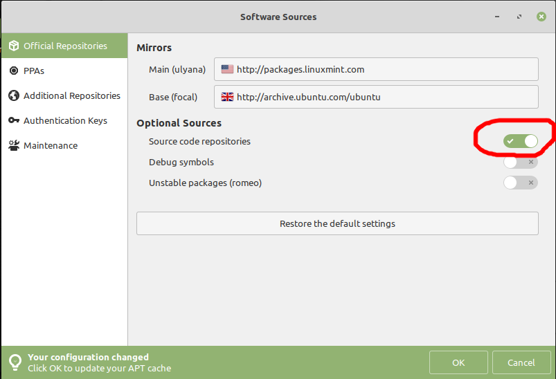

I was trying to put in this fix but when i run the ./build.sh command i got this error
E: You must put some 'deb-src' URIs in your sources.list
dpkg-buildpackage: error: cannot open file debian/changelog: No such file or directory
Yes, you have to enable source packages in your package sources manager. I attached a screenshot how this looks in linux mint MATE. The menu entry is called "package sources" there. This might differ from distribution to distribution, but i guess you will get the concept.
@Tfive Thanks...i was able to find the source packages and once enabled everything worked fine from a code loading.
