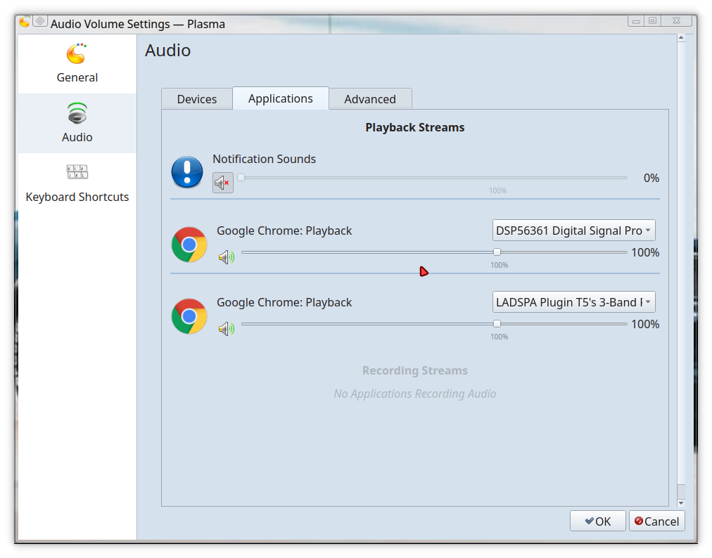

Yes it starts up with the system as default on if it is on when you shut it down and do a reboot.
I don't use Kodi but Imagine it works the same, as it is just basically a DE running under the very some OS you are using.
Yes you can set several Presets with whatever name of your choosing yes it runs in the background and is inserted in the path of whatever your streaming device may be and you can choose what your default is.
In the screenshot below you can see that I have two videos playing one is straight through from my soundcard and the other is diverted through the EQ to my output device (soundcard).

What is the DSP56361 device? I assume the second one audio you have in configuration called LADSPA Plugin T5's is the fake, loop back input of the Tfive software, correct?
Yes, The T5 is inserted into the path from the source in this case Google chrome and looped back into the soundcard, I don't have any other device hooked up at this time so I have not tried using a USB soundcard yet, I can make one up using my one of my STM32F4discovery boards that has worked in the past as an output device, but I am sure that it would work just fine, I hope.
